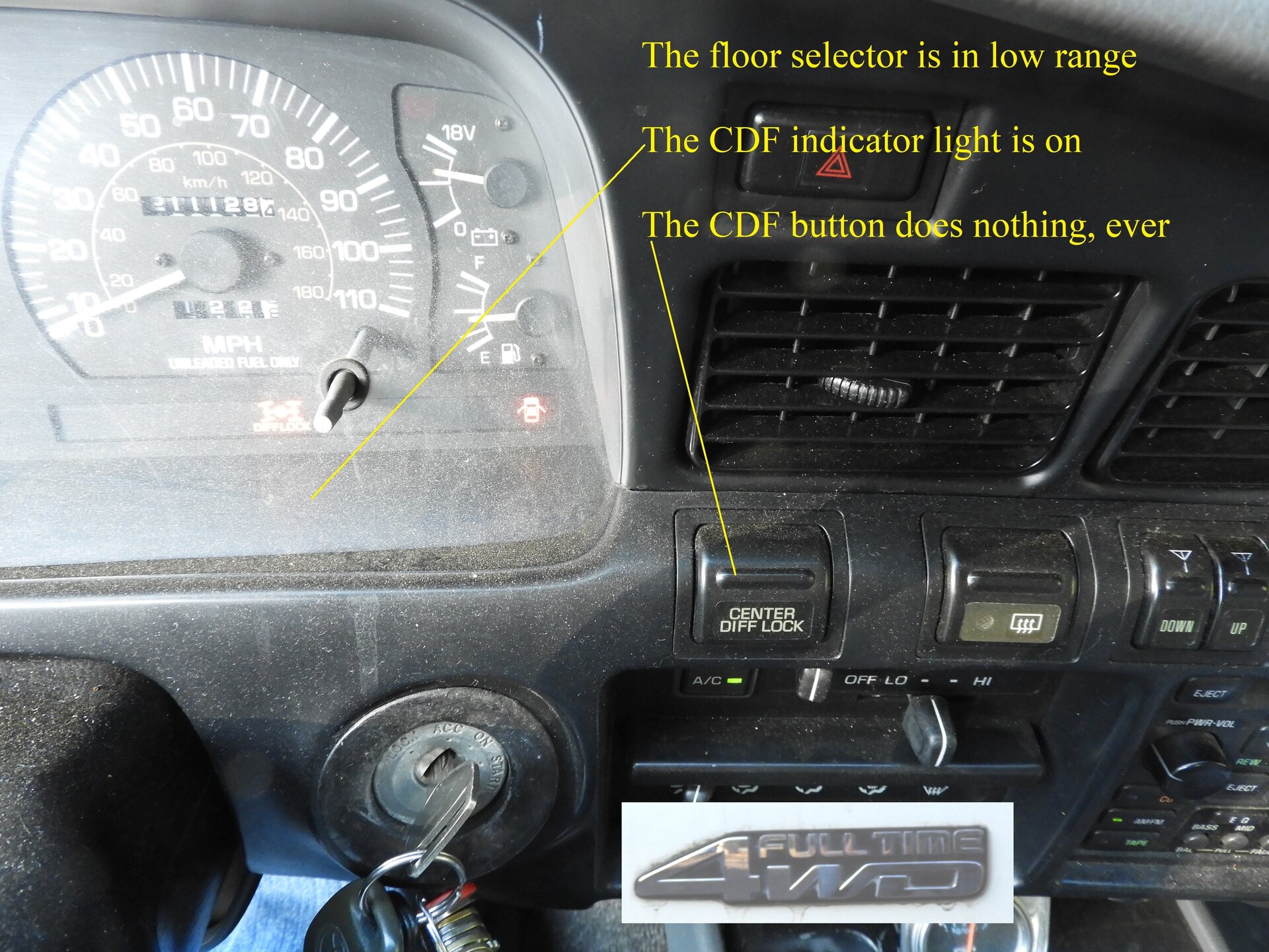

My 92 does any off road driving I can throw at it. The only question about that is, are the lockers supposed to be full time in low range? The locker button is non functional, like someone mucked with it before I got the truck.

Center diff lock comes in when you go into low range, unless the low range sensor is not working, and/or the pin 7 mod has been done.

Your 1992 does not have axle lockers, unless they are aftermarket.
The only "locker" you have is the center diff locker (CDL). This puts the truck into regular old 4WD. The dash button should allow you to lock the CDL in high range and should automatically lock in low range.

The center diff lock light on the dash comes on when in low range. The button does nothing. IT is made to be in 4WD all the time, which I do not like. It is always in 4WD based on the places I can go. There is no way I could do that in 2WD. The center diff lock light is indicating something. IT gets harder to steer. The tires all turn .

Your rig will automatically lock the center dif in low range.
In high range you can unlock or lock the center diff with the button, but the button will do nothing in low range.
It's an awd truck, full time 4wd is misleading. When you lock the center dif in high range it's true 4wd.

Just ran outside and tested on my 91.
When putting transfer case in Low, the Center Diff Lock engages automatically and cannot be cycled off.
When putting back in Hi, the Diff Lock disengages automatically.
The CDL switch will lock and unlock the diff in Hi.
So your automatic locking of the diff is correct, but if the CDL switch does nothing in Hi that is not normal.

This is a full time 4wd vehicle. There is a center differential in the transfer case that allows for good road manners without binding the driveline.
The center diff will automatically lock when in low range. In low range, the dash switch will do nothing. It allows you to lock the center diff in high range only, unless there have been modifications.
