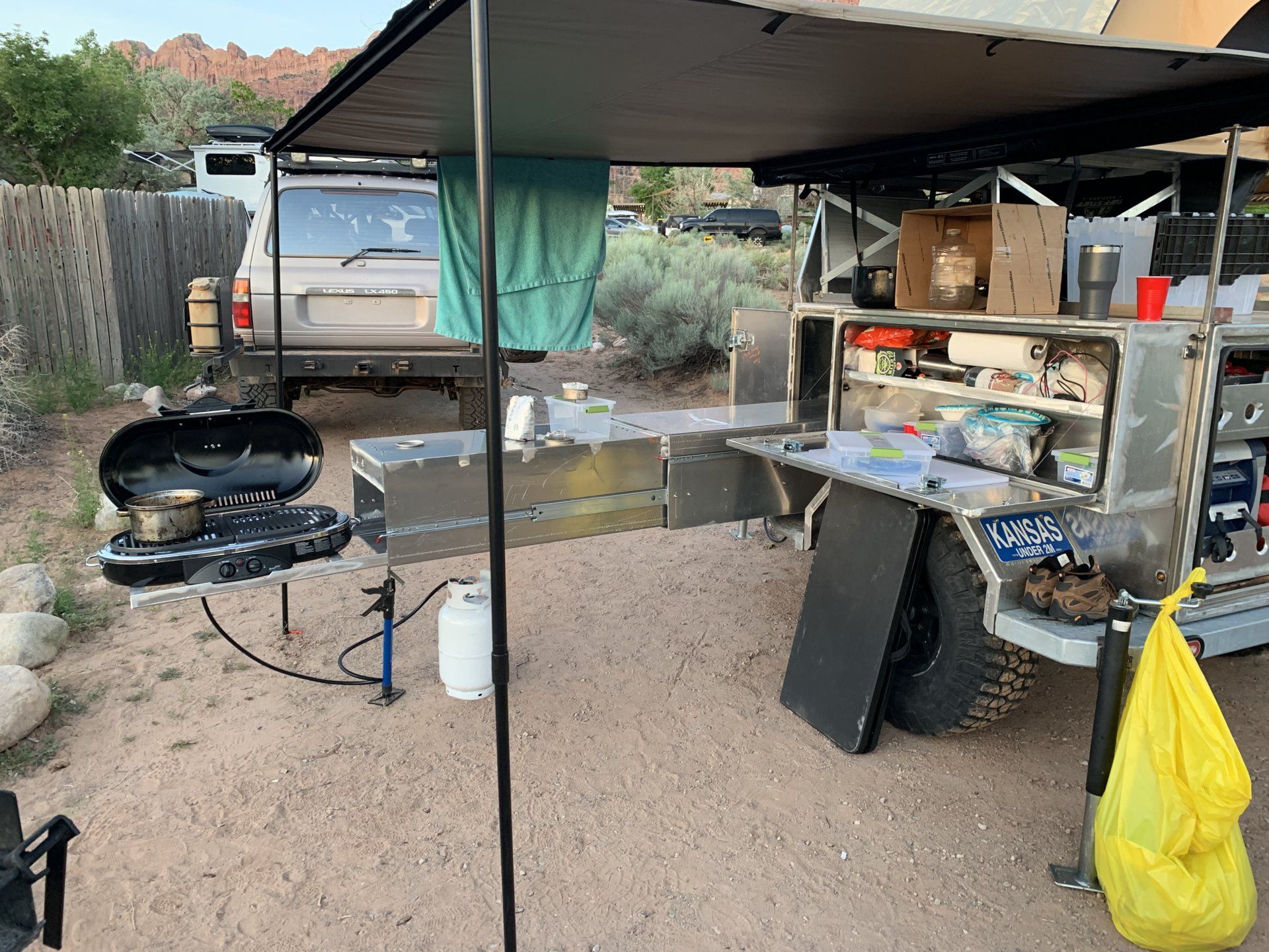

Finally getting some time to work on this build again. Some of you might have followed by camping trailer build, then got Utah, my 75 FJ40, out to Moab for a trip last month.
If any of you have gone all the way to the top of the world, without taking bypasses, you’ll realize how crazy I was to pull that trailer there..... but it made it !!!!

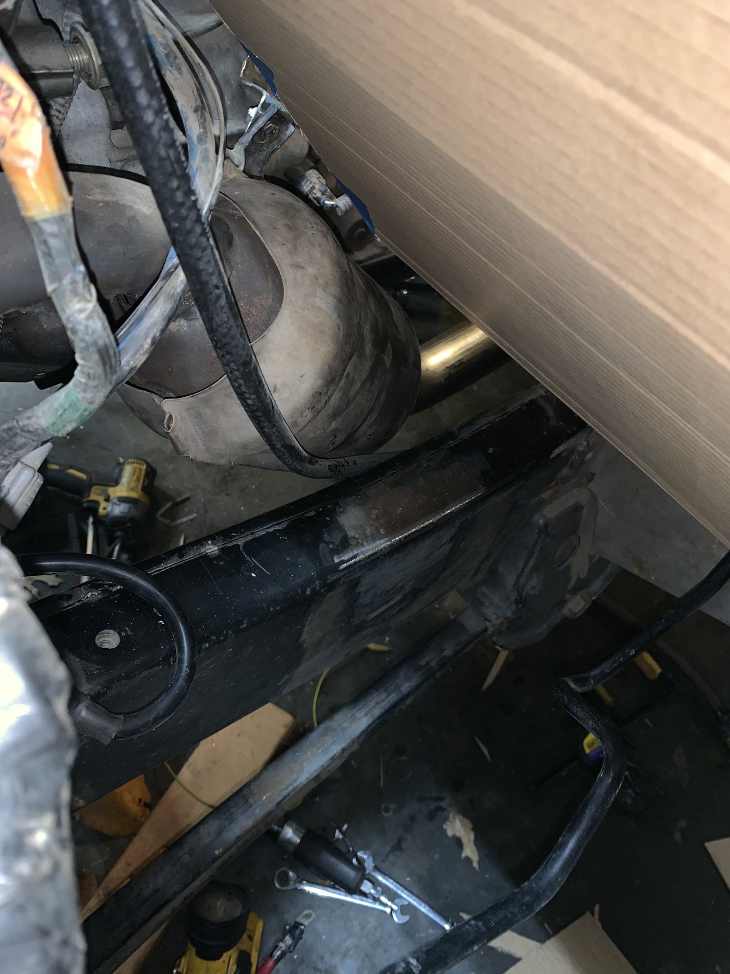

First thing to do was to get the exhaust tacked in place. Then I realized that I need to put the transfer case in and the front driveshaft in to be able to place the exhaust correctly. My son Joshua, who is 17 now, and stronger than I am, helped me muscle it into place...
Unfortunately it is really tight for the rear two sensors.... I don’t think I can move the engine Farenuff forward so I’ll probably have to clearance the cab for this...

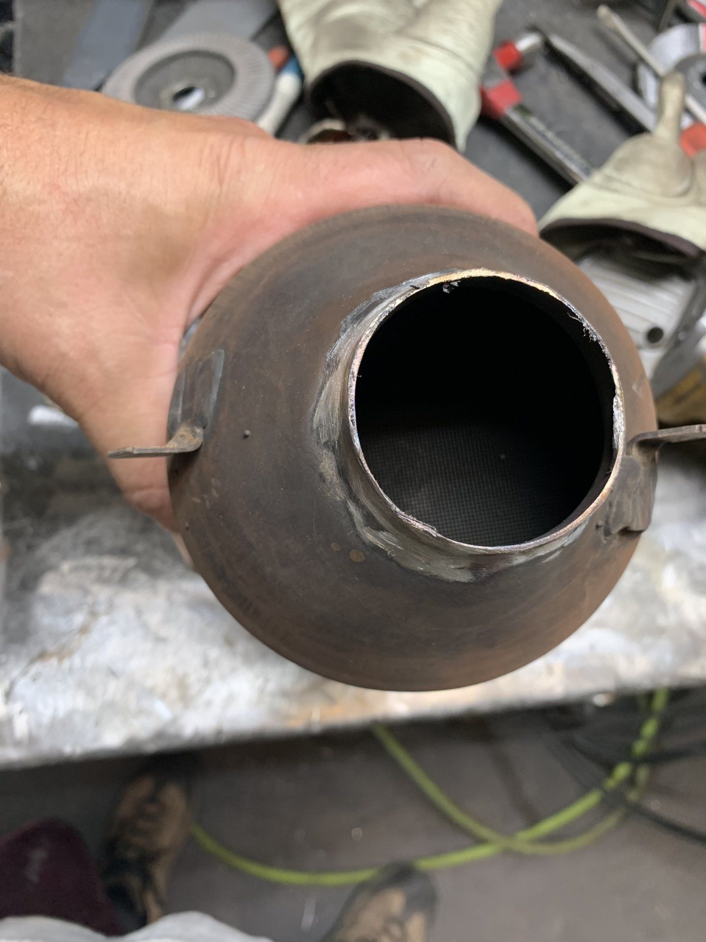

For the exhaust, I wanted to put the cad converters in about the same place as they were originally, right after the upstream O2 sensors, but in order for me to move the floor I need them offset forward as much as possible. Looking at the converters, they were offset on the downstream side, so I cut the flanges off and flipped them over. Here is the original upstream side
And here is the downstream side originally
Here is the passenger side tacked in place with a 45° Mandrel stainless bend

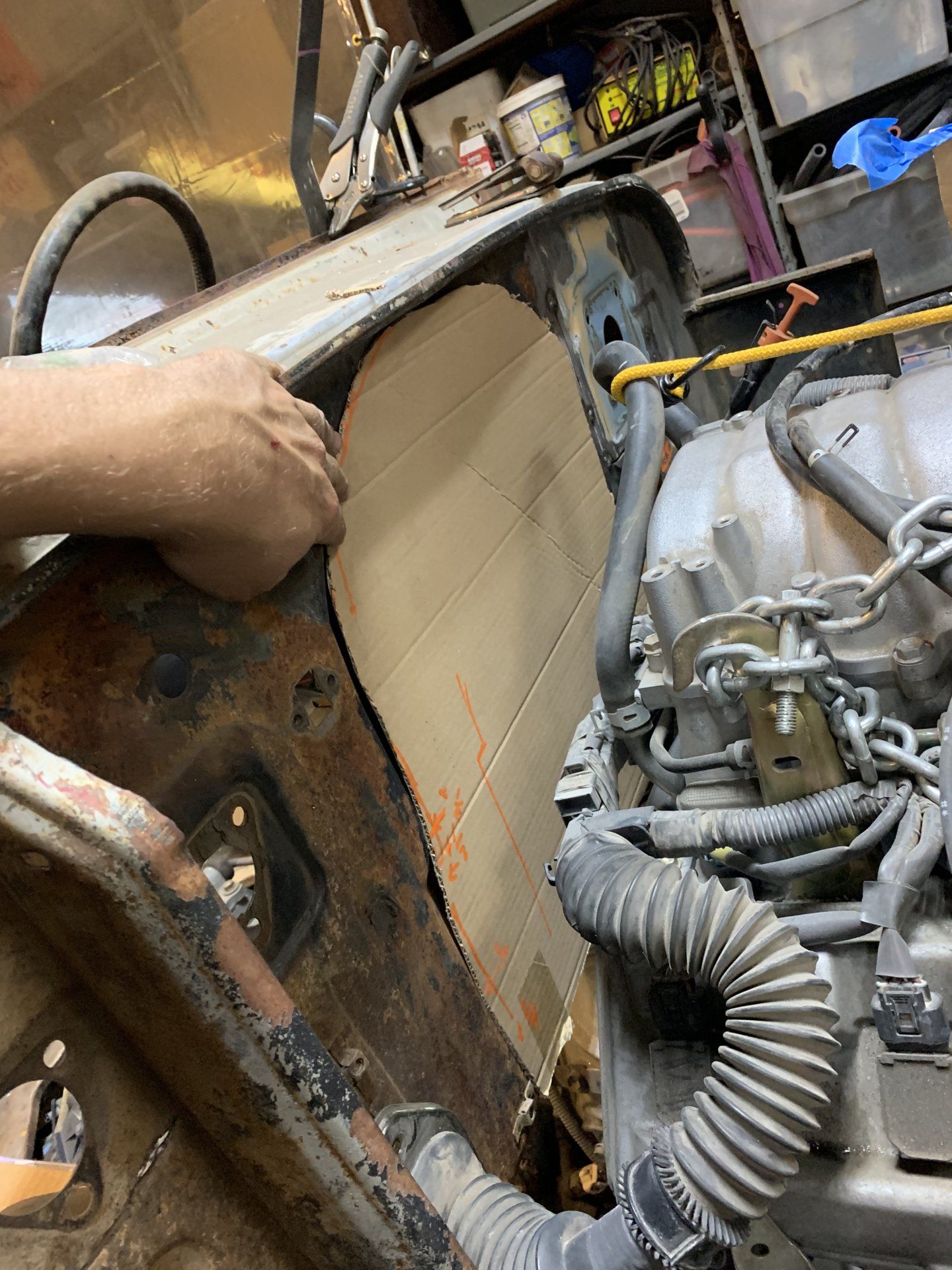

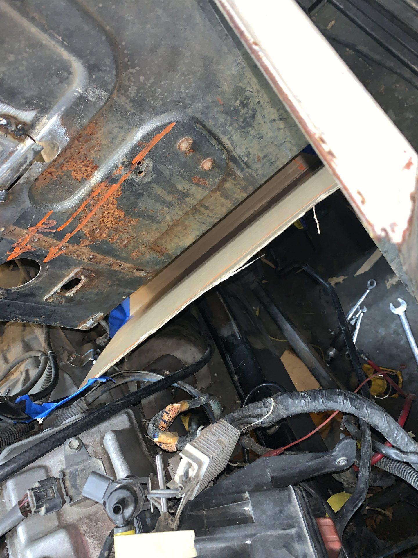

With the exhaust tacked in place now I can start working on sheet-metal. First thing is to get rid of the we are engine hump and planwhere I can move the floorboard to.
With a 4 inch forward movement to the floorboard, I still have about an inch gap to the exhaust , With the aluminum heat shield

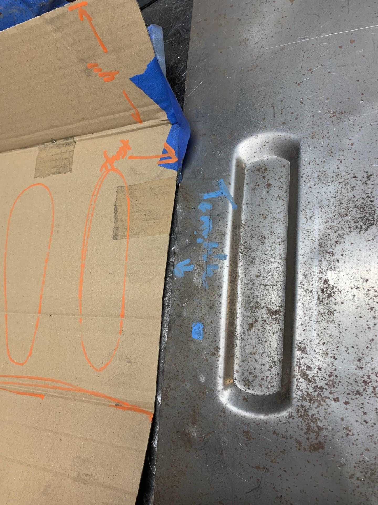

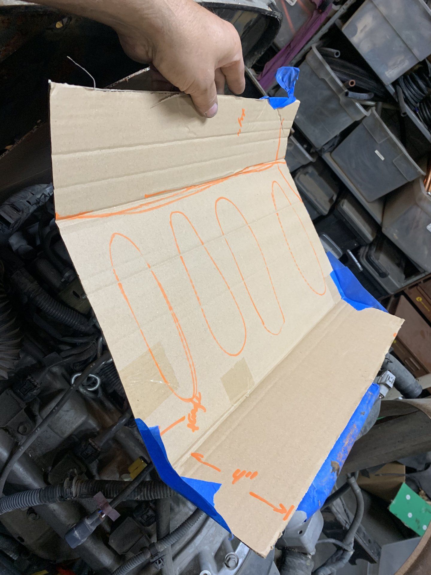

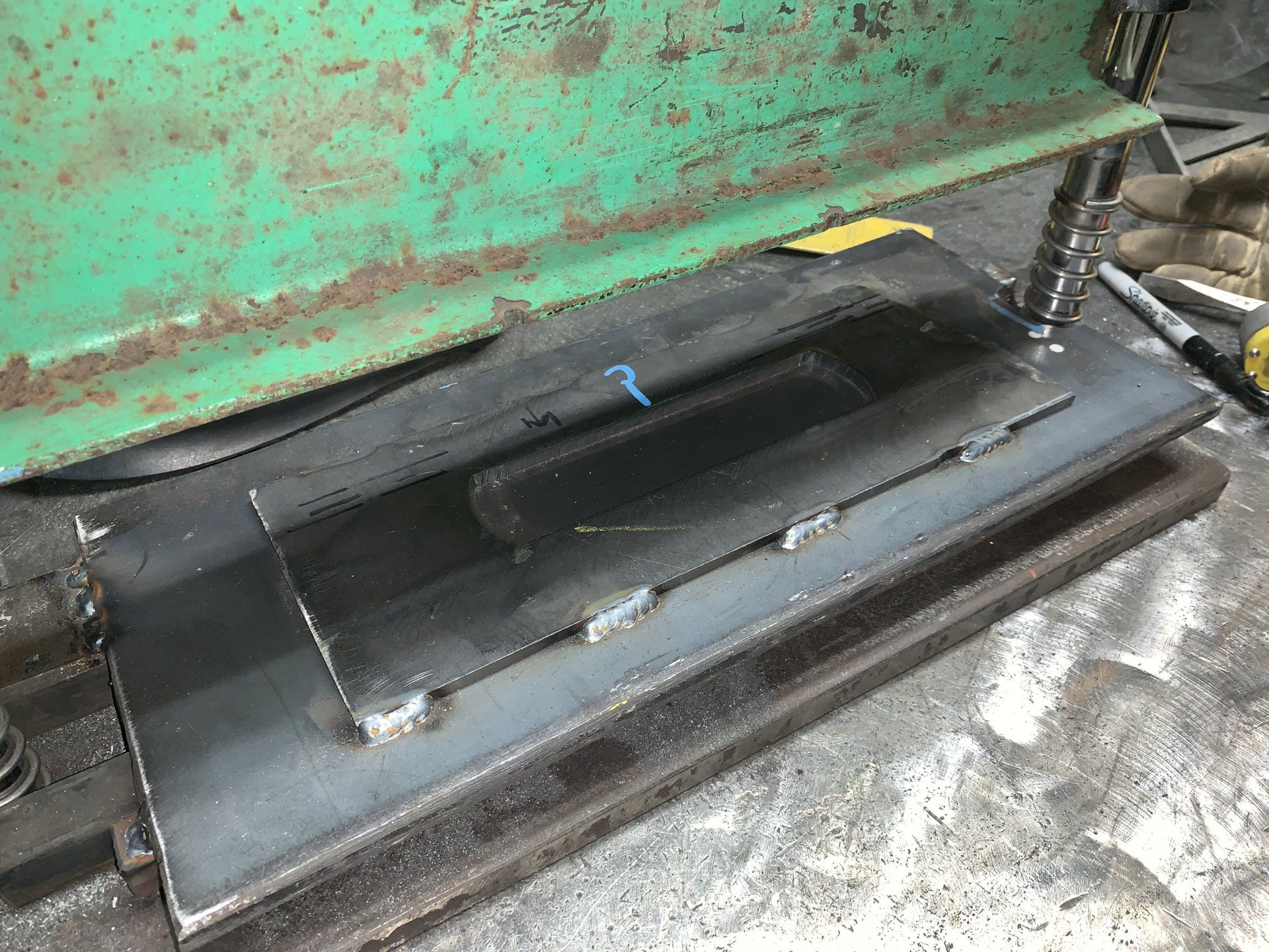

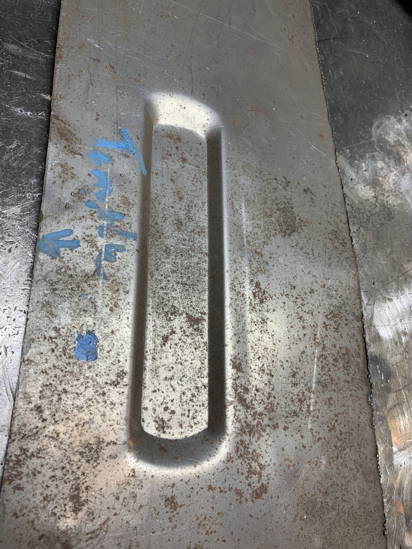

Somewhere on mud there’s a thread about making a home built press negative and positive to make the indents to help strengthen a flat piece of sheet metal..... without using a English roller
—- need to find that and make something.
With the exhaust tacked in place now I can start working on sheet-metal. First thing is to get rid of the we are engine hump and planwhere I can move the floorboard to. View attachment 1999157
With a 4 inch forward movement to the floorboard, I still have about an inch gap to the exhaust , With the aluminum heat shield View attachment 1999154View attachment 1999155View attachment 1999158
That hump will be nice for if you gotta replace the starter...
I thought you have to pull the intake off to get to the starter on the 2uz.

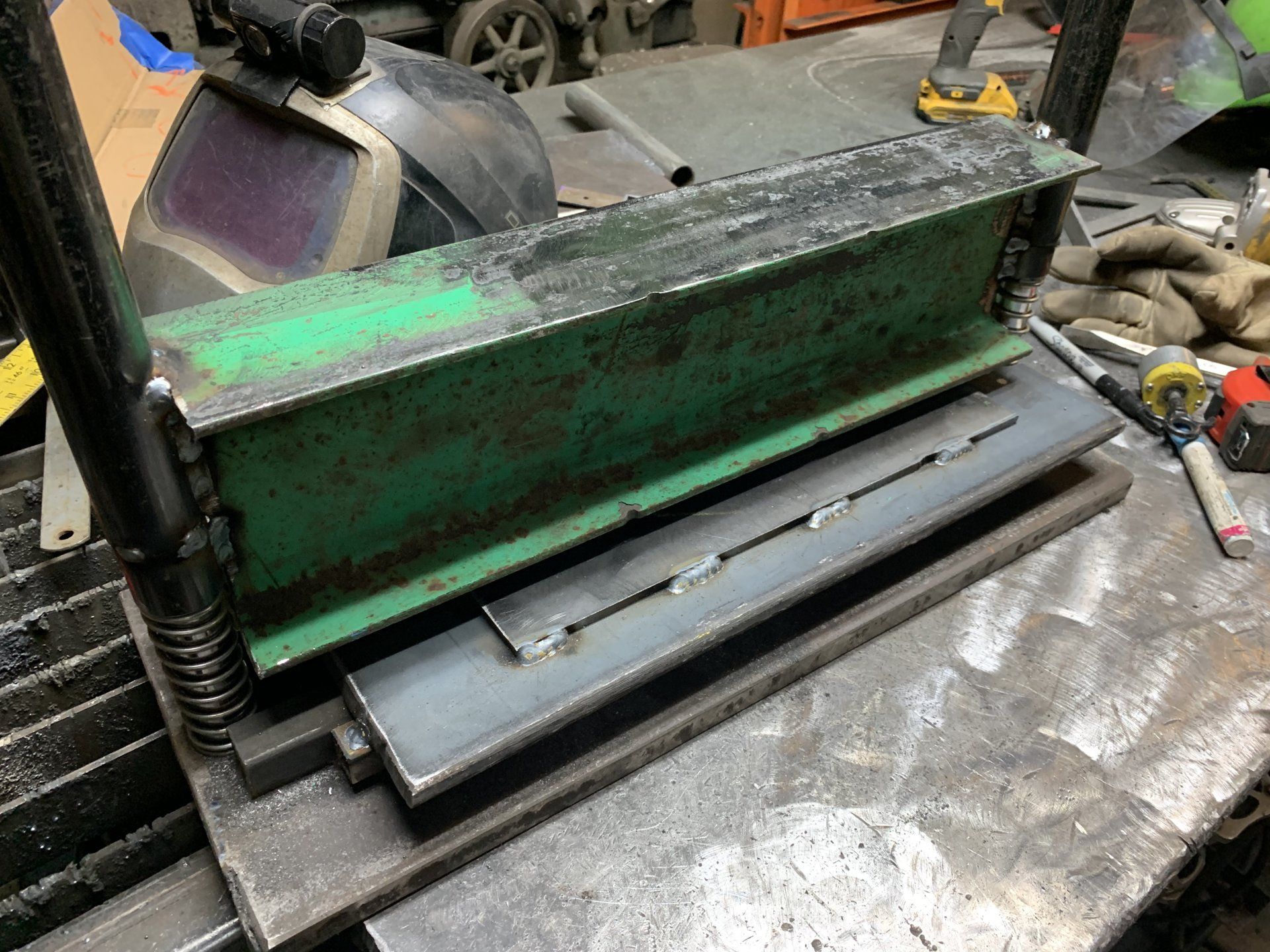

Converted my hydraulic brake to a dimple die...
Baller status for that dimple die!

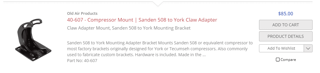

Is it a serpentine? We can prob fab a bracket for it. They have little tabs that mount on the sandens
Yes, you have the choice to get the V belt or the serpentine, I went ahead and got the serpentine. The issue and concern is that the compressor is in a very tight spot already with an aluminum bracket that also supports something else... so this may get complicated.... however, it will likely solve my hose issue with the stock hoses coming out of the compressor running into the frame.
I did pick up this mount as part of the package.....
