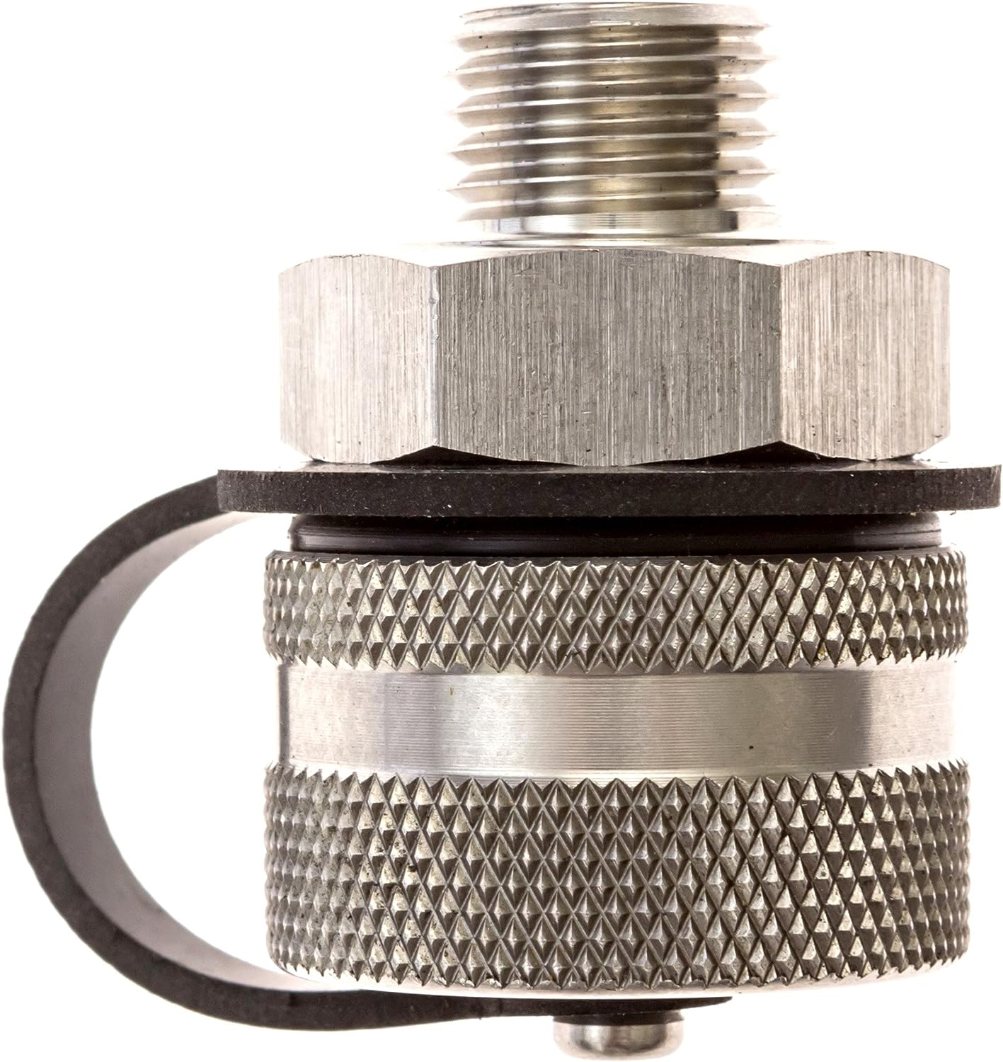

What are your thoughts on the ValvoMax quick twist oil drain valve? I saw Scotty's review and I thought it's pretty cool. However, I wasn't sure how to secure/screw it to the existing hole. It seemed like he just hand screw it in. If so, is that tight enough?
It seems to me to be as messy as just using the drain plug. I suspect the main body of the Valvomax is more than just hand tight in the pan. The cap is just hand tight.

Looking at this image from Amazon, it seemed that you can use a wrench to tighten the Valvomax and the cap/cover can be hand tighten. At $50, I'm not ready to purchase it yet but curious about it.

I have it on mine and will change my oil with it for the first time this weekend. There is 2 oil changes using it on my son's 4Runner. Works great and it is not as messy as a regular drain plug. Oil doesn't flow out until you screw on the other side that comes with the valve which has a nipple and hose on it that drains into your oil container....plus you don't ever need to buy crush washers again.
It was installed with same torque spec as the drain plug. The cap itself is just hand tightened because it is just a protective cap.
Most people use the Fumoto for easy draining. It has a 90 degree turn ball valve rather than this screw in valve.
