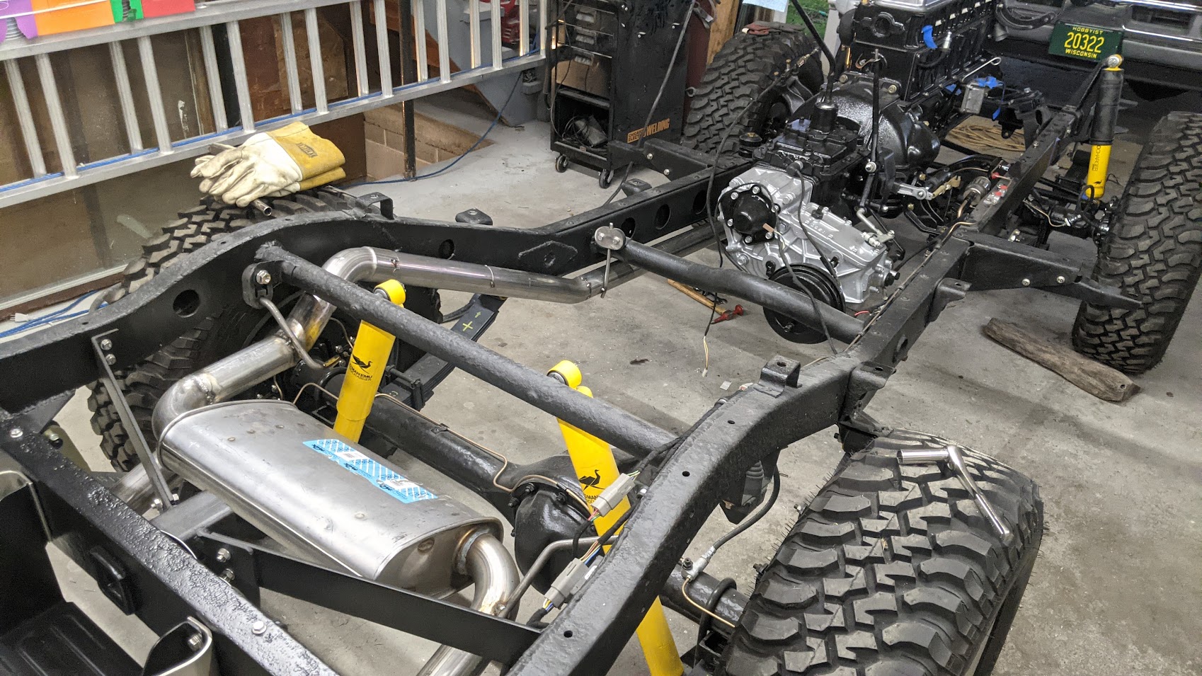

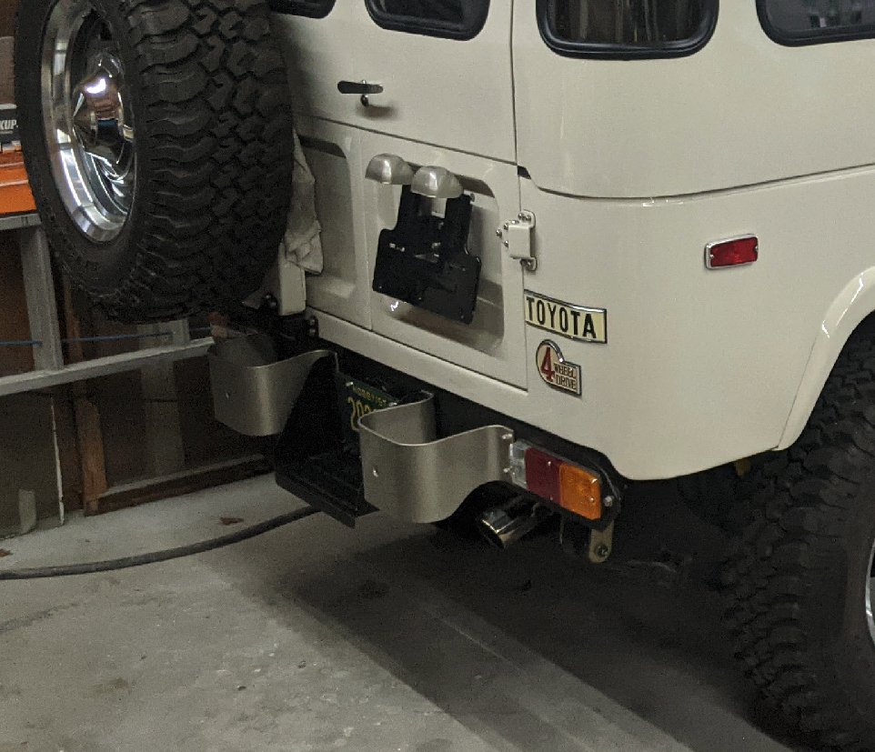

I've still got the 2F, but I've been happy with the 2.5" stainless back to a modified rear-exit stainless Dynomax for a Wrangler JK (#53804). I kept the pipe tucked up a little higher than stock by the transmission/TC as well, just to reduce how much it hung below.
I do have slightly different rear bumper braces, but might give you ideas around a non-stock setup.
View attachment 3504935View attachment 3504936
Looks nice. Did you bend those stainless pipes yourself? Does the OEM skid plate still mount ok w/ this pipe routing? (Looks almost like the factory pipe layout near skid plate area.) Any chance of a video or audio clip of how it sounds!? Thank you!
-Tom
I don't have a bender, so I got a couple 45s and one of the 180* U-pipes to cut and tig together as needed. The rear bends over the rear axle are the original piping from the JK muffler, but cut/rotated/extended if I recall.
I did raise my exhaust up a bit along the framerail, maybe 2" - my skidplate was pretty rotted, and I have no plans to take it offroad at this point in its life, so I left it out. Since it was out, I shifted the exhaust up a bit to have it hang down less.
I do have some video, but it hasn't made it into an edited YT publish yet, but I can prob snag it sometime this week. It's got a decent burble at idle, but generally benign driving around.
