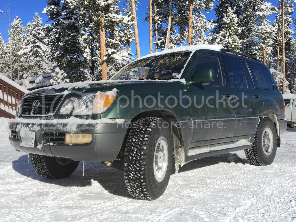

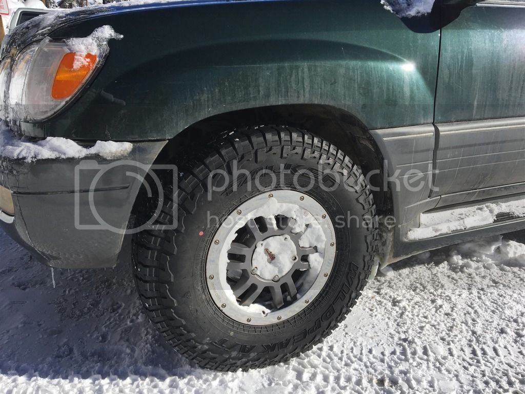

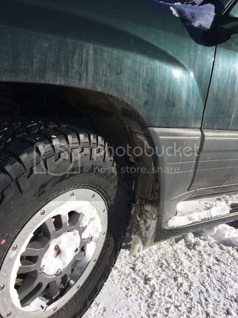

285/75R17 Falken Wildpeak AT3w's (34" tire). 1" front AHC lift and diff drop along with a Slee AHC override switch. There is slight rubbing while running at N around town (potholes, full lock, etc). I can use N on the highway, otherwise keep the AHC on Hi.
AHC @ Neutral
AHC @ Hi
AHC @Hi
If your tires are only rubbing on the "bump" on the lower fender splash guards, I can confirm from personal experience that a carefully applied heat gun will soften the plastic enough to flatten that area out.

Yes! Once it stops snowing and the temps get above 0*, I will attack the splash guards. The problem would easily be solved by removing the running boards, but the wife has requested they stay...for now!

You can push your top outside fender tab that holds the fender liner with your fingers. It is in the 12 o'clock position looking at your front tire. Put your fingers on the retainer that holds the liner to the tab and push up and try to flatten it against the fender. Should take care of that rub at neutral height over the bumps.
