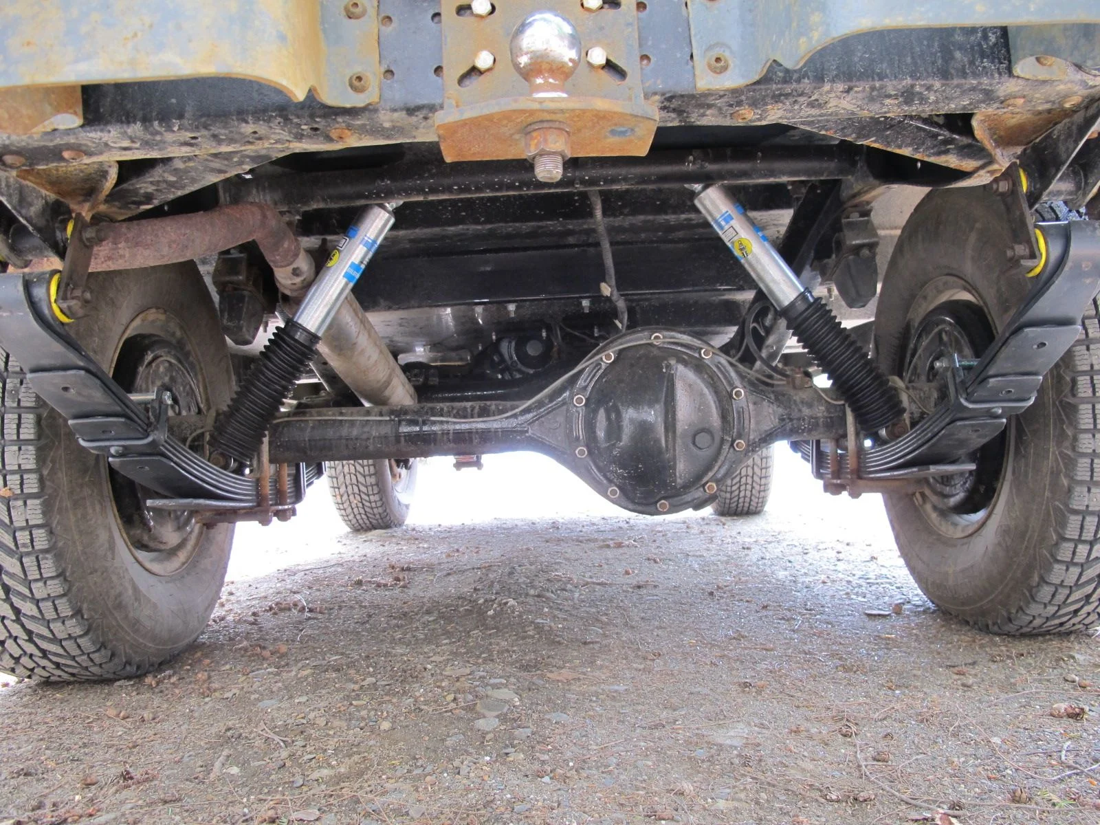

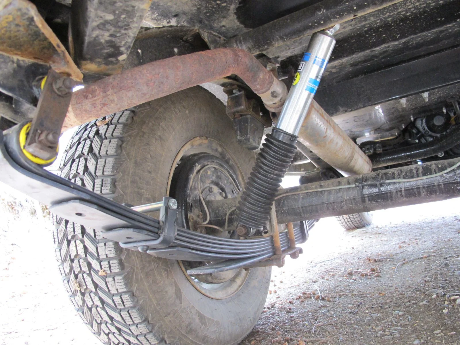

Yesterday I replaced my rear leaf springs. When I did my recent overhaul (2017) I thought:bang: the 63 OEM springs were good, at least the arch out of the truck was real close to spec. But once under the truck they just sagged even with new Bilstein 5100 Series 33-062518 shocks.
So I looked around for new leaf springs and found that it was difficult to find a vendor that had OEM springs but many that had lifted springs.
ARB sounded pretty good so I decided to try the CS001R with a 2" lift. So I also checked what Bilstein shock was comparable to the ARB recommended shock for the CS001R and the closest match was a Bilstein 5100 Series 33-186542 with 9.15" travel. I was somewhat astonished that the price for six bushings was $31 and change per spring, but you can't do an install without them.
Interesting enough to mention that I contacted ARB Tech and asked how the CS001R springs would work with OEM front springs and was told it would be a lousy ride and couldn't comment on the use of Bilstein shocks because they didn't sell them? The Tech should have stayed with tech instead of sales, the ride is pretty nice.
Now I have a pair of Bilstein 33-062518 shocks with four months of wear left over.
