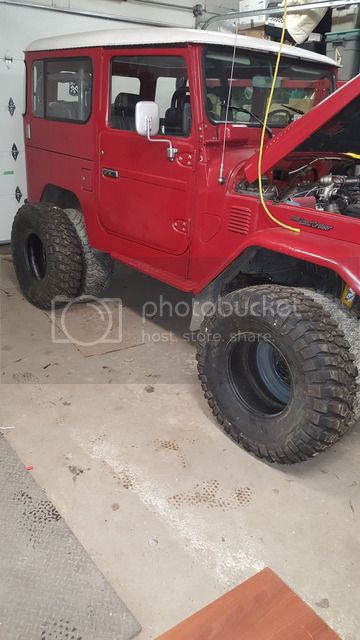

Scored 3 new KM2 for $400 id say thats a deal! Now i need to buy 2 more. Doubt another 2 will fall into my lap haha. Guess ill just pony up and buy 2 retail. Cant wait to get them on. I have a set of stock wheels i need to blast and paint then just mount these together.
