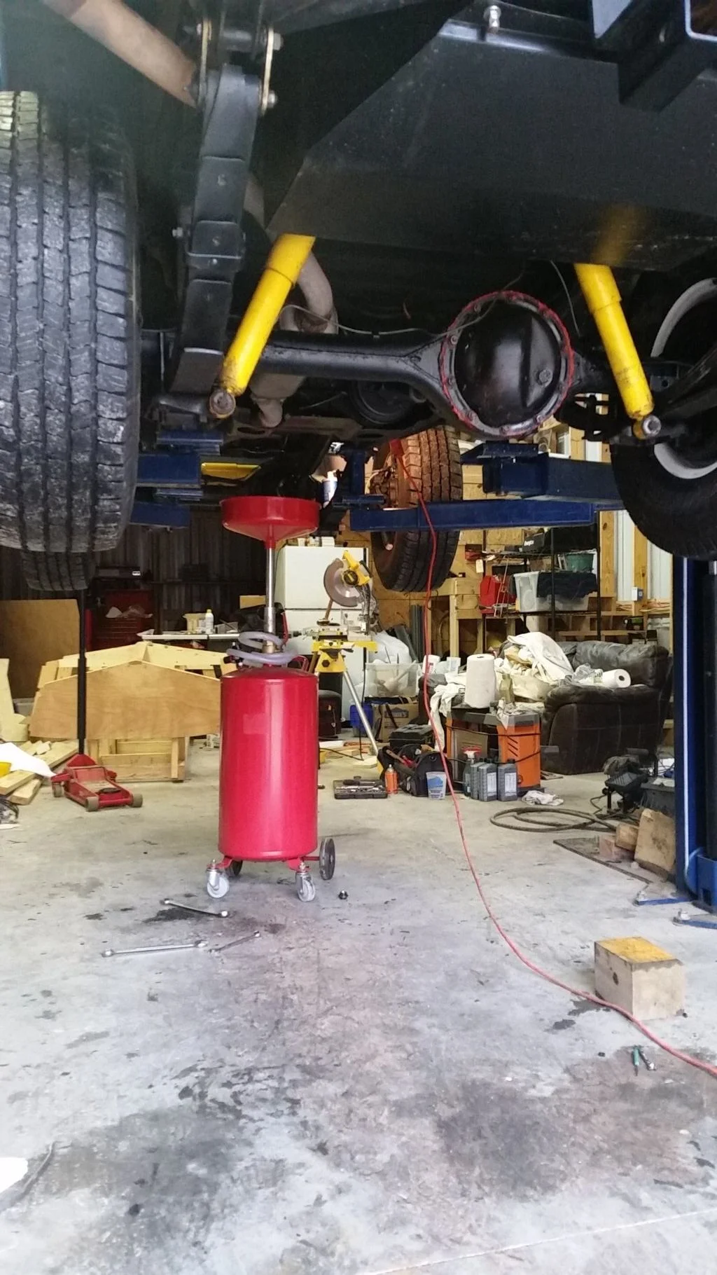

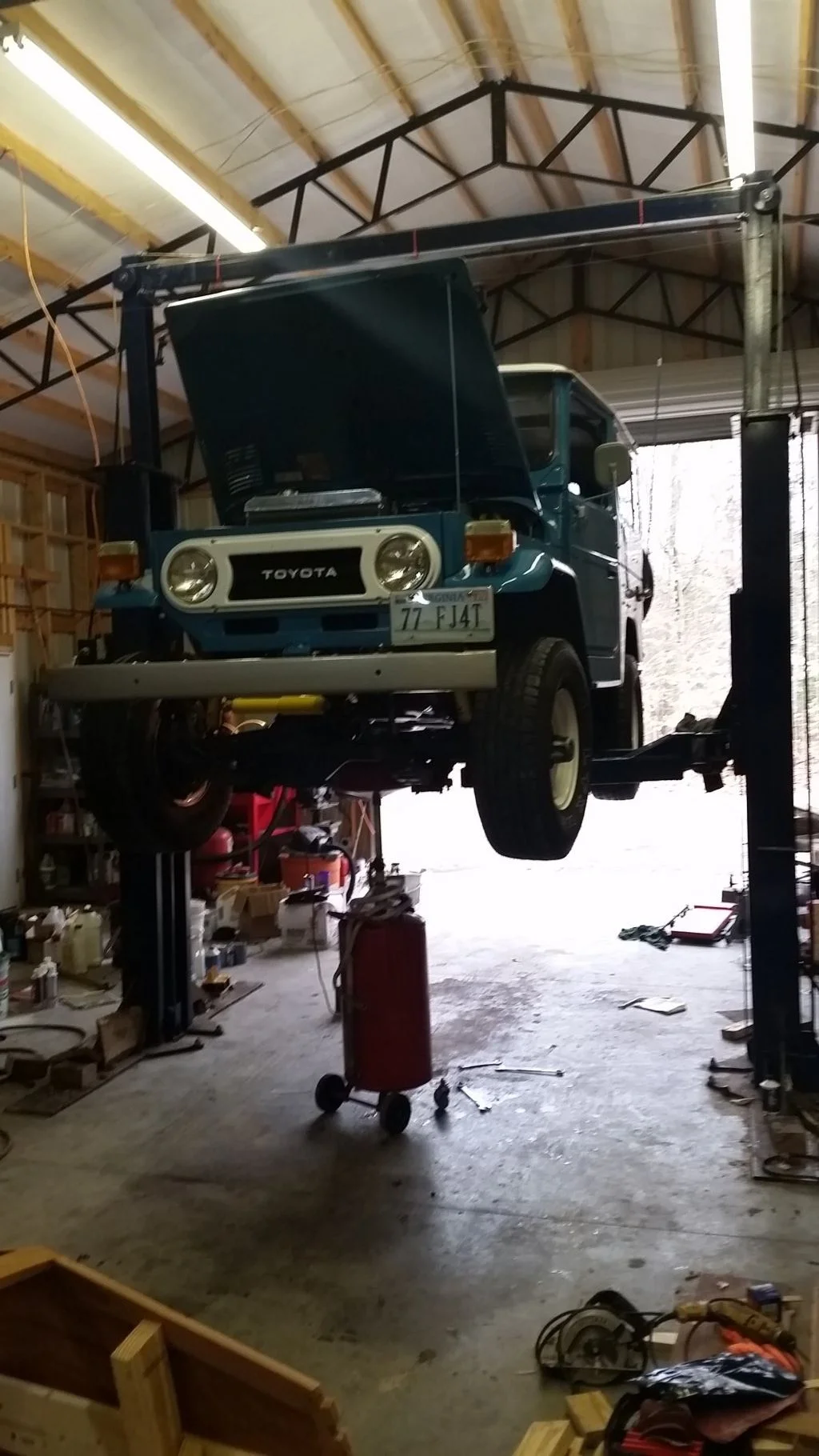

New shocks, FJ-60 power steering conversion, shims for caster, and new bushings
Spent another 3 hours unpacking the frame box and scraping the gunk off the transmission and transfer case.
Getting close to being finished under here.
Terrible job.

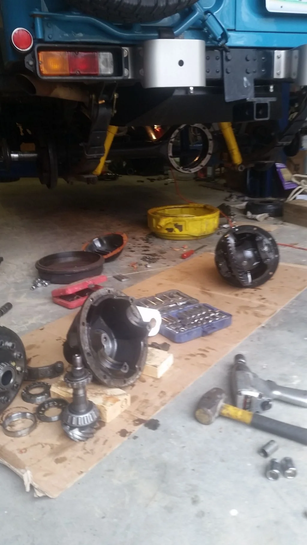

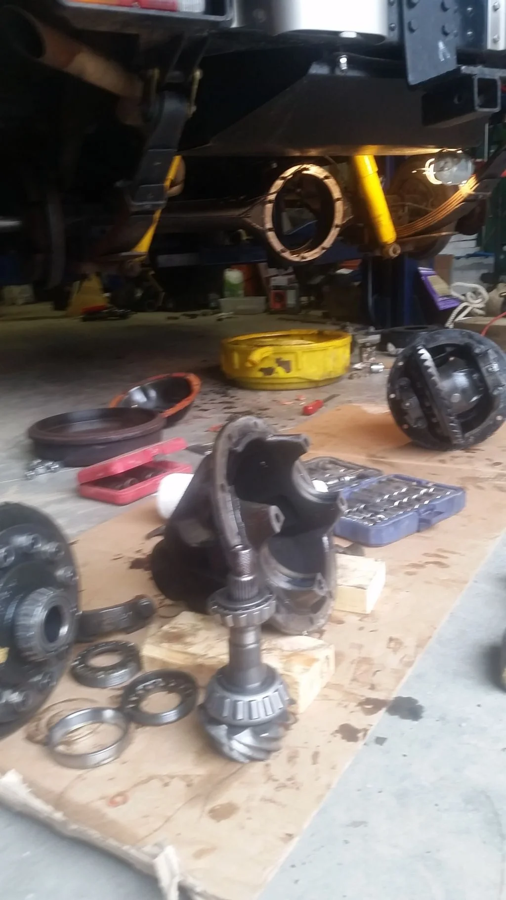

Simply added a Speedi-Sleeve for a slow 3rd member pinion drip.
Must not have reseated the pinion correctly. The cotter pin went into the castle nut in the same spot.
Backed off the ramps and boom.
Hero to zero in 30 minutes.
Gotta go dig a 3rd member out of
A parts truck. Bummer.
Oh Yeah, swapped back to the 4.11 diff. Was hearing a whine when slowing down. The 3.70 diff main pinion bearing was failing. Noticed this when I disassembled. So, went back to 4.11 diff I had. I think I like having the 4.11 gearing. Might swap the front back to 4.11 instead of fixing the 3.70.
