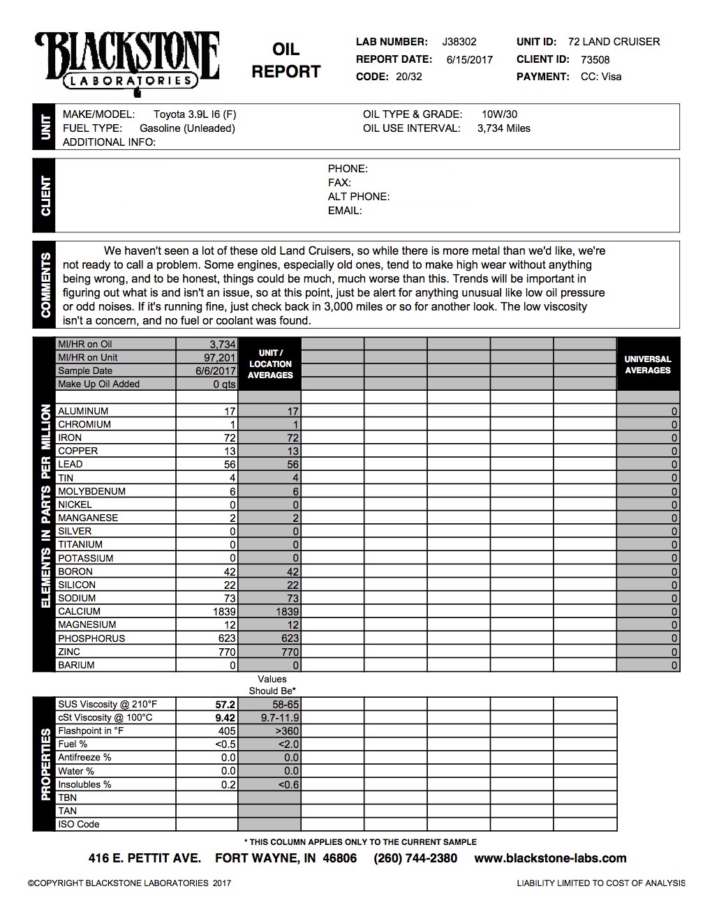

Changed the oil using Valvoline VR1 20w-50 and a Mobile1 M1-301. Captured a sample of the old oil to send off to Blackstone Labs for a health check of the engine.
Got the oil report today - with no background on the engine, I'm pleased overall - I'll keep doing these on the FJ40 as it's cheap insurance, imo.
