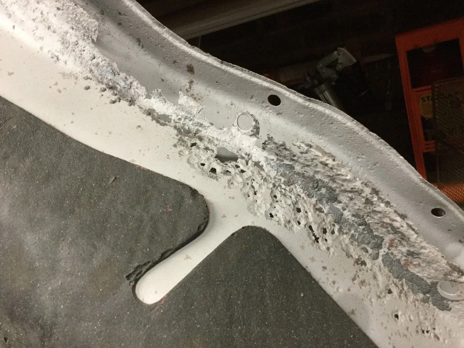

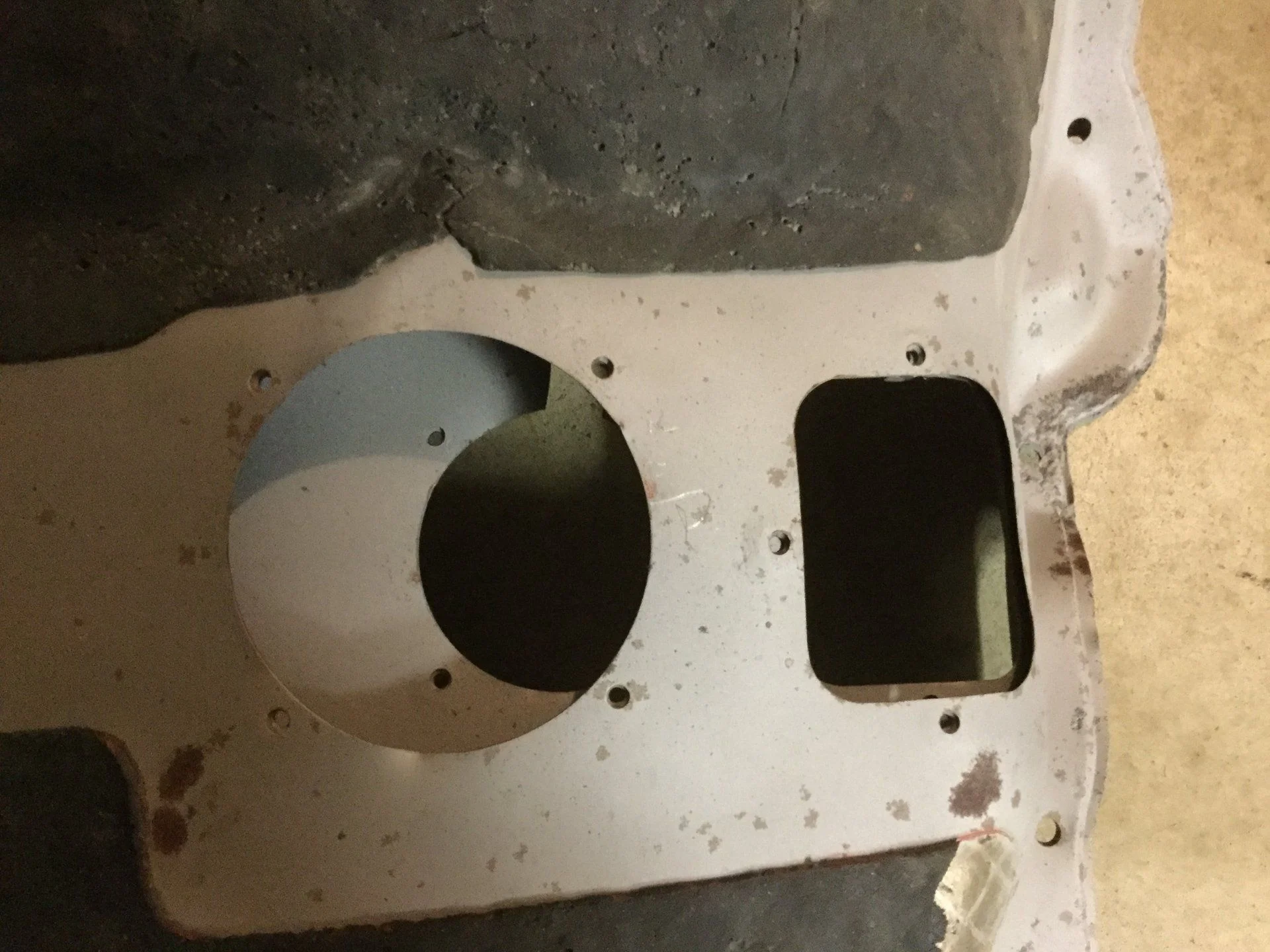

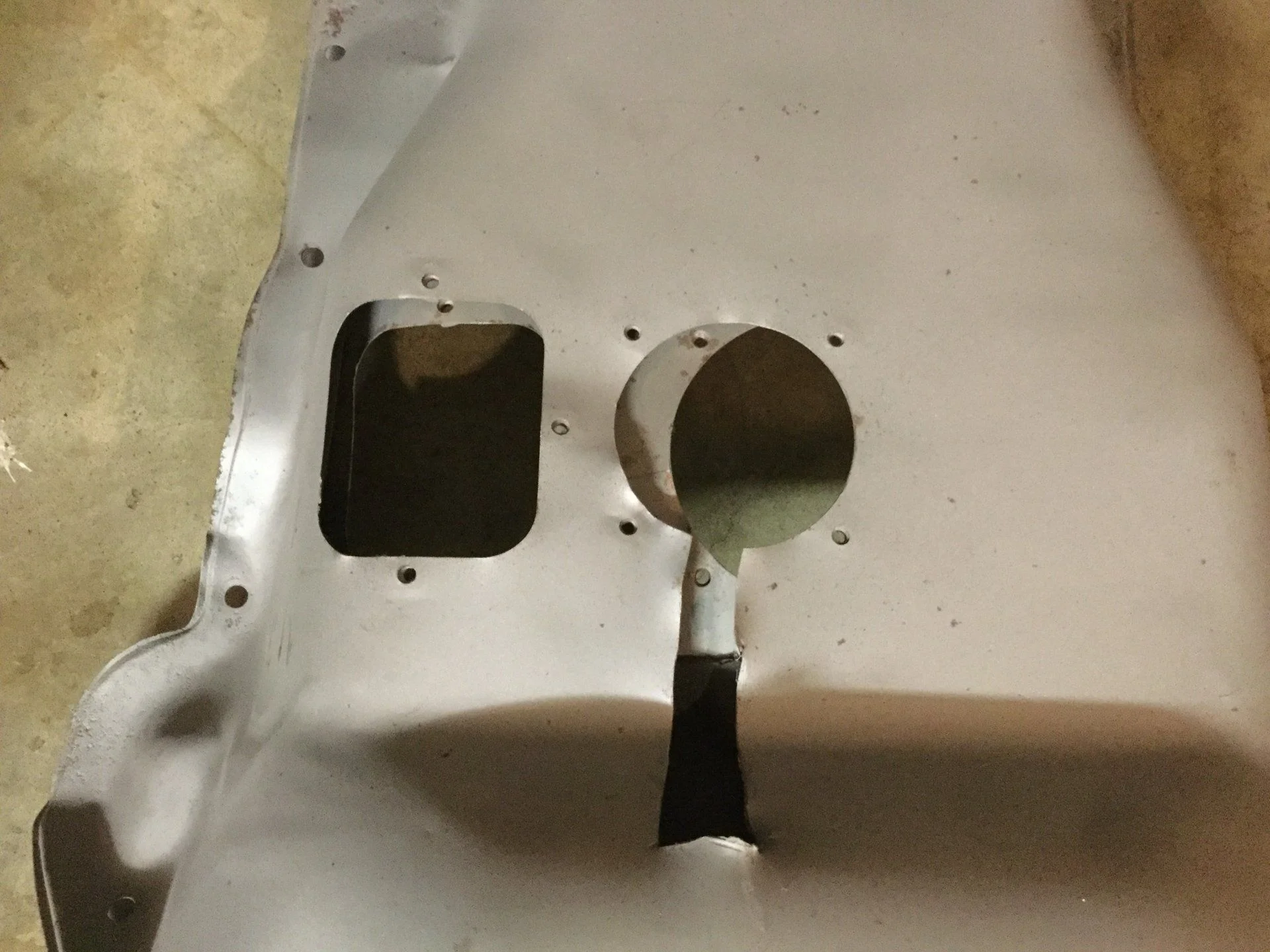

Got the top side of the trans hump as good as its going to get, by no means perfect but better.
From this...
To this...
This side looks better
Finished repairing tranny hump one side was pretty rotten
filled in the cowl vent drains, as that will be sealed up
tried all kinds of stuff to clean off the cooked on under coating, bug and tar remover worked the best maybe the kids wont bend it

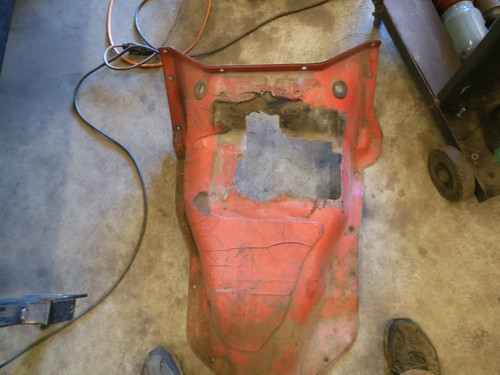

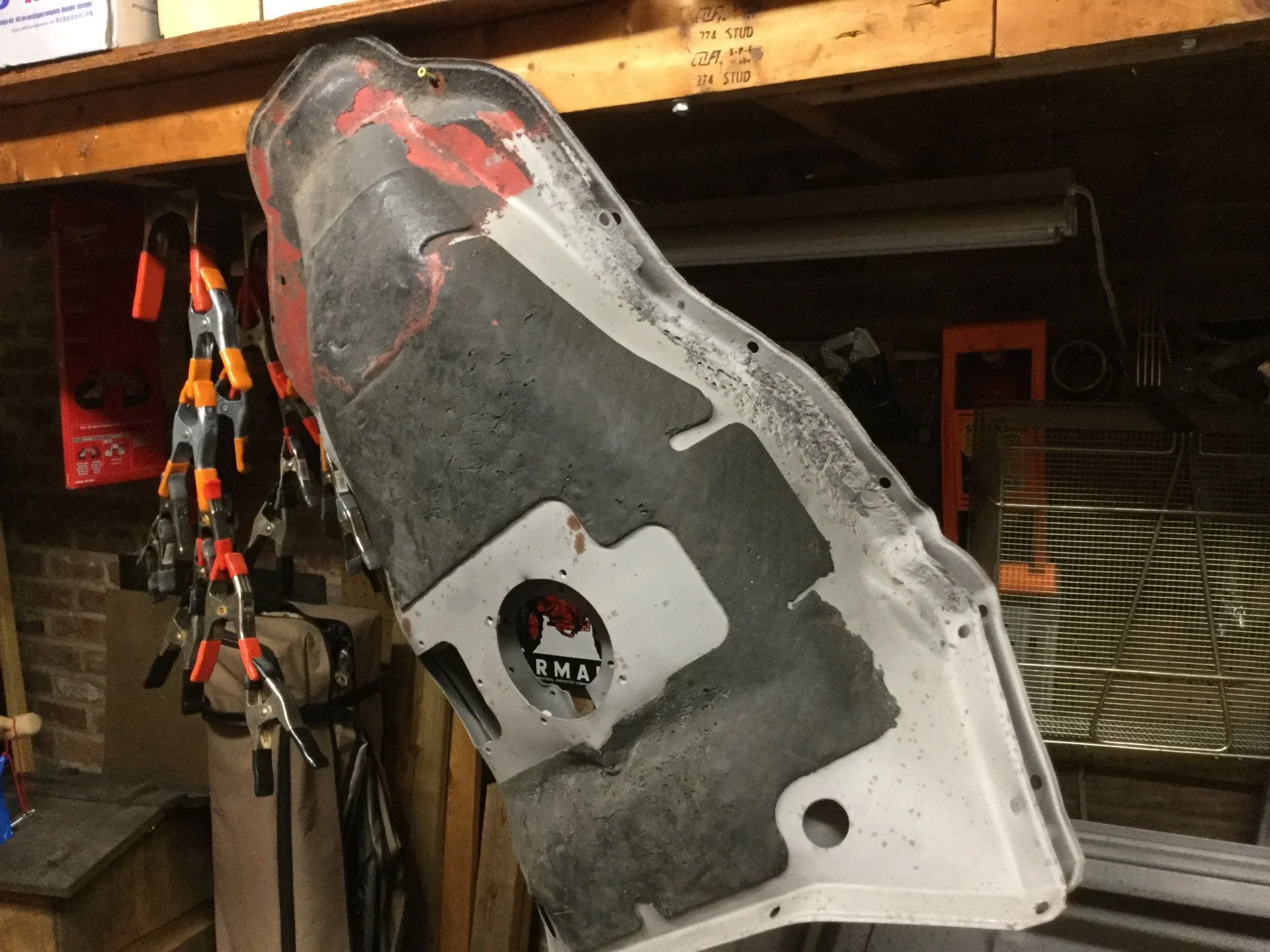

Nice work. I have to do the same but my two candidates each share some weaknesses. It'll be a FrankenHump. One must be a 3 speed, and one a 4 based on the size differences in the holes.
View attachment 1454173 View attachment 1454174 View attachment 1454175 View attachment 1454176
That ought to come out good, metal doesn't look to be stretched. You'll have her good to go in no time.
Are you going to use the flange off the 3 speed to repair the 4 speed hump or put the center section off the 4 speed on the 3 speed?
I'm thinking put the center of the 4 speed onto the 3 speed. Lots less cutting and welding.
From this...View attachment 1454145
To this...View attachment 1454146
This side looks betterView attachment 1454147
