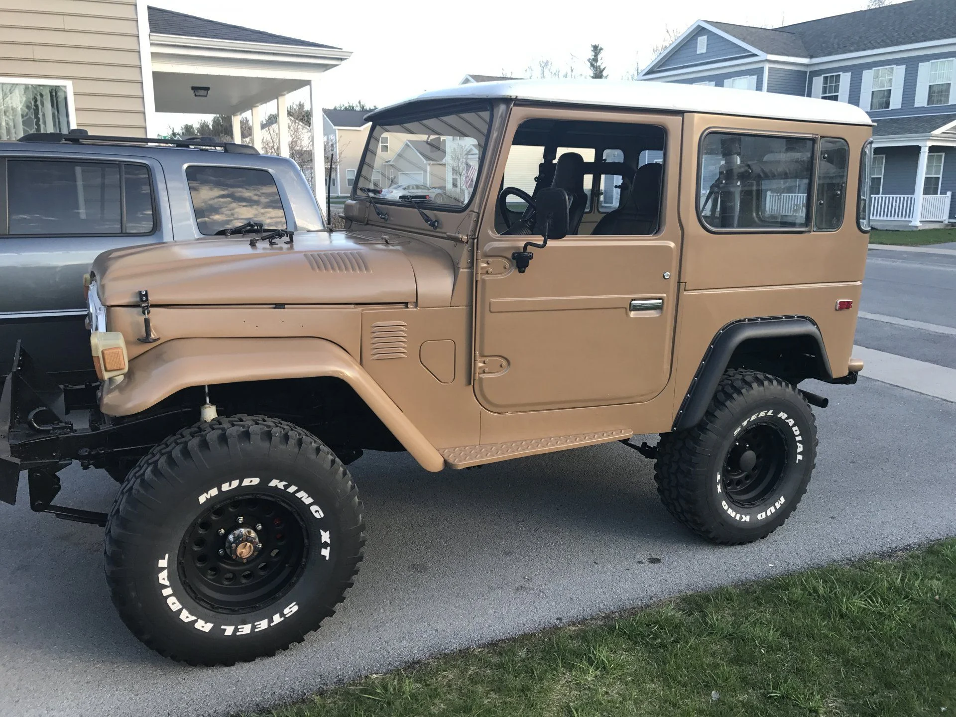

@imyahucklbrry I used Rustoleum Gloss Enamel Smoke Grey for the wheels. Came out great. Was going to use a darker color but when a mud member posted up a pick of a stock extra wheel he had put away out of the sun for probably thirty years the OEM color looked lighter than what I had originally planned on using. I think this color is closer to what the original was.

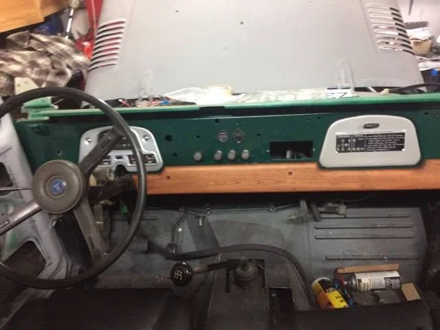

almost finish my interior for the 45
The dash piece does look very good. White Oak would make a very good wood for use in a LC that might get wet inside. Walnut is another good choice as is mahogany, either African variety like Khaya or Sapele. The wood makes the dash look very fancy.

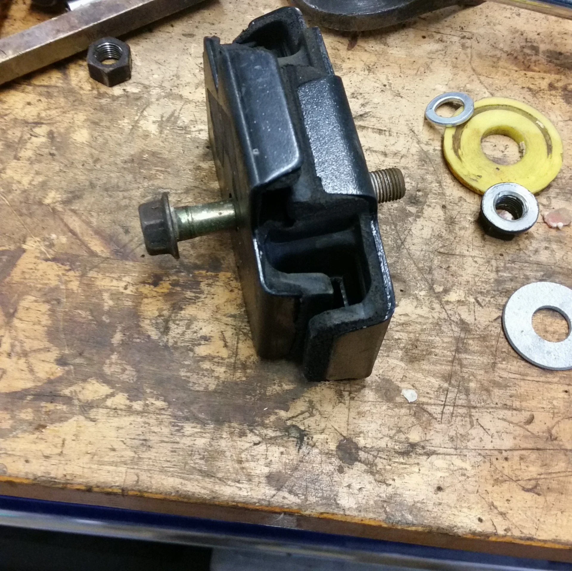

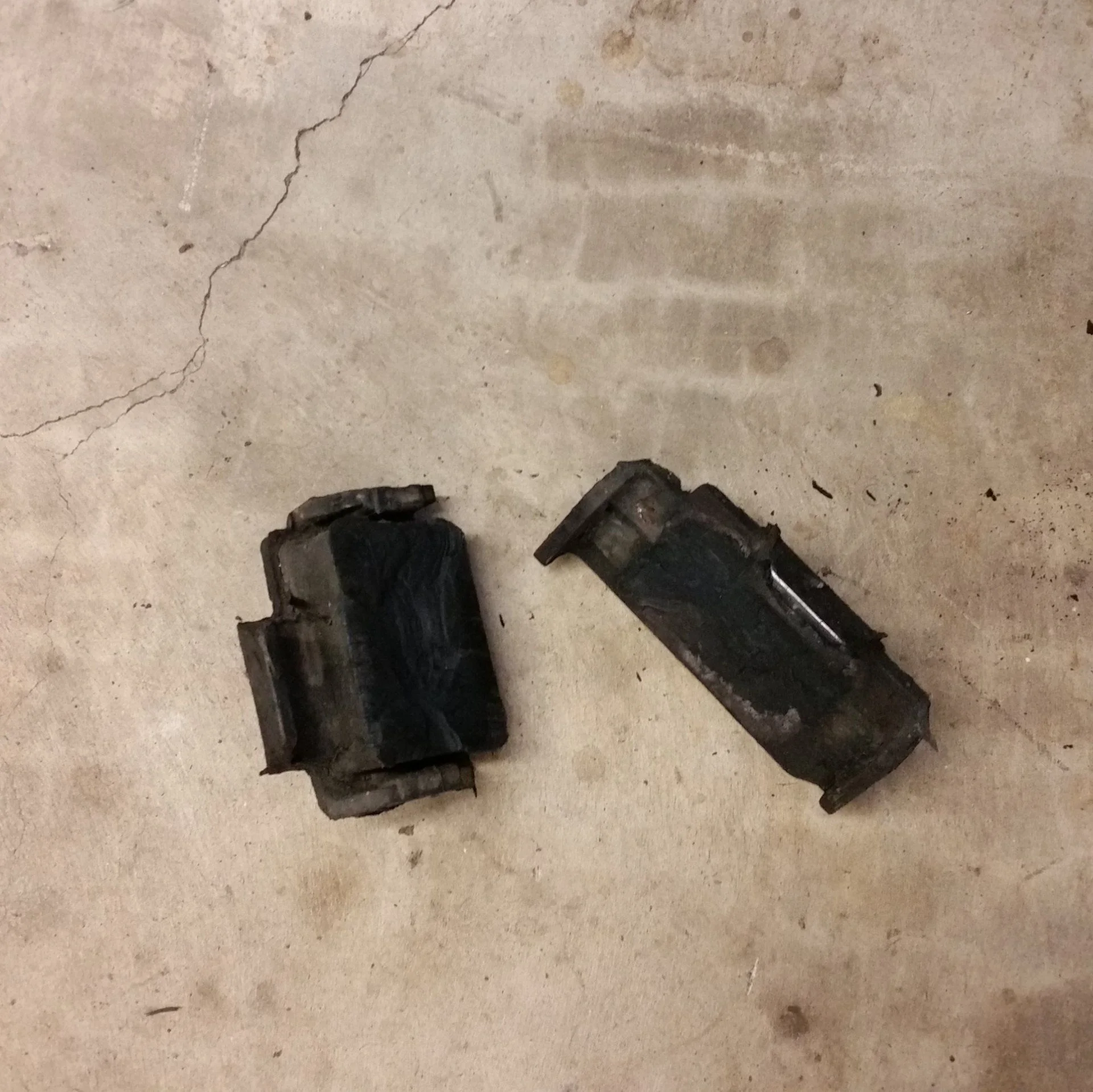

Replaced my almost 36 year old front motor mounts with ones from @cruiseroutfit .
We suspected the DS was toast... suspicion confirmed.
We drilled the DS mount for a bolt and used a ear from a poly spring bushing to allow for some flex.

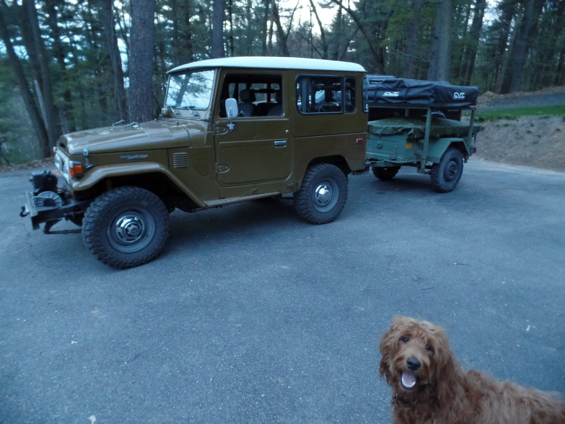

Took my Canadian M101 for a test run behind my new 40 tonight. Pulled it like it wasn't there. My 80 is going to be peeved but I think my 40 is getting the nod for the first camping run of the year!
Appears doggy approves this message...Lol

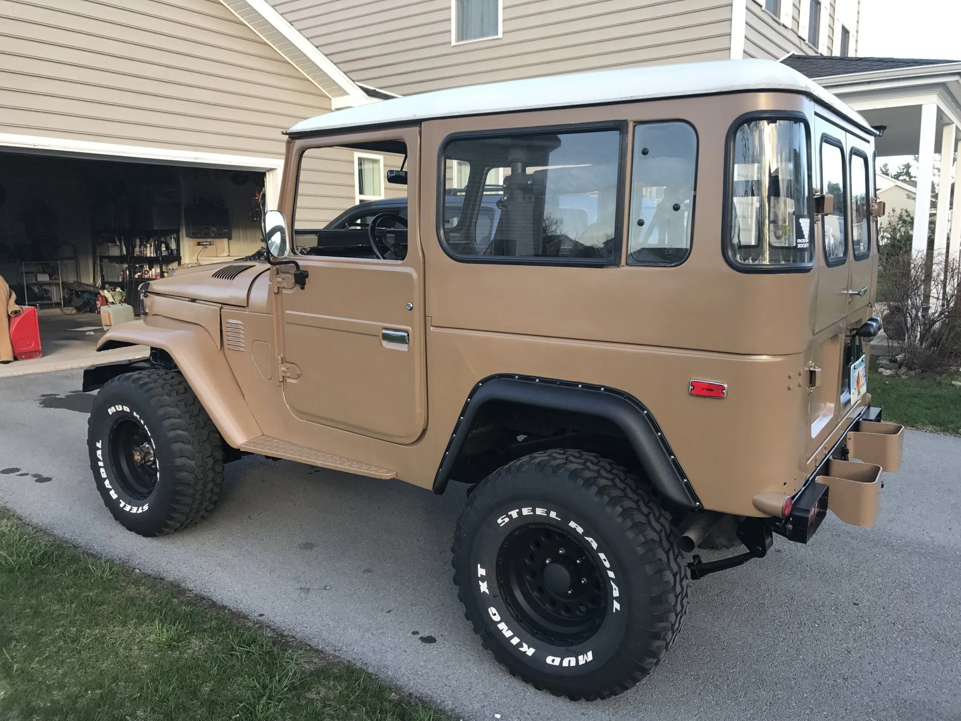

Been a while since I have been on here but figured this was worth posting. Finished my rattle can paint job! Sanded down all the rust from it being in upstate New York primed and painted. Now all I have to do when rust peeks through is sand it and throw more of my paint on it. I have about ten cans left over:)
