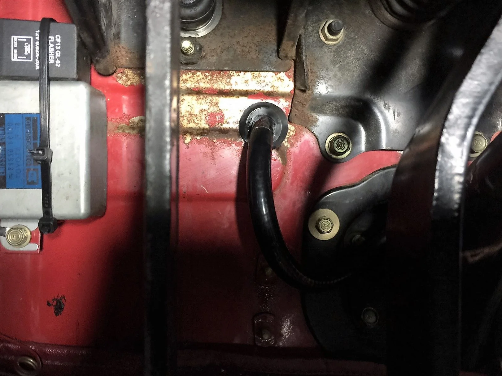

Drilled hole for lock cable
full

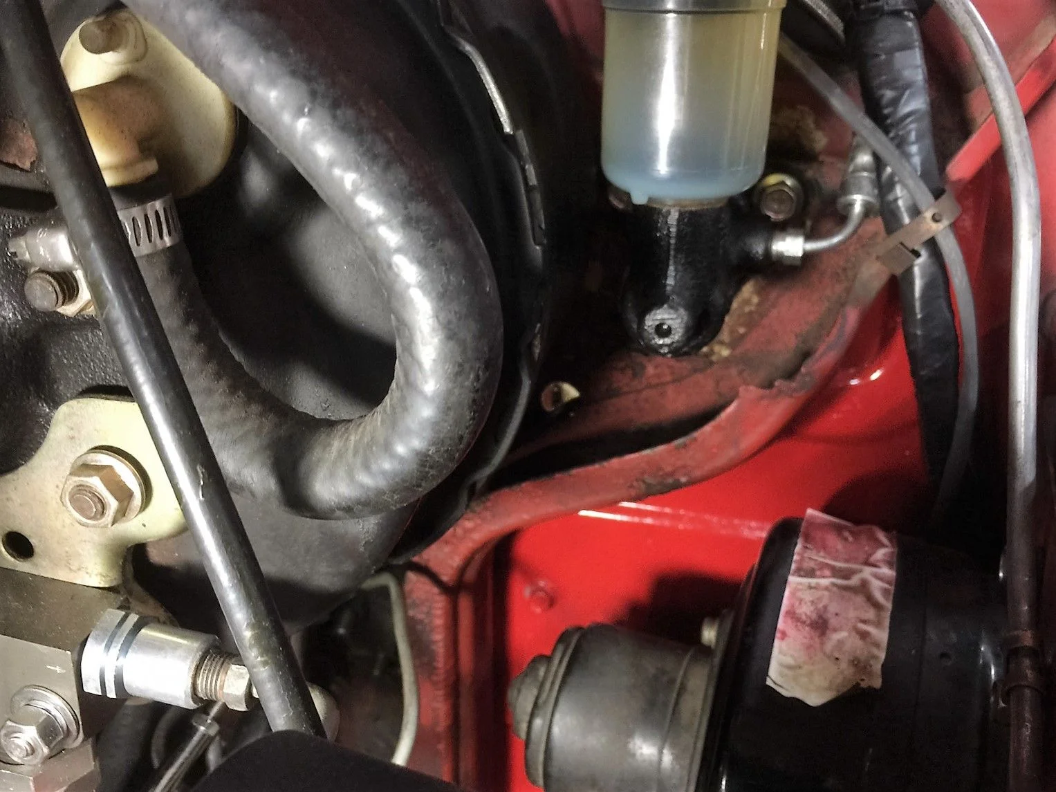

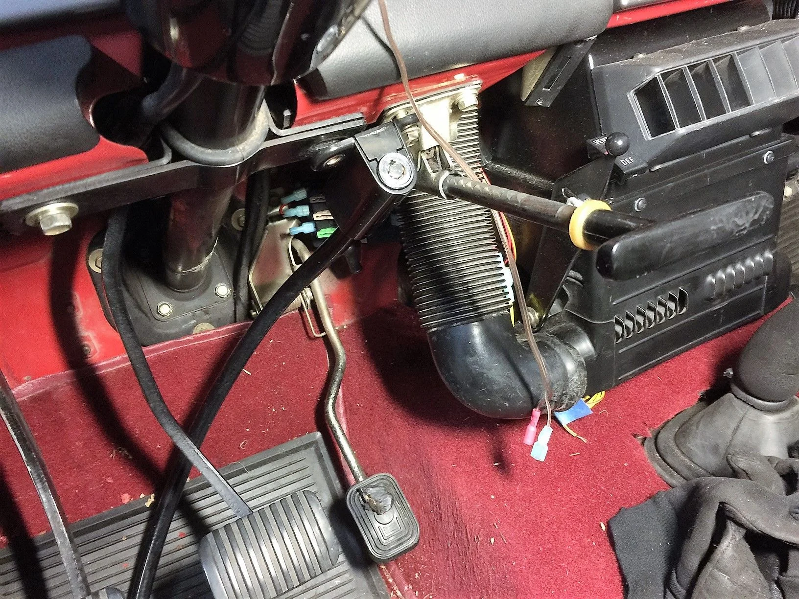

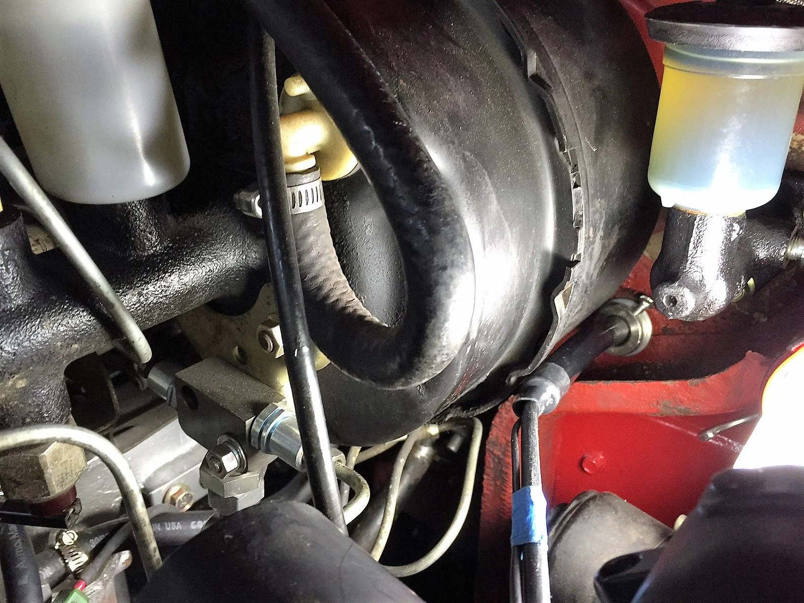

Installed cable
full
full
Installed rubber grommet to protect cable
full
full
full

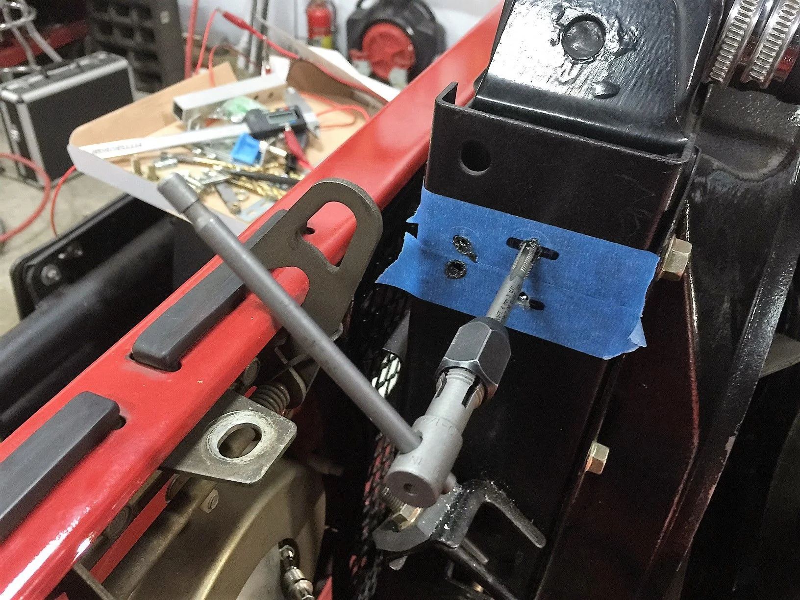

Tapped radiator frame to secure lock striker
full
Lock striker installed
full
full

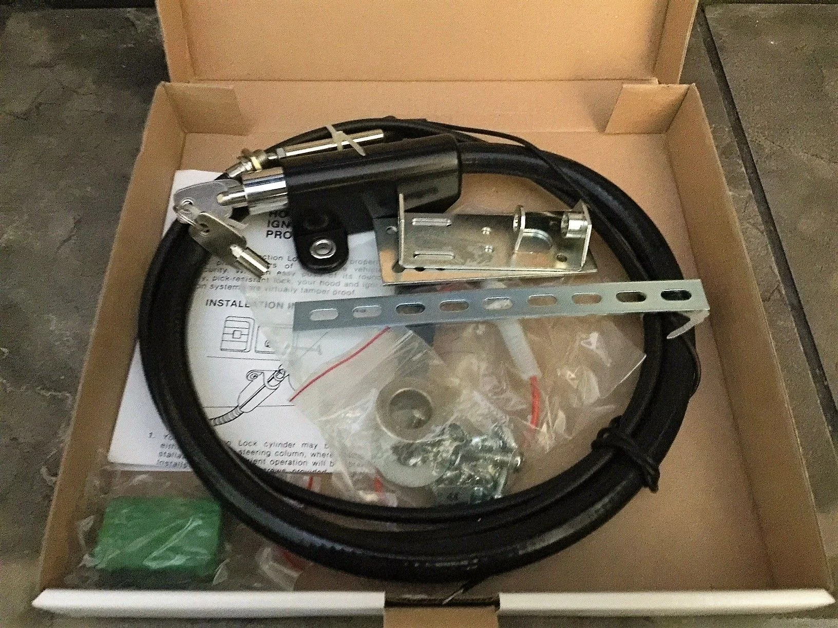

Does anything need to be mounted to the hood? Or does that pin go where there is the lip on the hood? What does the control end look like? I like that setup! Please share details. Thanks!
The striker pin locks on to the hood lip just like the OEM latch but it firmly secures the hood in place. It's a great theft deterrent and impossible to defeat. It also disables the ignition circuit.
Amazon.com: Megatronix - HL6 - 6 Foot Mechanical Hood Lock Cable With Ignition Interrupt: Automotive
Here's what the business end looks like:
