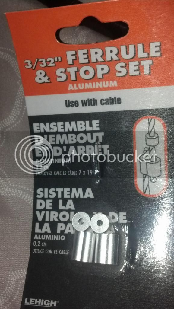

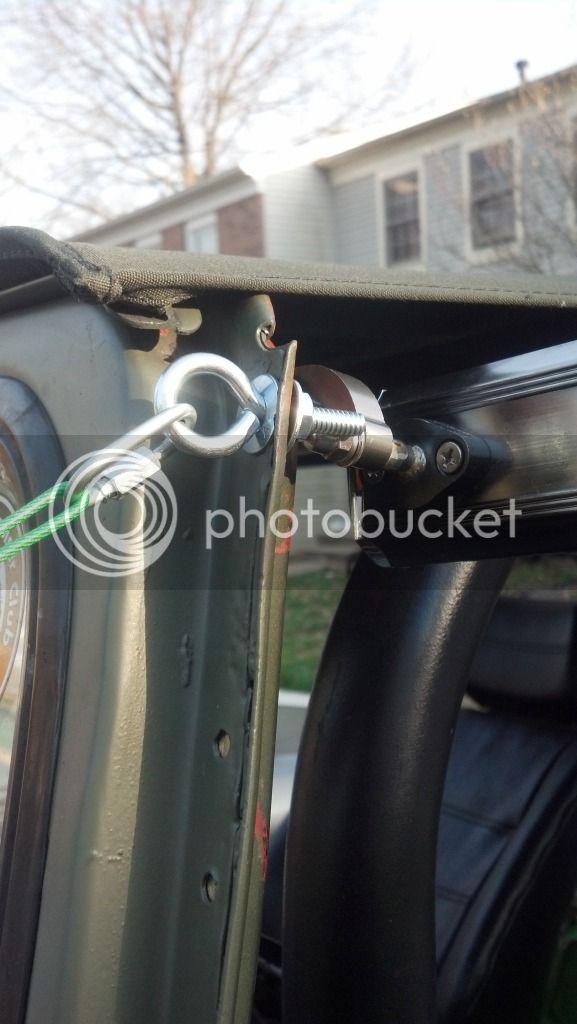

Added some brush wires to help keep my windshield in one piece and help counter the bikini top from pulling the windshield back and forth at highway speeds.
1/16" plastic coated cable. If you can't tell I dig the green and it helps on visibility.
I used 1/4" eye hooks on the brush guard and used the windshield/hardtop holes.
Four screw removable links, two 3/8" turnbuckles, and a couple 3/36" ferrule and stop sets. I used the 3/36" instead of the 1/16" to account for the plastic jacket thickness. I used lineman pliers to crimp. Good enough for this type of connection. The removable links have a breaking strength less than the cable and hardware and are intended to break before the other components break. I intend to add another set of cables redundantly attaching the turnbuckles to the brush guard to prevent projectiles.
the drivers side cable ended up being a little too long and I've maxed out the turnbuckle adjustment. Cable is under decent tension so i'm not concerned. This cable may get shortened in the future.
