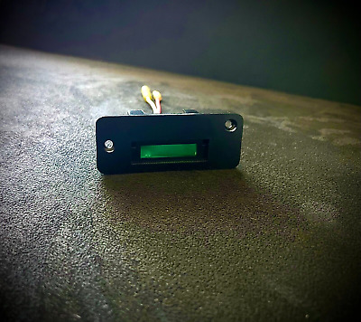

you are apparently missing the dash light that illuminates from the underside of the dash pad “lip”Install a "new" cluster. Mix my 1976 with 1980.
I don't want to spend time figuring out how to connect +/-50 Amp on the 76 model.
Is this the only dash light I will have at night?... Hmm
My dashpad doesn't have a "cut" for this light. It has two wires coming out to connect it. I have tested them.you are apparently missing the dash light that illuminates from the underside of the dash pad “lip”
Toyota Land Cruiser Upper Heater Control Light FJ40, BJ40 BJ42 FJ43 FJ45 HJ47 | 8193020011 | Green | Interior Lighting | Dash | 12 V | OE
Fits all 40 series Land Cruisers with upper dash pad 1972-84. The Dash light is installed inside the upper dash pad right above the center to light up the dash switches. 02/1976-06/1980 FJ40LV-KCJA USA ,VAN ,2F ,4F ,VKC ,RB 83-02 83-02.www.ebay.com
I thinking of fabricating some "external" light there.
@SergP I would like to see what solution you come up with for interior illumination. Ours is a 1970 with no provision for dash lighting other than the instrument cluster. Driving these things at night is interesting. I've learned that it is best to set whatever you want set before beginning the dark journey with a small pinlight flashlight in my teeth for any needed midtrip adjustments.My dashpad doesn't have a "cut" for this light. It has two wires coming out to connect it. I have tested them.
How did you bolt it to the pad?I cut my dash pad with an exacto knife to insert the light. It cut easier than I expected.

You could glue a piece of sheet metal with two holes drilled in it through the pad to surface screw the light onto after you cut a rectangular hole.How did you bolt it to the pad?
