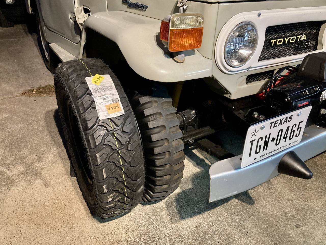

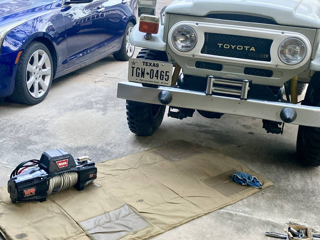

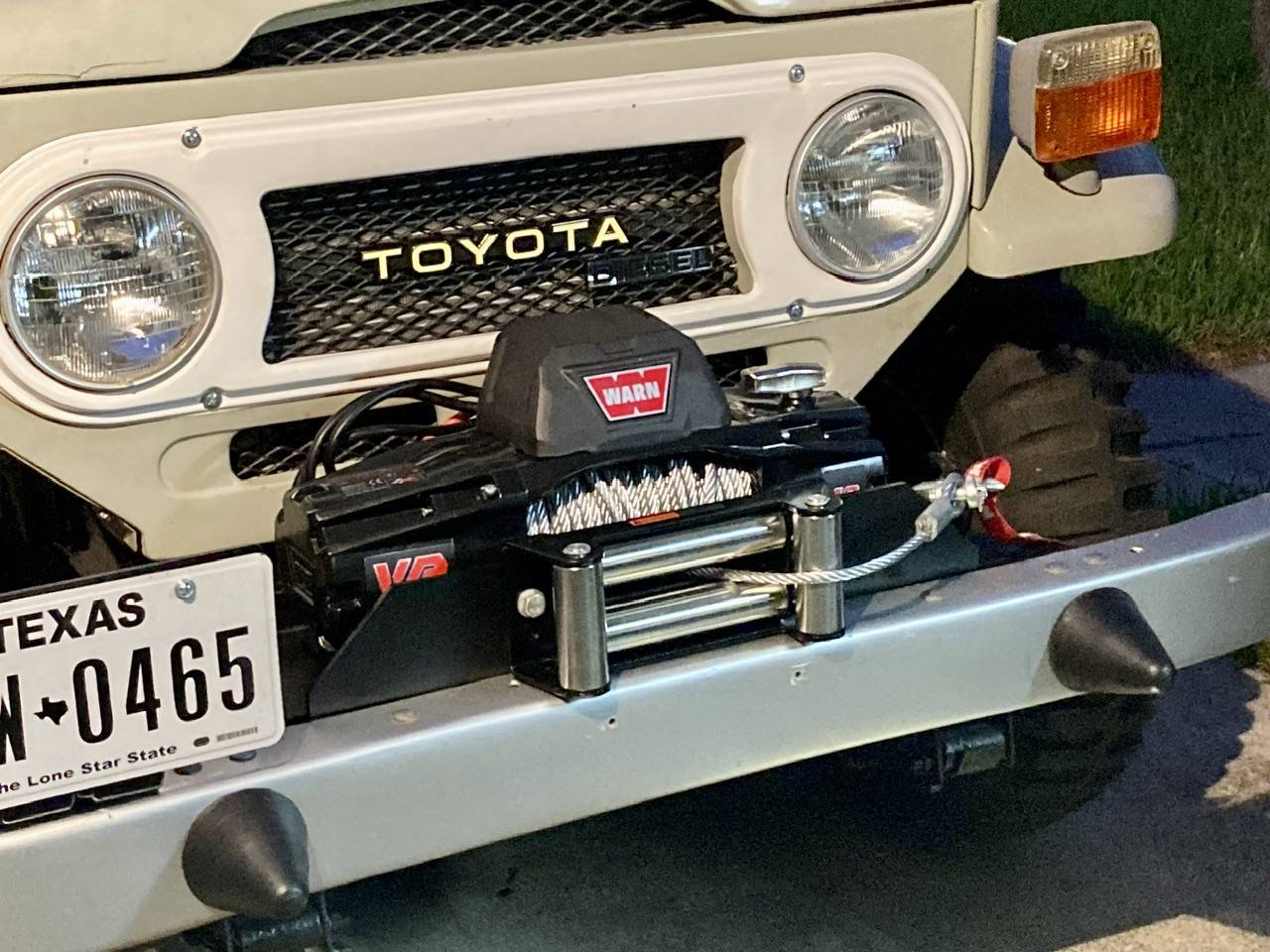

The mounting plate arrived late yesterday so I installed the winch when I got home. Removing the tow hooks was a bi-atch.!! I don't think they'd ever been taken off! The CCOT mounting plate is stout piece of metal and was a precise fit for the frame and the winch.
All in all the install took about 2 hours. Didn't have time to connect the cables, will do that this weekend.
Oh yeah, I also bought her a nice set of Stilettos. (235/85/R16) :) I'll get them mounted tomorrow.
Very nice. I wonder if this plate will work with a Saginaw steering box
