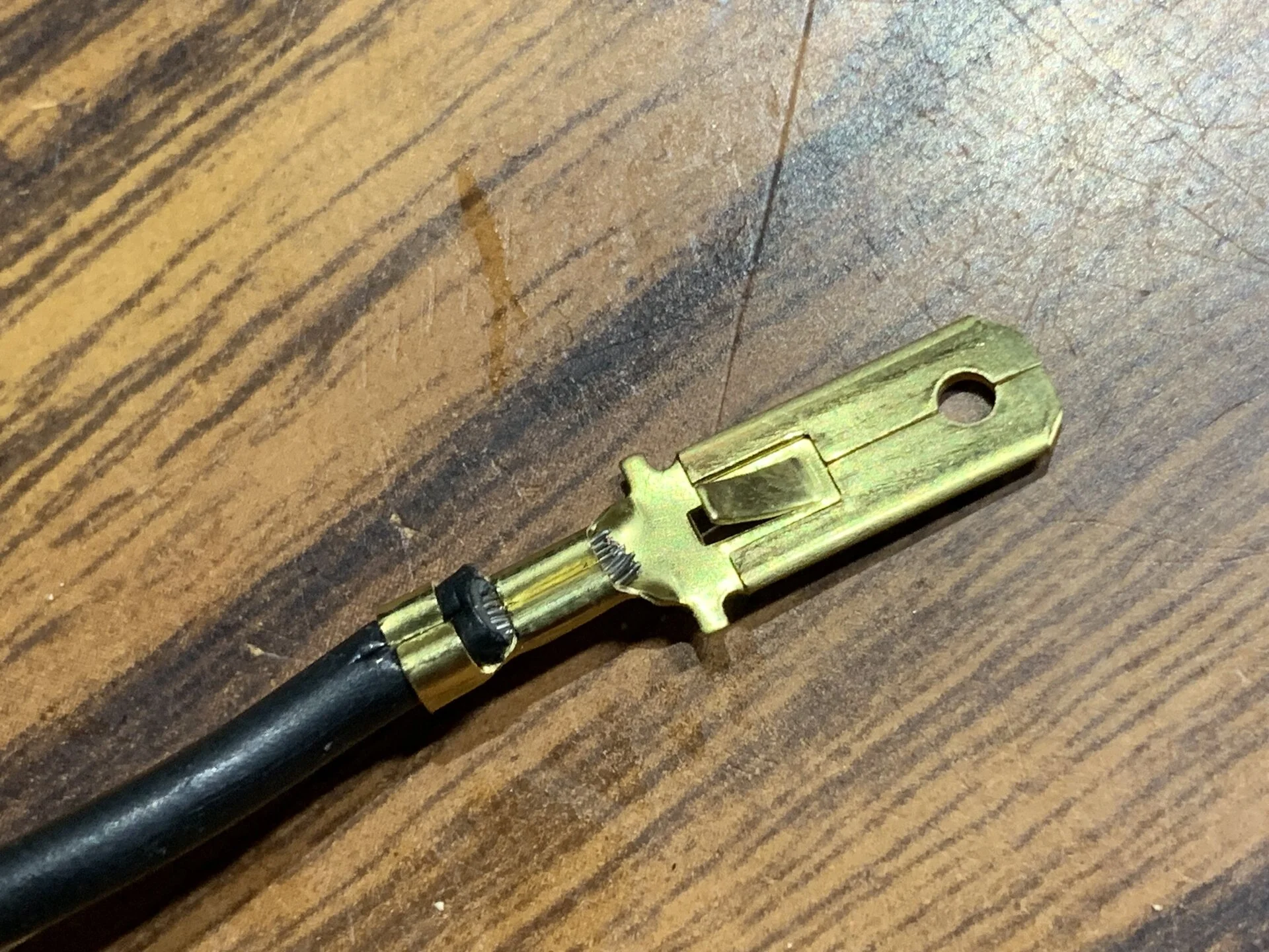

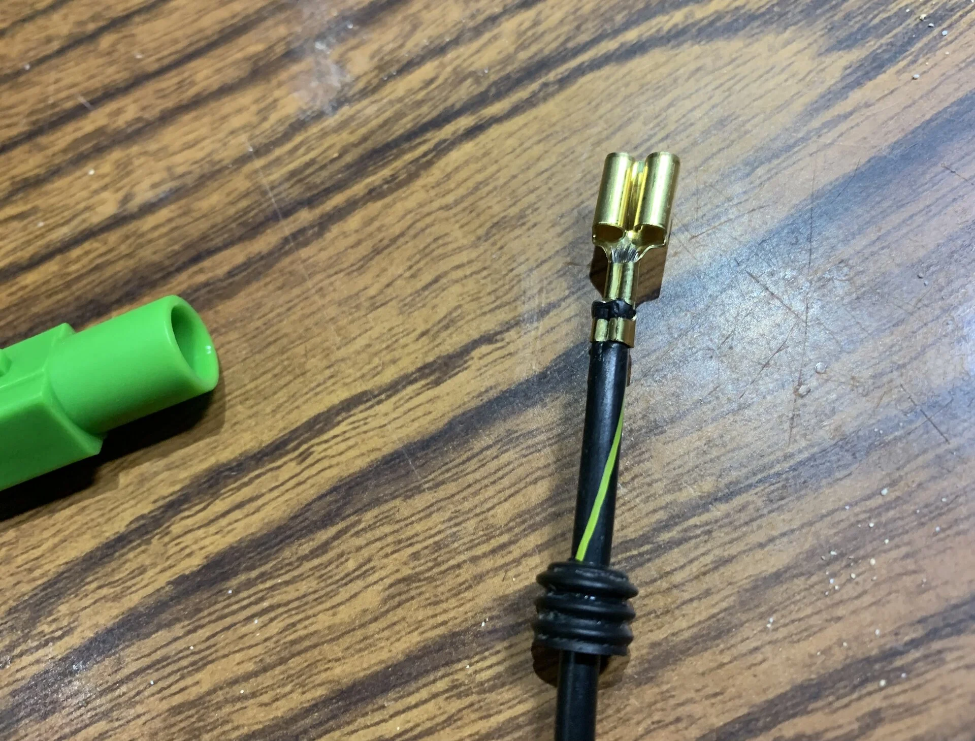

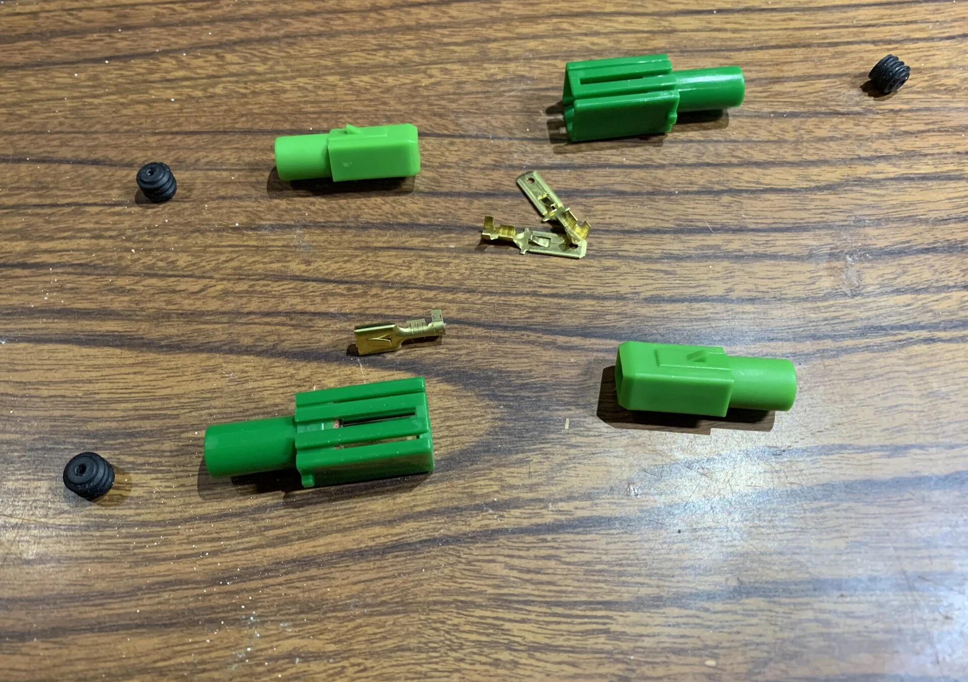

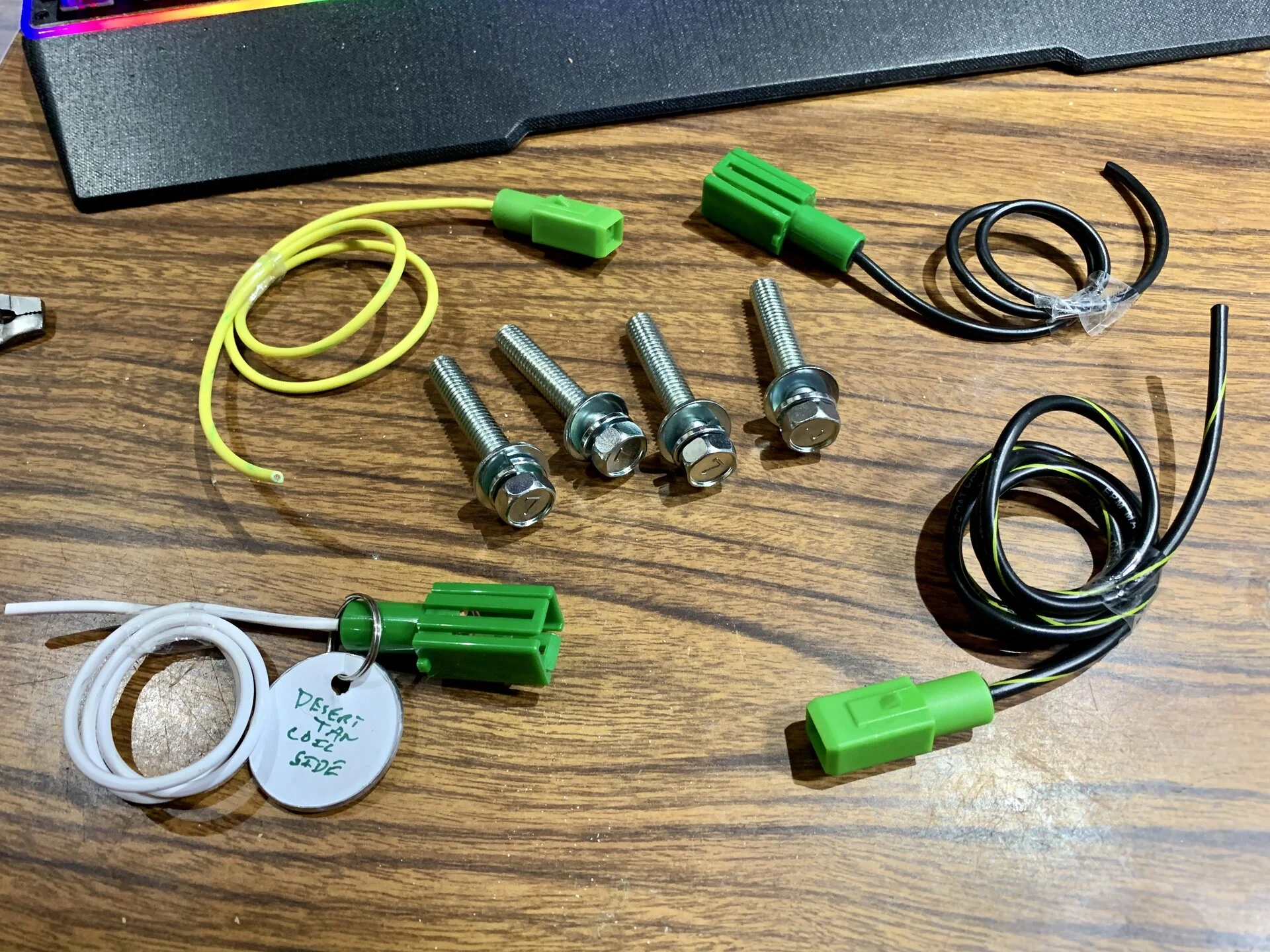

Are those for the idle solenoid on the 40?
good question .........
these particular OEM connector housings / profiles were used in various engine bay applications and a few non-engine bay ones too , there a first generation attempt at a water proof or splash proof design , and other then having a ODD tandem type release tabs system to un-lock them apart , which often snaps and breaks after some age and time a good over all weather proof type design in all ....
here is a list of where there incorporated , and they were NOT always green either , natural white , black , blue i have seen before too
- carb fan to thermo sensor manifold
- YES , ICS or fuel cut solenoid single wire type
- ignition coil / igniter on fender mounted location
- carburetor air horns
- a extension cord sub harness on the fuel tank sending unit
- a extension cord sub harness for the cylinder head coolant temp senders gauge and thermo smog one ,
- the tandem brake master cylinder's 2 fluid level sensors to the drivers fender
- early points style 2F MED cap distributers main RED WIRE connection point
- just a few of the ones i can recall now off top of my head , im sure i missed a few
- the FJ40 , FJ55 and FJ60 2F era all utilized these in some way at some point 1/75-9/87 , not sure about a FJ62 but it would not surprise me ....

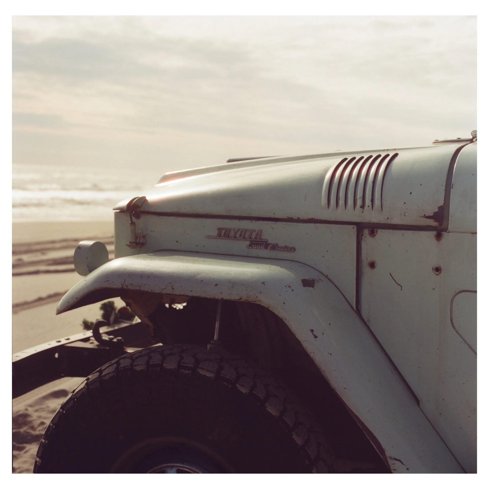

I did the rear sill on my fj40 this weekend. A few mistakes were made but I can live with them. I am going to paint tomorow and will post some pictures. For now here are some photos of my fj40 that I shot with my hasselblad on the beach last weekend.

Nice shots and better looking cruiser.
I love how this thread is partially turning into a photography gallery. Motivation to get my kit back out.

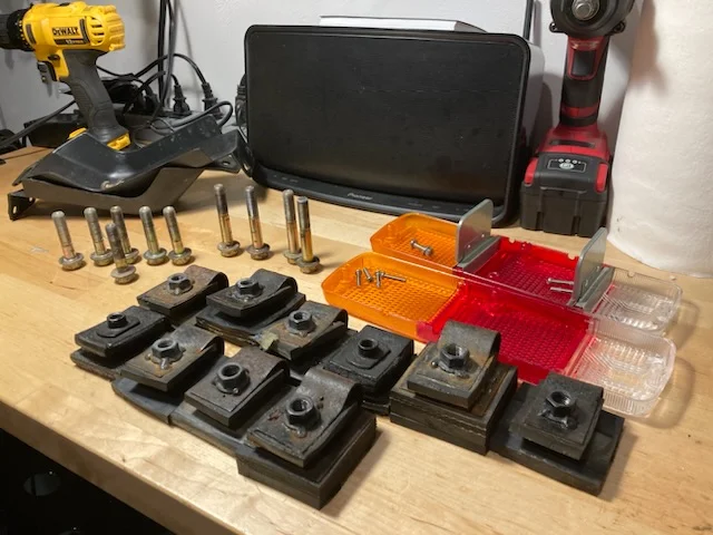

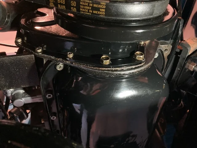

Discovered the two lower bolts on the timing gear cover are the source of small leak. (ordered parts to fix).
Then, Installed new Energy Suspension body mounts (two 2x4’s with blocks and jack..,don’t forget to unbolt the tub from the front fenders). My truck never had the mount that gets bolted down through rear floor…Need to deploy some precision measurement to blind drill to hopefully hit the bullseye in the frame mount hole to install my last two mount.
Love the square format of the Blads.
Kodak Portra?
I love the square format of them too. Plus no other camera really sounds like them. Making it fun to shoot. I was trying a new film called cinestill 400D. I think its just rebranded motion picture film though. still cool.
Have you noticed in drive with those new mounts? I hear poly can be squeaky
@Ackcruisers- If those are your old body mounts, they sure didn't look bad.
Yes! The truck was restored in 2019 so shows you what the ambient costal air does at corroding the mounts. I will say, the Energy Suspension mounts have a a softer polyurethane bushing. It is very noticeable when compared to the old ones which had no "give".
