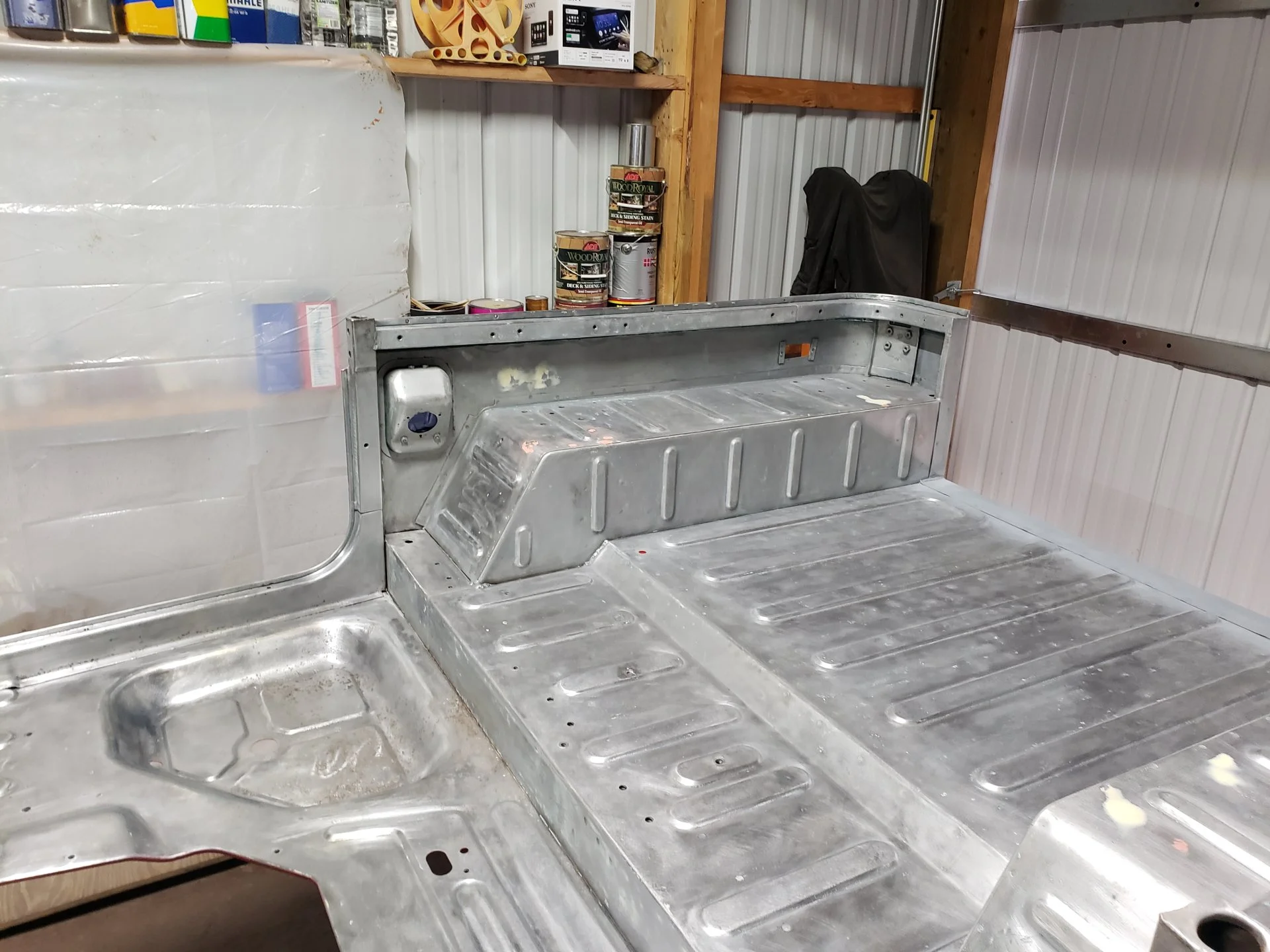

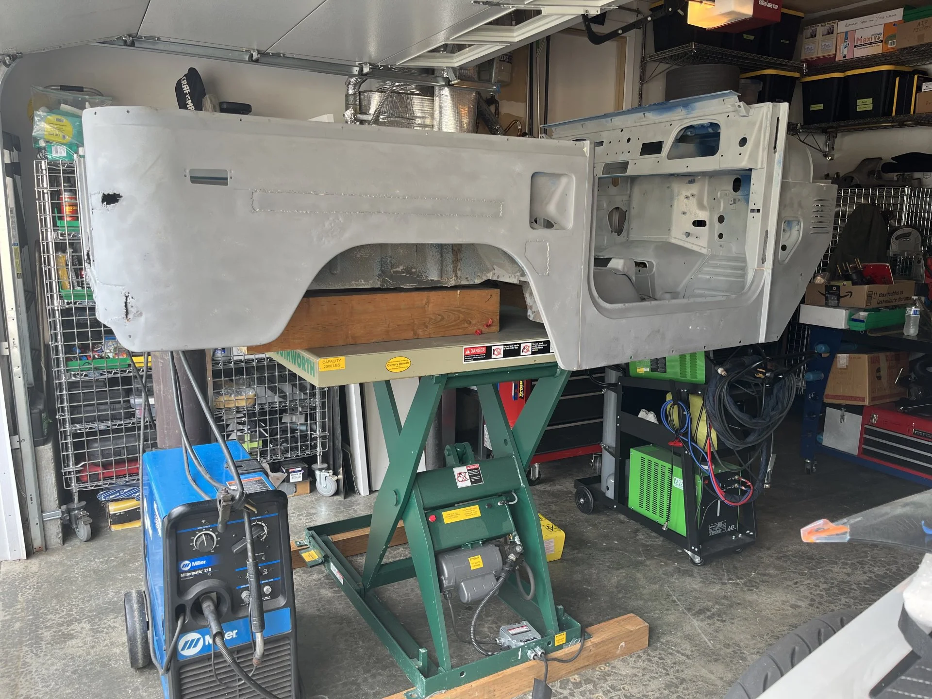

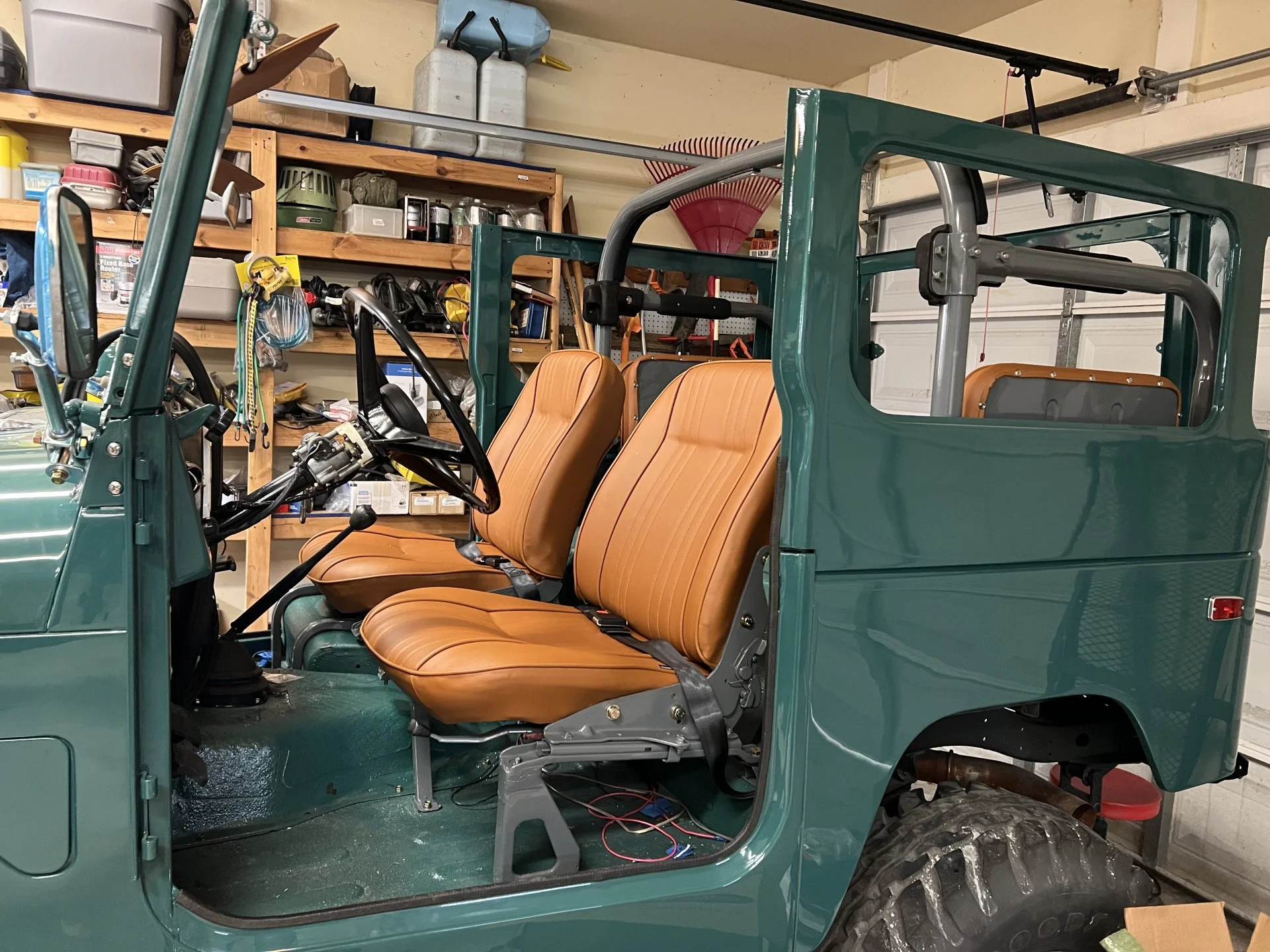

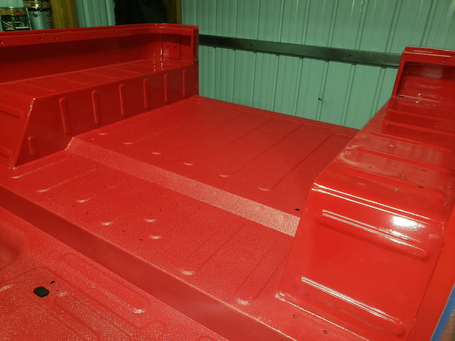

Got some paint on and the floor lined. Will paint the exterior in a couple days.

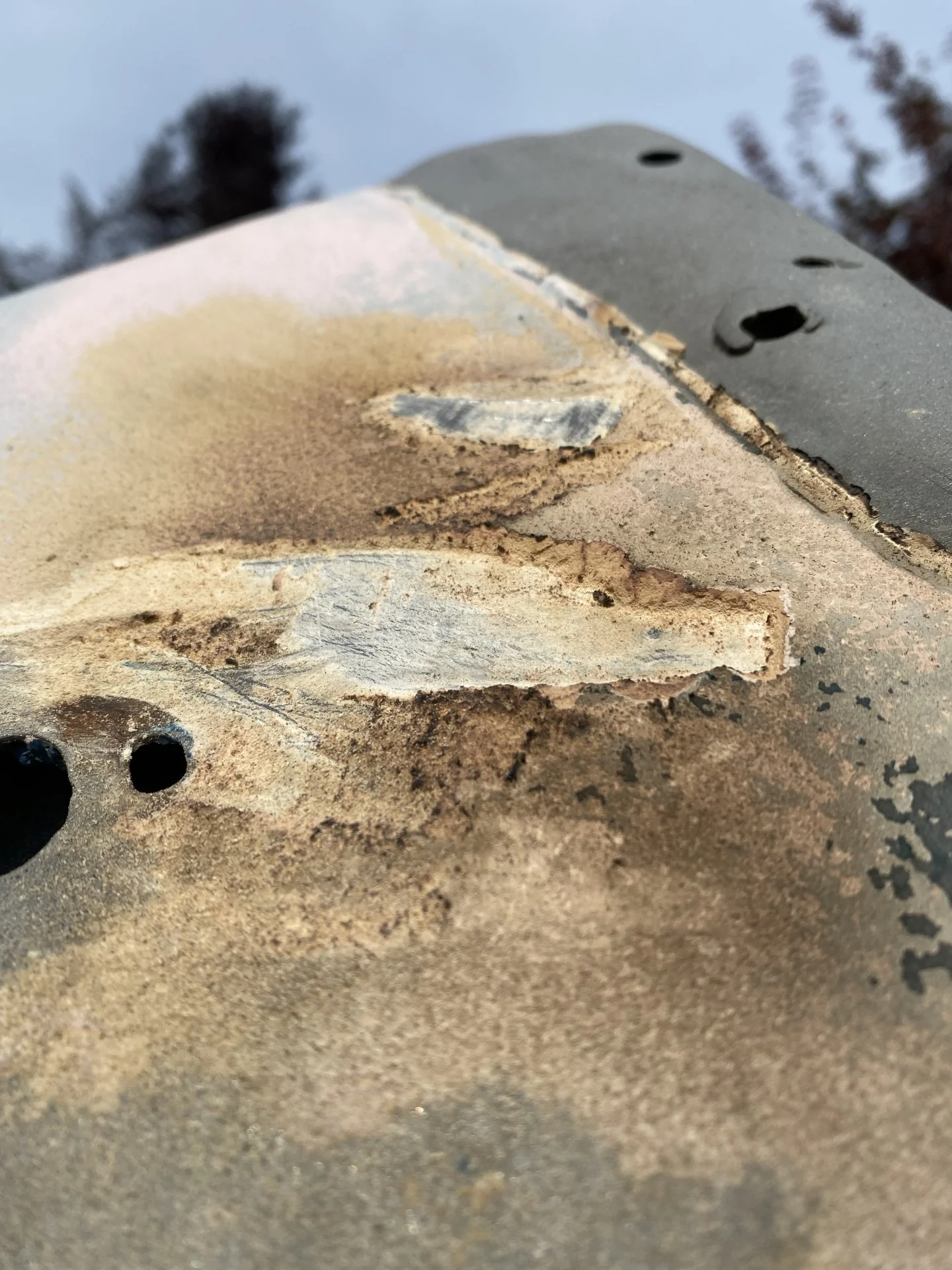

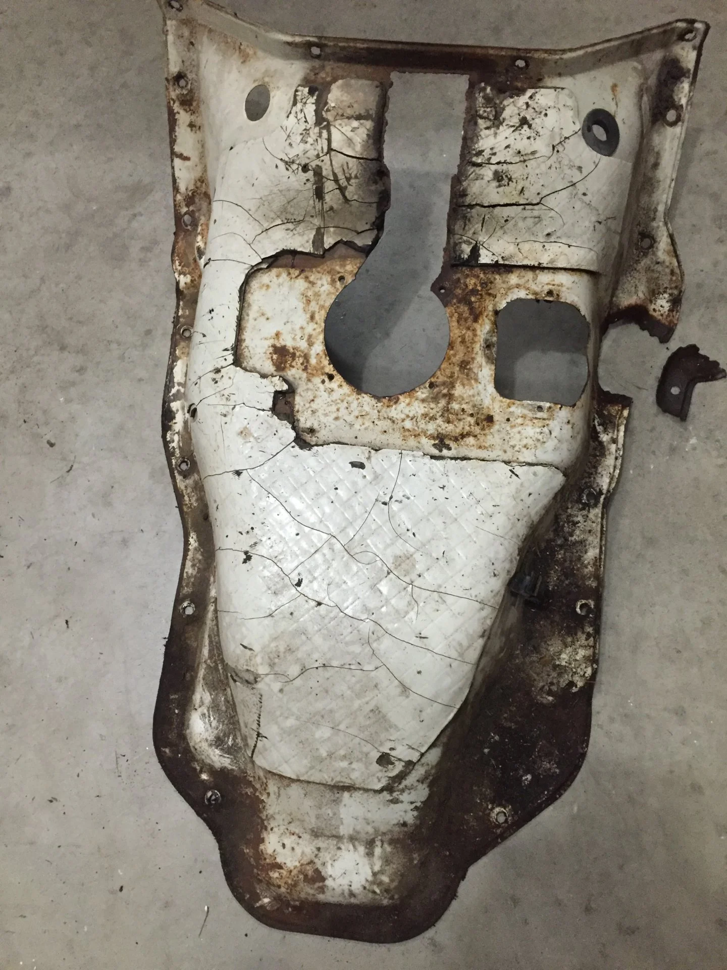

It could be worse... my PO had covered the rear tub in fiberglass without trying to do anything to control the rust. The thin layer of fiberglass did nothing but trap the water. When the garbage truck came by I folded the floor up by hand to fit it into the rear hopper. There was no point in trying to recycle it... there wasn't enough metal there to recycle. :D
One of my college professors said PHD was an acronym for Pilled Higher & Deeper. Unfortunately too many POs have applied a PHD approach to Bondo work... I hate it.

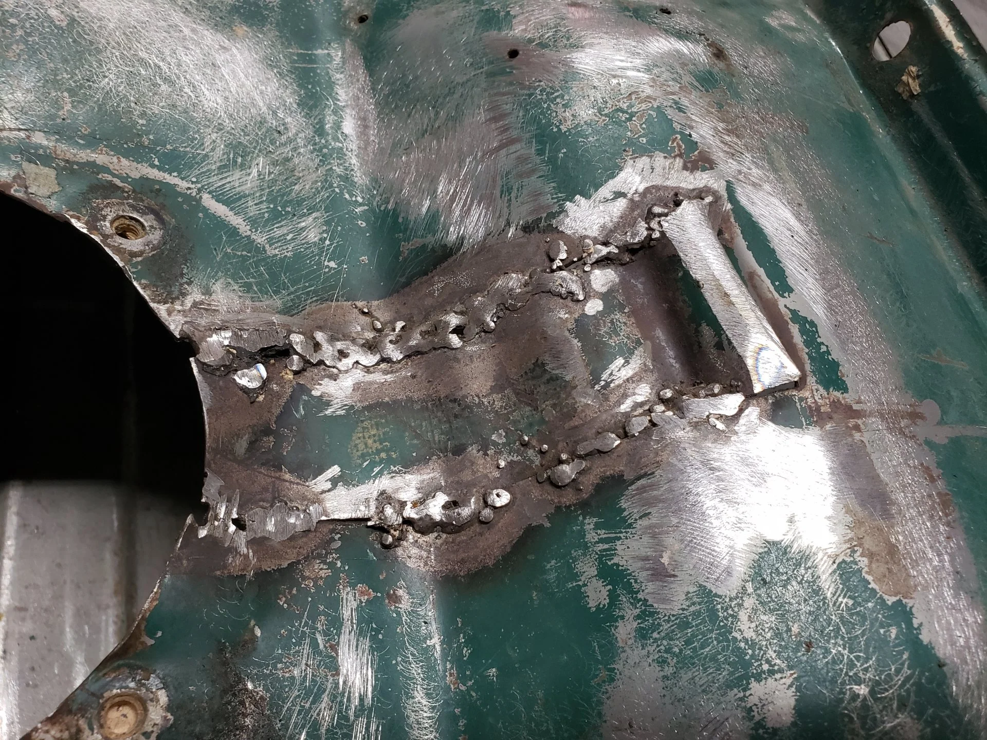

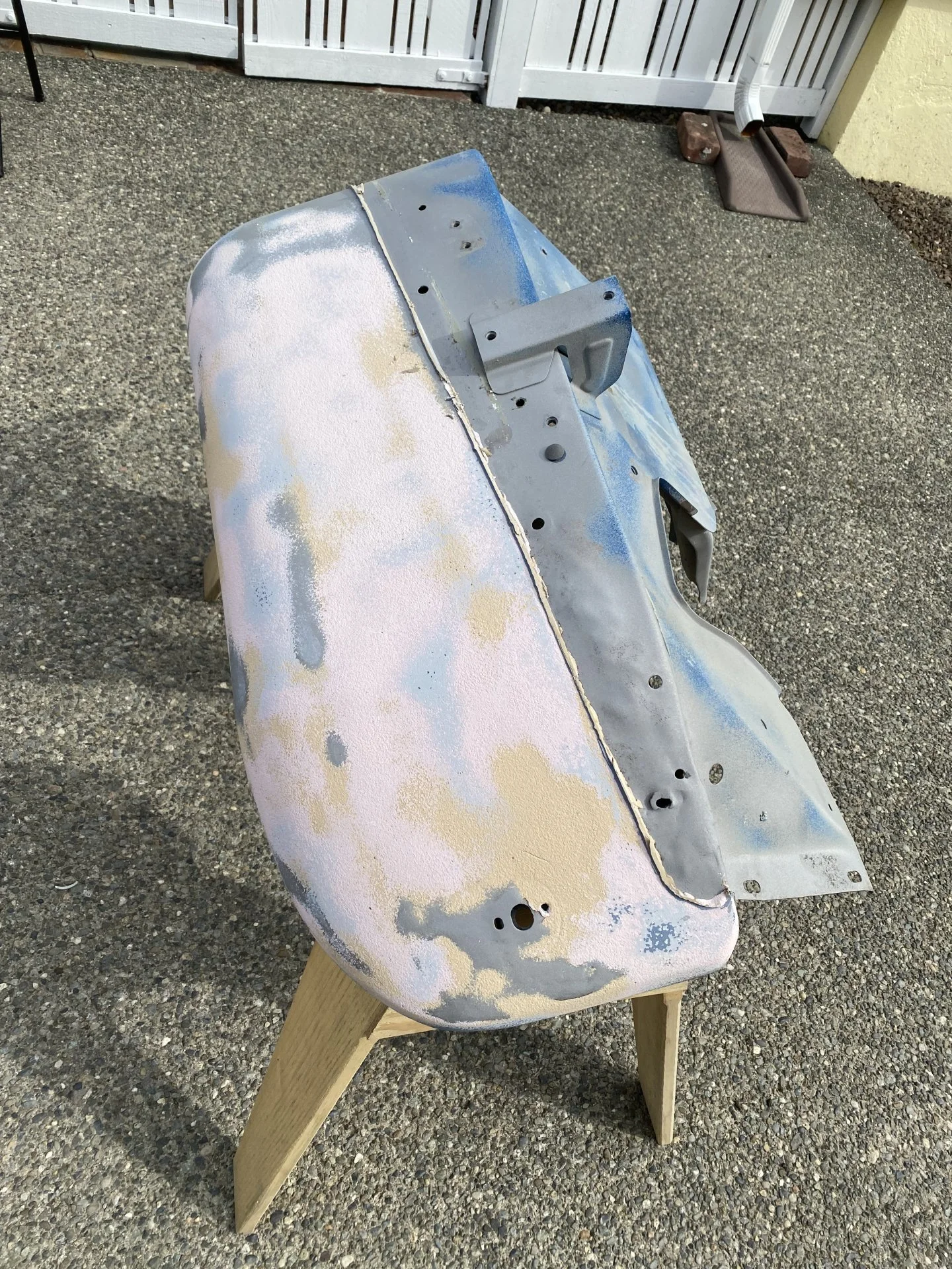

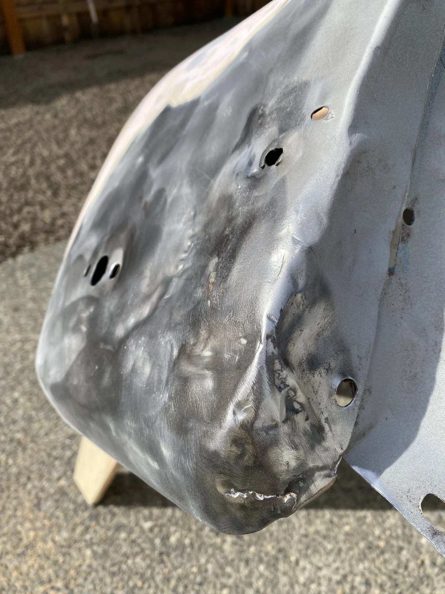

Bondo, or much better fillers out there, are a necessary evil. Unless you have a set of pneumatic planishing hammers. But there are still areas where you can't back up with a dolly. I hammer and dolly as close to straight as I am able. Sometimes I get it close enough that primer surfacer will level it. I've spent 6 months unfking PO stuff on my project.
Just one example.
Just one example.
I agree that filler has a useful purpose. Using a skim of filler has a time and a place... what I hate is when it is easiest to measure its thickness with a yardstick. I prefer to use as little as possible... if any at all.

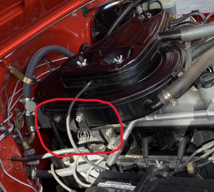

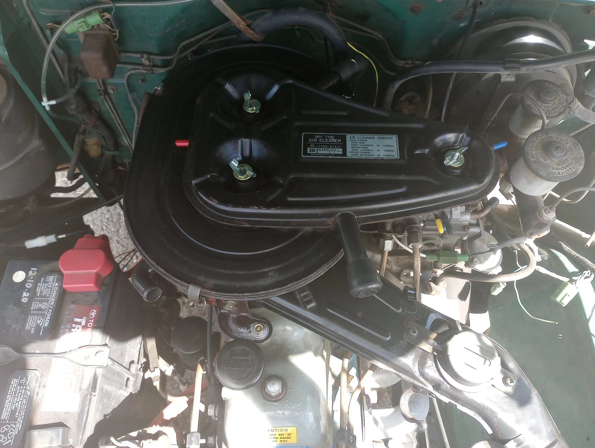

Now that the distributor issue is tackled and I'm back to running, I can show ya'll the fun stuff I've been working on! @Toyrod sold me a beautiful original air cleaner housing assembly, a 17700-61022, complete with super survivor sticker! Then I bought all the bling, with a new stud and gasket from @ToyotaMatt. Enough talk, here it is!
The different color vaccum plugs were all I had, I'll clean that up later. This replaced a 6 inch round Mr. Gasket generic thing, so much better! And now I am finally able to run a hose from the valve cover to the intake for the first time, smells better! Then, I had to overcome a difficult decision ... Cruiser Problems :cool:
So now, all I need is some brackets and the hose and SS clamp from City Racer. Here's everything I'll have to run down:
That Bracket and then these things:
If anyone has that to part with, just hit me up. :) It's gettin' better all the time!! 🖖

Are you looking for part 17765, the stay for the air horn hose? If so a guy on Facebook had it, I think. If so let me know and I'll see if I can track down the post.
Yes sir, from the Parts Microfiche scans, the call out number is 17765 and the part number is 17754-61010. It is the Z shaped bracket, but also is supposed to include the round hose clamp that bolts to the bracket. I haven't gotten a chance to really start searching yet, as I just got the air cleaner, but in my early searches it seems like this is getting hard to find, at least with the clamp.
The other part to that, the Inlet, is part number 17751-61021 I believe (the microfiche is hard to read right there). It changed shape in '80 so I want to get the right one for '78. This should be it:
And the bracket on the left side of the air cleaner 17700-61022 unfortunately doesn't have a separate part number that I can find, it was just included with that part I suppose. Anyway, sorry if this is a thread hijack, but hey, maybe in a few weeks I can show pictures of these cool old parts bolted to my rig :) Thanks! Have a great day!
I reached out to the guy on facebook to see if he still has 17765. In his pic he doesn't show the clamp but I will ask.

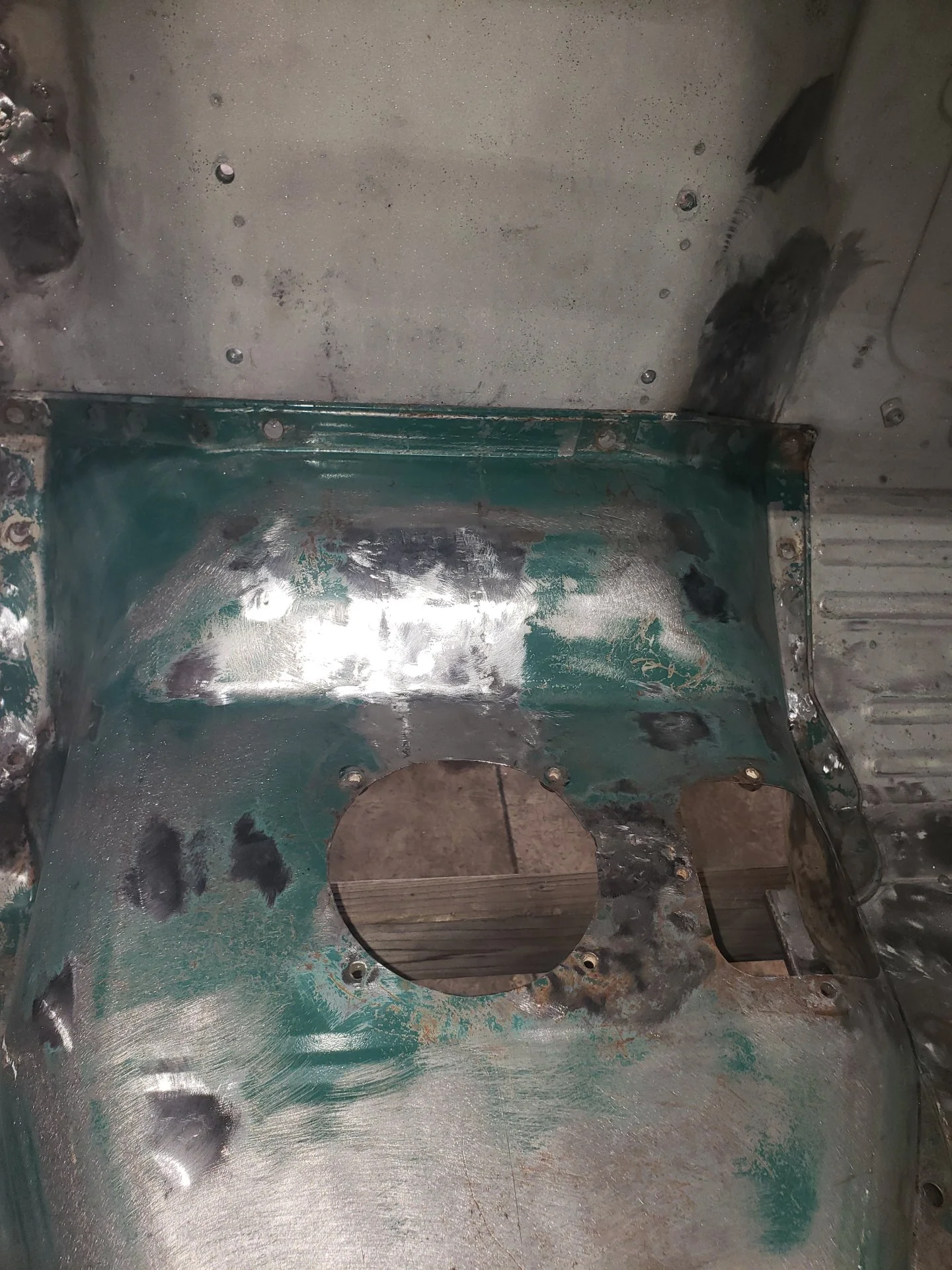

Just one example.

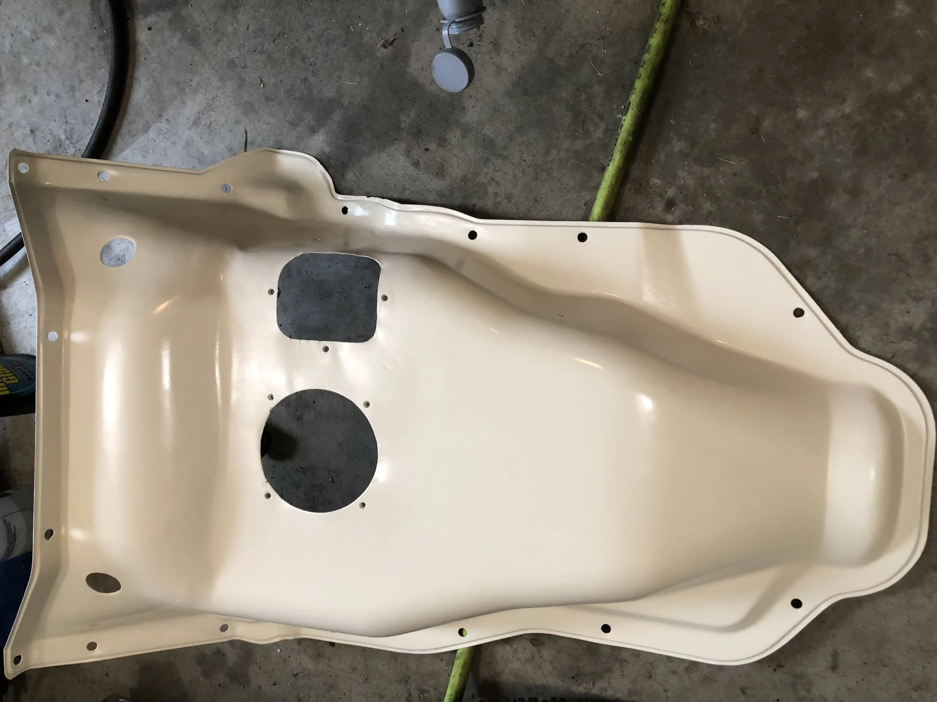

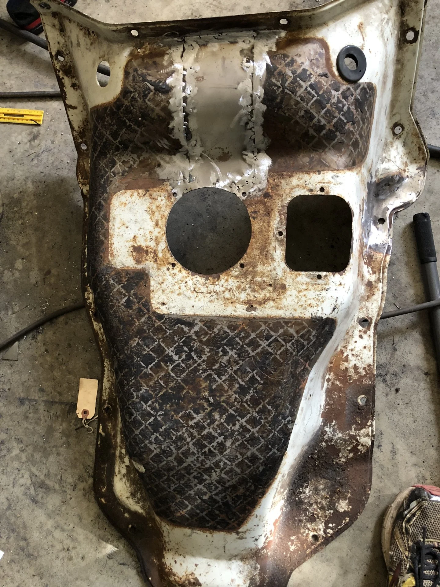

Man this is painfully familiar...

You might try cruiserparts.net. They’re in NH so it will have some rust but their prices aren’t crazy. That bracket and clamp are incredibly hard to find and I’ve seen them priced over $200 here. Happy hunting!
