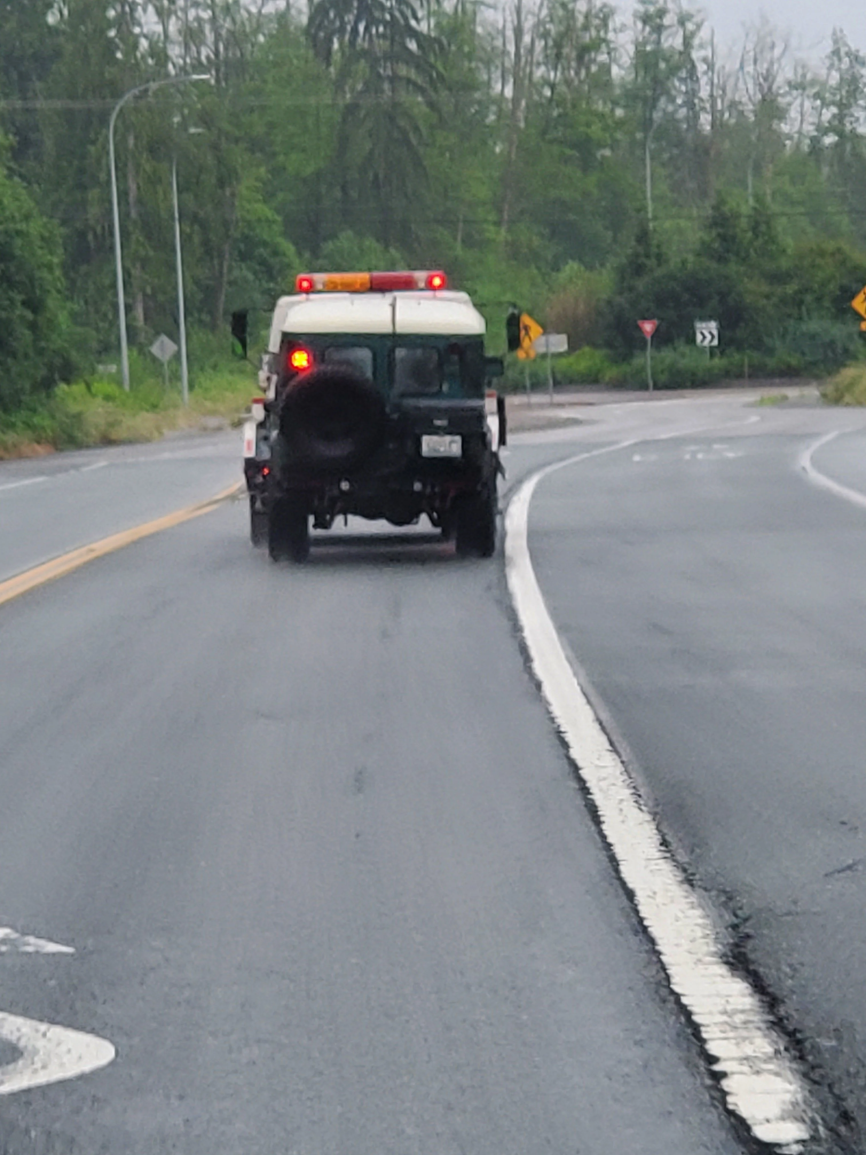

Took her on the first off road trip after 4 years of restomod work to Walker Valley. The night before tested the 4wd and Lo.
They worked, but my rig went completely dead in the driveway. Fould the cheap fuse holders I used for sniper and ingition wiggled lose. Tightened them down and took off the next morning.
4x4'ing was awesome, son has a FJ80 and we tranversed about 3 trails until my rig went dead again. This time the sniper was in a continual state of rebooting. Checked the fuses, they were secure, but obviously causing some problems.
My son pulled me down trail #3 to larger road and I trouble shot the wiring for an hour and a half. By passed the fuse altogether but still couldnt get the sniper to stay on nor other electronics. Dakota digital was flashing on and off and switch pros was blinking. Finally gave up and my son towed me off the mountain. After a 3 hour wait, took the drive of shame home.
After more trouble shooting at home, found my digital guard dog ignition box draining at about 43 mA when off, my odyssey battery was holding 9 volts. Battery place warrantied the battery and digital guard dog RMA'd the ignition box. I got a new blue sea fuse box to rewire.
Although it was a frustrating first outing, wouldn't have traded it. Cant wait to go again.
