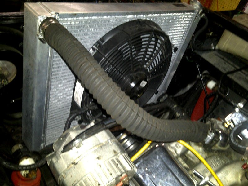

Installed a Be Cool radiator.
The stock radiator allowed the temp to climb to around 225* when idling around for extended periods of time.
New radiator keeps the temps down around 220* LOL... I think I need a shroud, I only have an electric fan at this point. (195* t-stat)

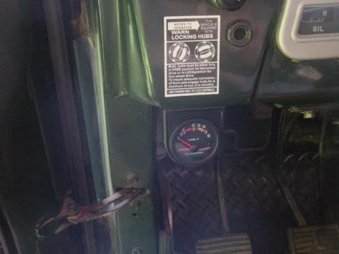

Volt meter
Installed a Volt meter last week, because I suspect my generator or my voltage regulator is not working ok. We'll see.

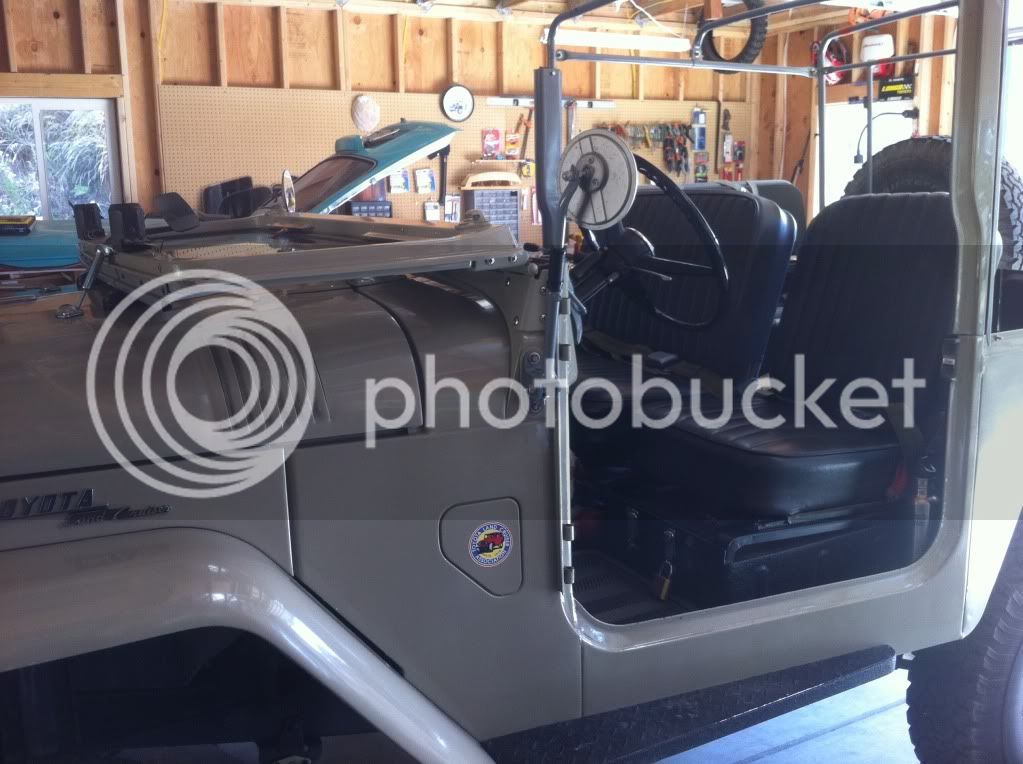

Completed "Project Roof Hoist". And then took the roof off:
Good idea to store the doors up there too. I used the same hoist for mine and just installed it this last spring; wish I had done it years ago.

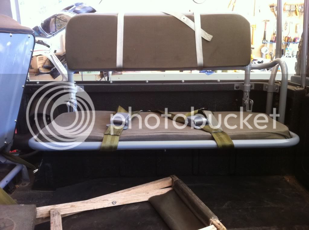

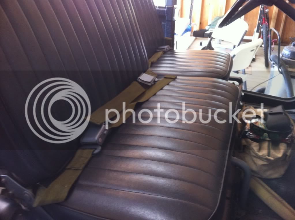

Installed new lap belts in my '67.
