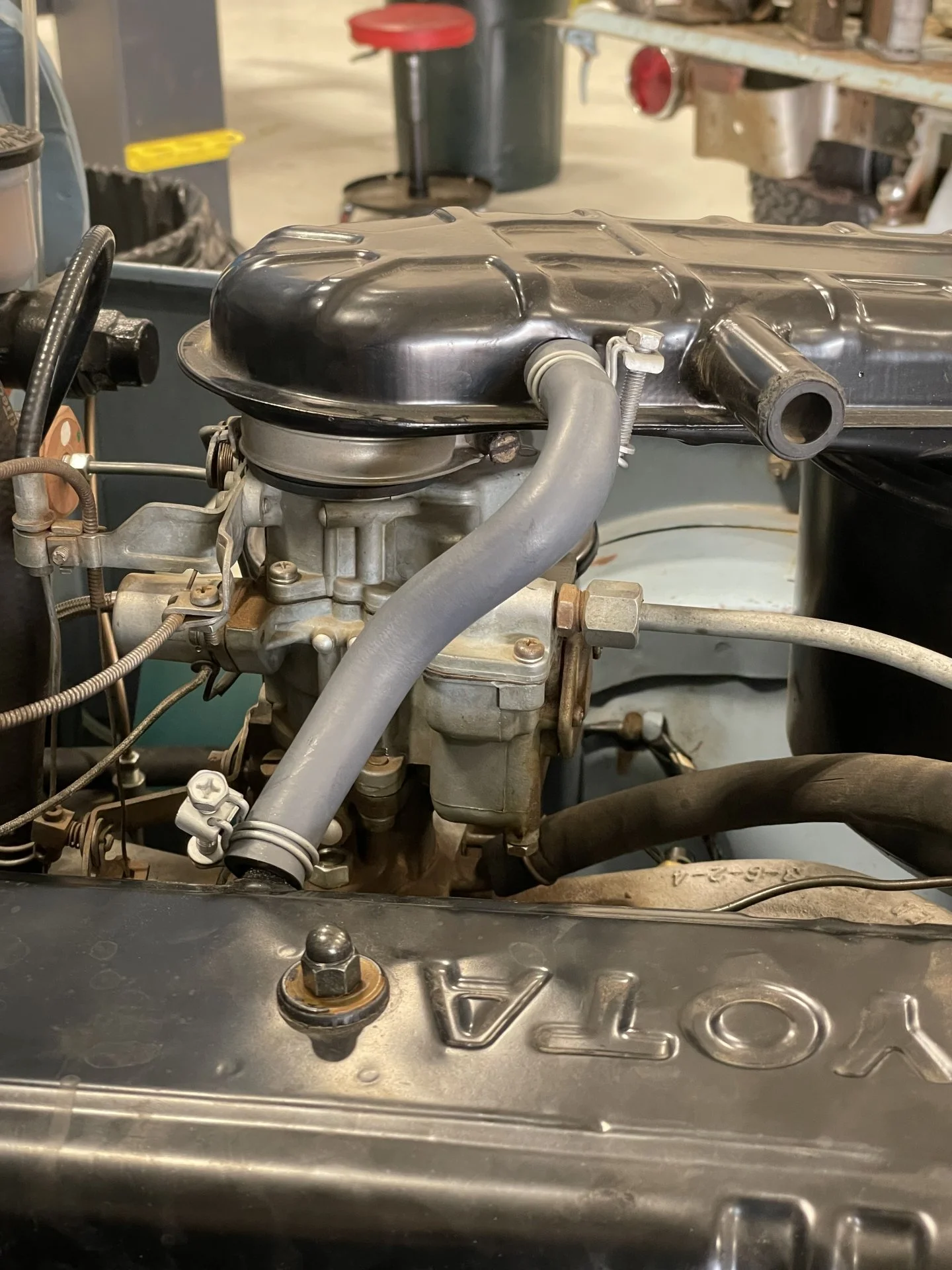

Vent hose from valve/rocker cover to air filter housing.
From a 1FZ-FE:
Use 96112-10220 hose clamps for a good fit.
Will need to be trimmed.
Installed:
Hope it helps keep things Toyota.
