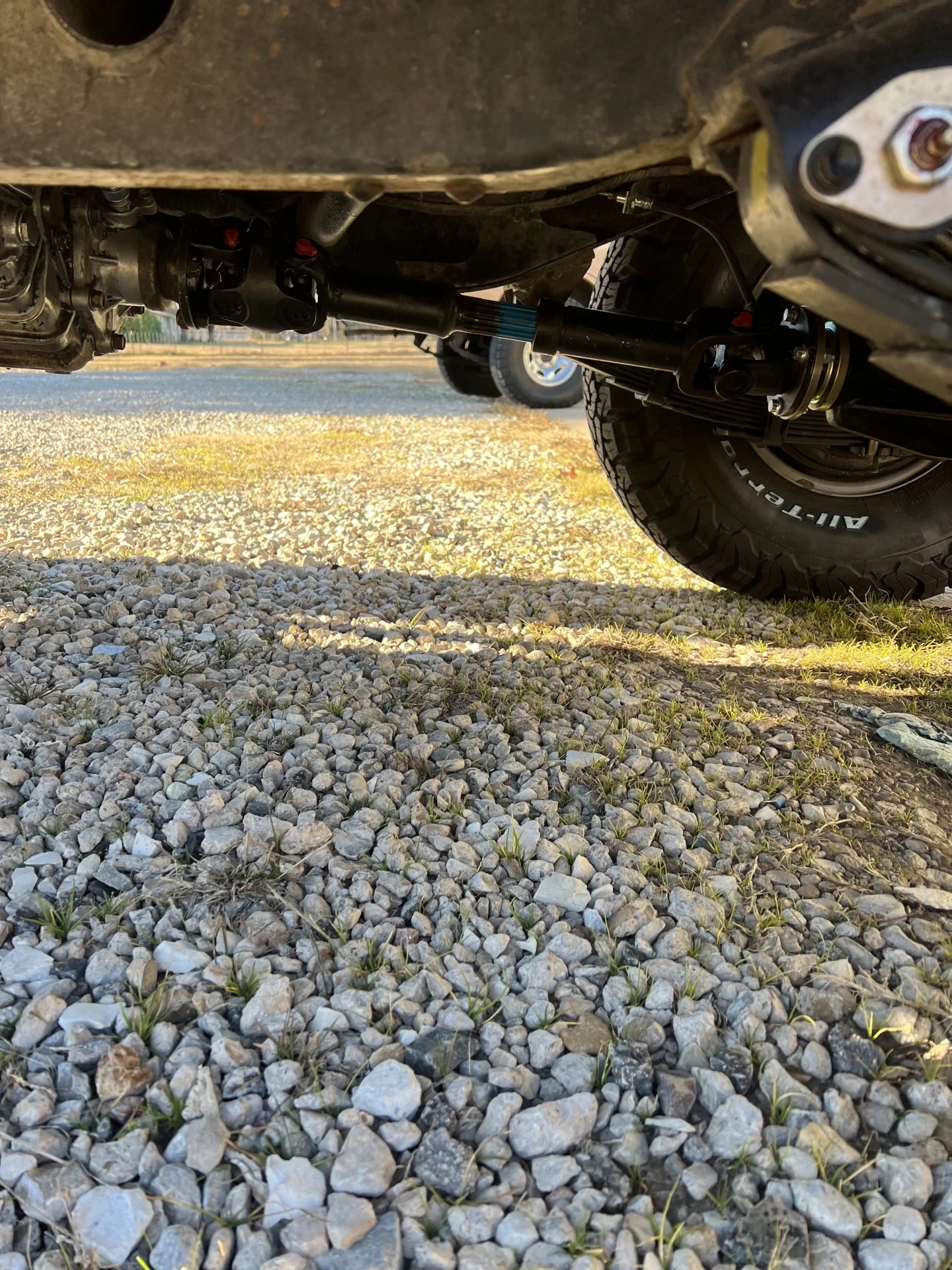

I really need to get a double-cardan rear driveshaft for mine; even after shimming I still have a slight vibration at 35-40 mph in 3rd gear.
Exact symptoms we had. DS angle was about 15 deg. Added 6 deg shim. That’s all it took.
