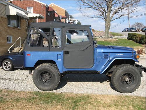

installed OME lift, plus extended shackles, all other goodies as well, snapped all the old stuff off. corrosion was serious.
I like your 40 and new lift, but I hate to tell you the front shackles are facing the wrong way. They are pointed to the front, but they should be pointed to the back in order to perform their anti-inversion function.
x2 what he said......and the rears appear to be on backwards as well......otherwise sweet looking 40 and good choice of lift :)
Spring reversal. Also added a leaf because I felt the rear was sagging a bit..
