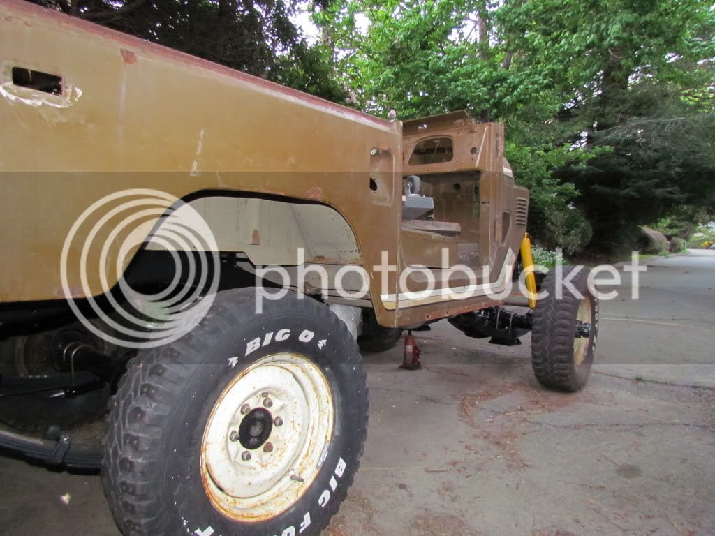

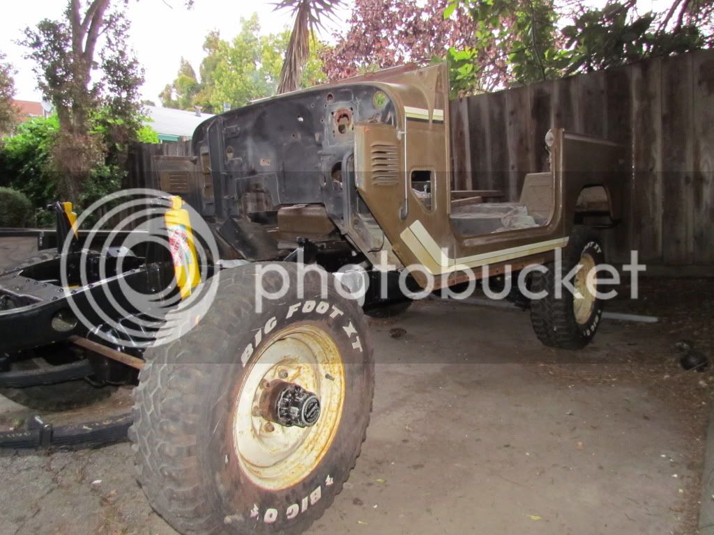

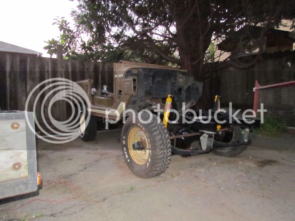

Got the frame back together rebuilt the and painted the front axle installed new suspension, temporarily set the body on to see what it would look like
Finally got the axles out from under it
