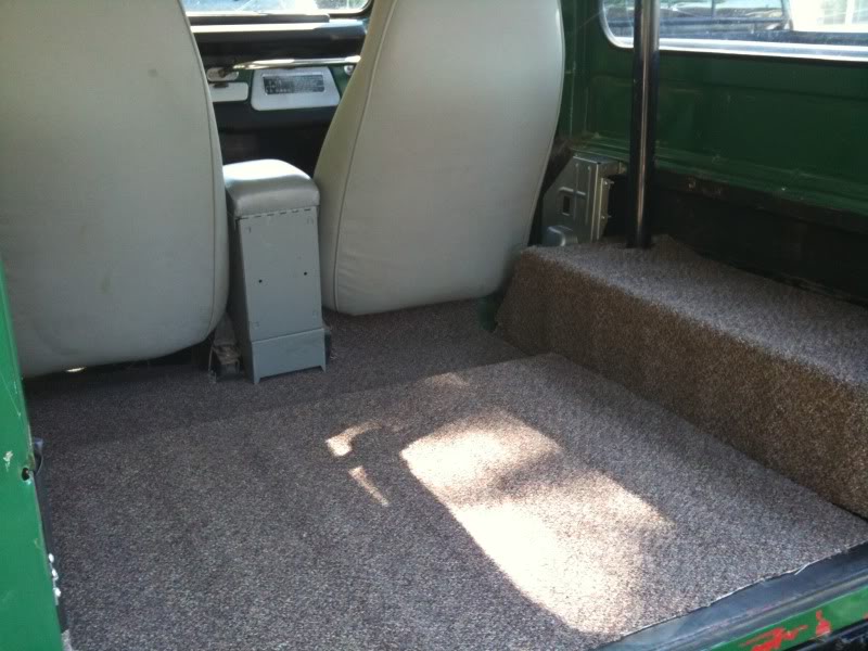

Started working on the interior, lots more work to do.

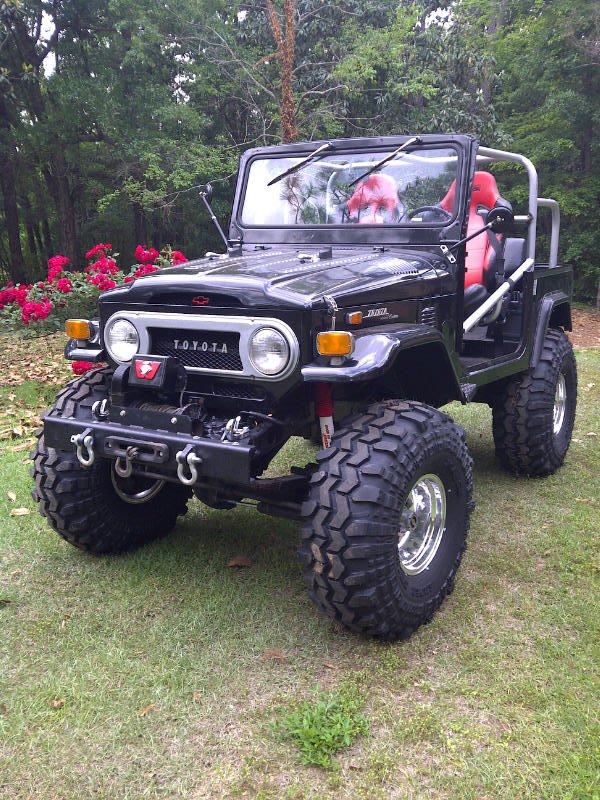

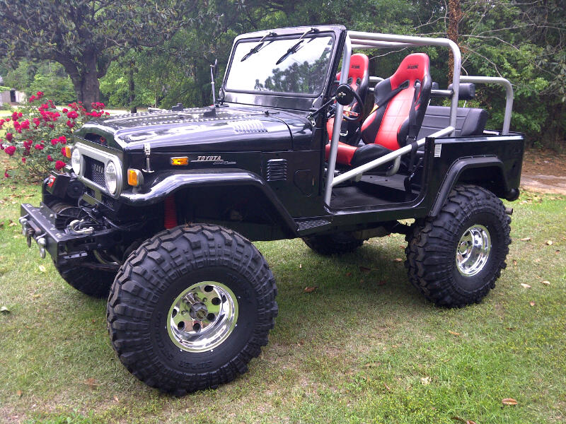

Dude, your 40 is awesome. When I rebuild mine, it will look like that, but in lime green and black. Well done!
I did wheels/tires, winch, and a back seat from cool cruisers. Next up is rear disc brakes and install my onboard air system (left over from a previous train horn addiction)
