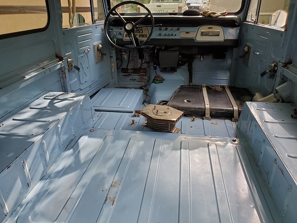

If you have old gas tank .. you can make some body floor...
my tank rust from side .. I use it for tube fabrication ..
make some channels ...
weld through primer..
it can hold a beer now...:-)
