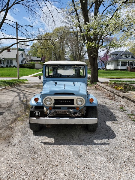

Drove my new to me `69 to a farm in the next county to help out a guy with a couple of neglected fj60`s. Longest drive yet with this 40, I've been fixing things and taking it on short trips to get a feel. Runs better and better. I think it`s enjoying attention after 30 years of being idle. 🥰

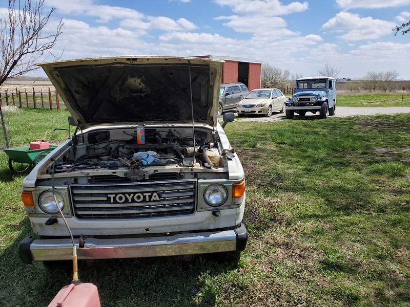

This poor old 60 is too! Fired right up after I bypassed the tank and took the airhorn off the carb to clean the stuck float valve and remove crud from fuel inlet screen. Tank needs to be dropped and rehabbed I think. Fun!

Looks a lot like mine when I got it, tow bar and all. A little compound, wax, and polish and that paint will shine right up.

Looks like Story county. I graduated from ISU in 86.
