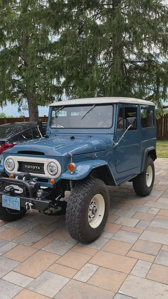

Performed compression test after 700 mile break in on rebuilt 2F. All cylinders were at 145 PSI across the board (20 feet above sea level). Changed spark plugs to Denso W14EX-U, OEM #90919-01056. Also, upgraded plug wires to OEM #90919-21322. Fixed vacuum leak at base of carb thanks to @Solace in Solitude. Then went for a ride.
Performed compression test after 700 mile break in on rebuilt 2F. All cylinders were at 145 PSI across the board (20 feet above sea level). Changed spark plugs to Denso W14EX-U, OEM #90919-01056. Also, upgraded plug wires to OEM #90919-21322. Fixed vacuum leak at base of carb thanks to @Living in the Past.
