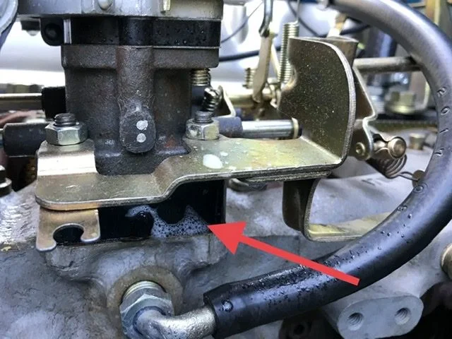

Thanks for the suggestions, much appreciated. My 40 was never smogged as it was originally from Colombia. I sprayed water (with a slight mixture of dish soap) around the intake manifold. As soon as I sprayed water around the drivers side rear carburetor base plate mounting bolt (image below with red arrow), I immediately noticed an idle change. Shortly after, the noise was gone. The water apparently filled the void enough to stop the whine. This has ruled out the other possible sources of the noise (compressor, belts, bearings etc..)
Intuitively, my next step is to tighten mounting bolt to create tighter seal.

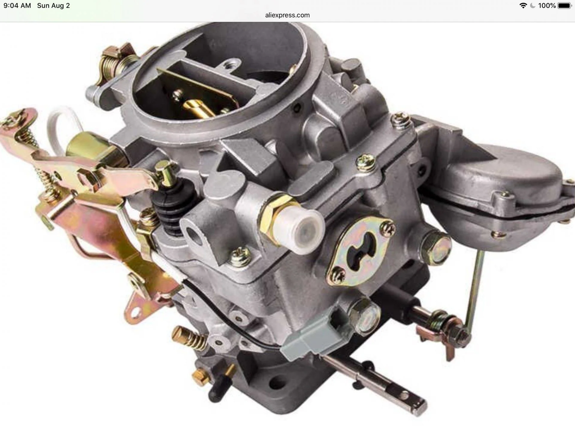

Thanks for weighing in. The carb was installed by the PO. It does appear to be new. I’m not familiar with these Chinese non-USA carbs (H3662) and am now doing research to get up to speed on best options. I may keep this carb as backup and go for a rebuilt Aisin. Wondering if there will be any performance improvements.
Here is updated video after tightening mounting bolts. All 4 required more torquing.
No more vacuum leak sound for now. But how about those noisy valves? Will be adjusting those for the first time next.
