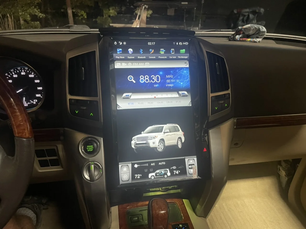

Upgraded the nav/head unit. The 200s nav was so bad that I never really used it. I just used my phone for nav. I was going to add a ram mount for an iPad but I decided to go this route. The unit is essentially a 16” android tablet. Lots of settings to figure out but just getting Google maps on a 16” screen is a major upgrade. Onx and Gaia will be awesome.
This part was scary. I hate wires.

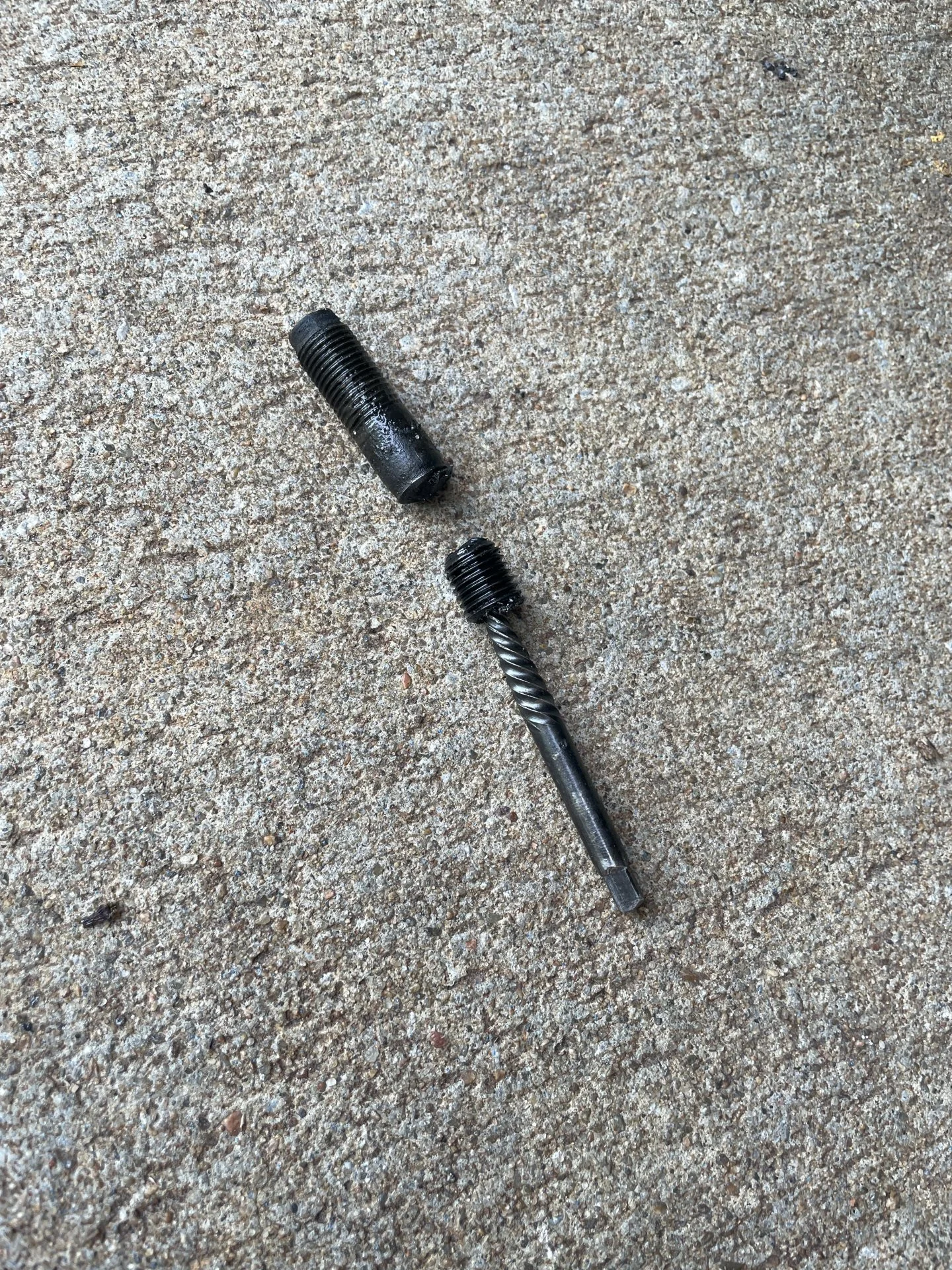

Had to figure out a broken Key Cylinder Rod situation:

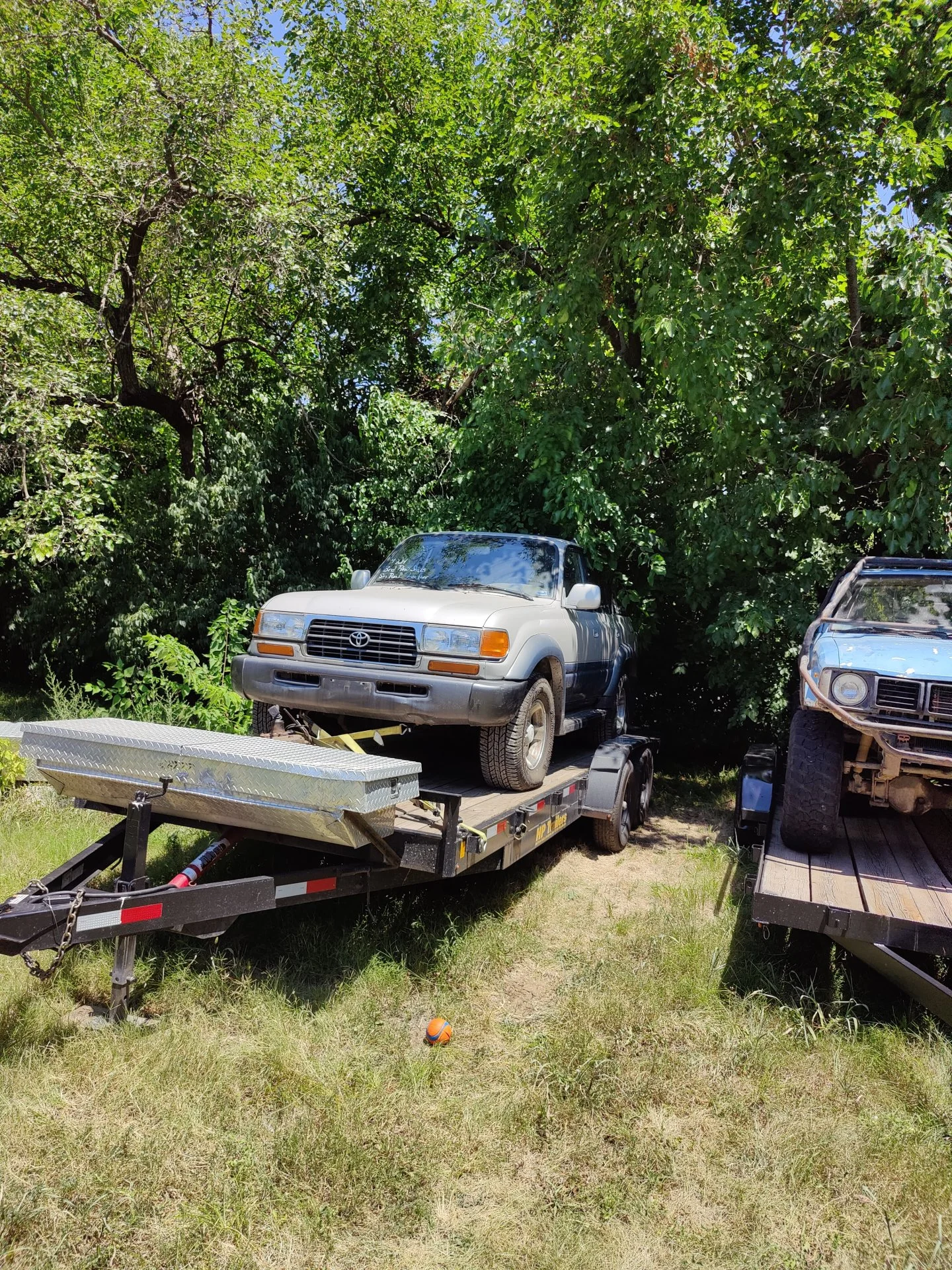

Rob with the win on the race to Pick-N-Pull, beat me by a few minutes!
Let me know when it’s for sale again, I should have offered $3000, let you make a quick $300 😂

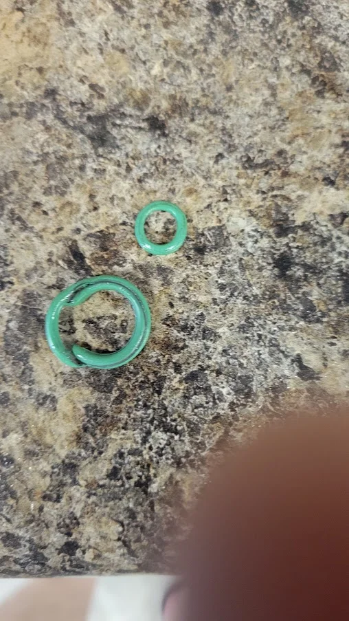

may have found the reason the AC in the 45 wouldn't hold a charge. Changed 2 o-rings last night, pulled a vacuum, let it sit overnight with the gauges. Still had vacuum this morning. Going to toss a new dryer on for safety sake. (old dryer doesn't have a window)
This is the primary reason you add UV dye to the system, so you can find where it is leaking.. One other issue i had was the High side Schrader valve was leaking.

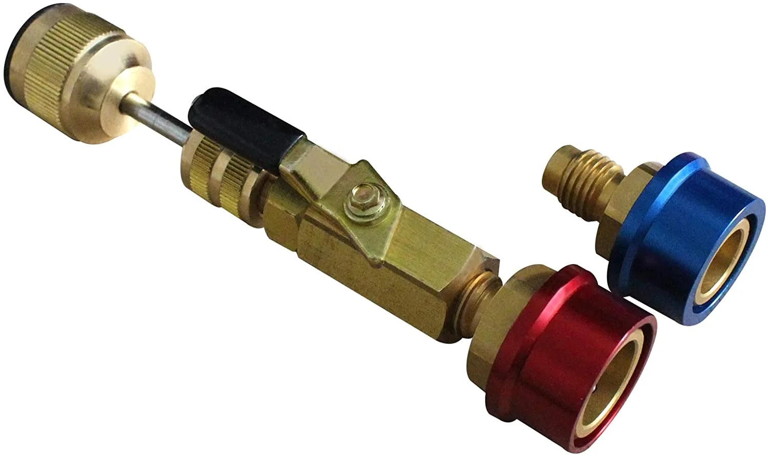

FYI. standard tire core removal tools will NOT fit deep enough into an R134 fitting to unscrew the valve. I was able to use my new Mastercool core removal tool with great success.

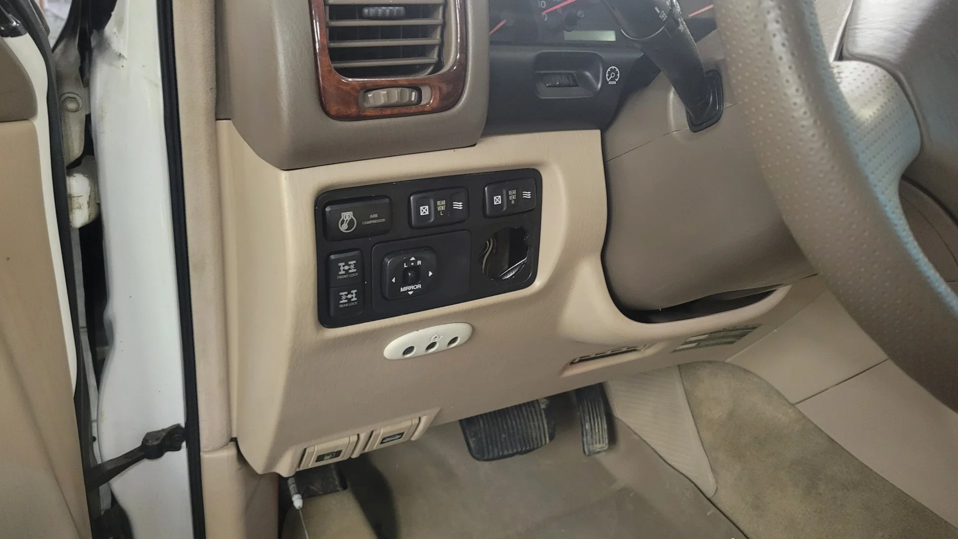

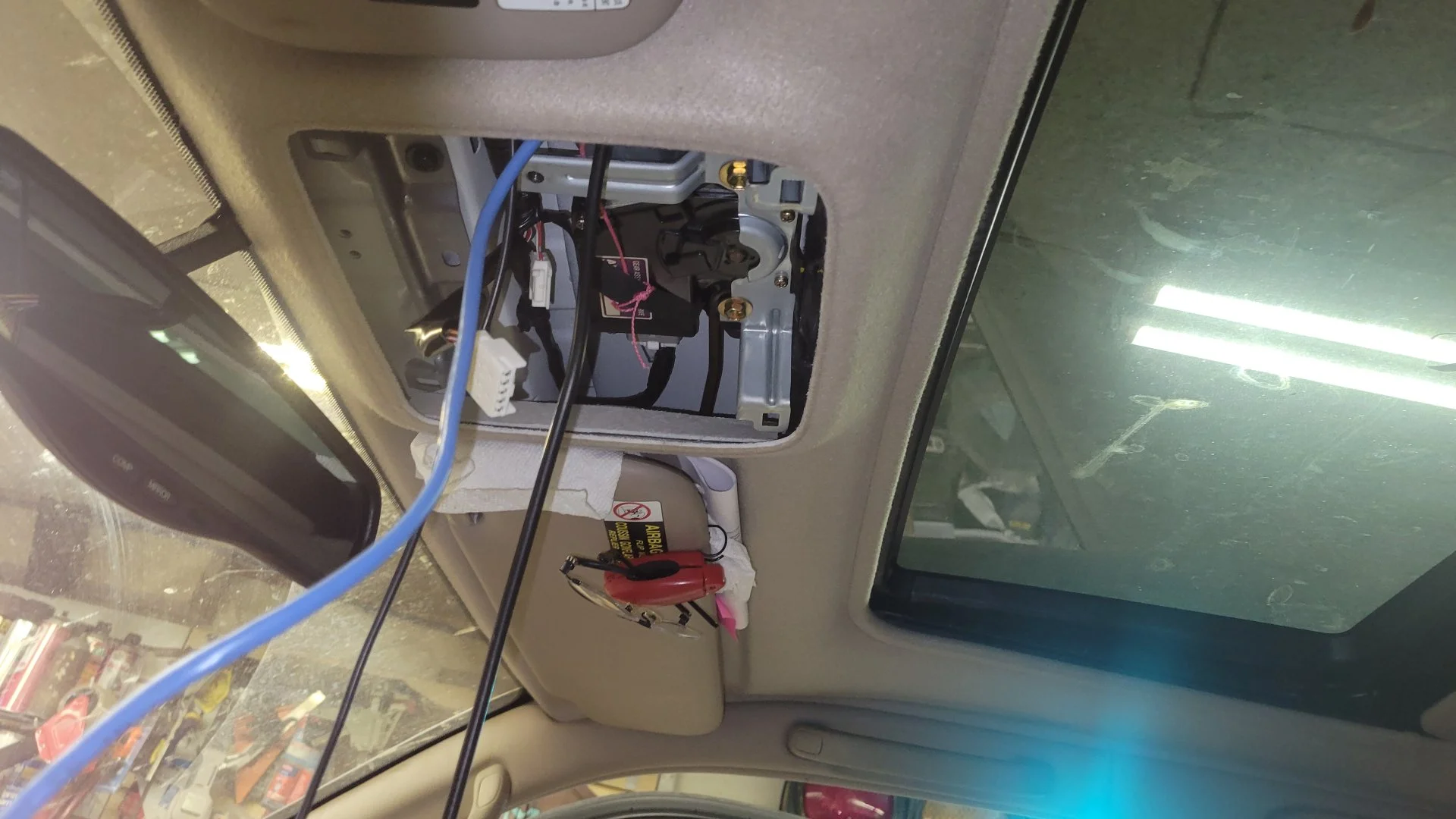

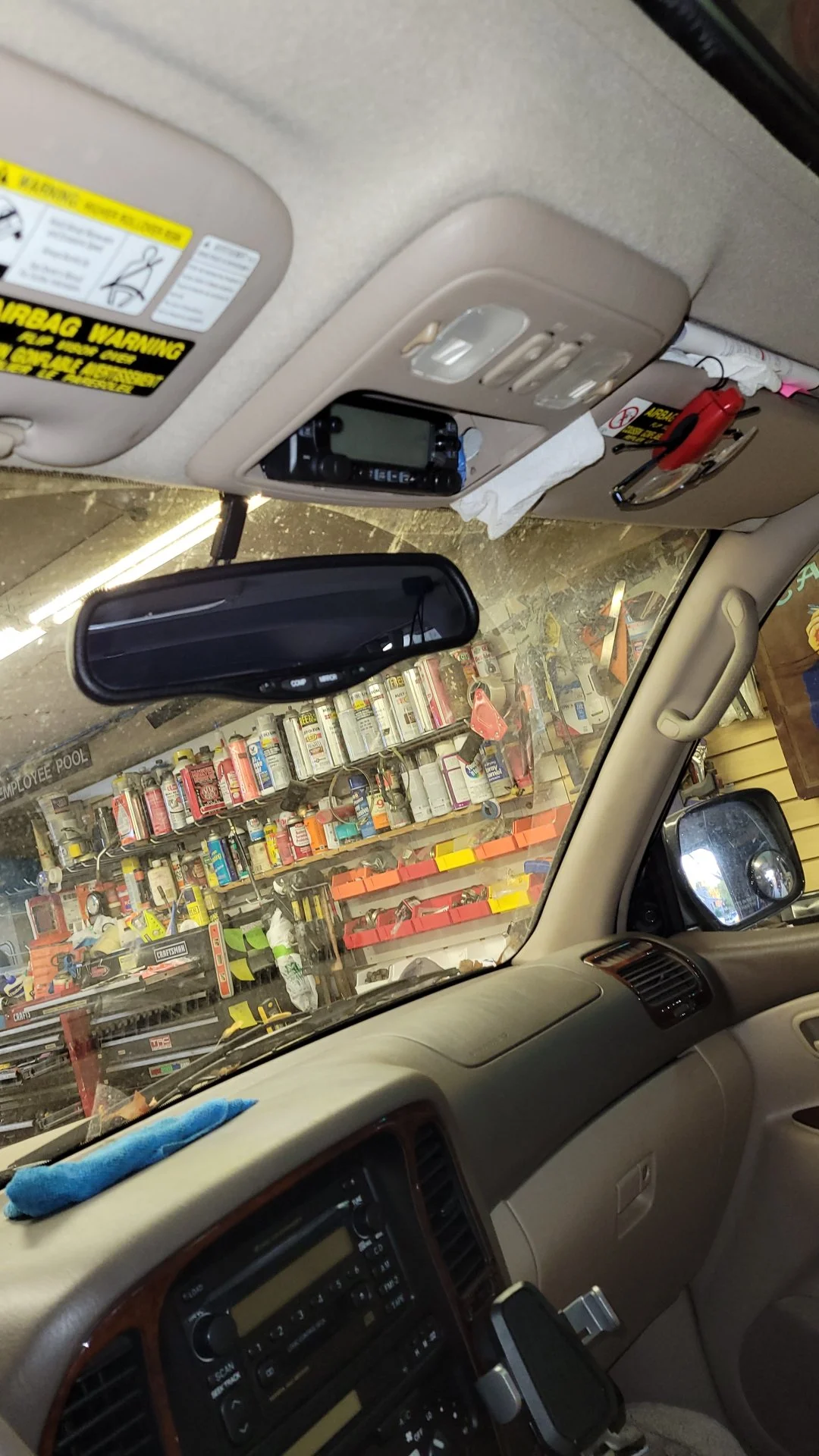

Cleaned up the dash and working on ham instal. Lots of wires. Thanks to Jess for the assist in don't use the illumination feed on the switch. I was having weird issues, apparently the ch4x4 switches have problems with their illumination on some switches.

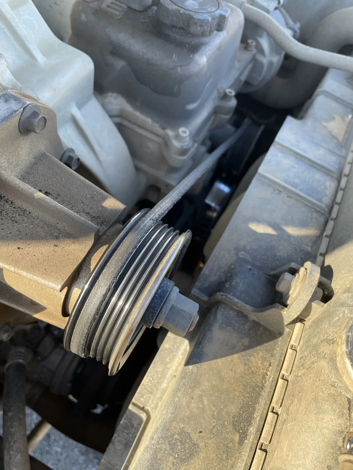

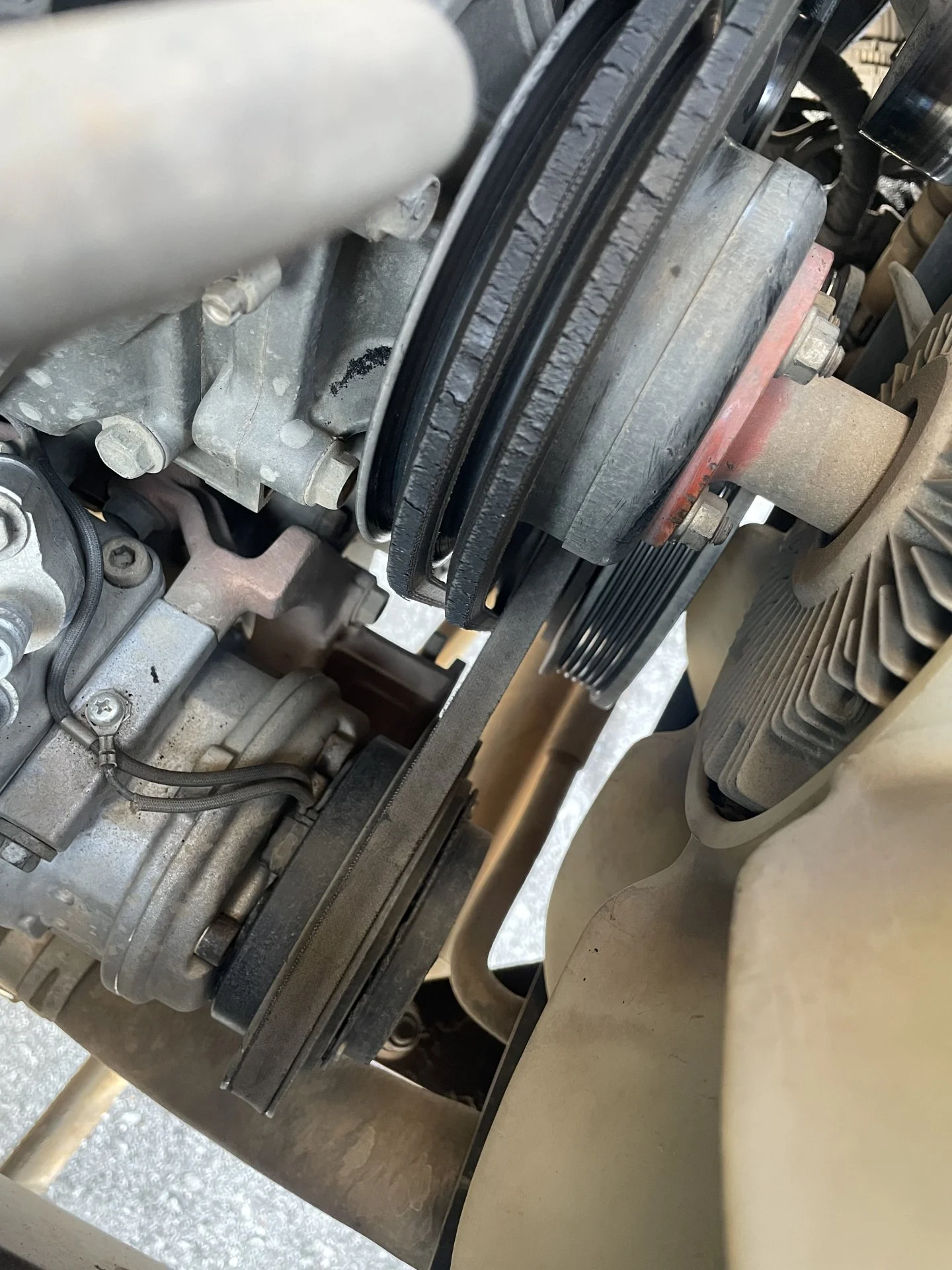

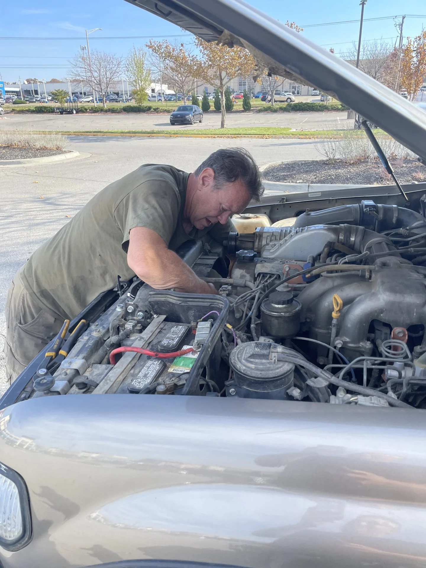

Called roadside assistance and they sent this guy…. Bearing on supercharger idler went out and inverted the normal two belts as well…

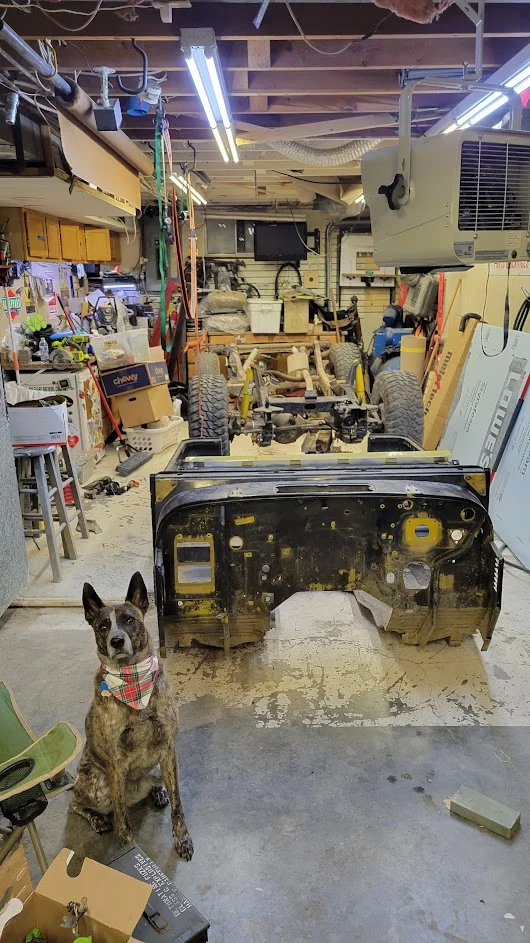

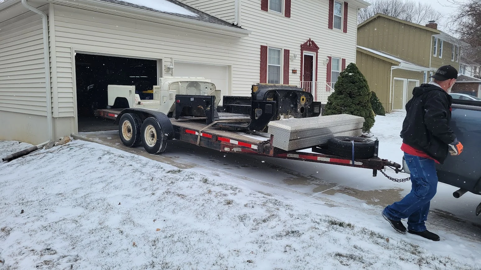

Pulled old body, swapped some stuff around, installed new body.

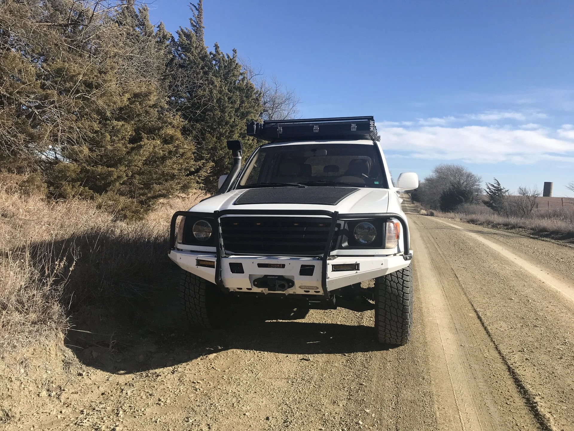

Installed 7" LED headlights on the 100. Had to delete the DRL function by removing the ignition line to the daytime running relay, apparently LEDs don´t like being placed in series with one of 'm in reverse polarity. New side markers are still somewhere in shipping. The trucklite LEDs provide a nice beam pattern :)
