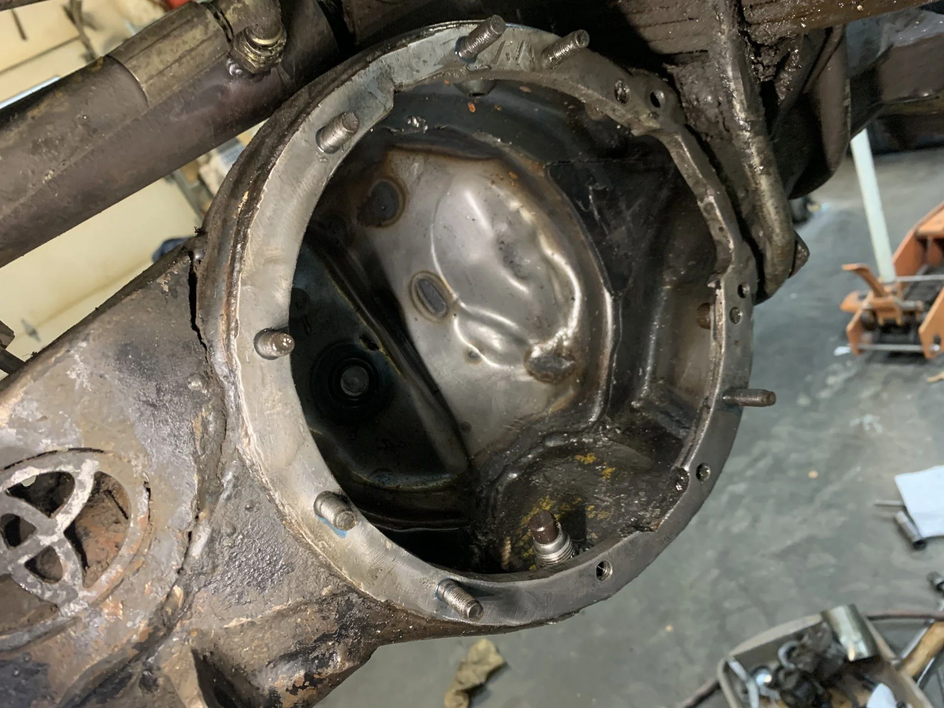

I'm playing the same game as Kelly. Pulled the front diff to reseal. Discovered a better use for my wife's Cricut machine. In house gaskets!

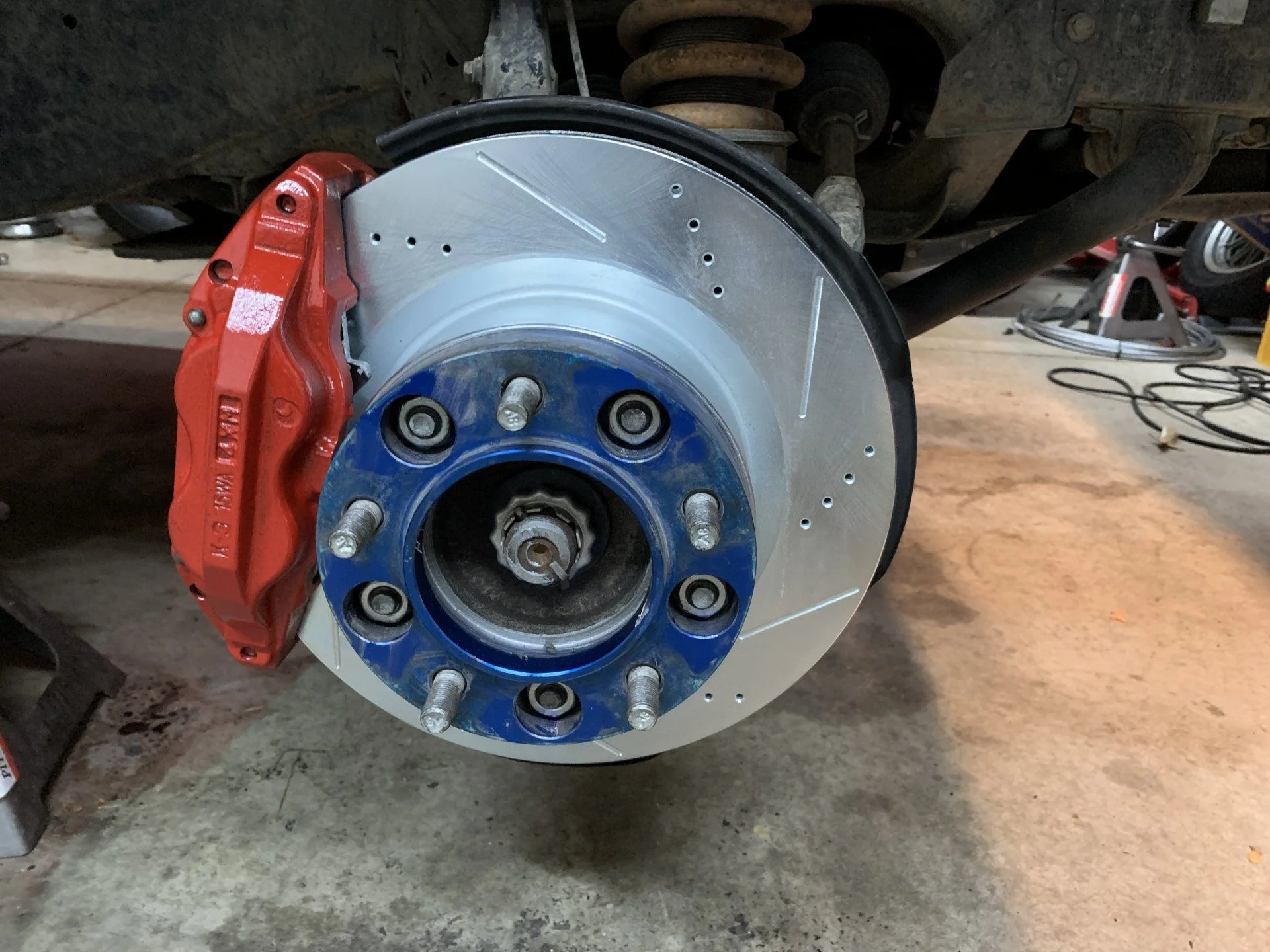

Also finished up the new brake calipers, what sounds like a really easy thing.. it was a little bit of a pain... When I took out the calipers the top driver side bolt did not have a washer which allowed it to go all the way in and hit the rotor. This of course buggered it up quite a bit. I noticed this, but the only way to cut off the protruding end would be to remove the rotor, which to do so you had to remove the caliper which was held on by this bolt. So as I remove the bolt I did it very slowly and moved in and out trying to create new threads on the bolt. Evidently the bolt was stronger than the tab on the six shooter knuckle and stripped it out. Colin discovered that the six shooter knuckles are the same on each side so I could’ve torn everything down and swap them, but some quick in her web searching found that the M 12 x 1.25 is just slightly smaller than 1/2-20.
so a quick trip down to Ace Hardware and tapped out to 1/2-20, with a grade 8 bolts.

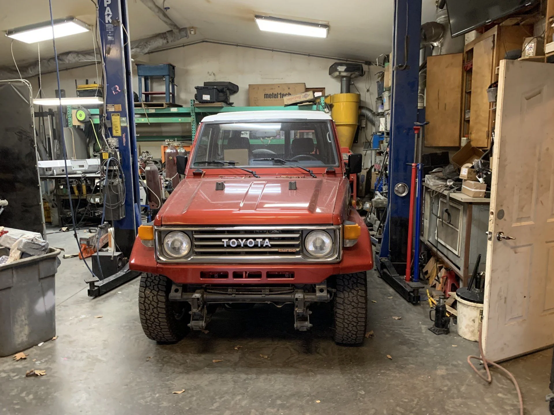

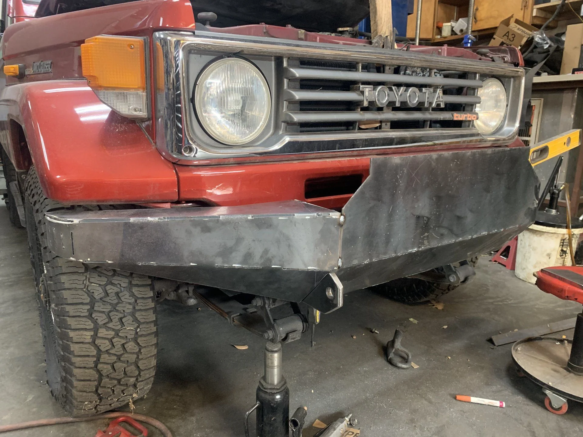

Started working on the front bumper for the 73 series with @kc_chevota

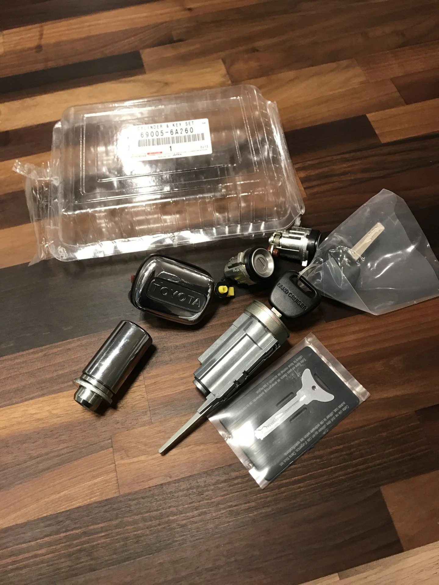

Picked up a new lock set for the 80. Jdm 80 series have laser cut keys like a GX or LX. Also, the key says Land Cruiser which is cool. I only had 1 key that was a copy and it only worked ignition and front door. Also replaced the Japanese jiberish on the door panel.

After helping on chefs rig, found all sorts of things I needed. Thanks to @CrowleyFJ40 I found my life was missing something.... this is a really great tool are used to unbolt the front bumper I am making for the 73 series

Then I replaced the front calipers (frozen) and pads. Also replaced a slightly worn steering stop on the axle.
