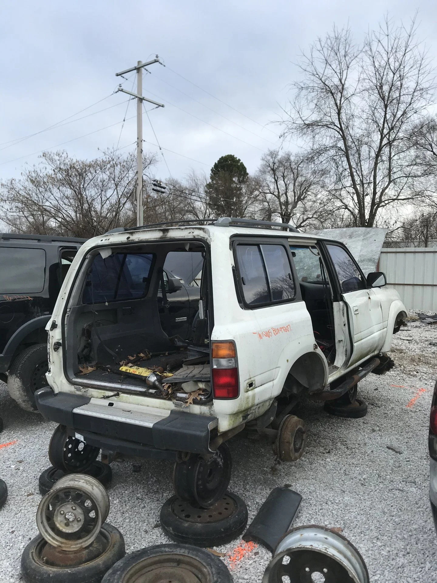

a ‘91 cruiser showed up at the Springfield PNP Christmas week - I had to pass through there so stopped and picked up some small pieces.

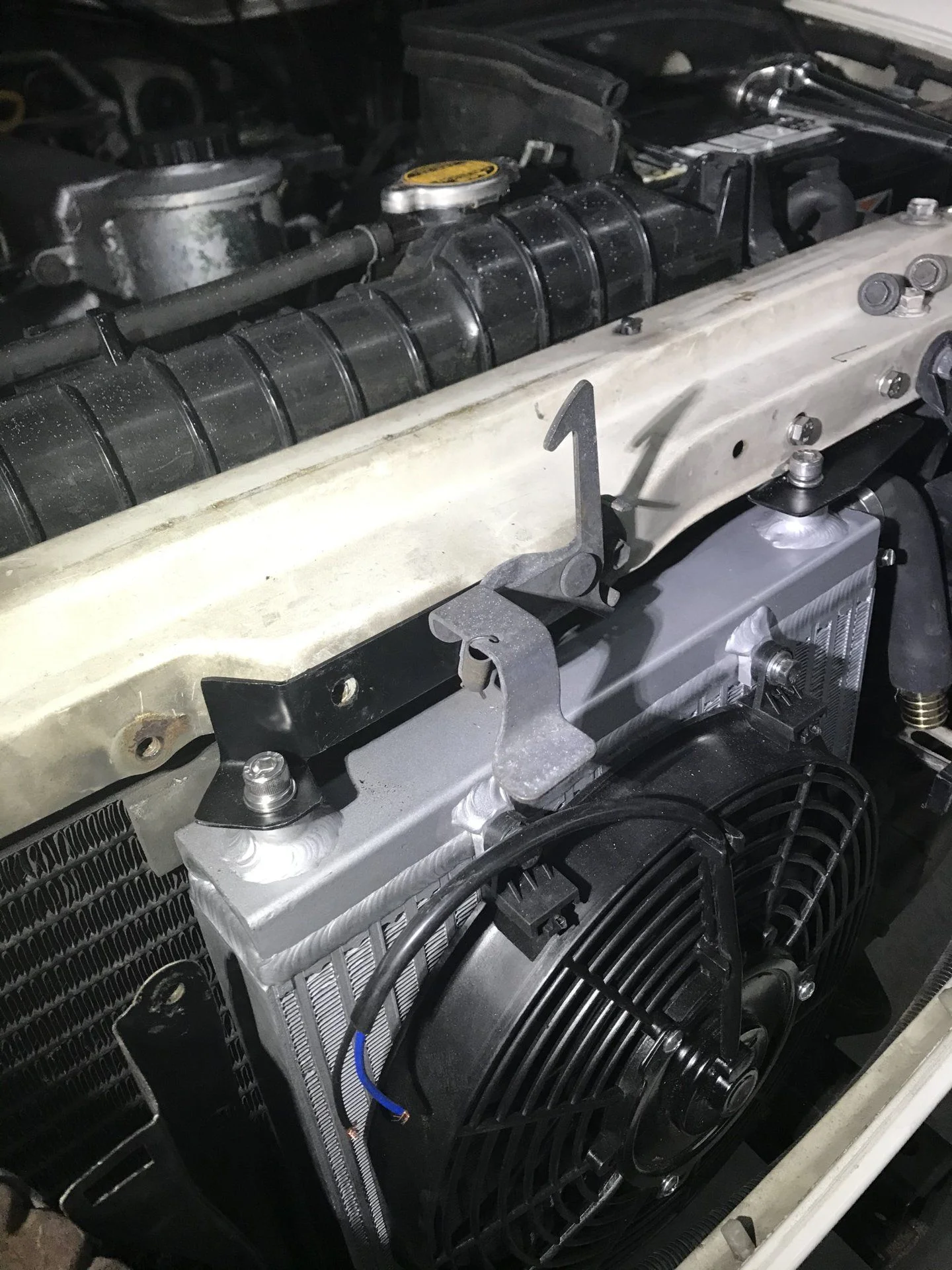

Almost finished with the water to air intercooler install. It’s from China so some assembly (tweaking) required. The heat exchanger didn’t have mounts so I had to fab some up. I also have an Oem condenser fan that will be installed on the passenger (left) side, and installed the heat exchanger and fan on the right. Need to get the wiring finished for the pump and fan, add coolant, and start tuning the new turbo.

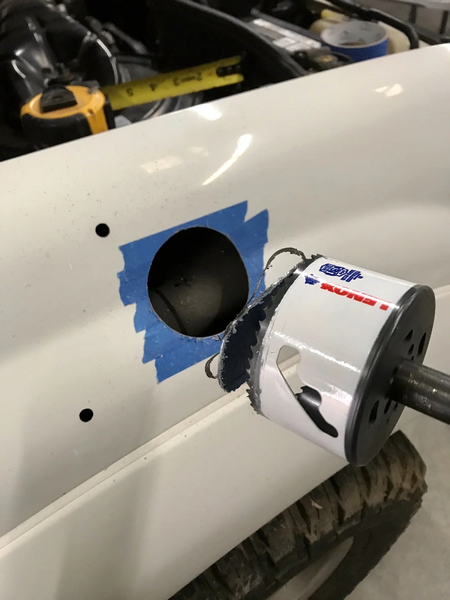

Was able to get a few things accomplished over the weekend. Drilled a large hole in my fender, finished up my pyrometer/boost gauge combo but the pyrometer stopped working - have talked with ISSPRO about it and have another part on the way. Also finished up the water to air intercooler.
