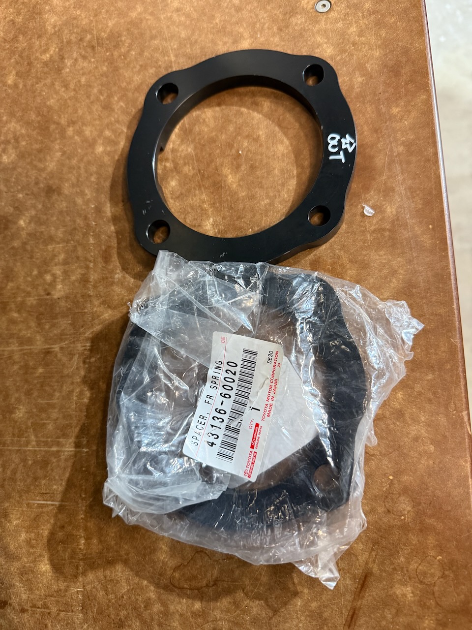

Installed OEM coil spacers to level out the truck a bit front to back and played around with KDSS to level side to side. Finally I'm able to move out of position 5 on the headlight height adjustment!
