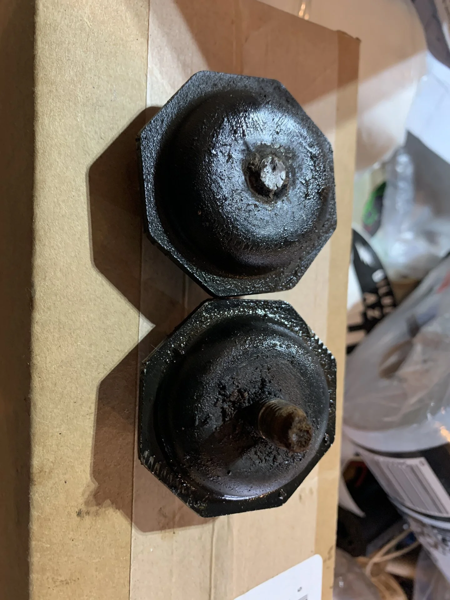

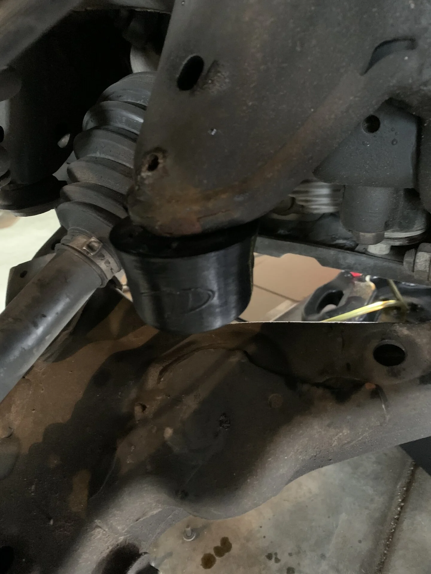

Before putting on my new sliders, I gave a little front sensor lift to Mr. Wayne and put on my perryparts bump stops…
…swell, I put on one. The passenger side OEM bump broke as I was removing it, leaving the threaded stud in place. Because of the LCA, I can’t get a drill lined up to drill out the stud. Does anyone have any suggestions besides dropping the LCA?

I had to drill out the stud from above. I'll see if I can find my post about it.

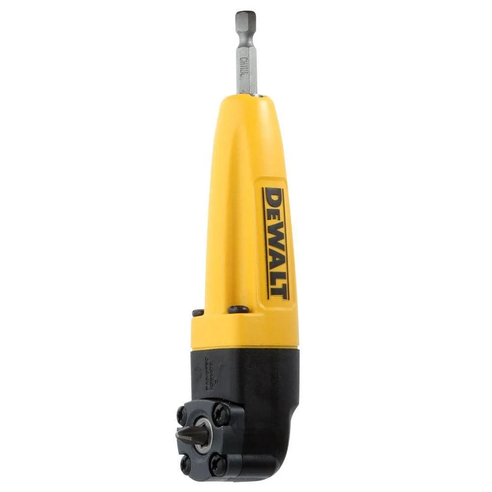

One of these right angle drill bit attachments along with a stubby 1/4” hex drill bit and 1/4” hex bolt removing bit have done the trick for me in the past.

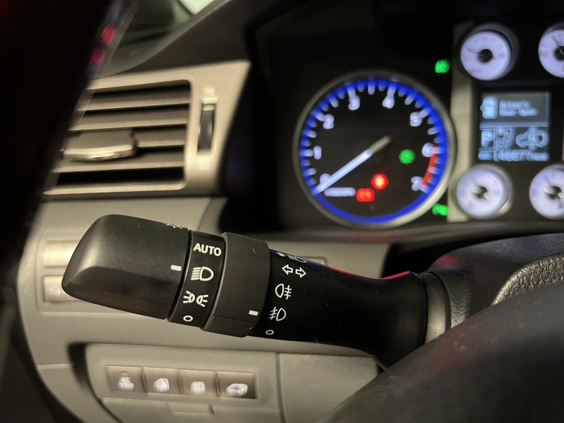

After the 100th close call during the frequent snow/rain storms out here, I decided to install rear fog light. I bought the OEM stalk and was going to do a bunch of custom wiring until I heard a relay click in the dash after installing the new stalk. After some messing around and testing, I realized the truck was already prewired all the way to the rear for the fog lights. The only thing missing was the wires from the rear sonar harness and the fog lights themselves. So I ordered those 2 and installed everything. It all works as it should now.

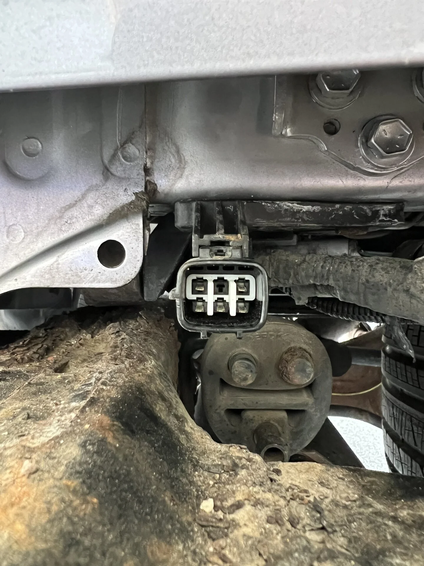

This is the connector for the rear sonar harness (where Frame #2 harness connects), the bottom 3 wires are for the sonar system and the top 2 are the positive and negative for the fog lights. I'm assuming if you have those top 2 wires, then your truck is prewired too.

Can you add the pins to the Sonar harness that is currently in place?
Yea, you should be able to just add 2 male terminals to the existing sonar harness connector and create your own wiring to the bulbs. That's what I would do over again instead of buying the $90 harness.
The OEM sonar + fog light harness (8216560270) is exactly that. Just 2 additional male leads in the connector with wires running directly to the lights. The new harness is below before I took the original one off, white connectors on the end go to the fogs. Sorry for the wacky floor.

Have the part number for the stalk with the extra fog light switch?
