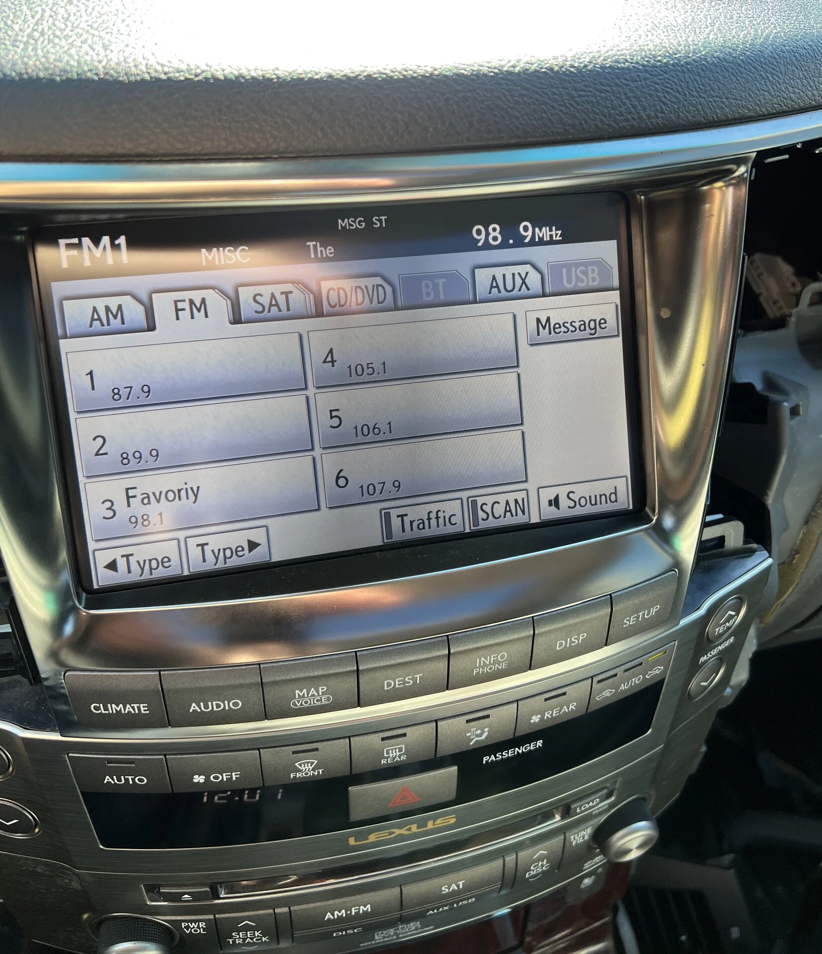

I replaced the navigation touchscreen on my 2010 LX today. It was yellow when I purchased the car. I used that fact to get more dollars knocked off the purchase price, and managed to fix it for less. I'll take it!
There wasn't a very good resource specific to doing this on the LX 570. I cross referenced multiple videos from multiple Lexus models, and also leveraged the brain of @nwfl4runner, who has done the same procedure on his LX.

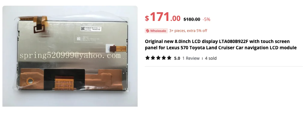

I purchased the Toshiba LTA080B922F panel from AliExpress. Here is a link, and here is a picture for when that link dies.
Not gonna lie - this job stressed me out. I'm a 1.5 :banana: mechanic - the most advanced thing I've done is AHC globes/fluid and changing spark plugs. I've never touched a ribbon cable before, and every connector has a slightly different mechanism to release the cable. I almost quit 5 minutes in.
I'll do a full write up and post a full video in the future. For now, here are some pictures.
I don't know how @NKP Garage does this stuff one handed, much less without a lot of edits. I think I shot 2 hours of footage, which is mostly of me cussing.
Success! The screen doesn't have that dark spot in the middle - it just looks that way in this shot.

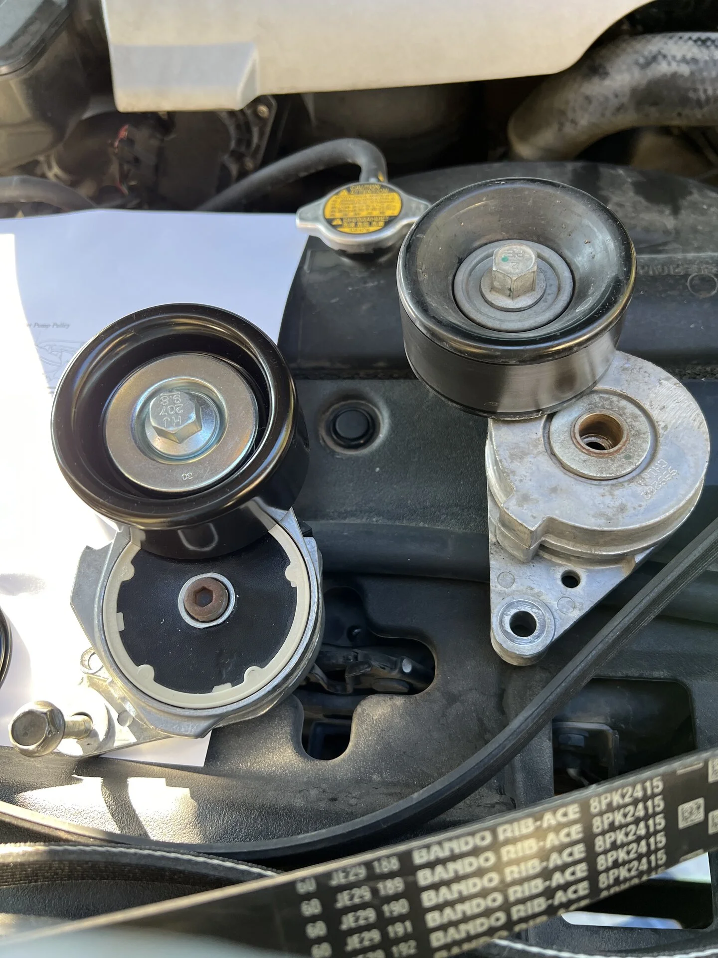

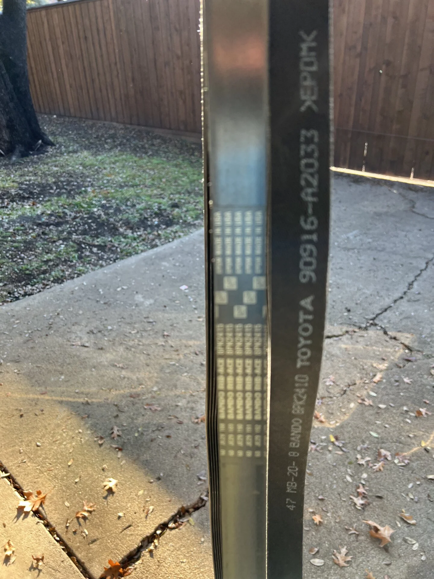

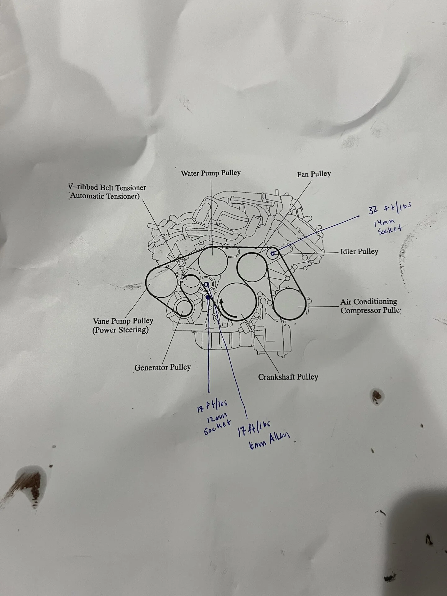

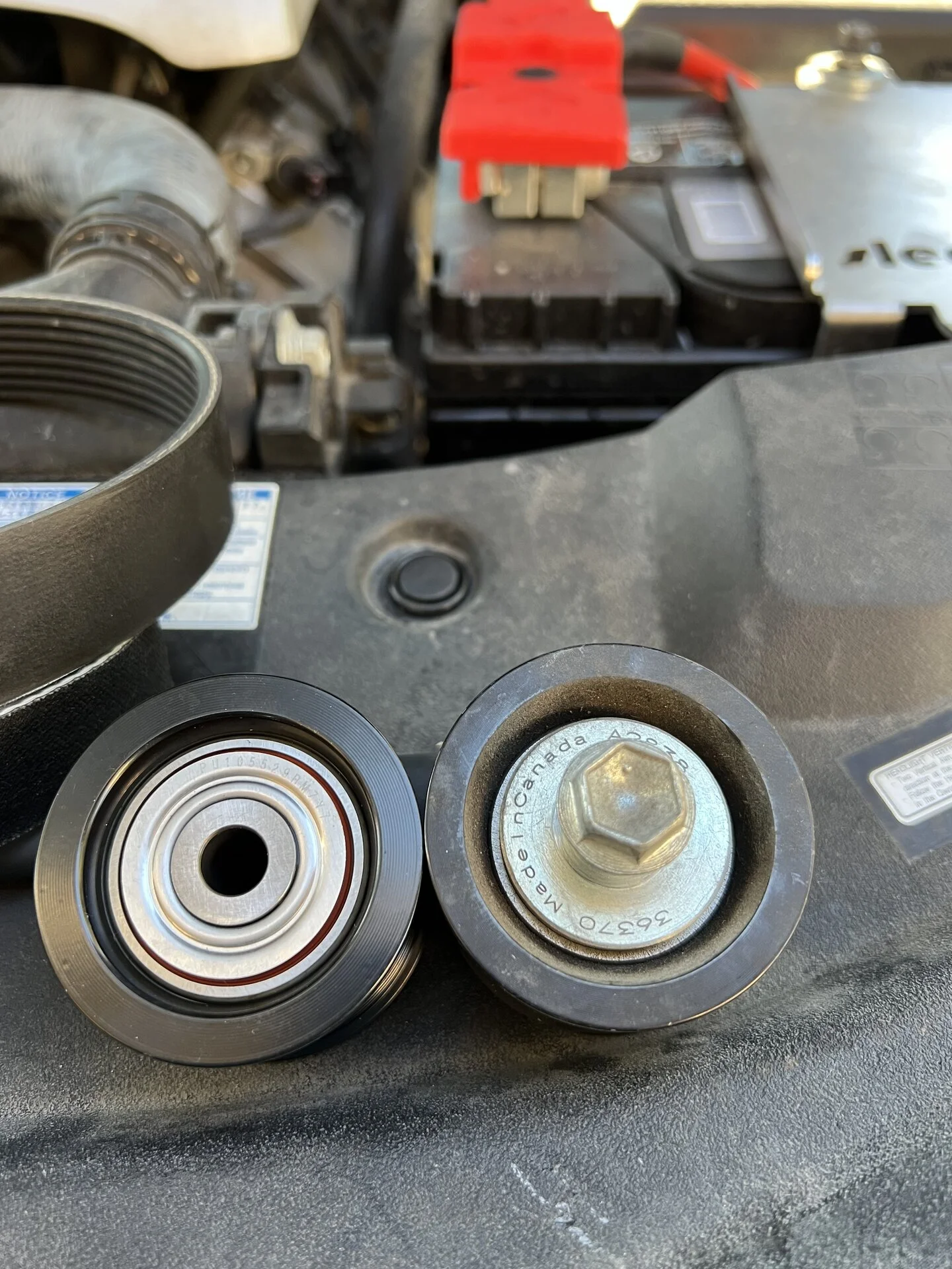

Serpentine/Tensioner/Idler Pulley - Water Pump looks good too!
Took about 2 hours and went from the bottom. Tensioner release bolt is 14mm and is a left thread to allow for you to leverage on it, needed to use a pipe extension.
Torques below for reassembly:
Tensioner - 6mm Allen is 17 ft/lbs
Tensioner - 12mm Socket is 17 ft/lbs
Idler Pulley - 14mm is 32 ft/lbs
Attached in photo's is the belt route diagram to snake the new belt through. I started idler pulley side from the top and worked my way down then back up again and across to the passenger side. Once the belt is routed I leveraged the tensioner again and got the belt over. Did a once over on each pulley to recheck they had been seated and proceeded to adjust them until they fit.

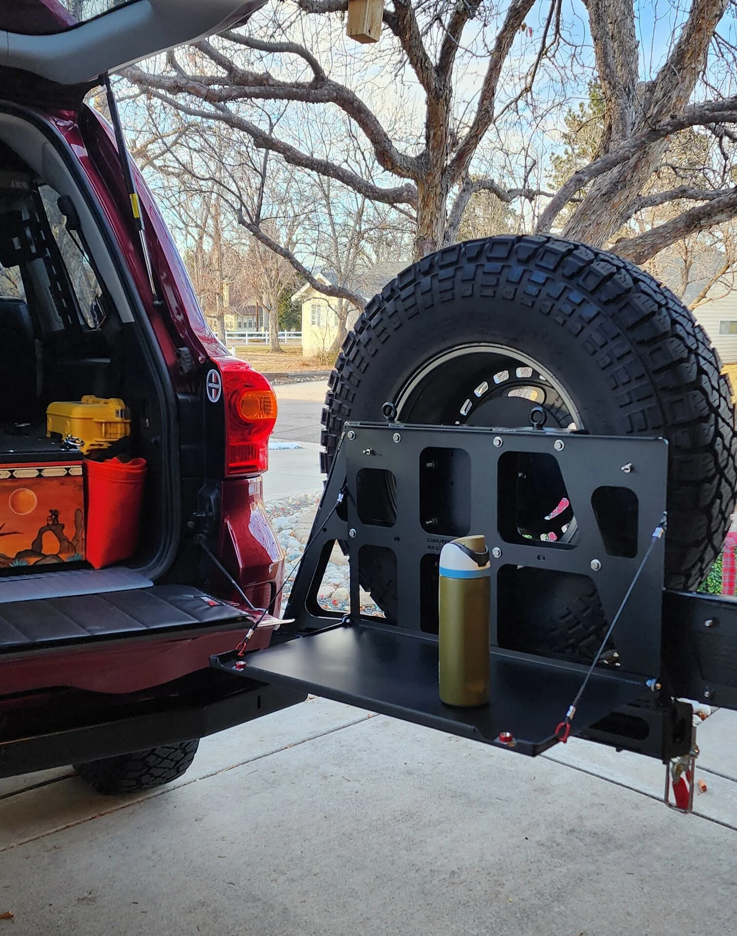

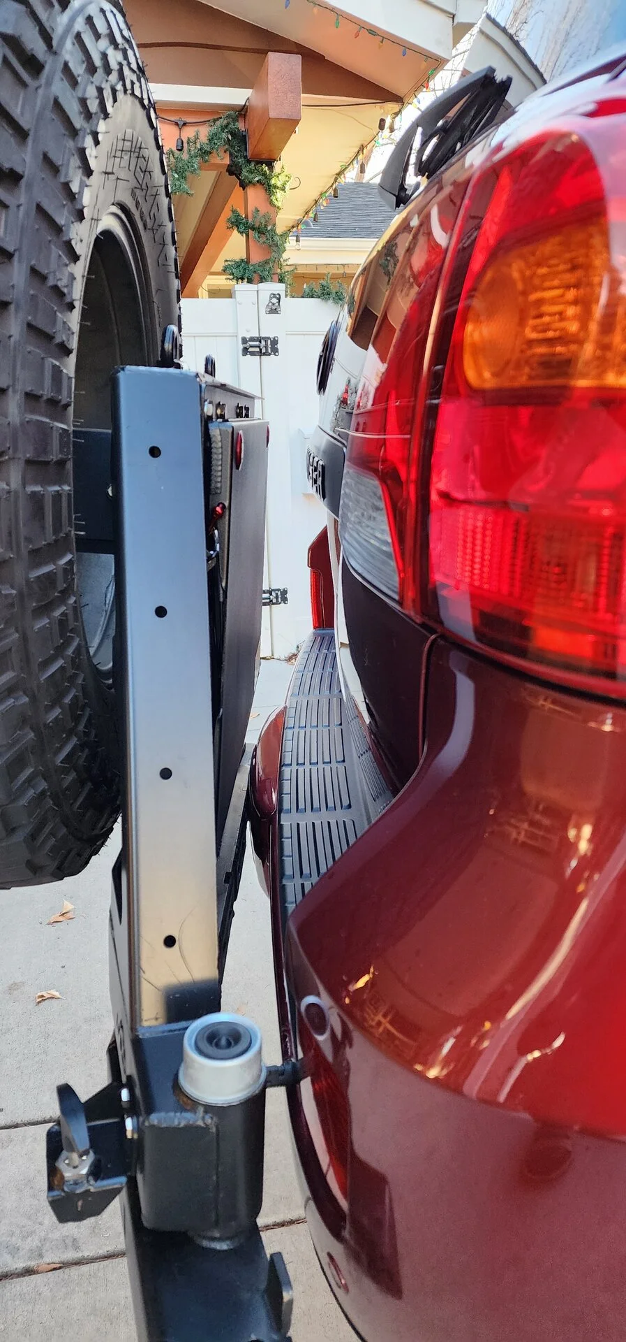

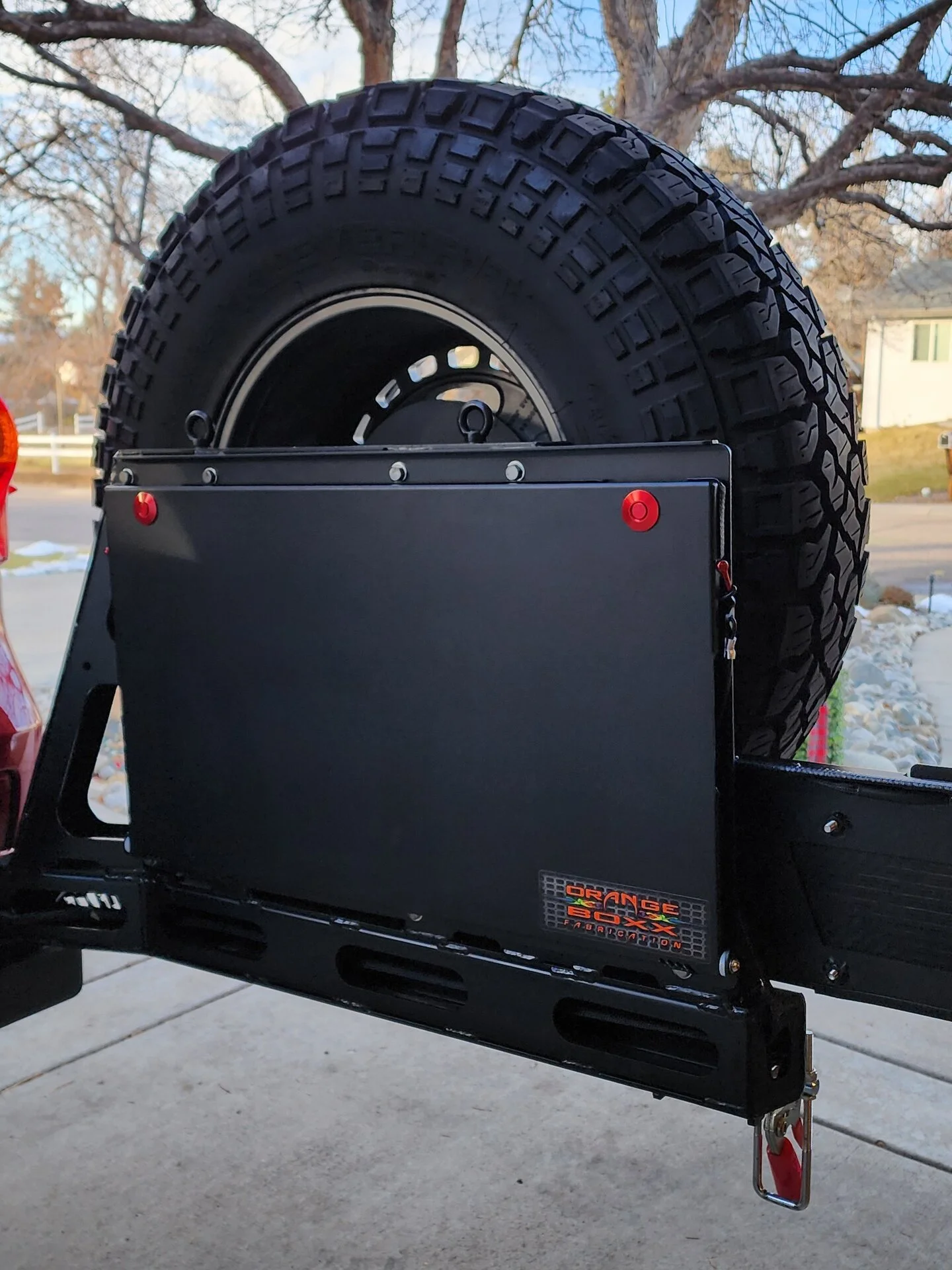

Saturday afternoon project. Added an Orangeboxx fold down table to the LFD hitch mounted swing arm. Very well made and fit perfectly on the arm. Clears the tail gate while down and tucks in nicely while closed. Looking forward to doing some cooking on this.
