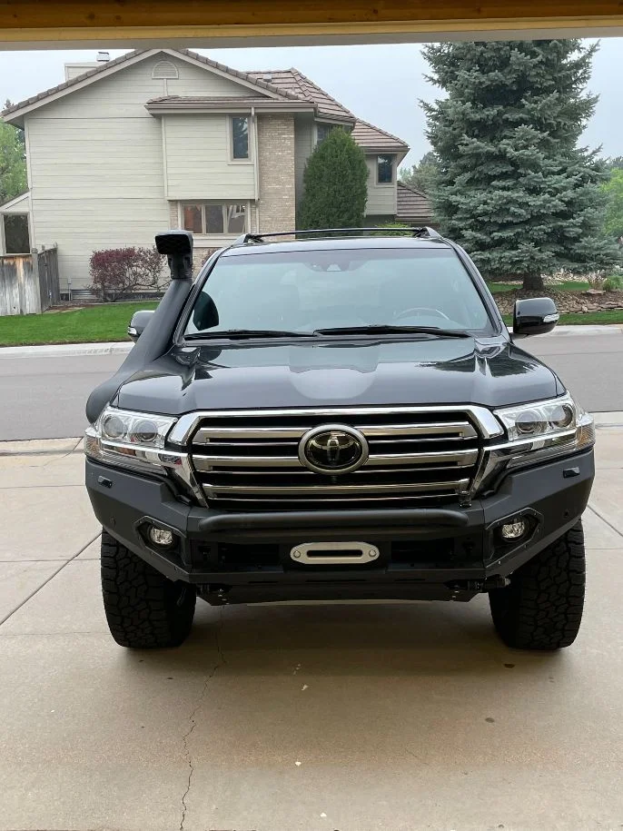

Got my Rhino front bumper on yesterday. Ran into some difficulties with mounting the winch tho. Will need to try and mount it up again later

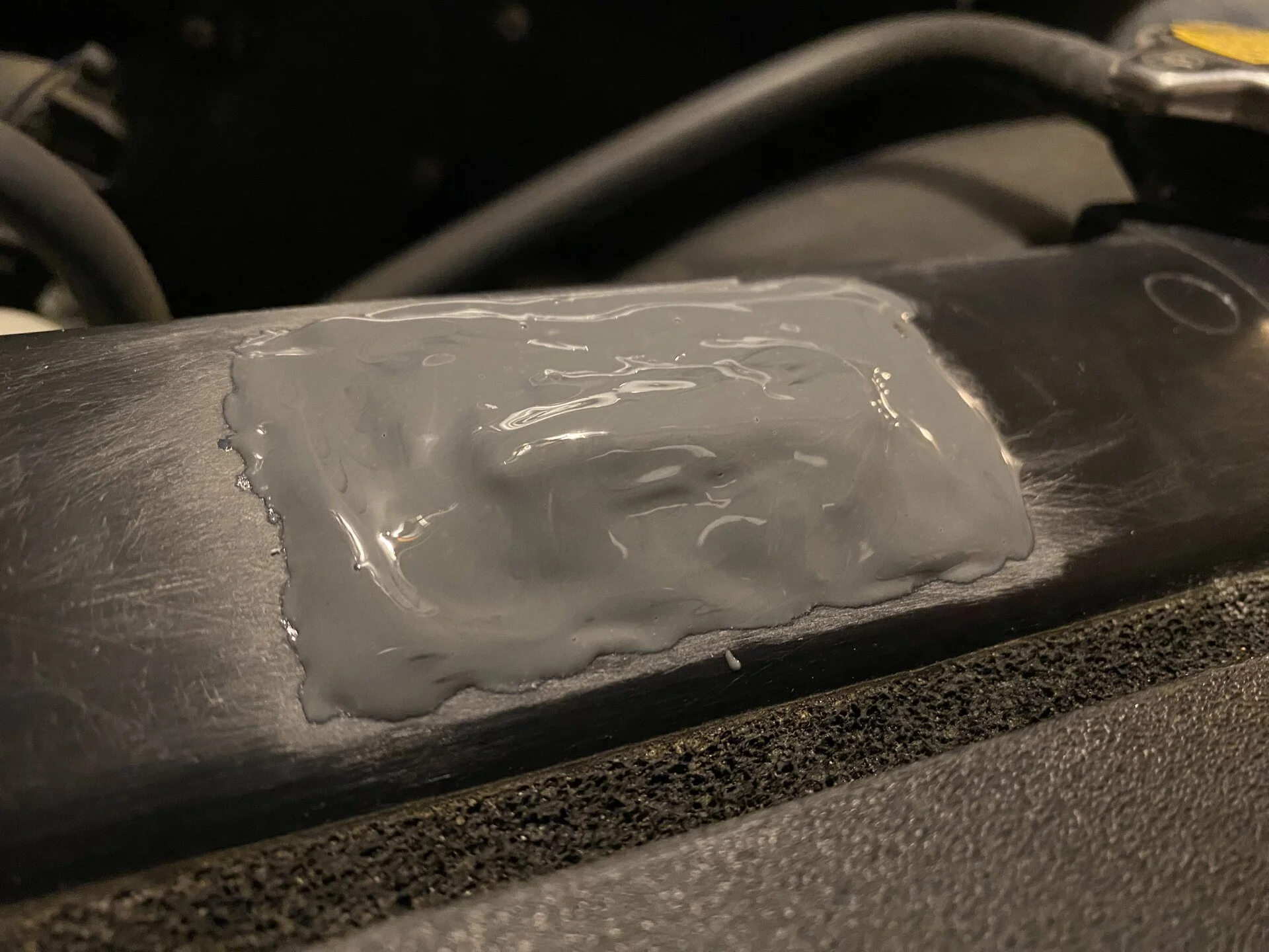

Radiator patch on the ‘13 (80k) while I decide whether or not to replace myself or take it to the shop… or just let it ride until 125k or so.
Went in reverse with the sandpaper. Started with medium grit and the scored it with coarse before applying JB. I used standard JB formula for the patch and let it cure the full 14 hours.
Hopefully that holds, on my tundra i had the same crack, i did the method you did but it eventually seeped out. Such a shame to replace an entire radiator just because of that one weak spot in design.

Looking good. My opinion is that's the best bumper for the 200 without it looking like it doesn't really belong.
How many hours did it take for the install?
Well, if you subtract the time spent screwing around with the winch, about 6 hours. The instructions are....ok-ish? I dunno, I haven't been overly impressed with the instructions from any off-road company. At least compared to what I get with my "regular" car/moto parts.
A bunch of time was spent playing with the alignment of the "wings" to get the body lines correct and leave the proper gap between them and the headlights and fenders.
I need to circle back and install the winch still. What stopped me was the need to at least minimally notch out the gusset on the crossbar that goes between the headlights. In talking with another Rhino bumper owner, he just sectioned it out completely from between the headlights. Which the more I think about it, makes the most sense. That gives free access to the winch and if the winch needs to be serviced it can then be removed without having to remove the entire bumper. So I guess that's the way I'm going to go. I'll keep the piece I remove and if I go back to stock, I'll just weld it back into place.

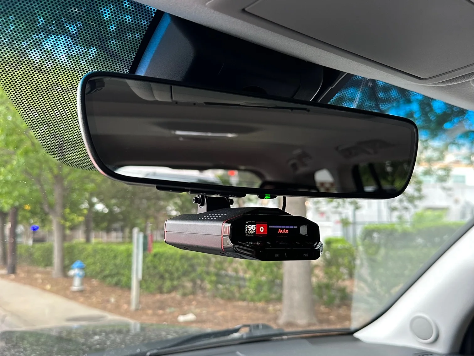

Per usual, my first "mod" was installing a blendmount and mirror tap for the radar detector. The results are so clean. Blows my mind that people drive around with a cord running up their dash when this solution exists.

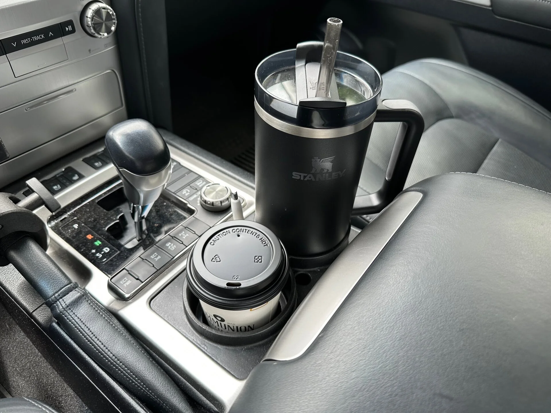

BH3D cupholder installed. Holy crap what an upgrade. Works great for the basic bitch Stanley cup my wife got me.

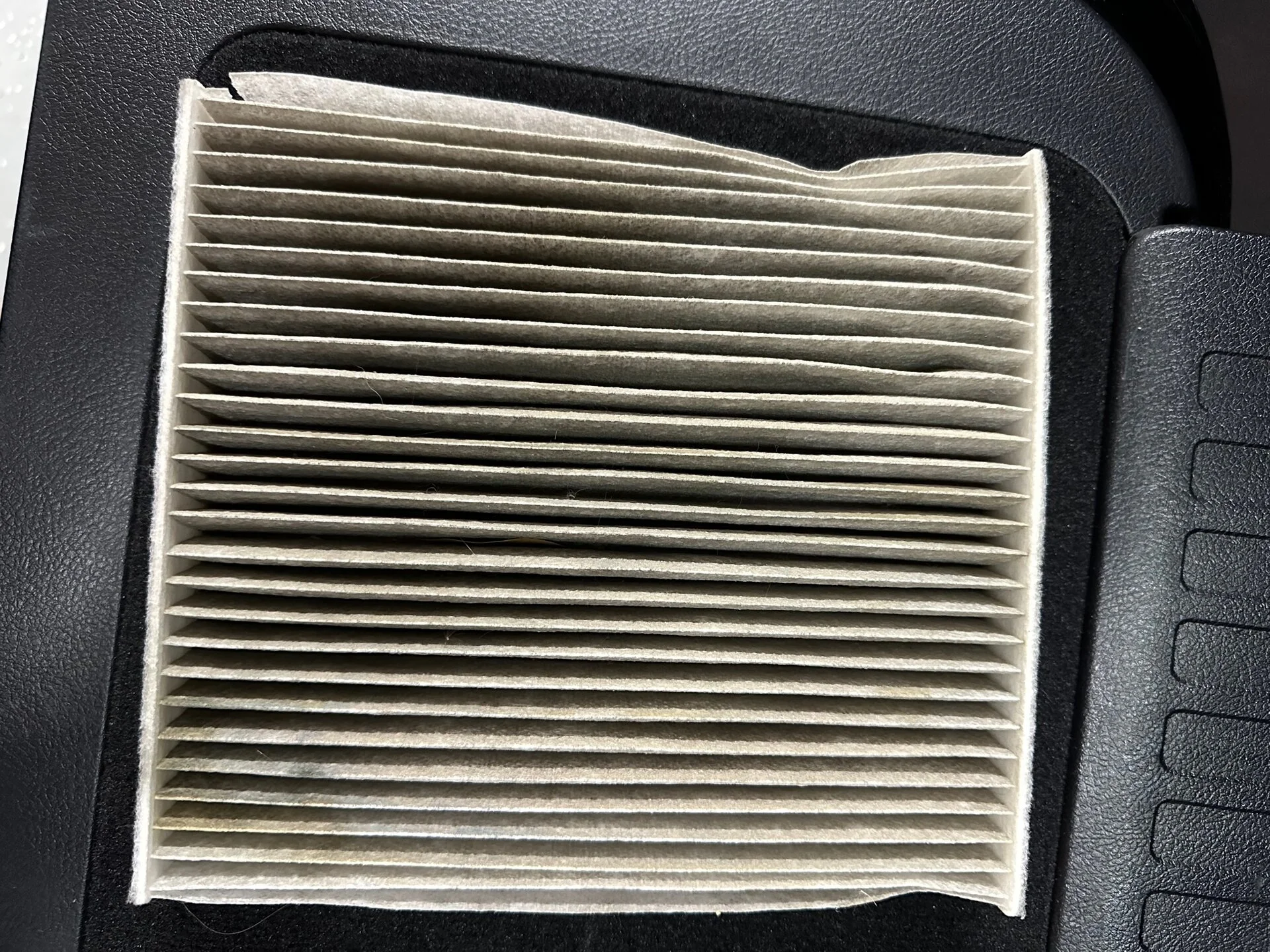

Changed the cabin air filter. By the looks of it the PO didn't do this very often (ever?). Replaced with the Bosch HEPA filter.

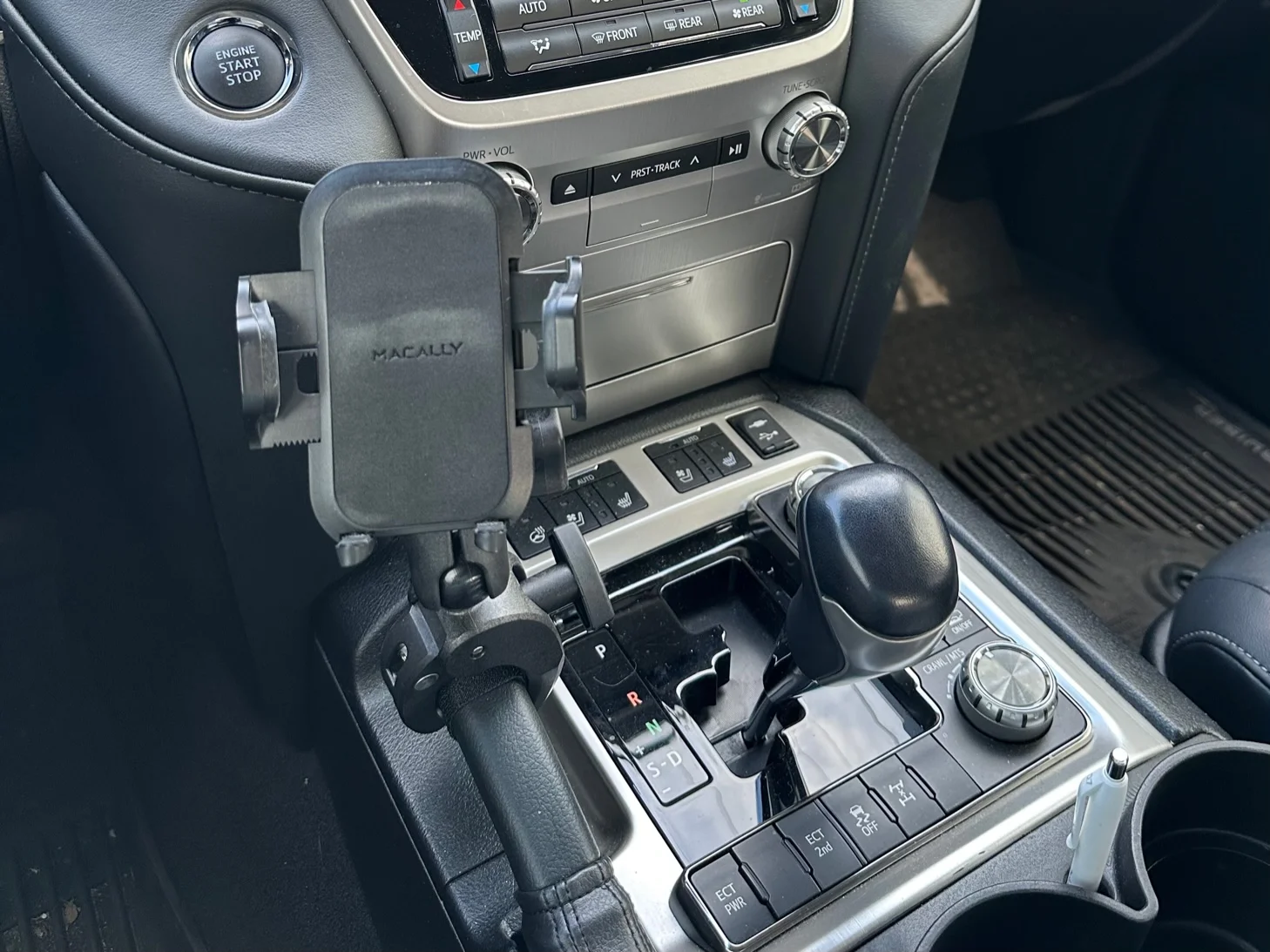

Rigged up this phone mount using a phone holder from my last car, a Ram mount double socket arm, and a knock off ram mount clamp from Amazon. I really like the phone placement as it doesn't block anything and doesn't sit up too high or too low. I'll probably bolt it to the side of the center console at some point to get it off the parking brake, but this is working well for the time being.

“Basic bitch Stanley cup my wife gave me”
Heh heh, heh heh heh (Beavis laugh)

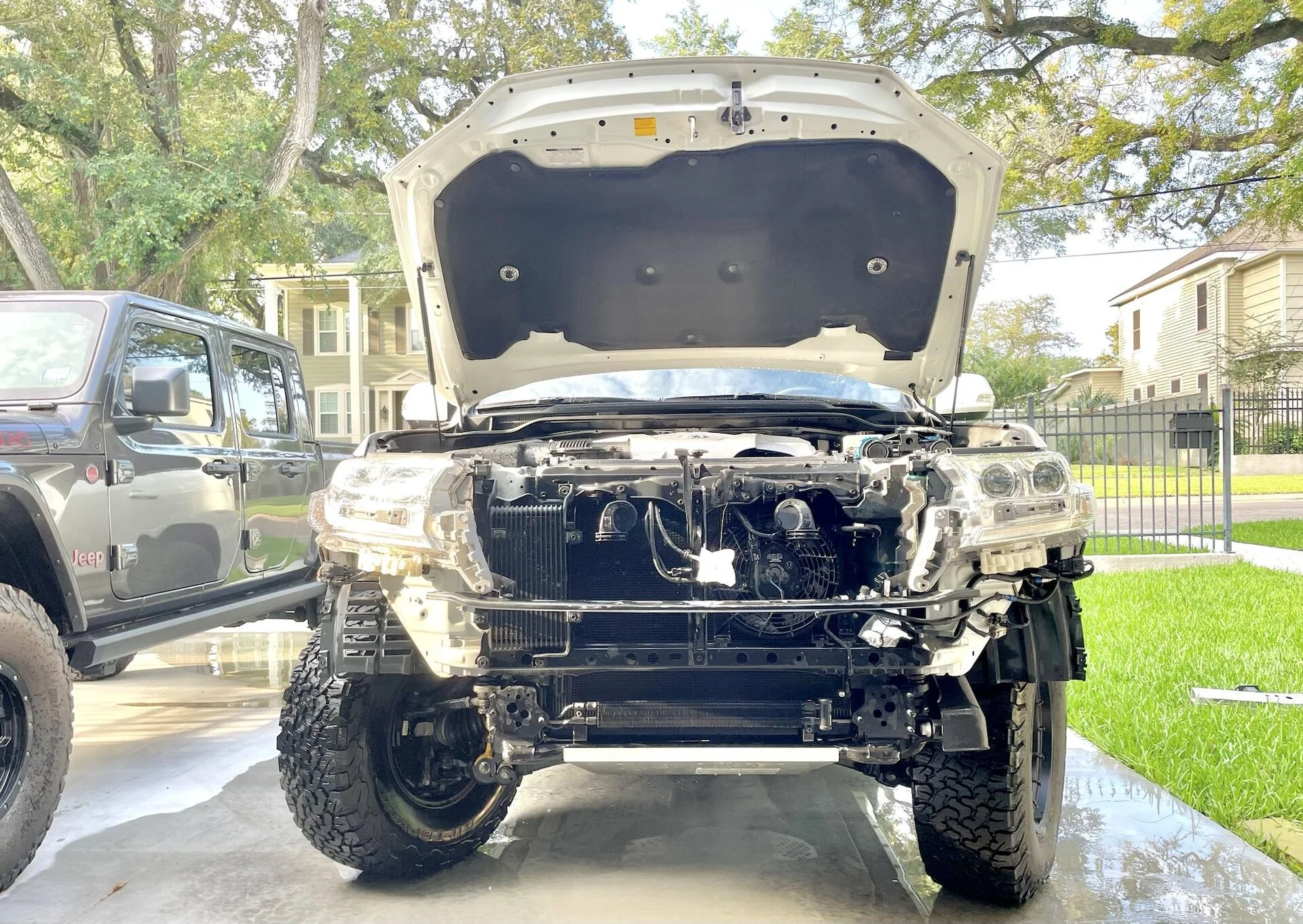

I started the install of the Dissent full replacement front bumper this afternoon. It took nearly two hours to get all of the factory plastics, hardware, clips etc. removed. I pressure washed everything off after the removal and I am pretty certain that I washed out 5 lbs of bugs, grass and other road debris. It is now prepped for the actual bumper install which I hope to start in the morning.

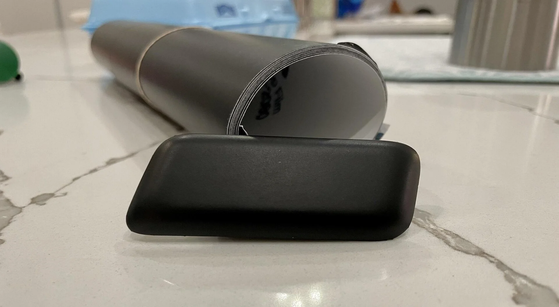

I went ahead and installed the Baja Designs lights in the face plates as well as the parking sensors. I had to open up the sensor holes with a step bit to nearly 1" in order to fit the outer frame clip portion of the sensors. I went ahead and bought new OEM painted black sensors to match the bumper. I also vinyl wrapped the headlight washer covers in matte black vinyl. Considering that this was the first time I have messed with installing vinyl wrap I am pleased with the outcome. I made sure I bought plenty of extra incase I need to redo them in the future.
Fingers crossed everything goes well with the remainder of the install.
