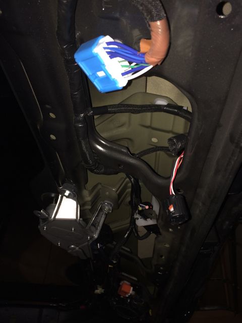

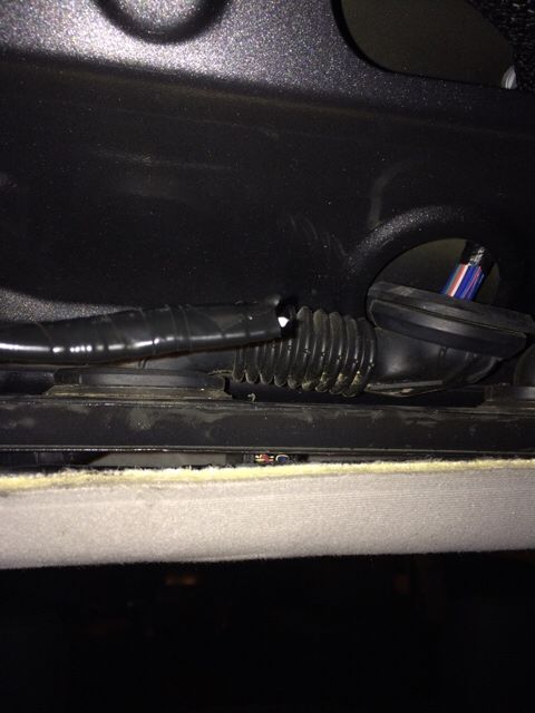

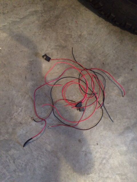

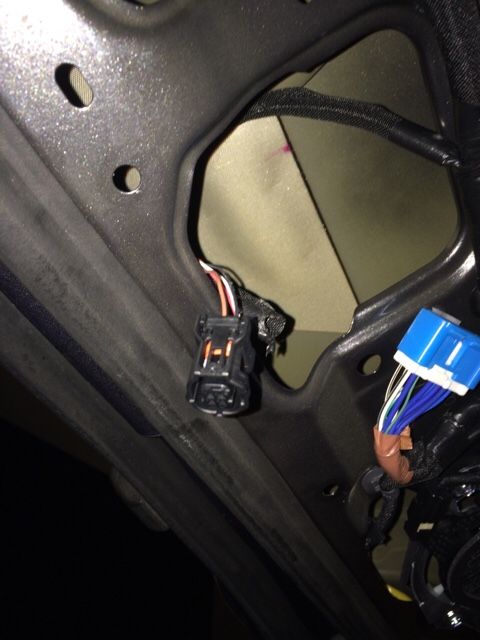

Thanks to those who alerted me that my tow harness was missing. Went to dealer and they confirmed I should have it and ordered part in for me. Here are pics if yours is missing.

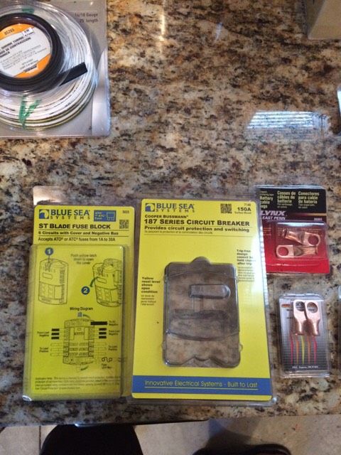

Today I addressed all of my past rush wiring jobs and did it correctly. Took notes from @pdxlc200 in a post he had some time ago. View attachment 1120475View attachment 1120476View attachment 1120477
I am pretty much going this rout also. Here is my delima. I worry about water splashing or actually up into the fuse block or circuit breaker. I have six current loads and adding another for the rear power for the fridge. Right now these are in those covered fuse holders that are actually water proof. I'm thinking of trying to put up higher in the engine bay where I currently have my differential breathers extended.
Although these Blue Sky components are marine rated for splashes mounted vertical and have covers, mounting horizontal could let the water settle into the fuse area.
I guess I really don't plan to have water crossings that are higher than the bottom of the windshield - and I know the engine bay is pretty water tight. @pdxlc200 @Willy beamin ?? Thoughts? Others?

personally - I have no desire to ever get in deep water anytime soon with my rig. Never even questioned the mounting but it is a good time to think about all possibilities. The fire wall might be a bit higher (and it's vertical) but its tight for space (running wires). You could explore mounting the components on the underside of the fuse box lid - the reverse of my final mounting placement. If those fuses get wet you'll have bigger issues than the LED's and fridge not working - ha
good question on the horizontal vs. vertical mounting - skeptical thinker
just get a bigger lift and 37's and don't worry about it - walk on water
I see now your concern - you have a snorkel so you're already set up for deep water crossings.
@pdxlc200 might have a better answer seeing how he has been running this set up for a while.
