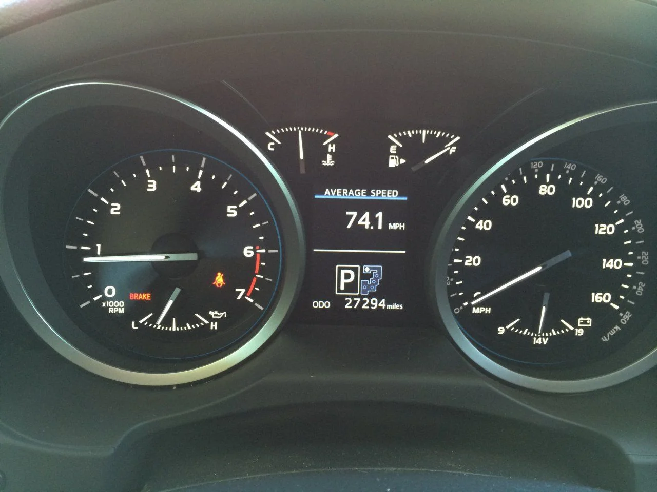

I put 4,800 miles on her driving from CLT to CO and back on a hunting trip ... OK, it was actually 1,898 miles over 2.5 days out ... 0 miles over 3.5 days ... and 1,865 miles over two days back ...

You've been hauling if your average was 74.1mph. Hope your hunt was successful.

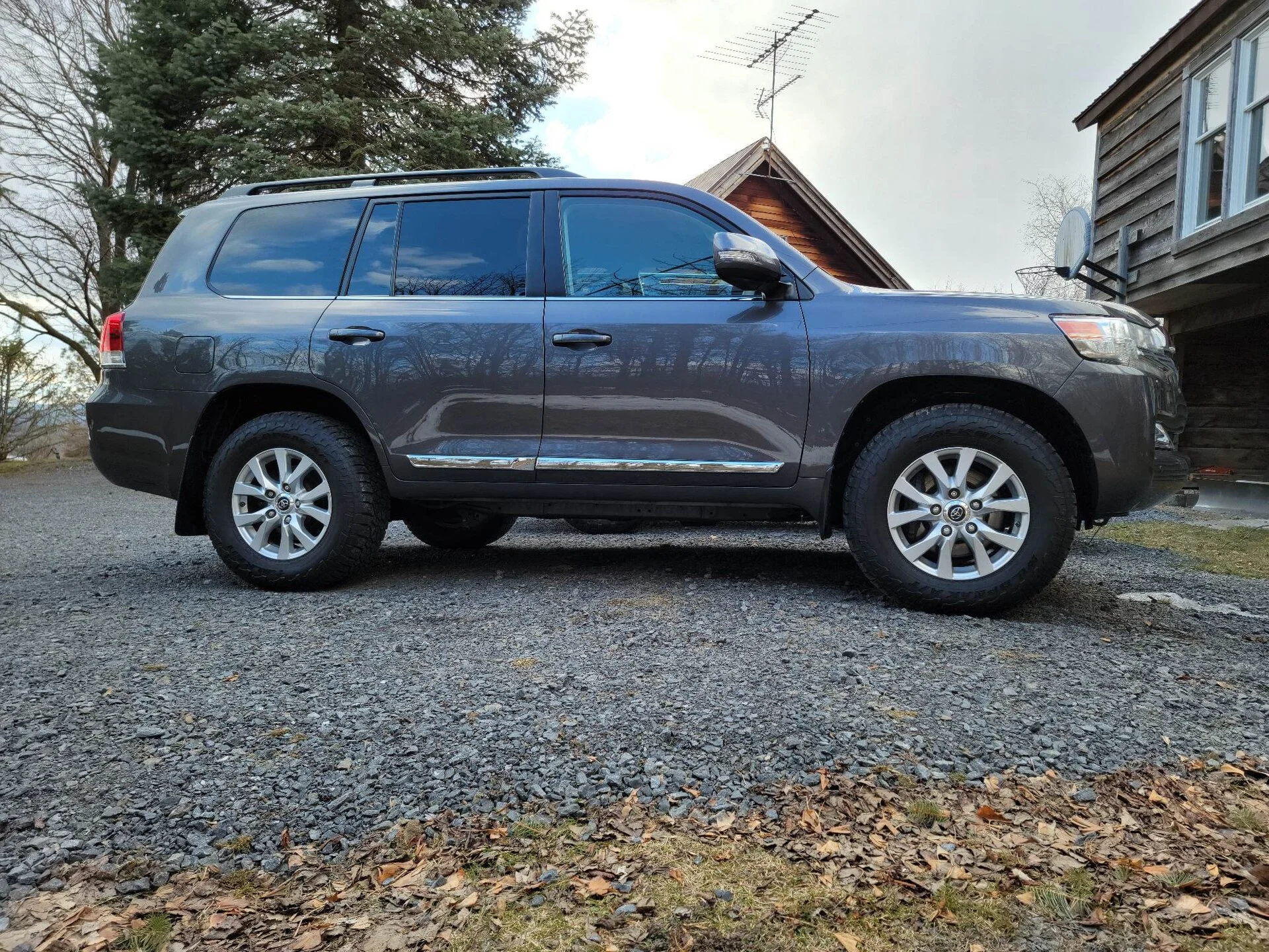

Pulled the running boards, easy peasy!

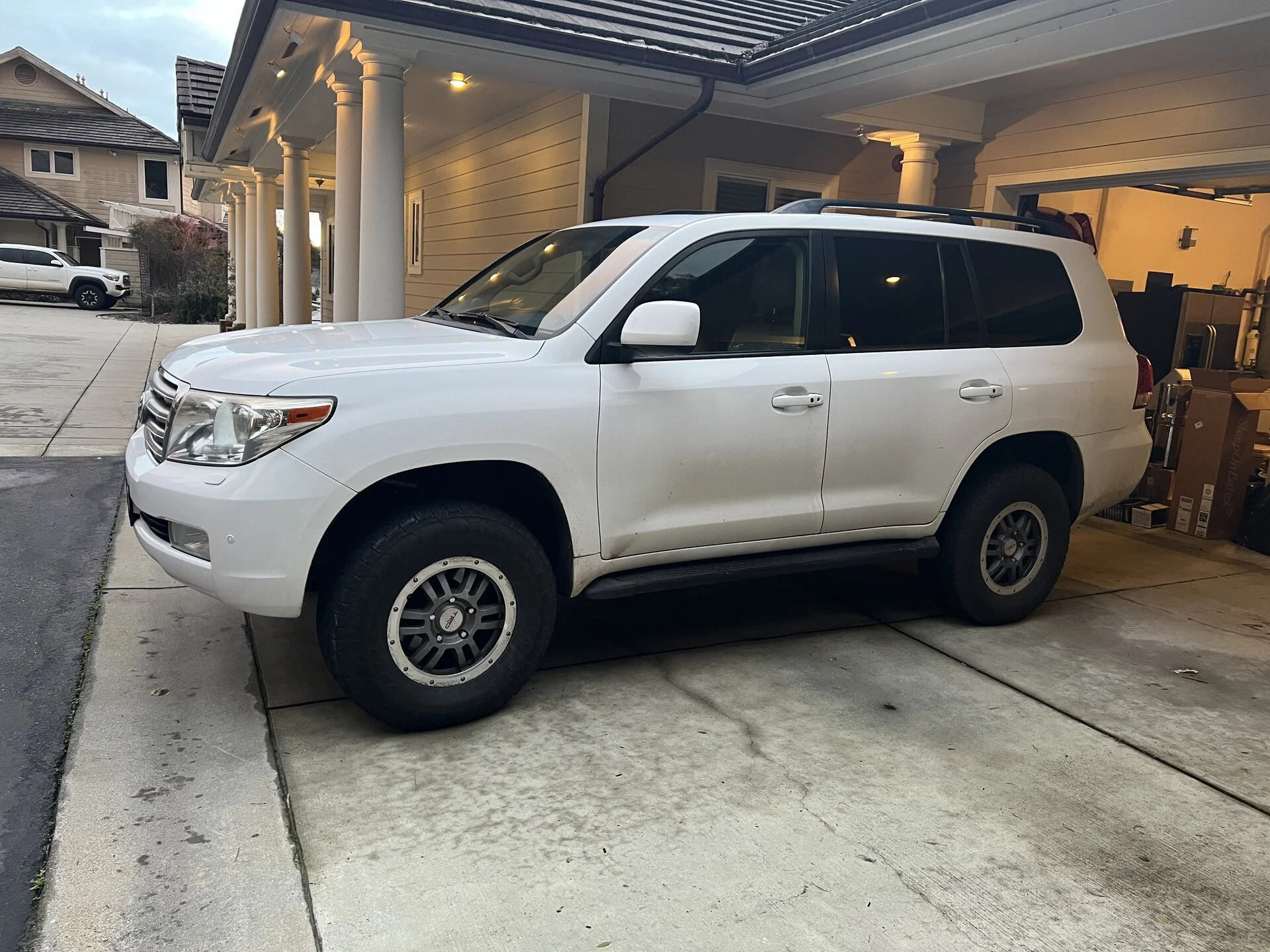

Took a step back down from the OME 2724 springs to the OME 2723 and added Airbag Man HP5051 kit.
Also removed my Gamiviti roof rack and replaced it with a factory rack.
Do you plan to part with the Gamiviti?? I have one on my 100 series and I've been toying with the idea of picking one up for the 200. You know, for the sake of symmetry.

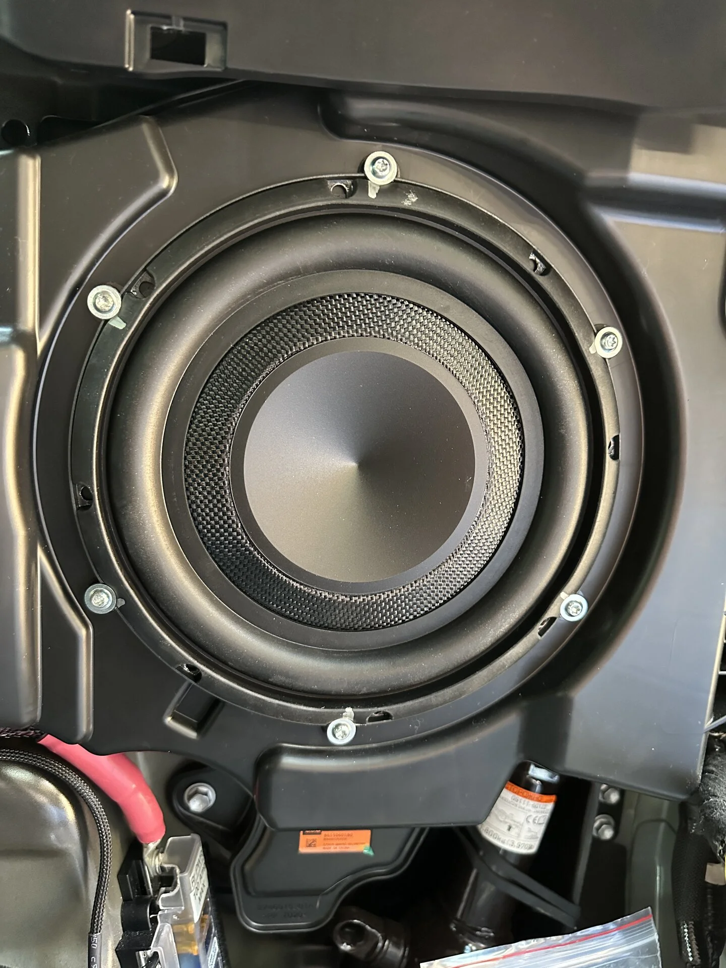

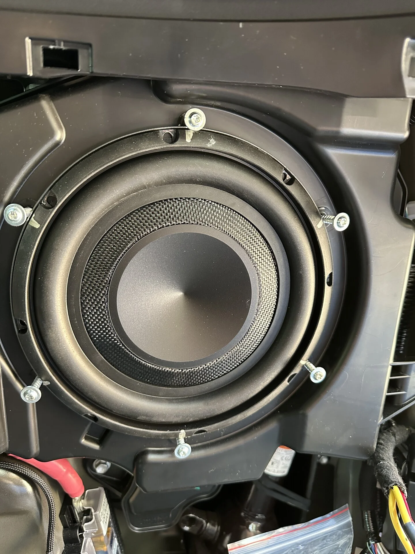

Stock amp? If not, what are you driving that with?
Stock amp. speaker doesn't buy much but I had the panel off anyways. Same impedance and similar efficiency to stock, so just a higher quality part.
Don't want to be a party pooper, but the posted efficiency seems to be optimistic. This speaker was reviewed on "Erin's Audio Corner" where he uses a Klippel to measure drivers.
Here are his results: (TLDR - 91db advertised vs 86db measured)
Frequency Response:
  • Since this is designed as a woofer and not a midrange/woofer, the average sensitivity is calculated from 40Hz to 300Hz rather than my usual 300Hz - 1kHz. From 40-300Hz the average sensitivity is 80.1dB at 2.83v/1 meter at 4-ohm. At 1-ohm nominal the sensitivity is raised about 6dB to an average of 86.1dB at 2.83v/1 meter.
  • On-axis response linearity is not reasonably within ±1.5dB thanks to the resonance at ~80Hz.
  • On-axis response linearity is ±3.0dB from 32Hz to 300Hz.
  • There is a 5dB drop in output from 100Hz to 300Hz.
  • Upper frequency response is limited to 500Hz where a strong resonance occurs. But, again, this drive unit is not intended to be played above 300Hz per the manufacturer. This data simply points to agreeance with that and a cautionary tale should someone wonder if they can push the upper end limit above the 300Hz recommendation.
Although, possibly being able to get the 1 ohm load and fit the enclosure may make it best aftermarket option anyways.

So this begs the question what does the OEM speaker produce and for how many minutes before the paper cone disintegrates into distorted mush.

Measurements (freq. response) have relatively little influence on tonality and musical performance.
This is actually a positive here. ^
And both these points are irrelevant
There is quite a bit of data and research out there that suggests otherwise about measuring of speakers and determining overall performance, but to each their own...The audio reproduction industry in general has functioned on false narratives and snake oil for decades, so this probably isn't the best venue for that discussion.
I was really only speaking to the discrepancy in efficiency since one of the OPs goals was replicating the efficiency of the OEM speaker. I agree for a car audio sub, the other factors listed are not meaningful faults. But, also, I don't think the listing was ever intended to be a "list of faults" as much as a description of the characteristics of the speaker. To be fair though, the reviewer did have an overall negative review of the driver, at least relative to some much more expensive drivers that also don't fit the OPs size requirements, so his overall analysis doesn't really apply to this situation.
Speakers are like spouses: What is a good spouse for one is not good for another. I have been asked by friends, family and such what do I consider the best speaker. (I am one of those idiots that spent entirely too much on my home system) I always tell them that the best speaker is the one that sounds the best to them. The only time I have given any attention to speaker efficiency is to make sure my amp can drive them without going into clipping. Lower impedance requires more current. Also, impedance is frequency dependent.
