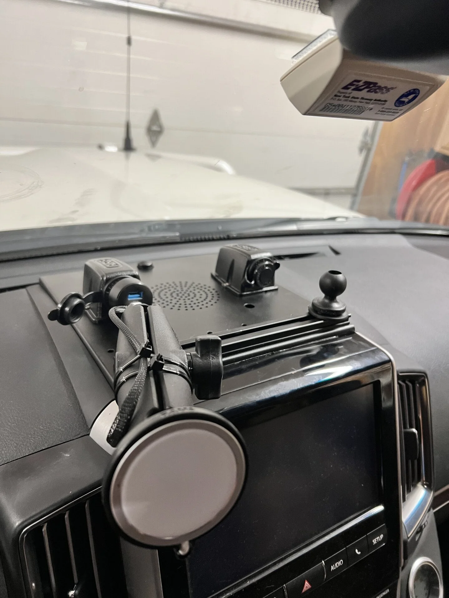

Giamviti Dash Mount added this week. I ran (2) 15A cigar plugs (Blue Sea) in ARB Fridge plug holders. Also added Ram Track mount for phones and maybe future Garmin Overlander or something in that lineup/iPad Mini. Ran #10 power/ground to a Blue Sea Fuse block. Wired hot to Aux Group 31.
I like this a lot. What did you paint the gamiviti panel with?

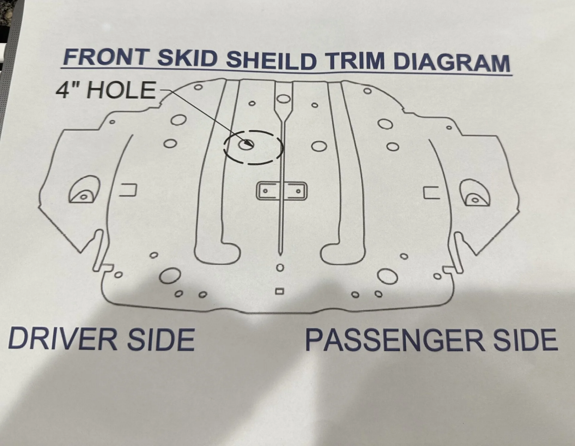

Was going to install a Curt Front Trailer hitch today. I've had these on our farm trucks and they are handy as heck when moving carts that steer
at the front where the hitch is located.
2" FRONT RECEIVER HITCH, SELECT TOYOTA LAND CRUISER, SEQUOIA, TUNDRA #31198​
Unfortunately, the diagram for the cut-out for oil filter access is 100% wrong. Glad I put it on the lift
and had a look first.
From the looks of things I may be better off with a rectangle or square hole. A fabricator friend can make a cover. Will use Rivet Nuts to secure it. Stay tuned.
PS: Contacted Curt, fwiw, to let them know. Pretty sure shield is NOT spelled "Sheild"

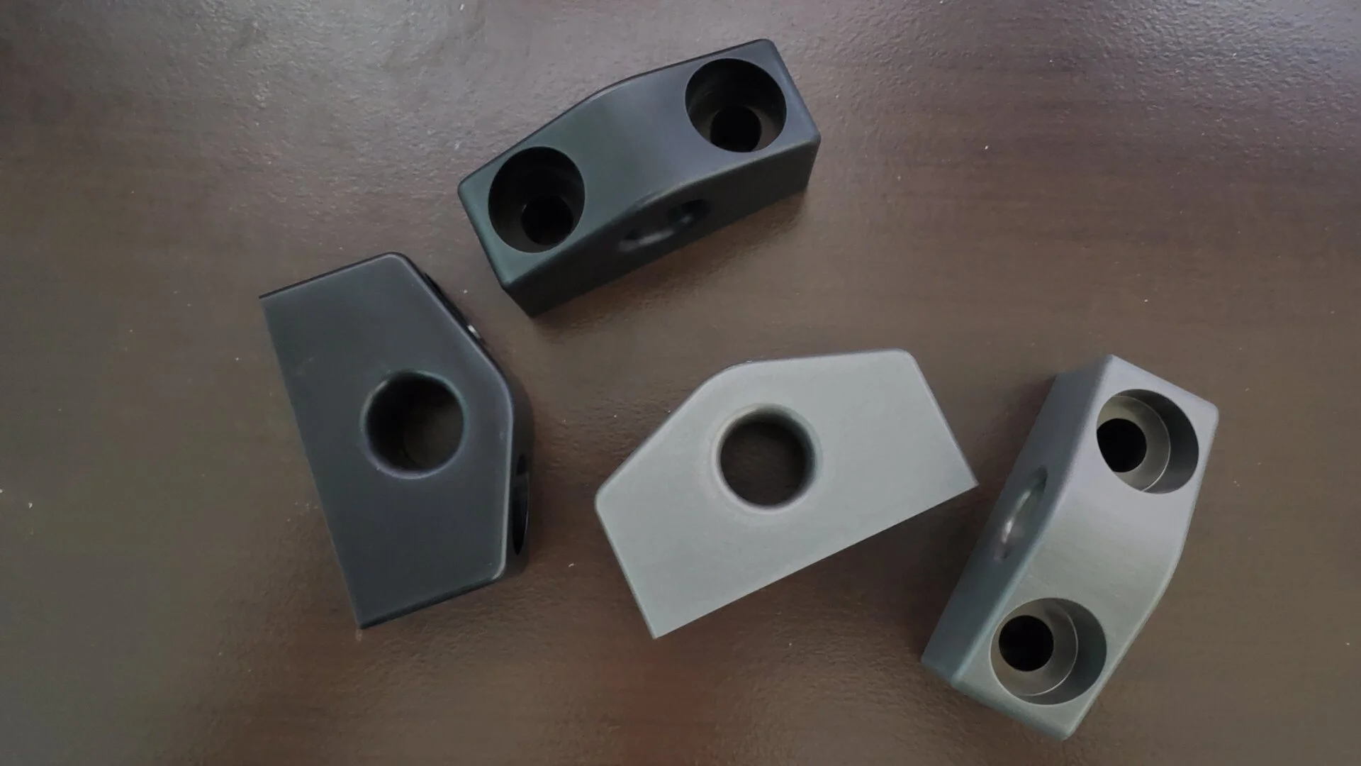

I launched my site and ready to accept orders on it.
www.ee-offroading.com
I only have limited supplies of the following:
Low profile front recovery points in black and clear hard anodize, which are ready now.
I will have a couple sets of red anodized ones for pre order, which should be ready in a week.
Low profile recovery hitch for soft shackles (as far as I know, this only fits the 200 series)
I have 5 uncoated for sale now, with black\clear hard anodize and red anodize that will be ready in a week.
RLCA brace\skids
I have a few of these in stock
Use promo code LAUNCHSALE23 to get 15% off your order. Sale ends 1/15/23
There are some product reviews from some members that I pulled from here, if you want me to remove them, I will.
Thanks everyone for your support, really appreciate it!

Interested to see how this comes out.

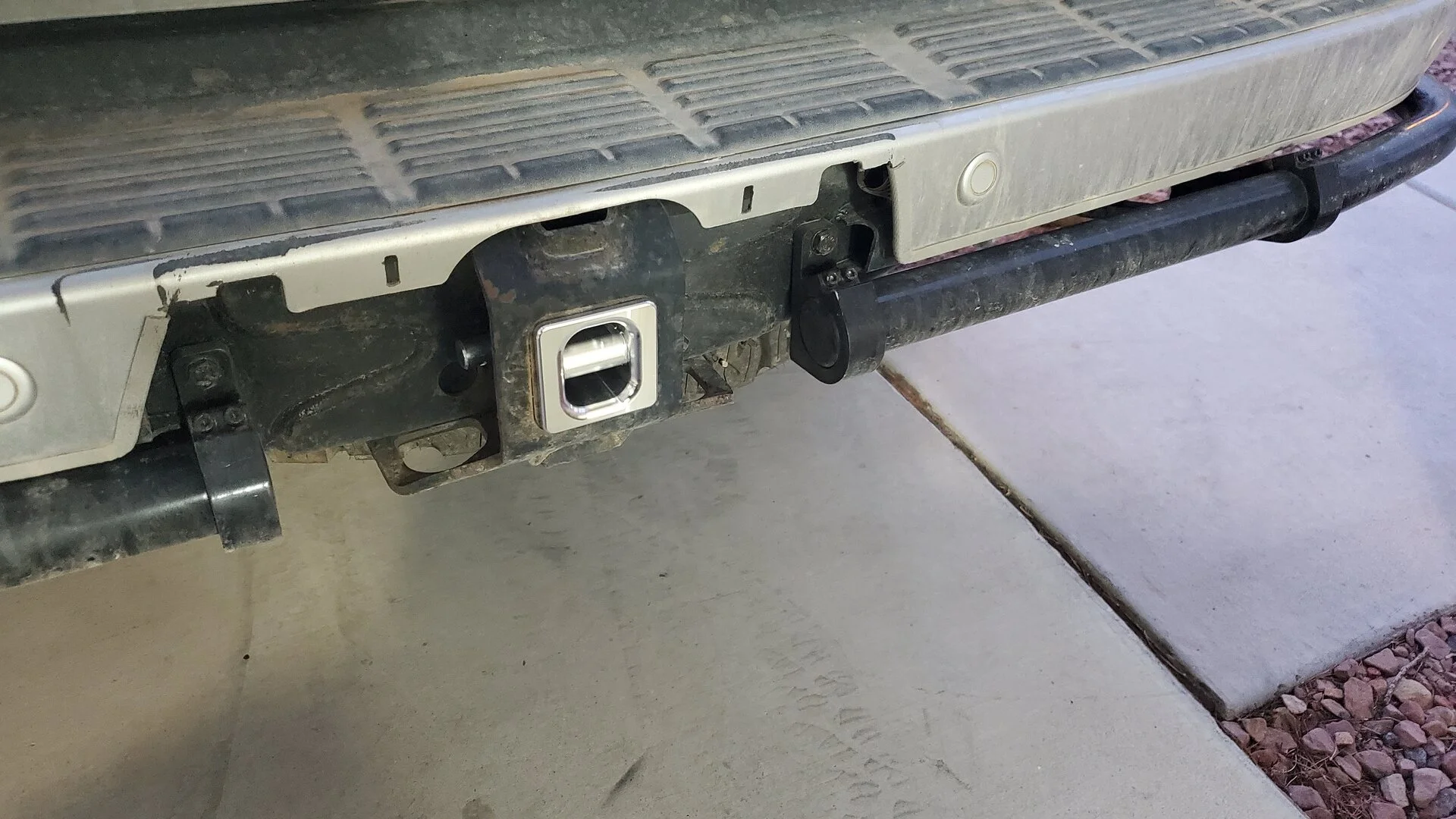

Love the low profile rear bumper!

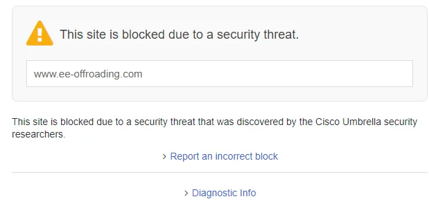

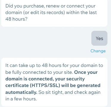

my company's IT has blocked your site -- just an FYI so you can work on getting past this
My day job company IT blocked it as well, trying to figure out why. Hosting site is through wix.
Looks like you need to get Cisco to think your site is safer. Probably a lot of companies use Umbrella for DNS security.
yeah, we use cisco too. This is what the wix bot said.

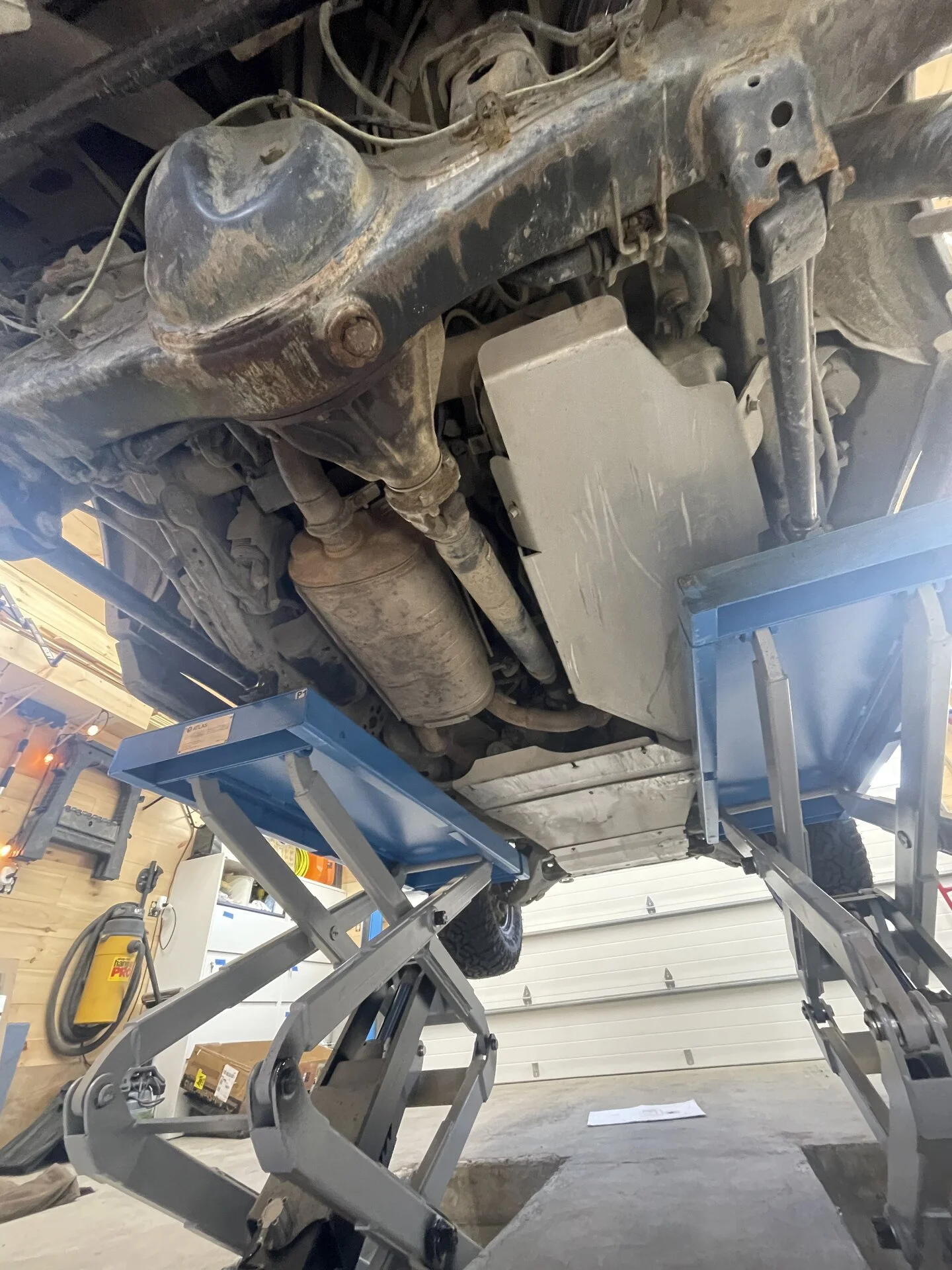

BTW can you post some more pics of your rig lifted up high enough to stand under? I’m diggin’ your lift and just wonder how much is blocked underneath. All I really need is to be able to remove all my skids. It looks like it may block KDSS valves or make working on sliders tough but not having posts and a frame in the way for the 90% of the time I’m doing something looks like a good trade off.
Does this help?
It's working on my work network now. It was being blocked as it was a "newly seen domain".
Yep no longer blocked on my end - good luck with the venture
I was going to quote how your rear end is as messed up as mine, and that it would be awesome if a company made rear diff skids for 200s. But i know the hivemind is completely against diff skids "its not needed"
Sand paper and a rattle can, sand paper is optional.

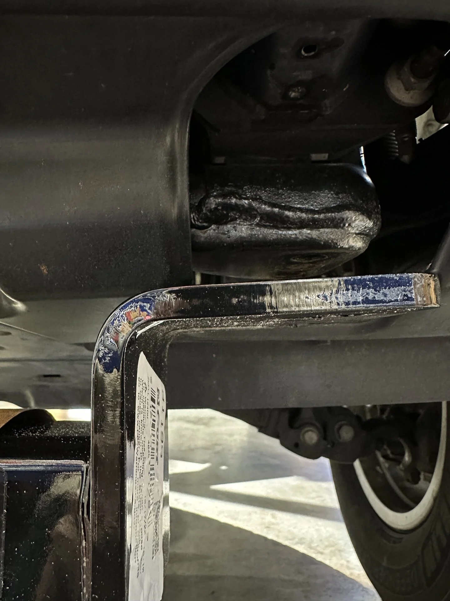

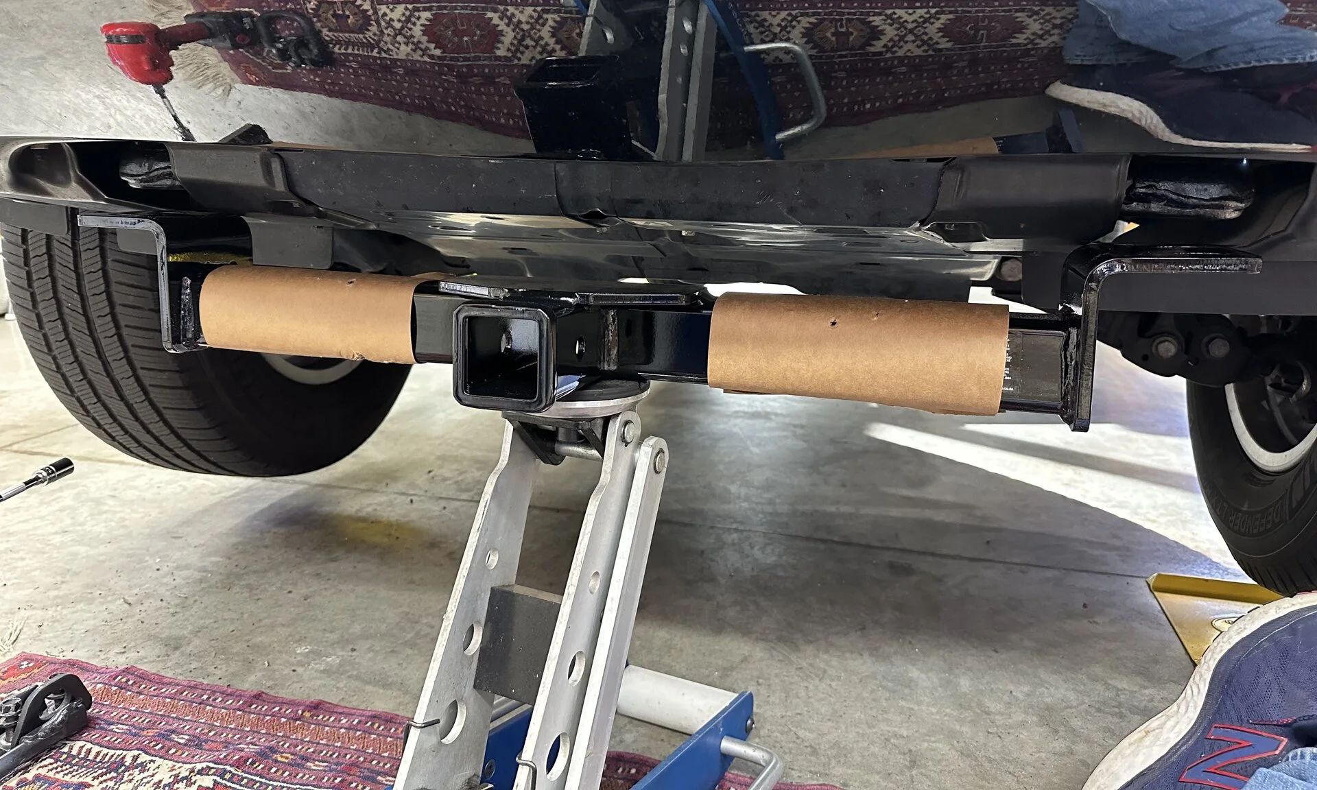

Upon further review I think this is going back. I'll have to cut things to make it fit and that's not happening. Have a local fabricator that can do this
in his sleep and it will fit perfectly. Of course it will cost more. This one size fits all it getting old. Heck, I may even just bite the bullet for a front bumper. ;)
That's a real ground clearance killer. Do you want this so you can tow the LC, or is this for mounting attachments?
Might talk to Trail Tailor, or one of the other guys who makes a hidden winch mount for the 200 and see if it can be modified to have a 2" receiver on it. You' definitely have to cut up your bumper for the receiver to pass through with that option though.
