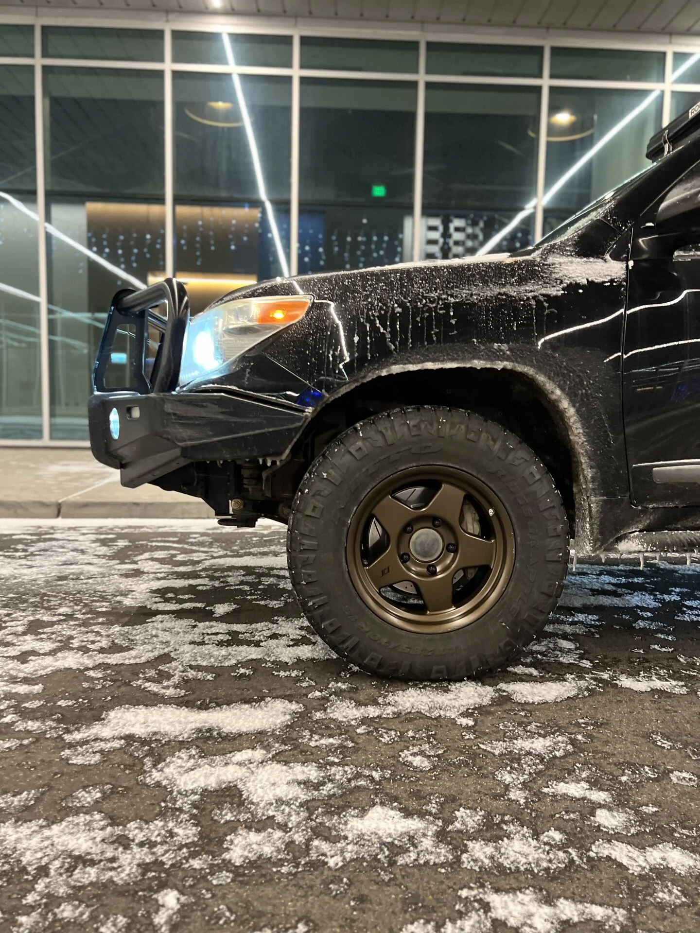

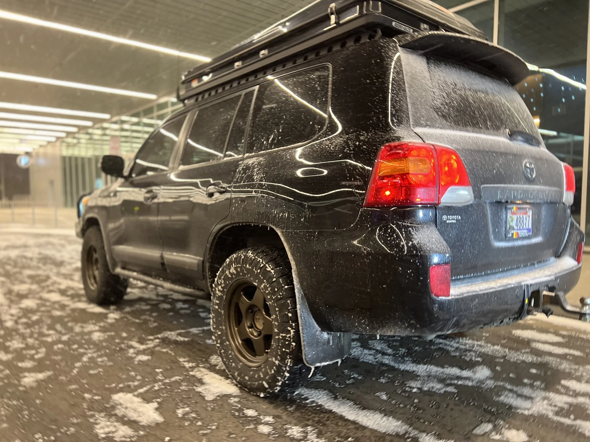

Here you go bud. We had a blue bird day today and it was above freezing, best I can do 😎
👆interesting to see how much positive camber I have in high mode

It’s still wild to me how good these things look when built all the while they retain their nice plush lux suv ride.
What’s your camber? Looks very positive.
Truck is in high mode here. Camber is within spec at normal height which is what it’s aligned at.
Stock alignment calls for pretty much 0 camber at normal height for the LX. Interestingly the LC calls for a touch of positive camber at stock height.
Camber
Left - right error
0°00' +/-45' (0.00° +/-0.75°)
45' (0.75°) or less
I have about -1 of camber dialed in at stock height for a few reasons. A bit more cornering grip, helps the tall profile tires not roll over as much corning, a bit more clearance at the top of the fender, while also helping against too much positive camber when in high.
The positive camber might not be a bad thing in high as it gives a bit more safety against rollover when in high, by reducing front end bite.

looks really good man. Now go get that alignment lol.
Your passenger is too positive, but its not necessarily bad if it was lined up for road crown.
I think it may be just a tad too much.

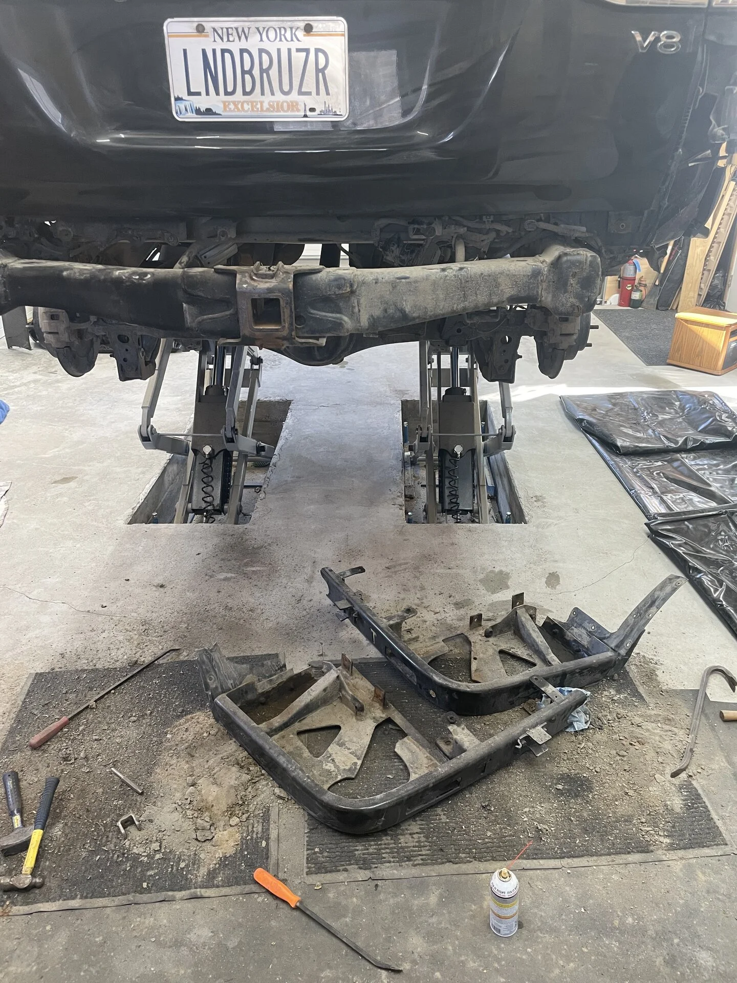

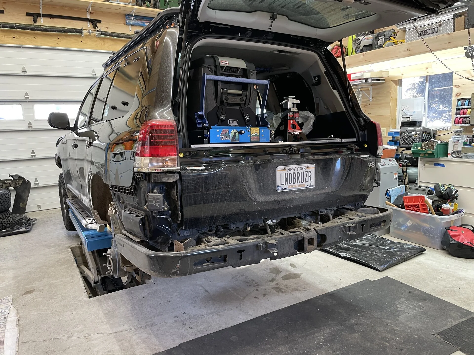

Started removing my modified Kaymar to swap to a Dissent.
I’ve got lots of cleanup and rust remediation before the Dissent goes on. Swapping due to higher clearance, lighter weight, different swing setup.

cool floor jacks, i need a set of those.
