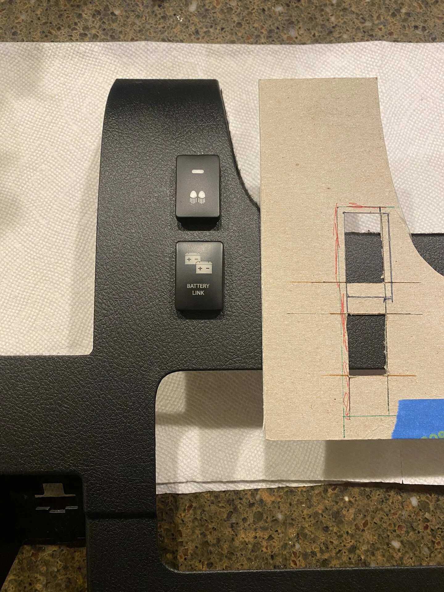

Adding two circuits this week. First a link switch for the Blue Sea ML-RBS 7713 Magnetic Latching - auto release Remote Battery Switch to link an independent auxiliary battery for jump starting or high load needs such as winching. And second a auxiliary reverse light 'lock out' for when the extra lighting is not needed. I was out of real estate on my normal switch positions and looked for somewhere unobtrusive yet reachable.positioning do to the behind the scenes dash framing and mount tab locations. As I had only one shot to destroy the panel, I made a cardboard template and even mounted the switches into position with the template.
Need a pic of that installed in the truck! Looks super clean and OEM. Well done.
