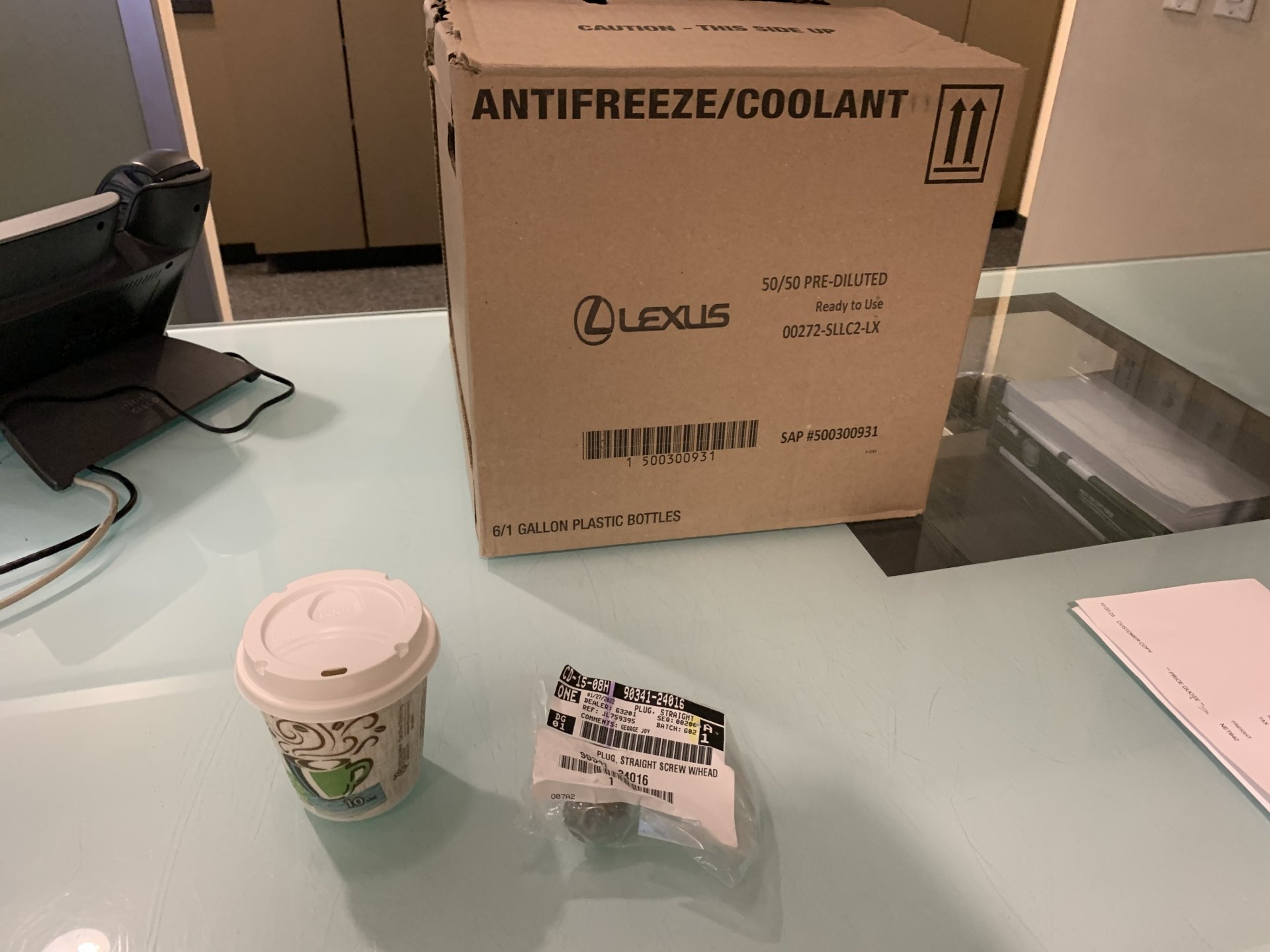

The Kaon dudes have figured out a great way to remove the plug with the below tool and they also sell a new drain plug that does not use an Allen key will save you the headache of dealing with that stripped plug. Just go to Kaon’s website and pick LC 200 in the vehicle type. They know the 200 very well​

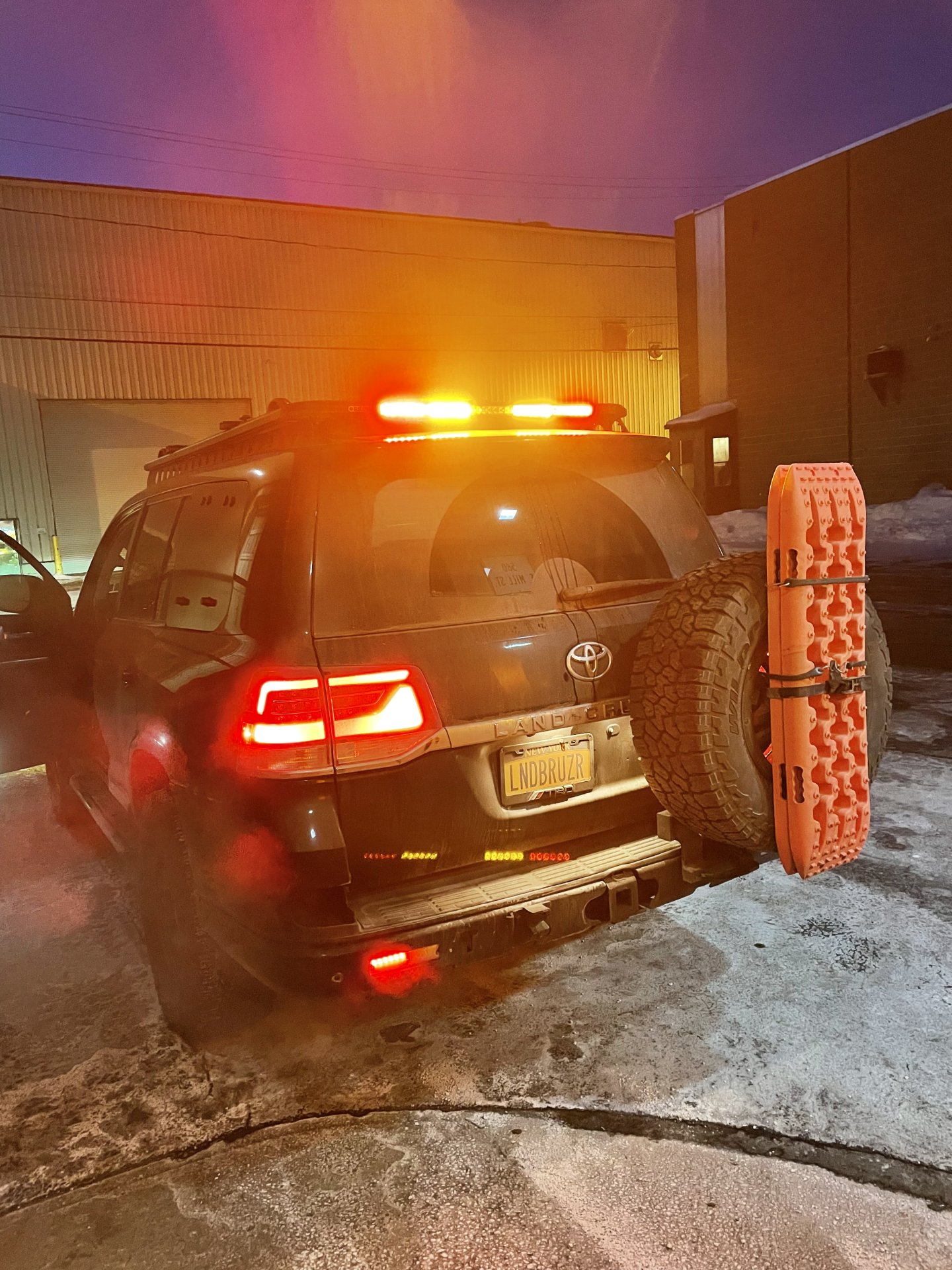

Not “this week” but over the past month or so.
Harrop Supercharger
ARB Solis spot/ flood combo.
Rear chase light bar on rack.

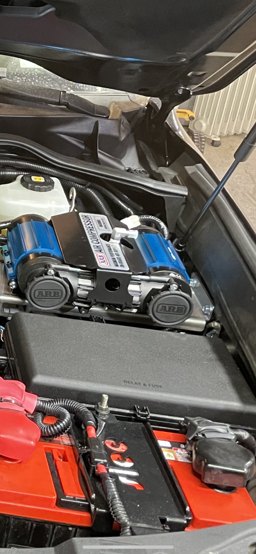

ARB twin underhood on Slee mount.

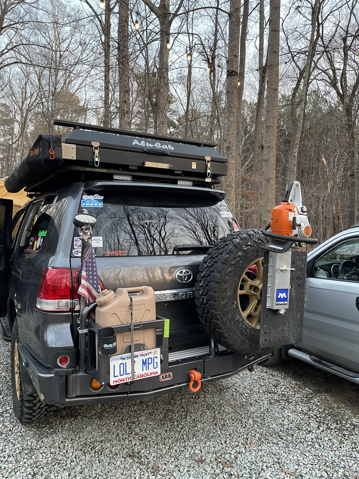

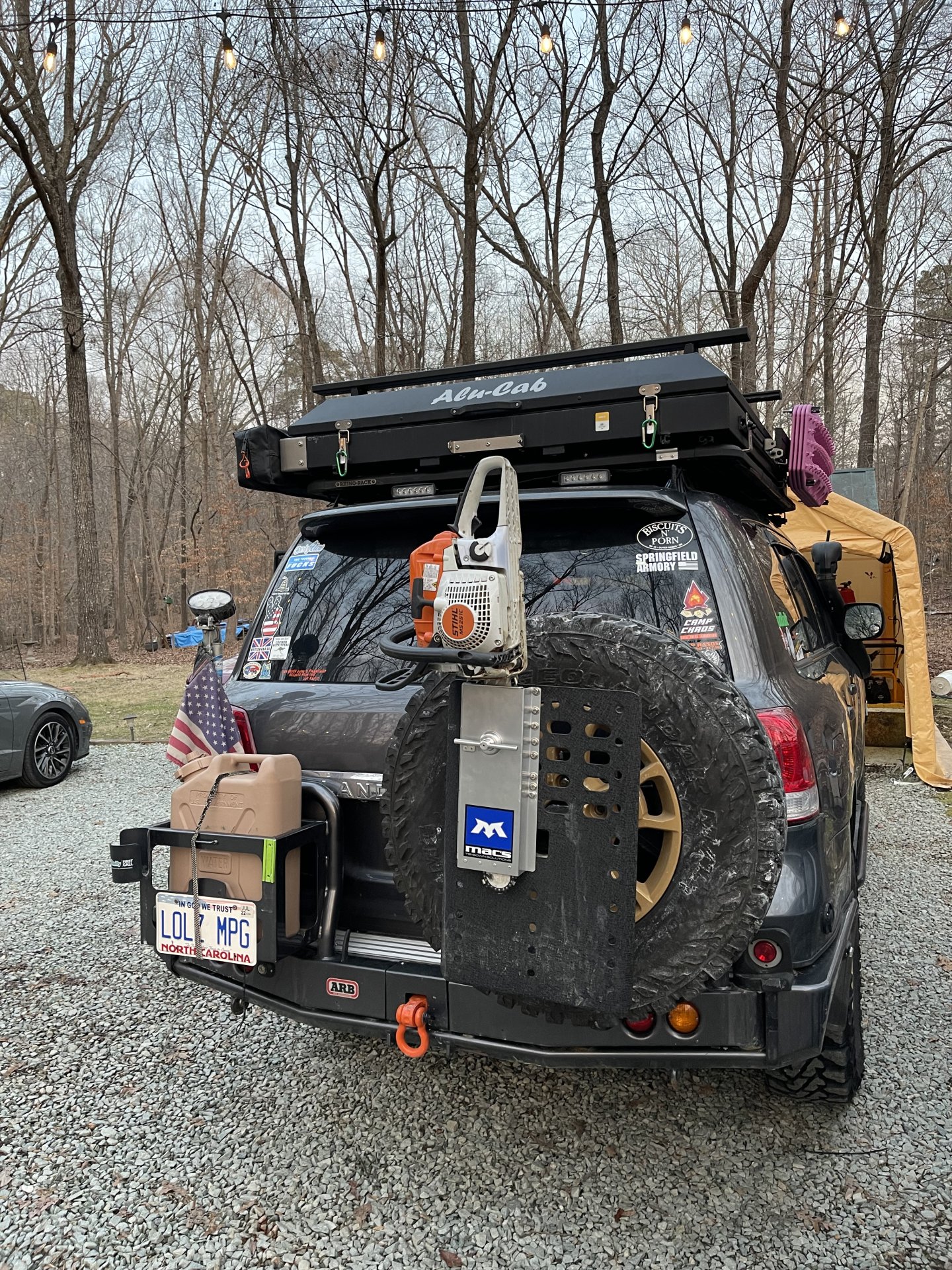

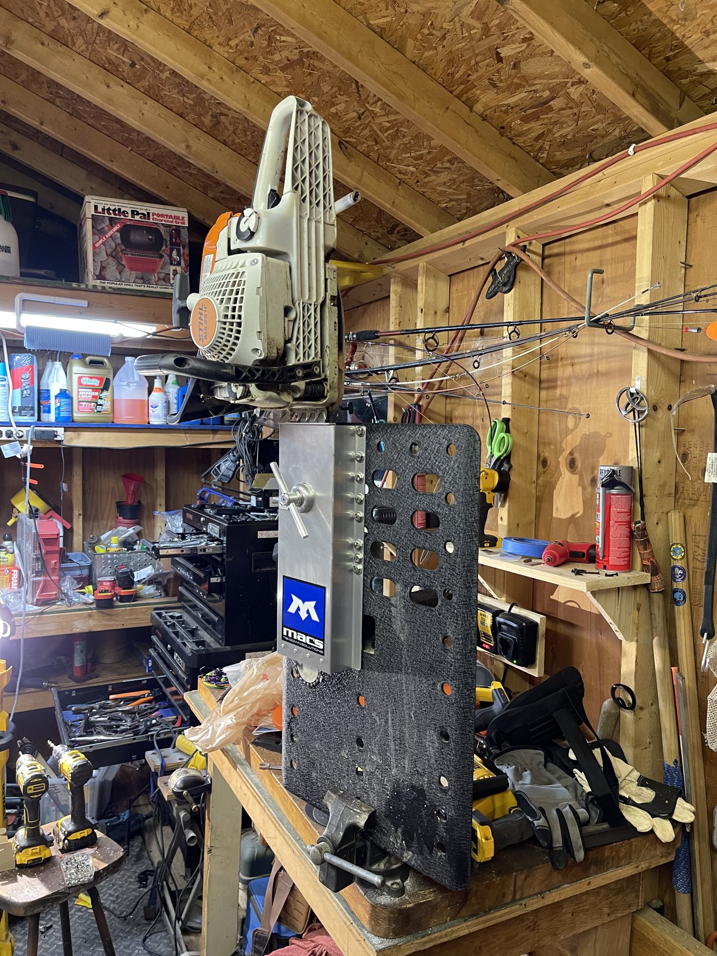

is the stihl chain saw bar strong enough to hold the body of the saw over bumpy roads? if that saw bar bends, the chain will not stay in the groove
So far so good. I will say this is the biggest saw I would but in here. But I actually only use it with my 12in dewalt battery saw. That’s no problem. Only put my medium size in there for pictures but so far no bending.

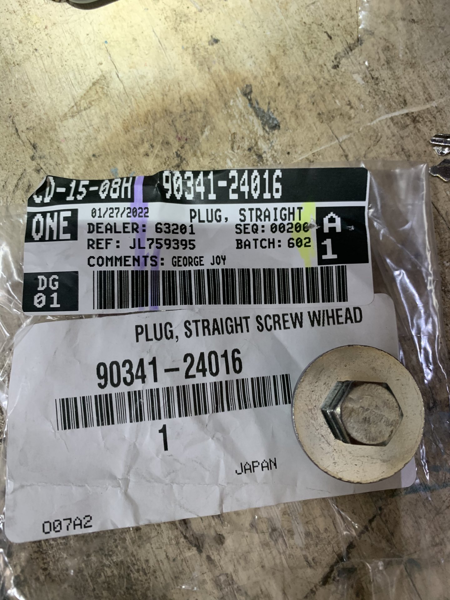

Went to Lexus to pick up a cup of $125 double espresso and a side of SLLC and the recommended non-Allen front diff drain plug. Was happily surprised Lexus doesn’t mark up the coolant! Got four gallons but only needed 3.

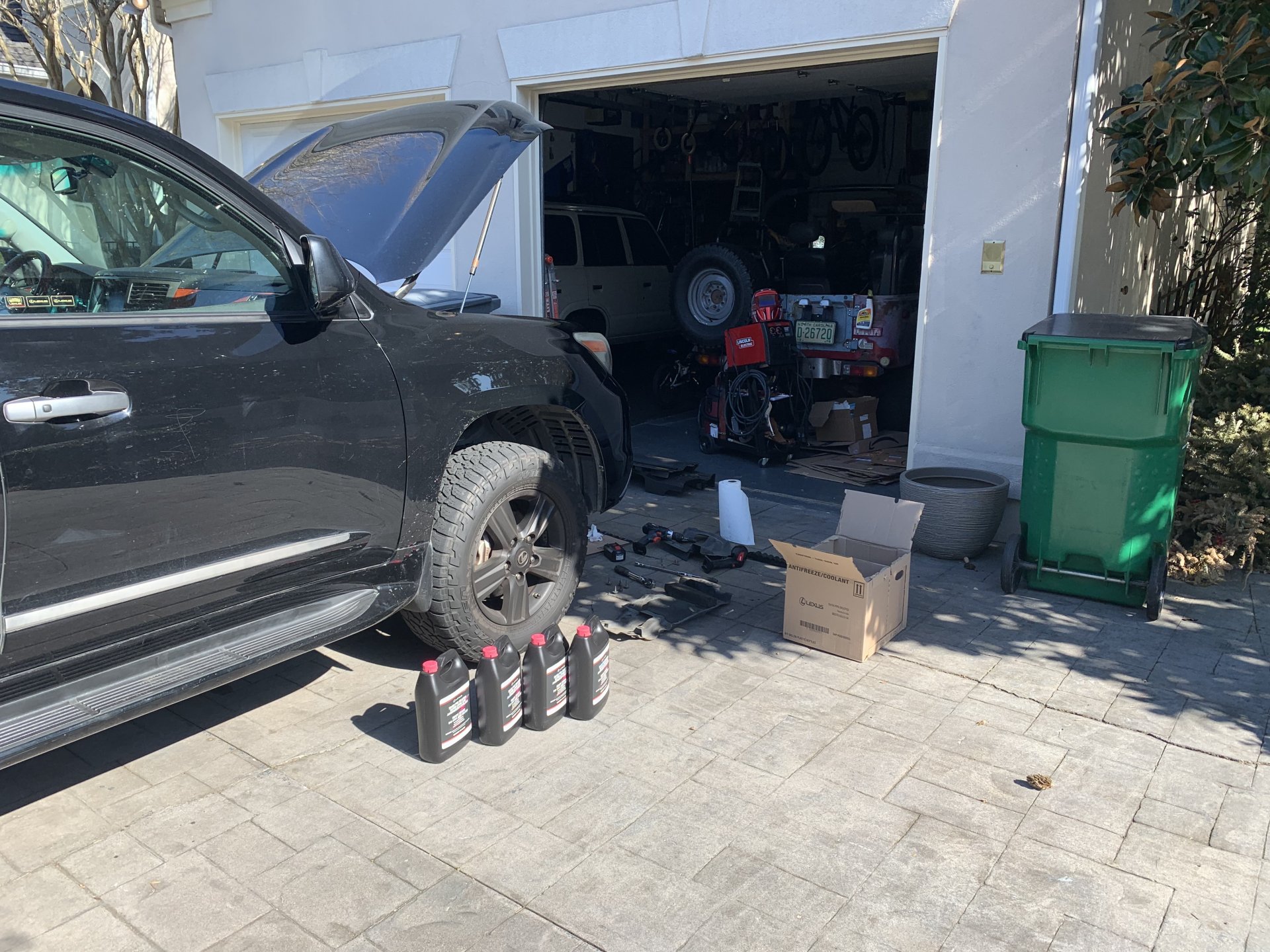

Uneventful drain and refill of the front diff after a weekend of struggling to get plug out.
Then drained the radiator, PS block drain, and then the DS block drain. Got maybe 3/4-1gallon out of the PS drain, and barely any out of the DS drain. Maybe cause I did that last? Put in just shy of 3 gallons total. This bloc drains are quite a challenge to get to due to angles, distance, and nerve racking soft brass…
From left to right, fron diff orig fill plug w new crush washer, black sludge from drain magnet, orig drain plug with bolt and nut mod, new non-200/LX drain plug with external head and new copper washer.
yes, if you put in a battery powered saw, and kept the battery in the suv, then there is not much mass to move around and bend the saw bar

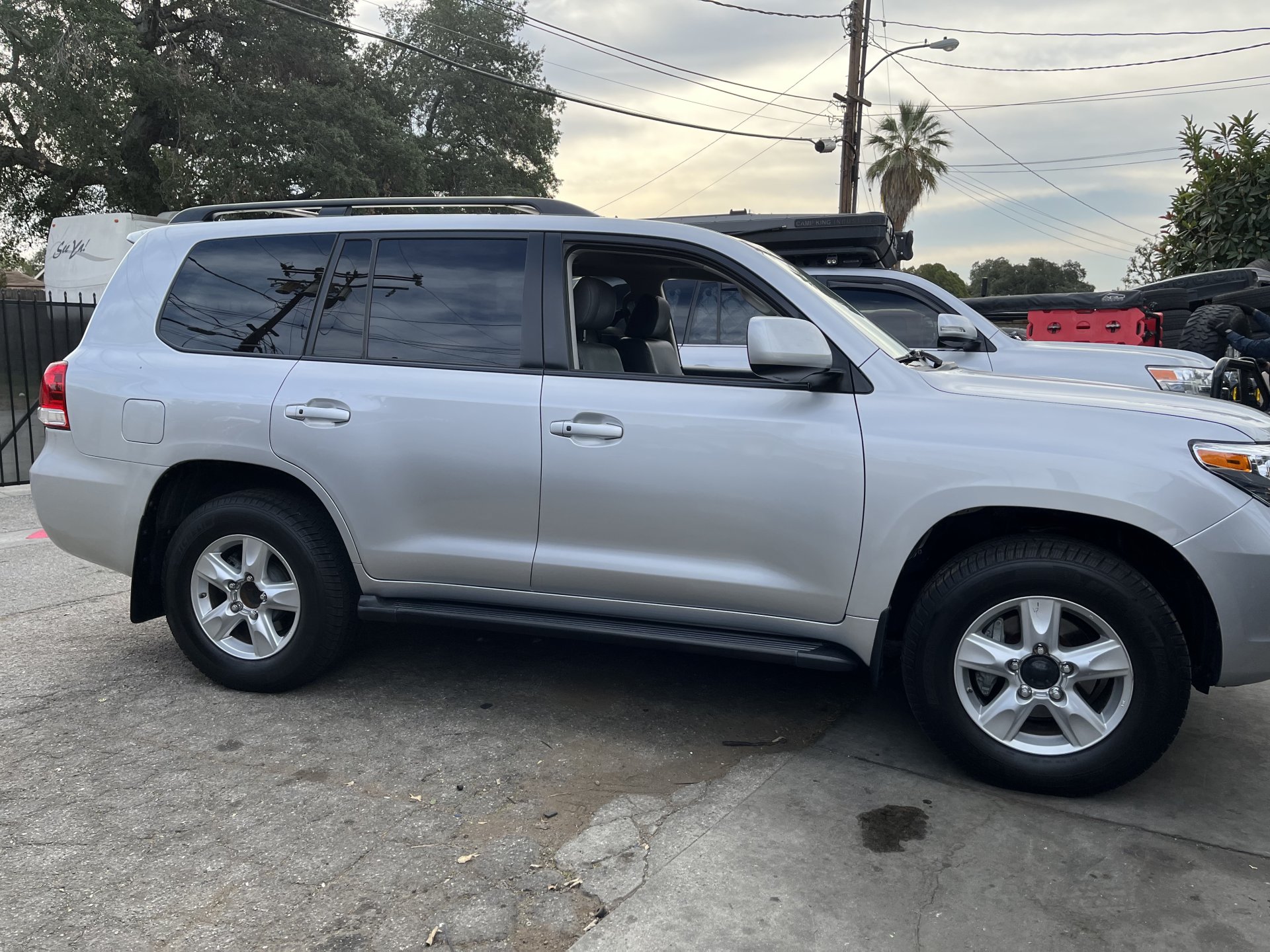

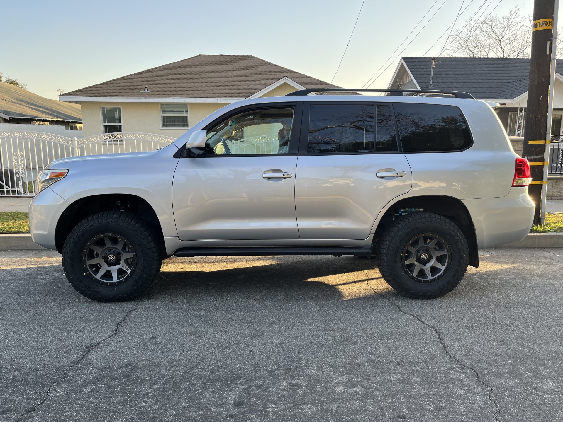

Got some work done by the guys at RPM garage in Southern California.
And after months of research here on multiple threads decided to go with this set up.
Kings 2.5 front and rear w/ adjusters
SPC UCAs
OME 2722 rear springs
Dobinsons diff drop
Icon rebound 17x8.5 +25
LT285/70r17 E Falken wildpeak at3w

Very nice, those kings will ride much better once they're broken in!

Like the rig! I have to say 2.5ish lift with icons and a 285-70-17 tire size is about the perfect set up without having to do anything with the fenders/trimming etc.

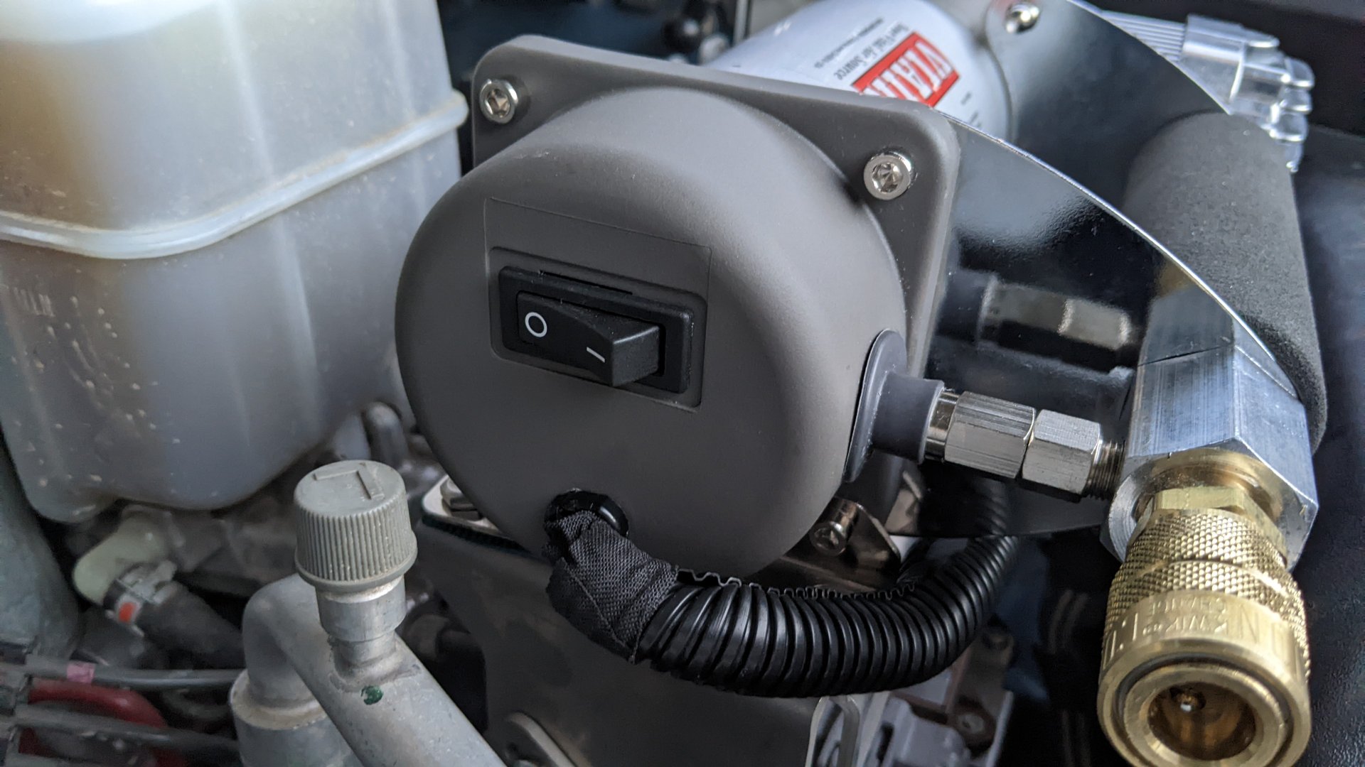

I have the same pump and mount and I wanted to do the same thing. Can I get some additional pictures? Also did you hard wire it?
Yes, it's hardwired. I can leave the cover in place now for hooking up and hitting the switch after making a few cuts to the plastic cover. I tried to cut as little as possible.
