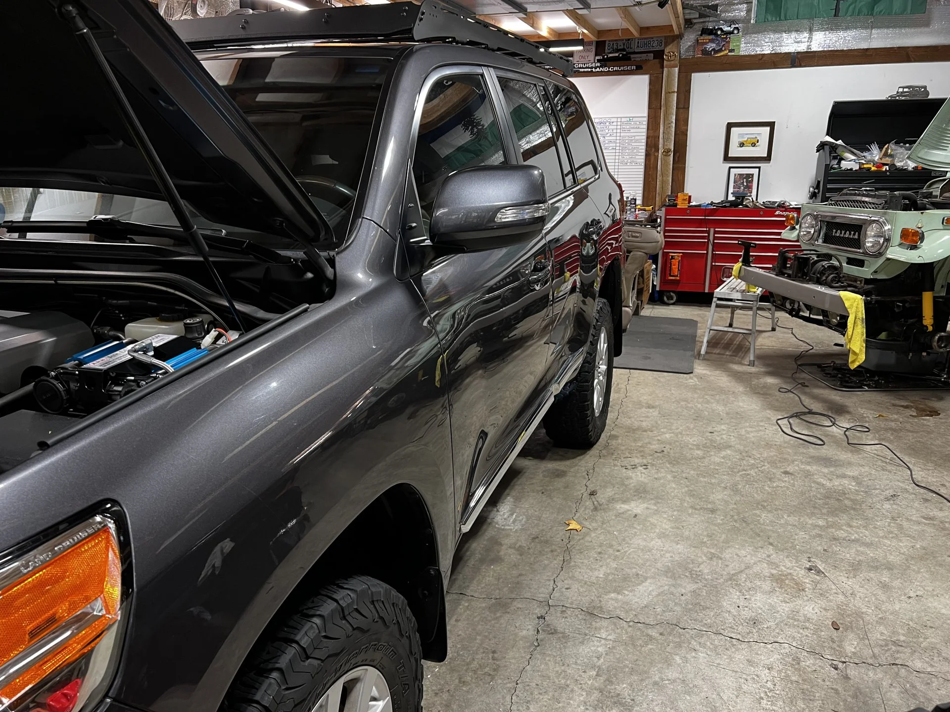

Getting closer!
No I don't have any photos of the mount before installing. They obviously moved the mounting holes toward the firewall so the compressor front filter caps wouldn't interfere with the fuse box hinges.
They must also have extended the base aft to mount the manifold further back, as the wires of the compressor limited it’s aft most position regardless of the positions of the holes.

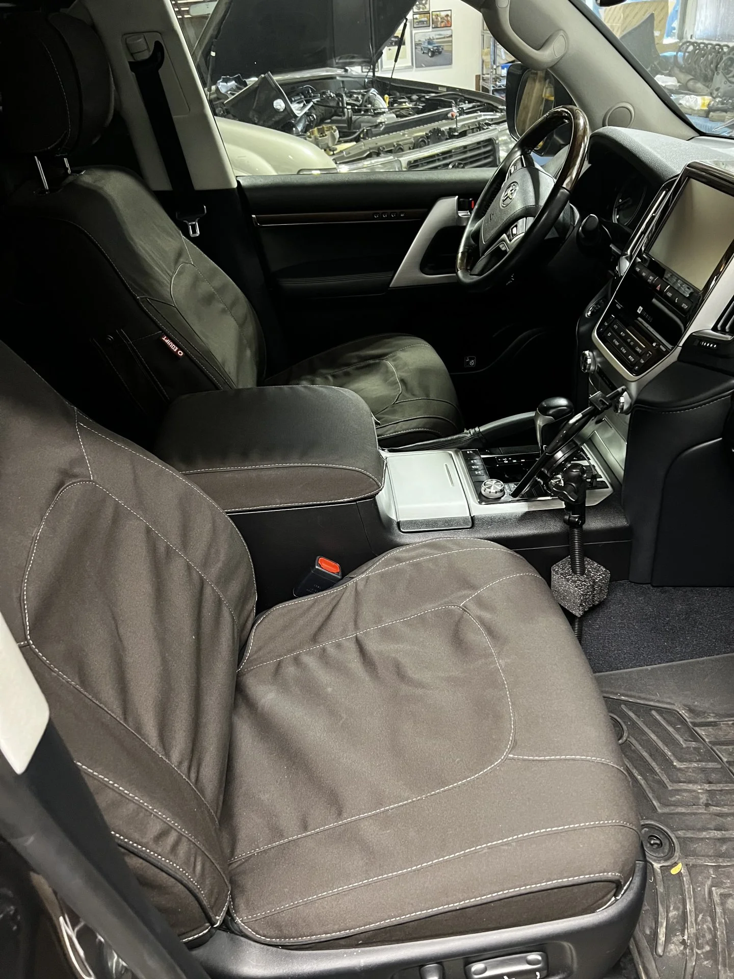

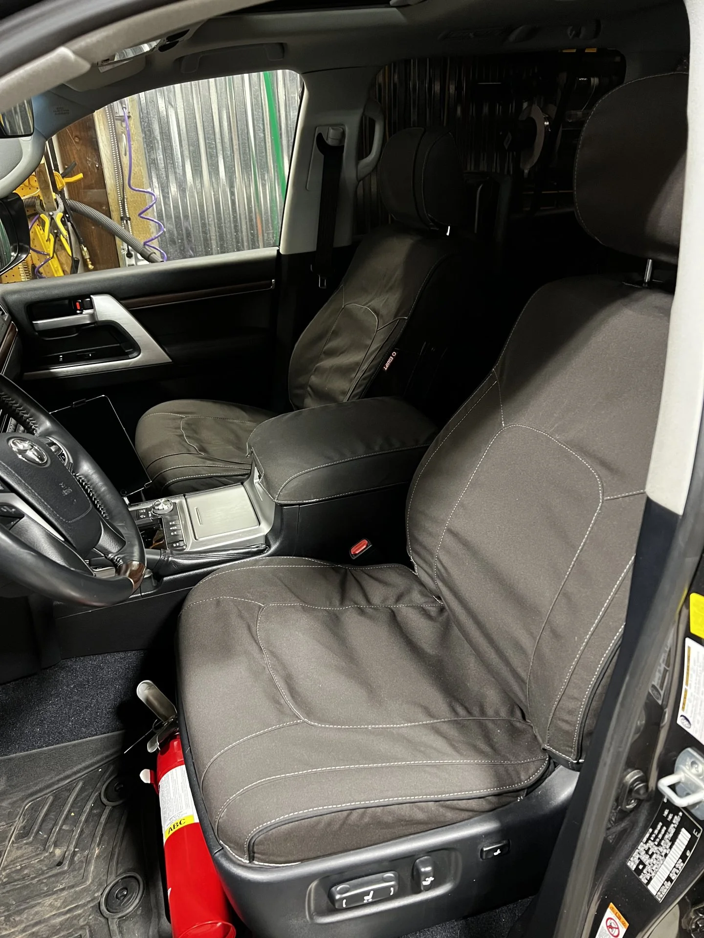

The covers are well worth the price and Equipt is maintaining an inventory so shipping times have not been bad at all.
this x50. I ordered mine direct. Received them yesterday, they are great products. I kick myself for not putting them on my 100 series.
They are especially valuable in places where it's hot. Gettinng into hot leather seats in a Texas summer is a beat down. The fabric and design are well worth the price. Either way of ordering will work.
Did a little winter prep by installing a set of Escape Gear seat covers from Equit, then gave it a good wash, used a synthetic clay bar and applied a ceramic coating.
Love these seat covers. I looked on Equit's site, and noticed they mention "with monitor, without monitor"? My truck is a 21' heritage, so what do I need? Do you recommend purchasing directly from Equit?
Pretty sure the monitors in question are the ones on the backs of the front row seats. If you have rear entertainment system you want w/ monitor and if you don't you get w/o monitor.
Heritage would be without, unless you had dealer install monitors on seat backs.

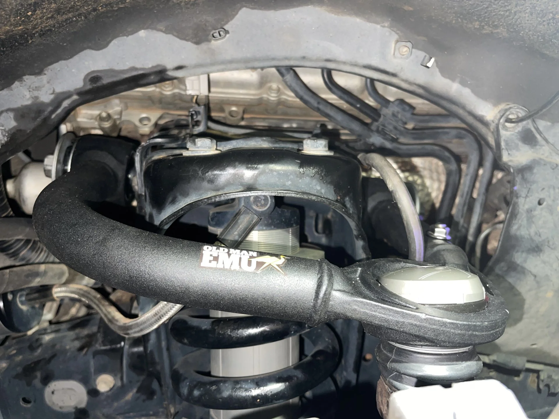

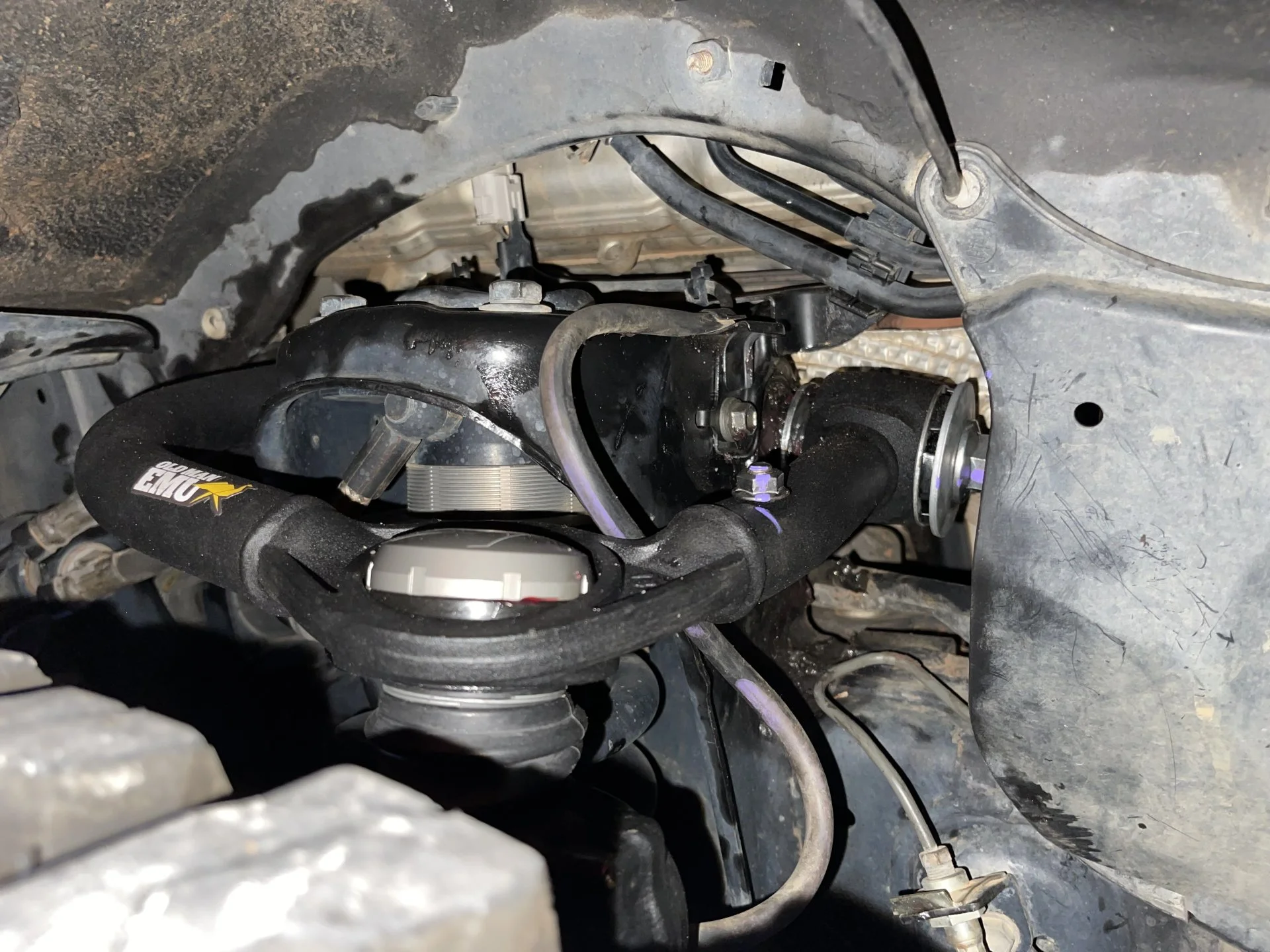

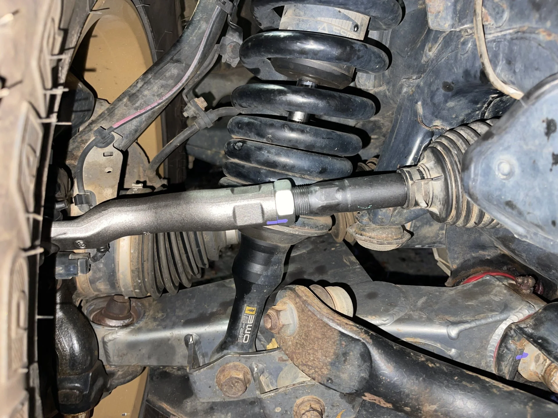

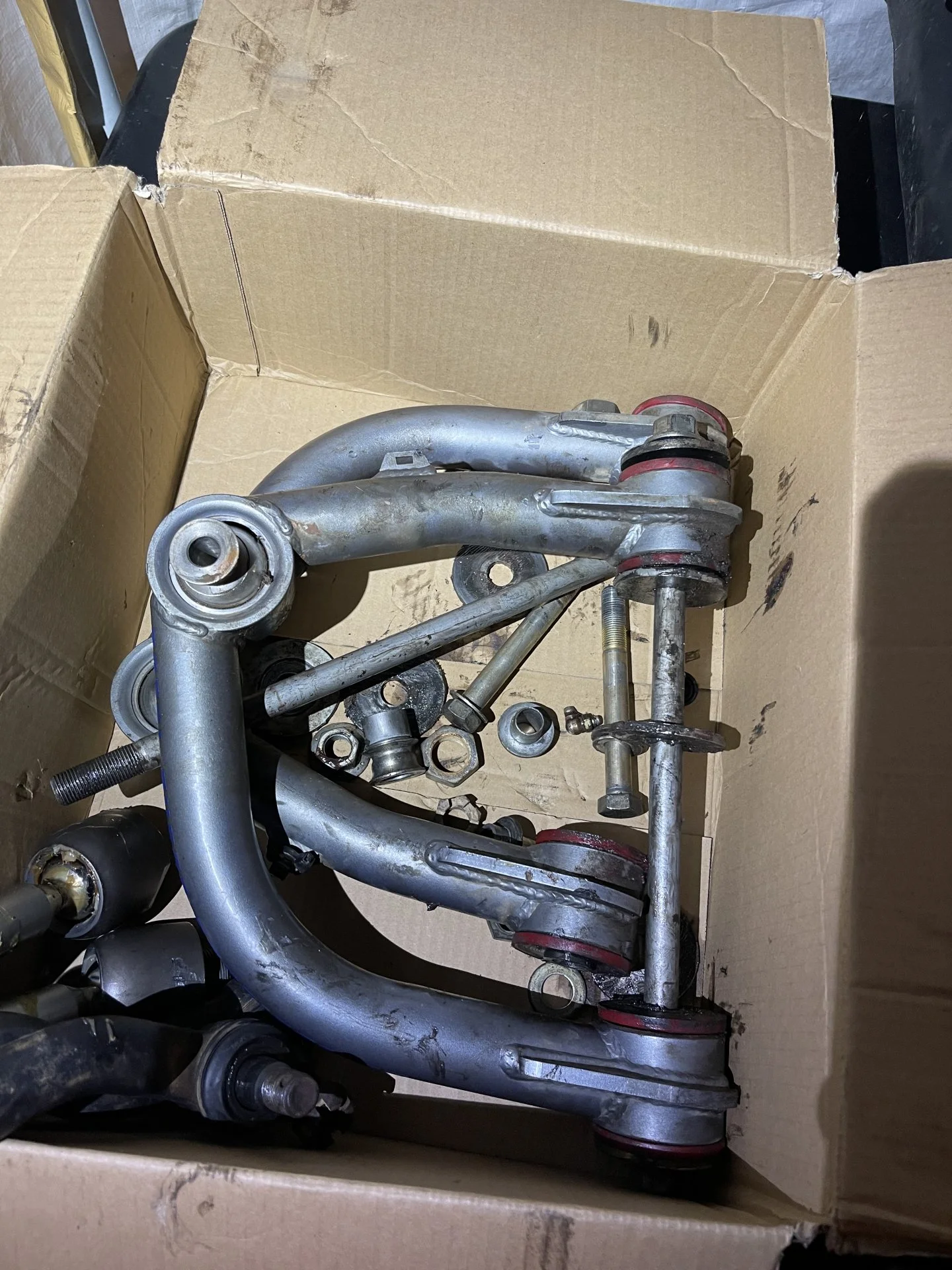

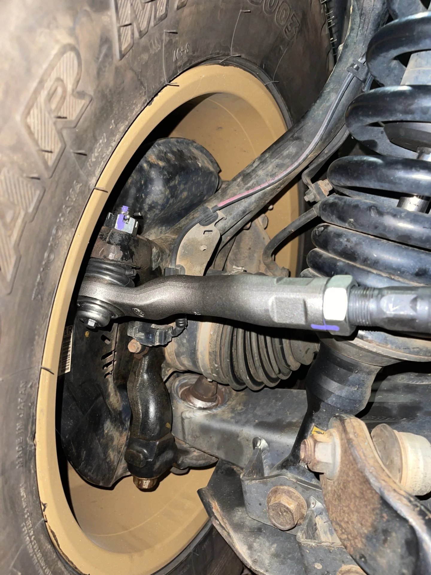

Took off my noisy TC upper arms and put OME on and it’s so much quieter. Also put on new 555 inner and outer tie rod on. This truck drives so smooth now. Turning is super easy. And no more squeaking. So nice.

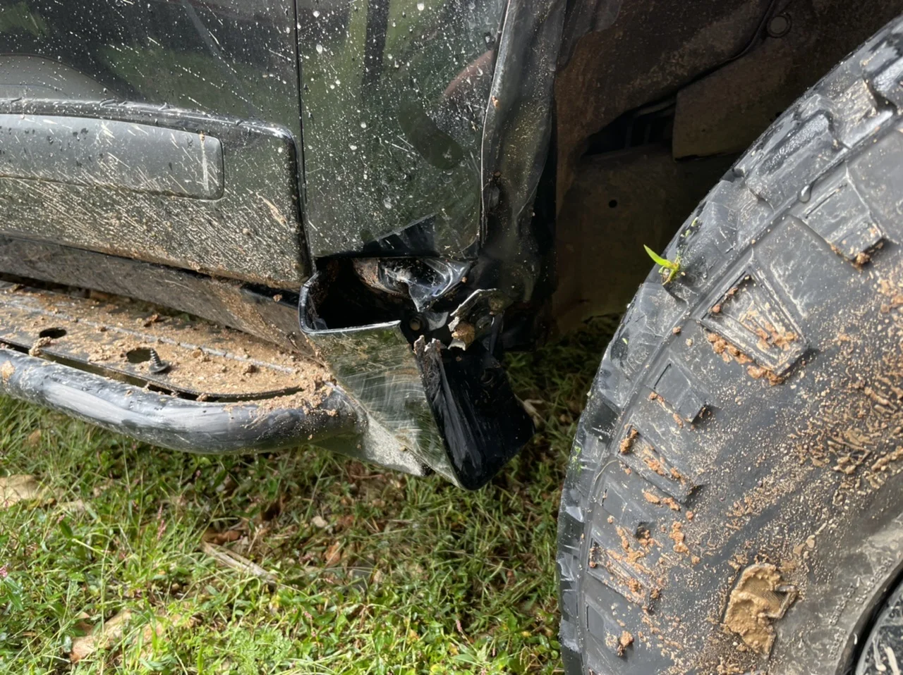

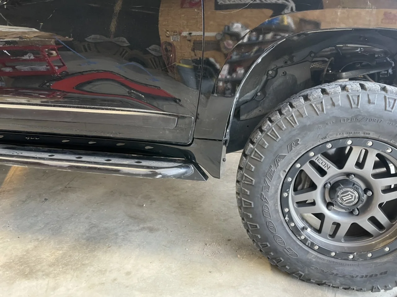

Fixed a rocker panel hit. Was able to save fender panel. Not perfect but pretty close.

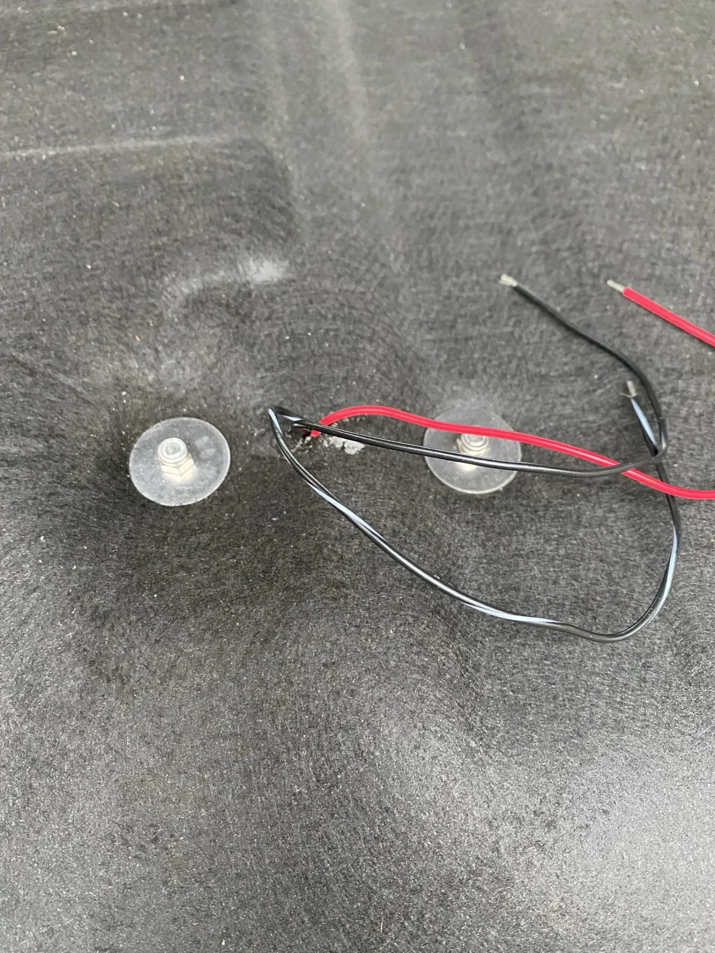

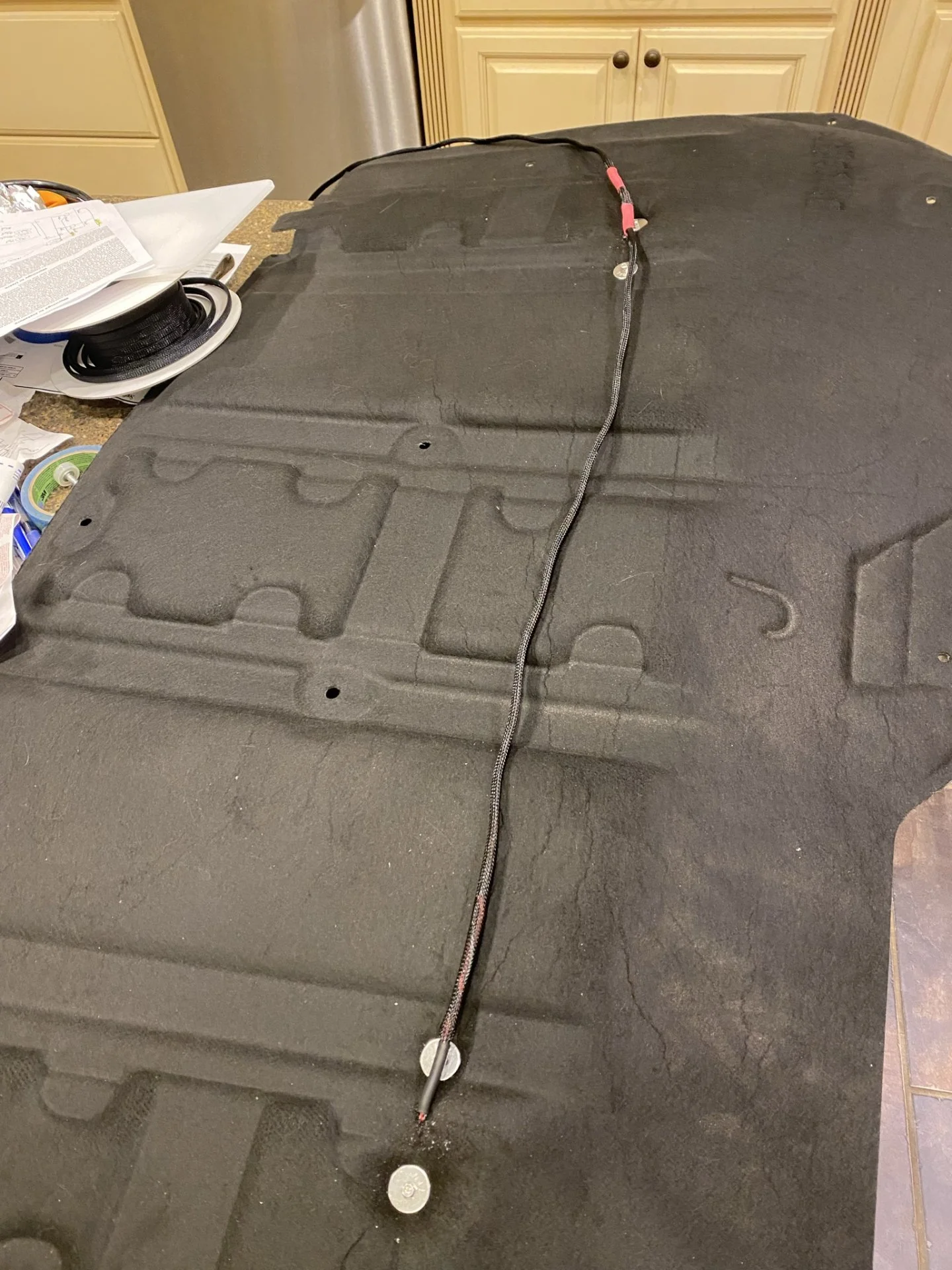

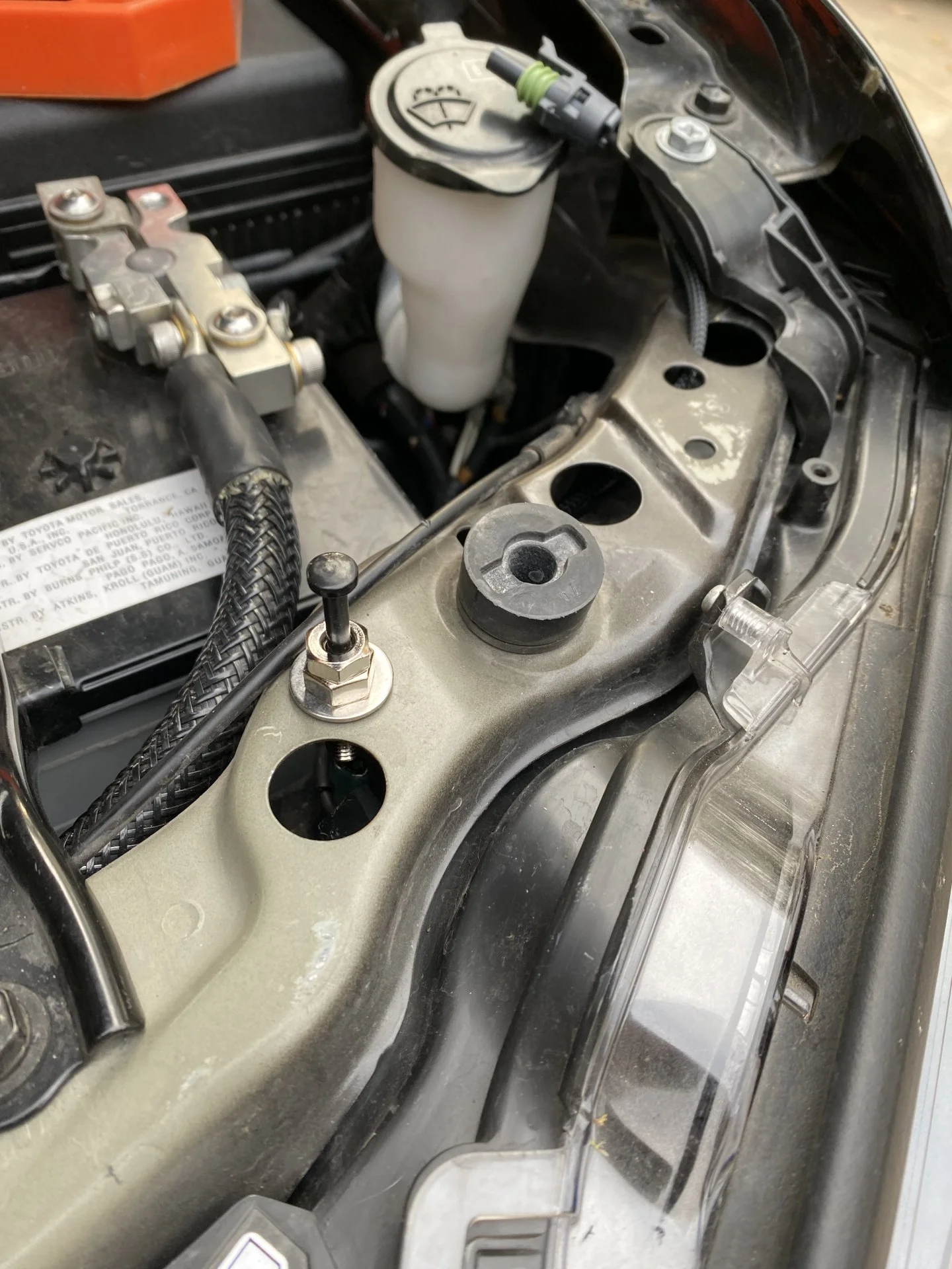

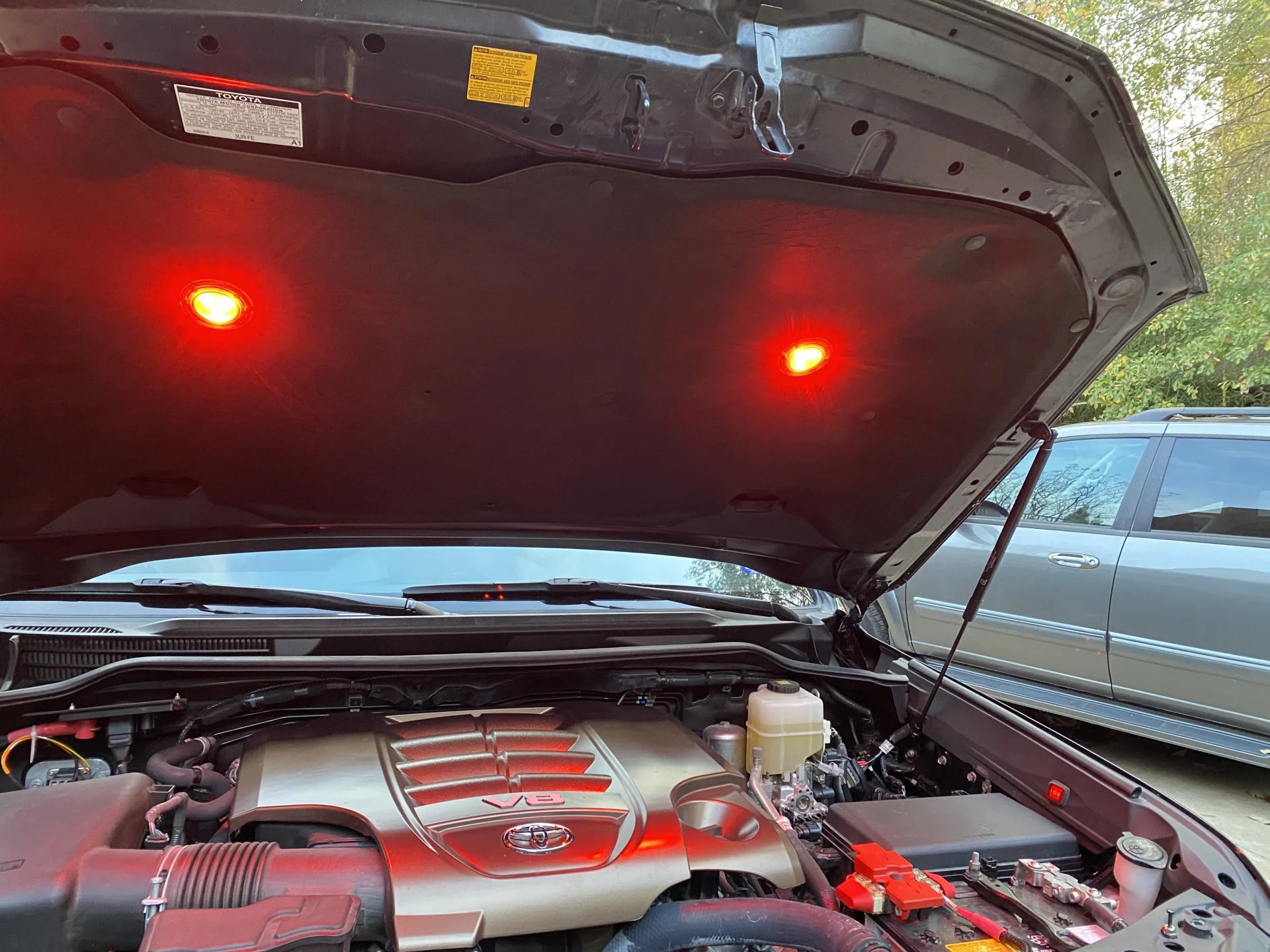

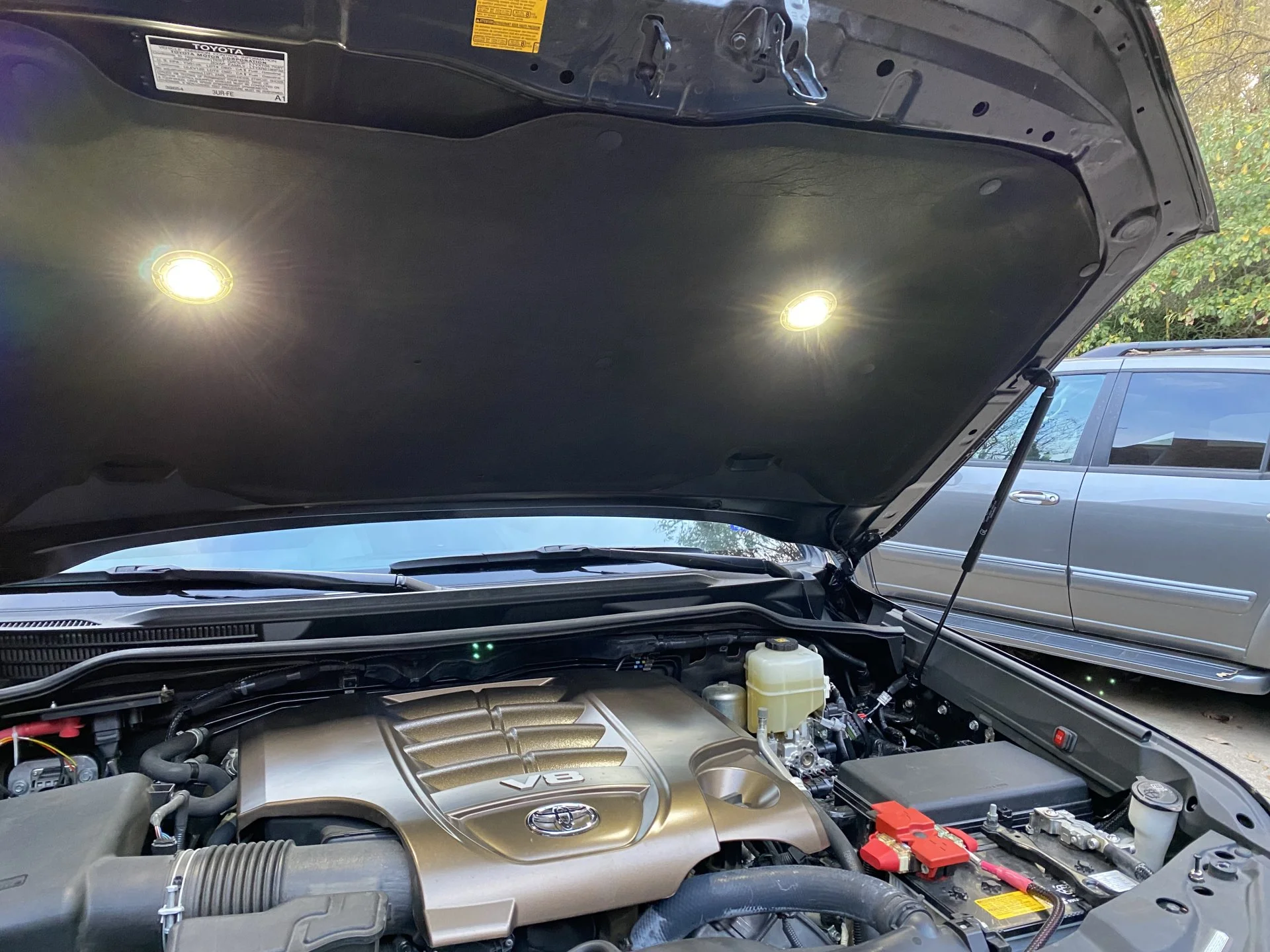

A little light added to to dark side.
Do you have a parts/link list available?
2 Whelen 3SRCCDCR leds, about $56 ea from Sirennet
1 Uxcell DPDT latching Waterproof rocker switch, Amazon $10
1 pack (3) DajierTek door pin switches, Amazon $7
2 leads of 18g wire about 8 ft each
1 lead 18g Red about 12ft
1 lead 18g Black about 2 ft
1 lot TechFlex Flexo Clean Cut Loom 1/4” and 1/8”
1 Bussman Mini low profile add-a-circuit w/ 2 amp fuse.
