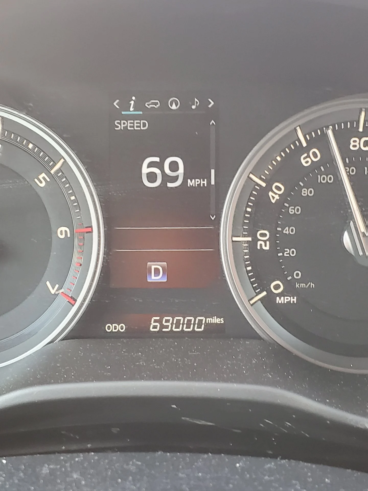

High level maturity as I turned 69000 today. That is all.

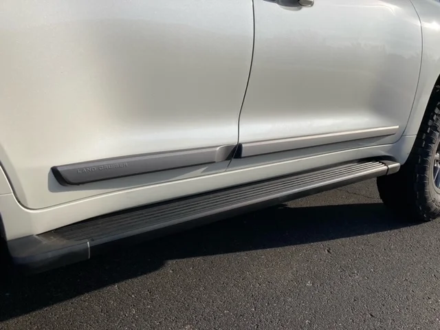

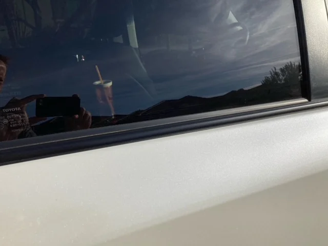

Sure, sorry for the slow reply. Had to wait until the weekend where I could get some shots in the daylight:

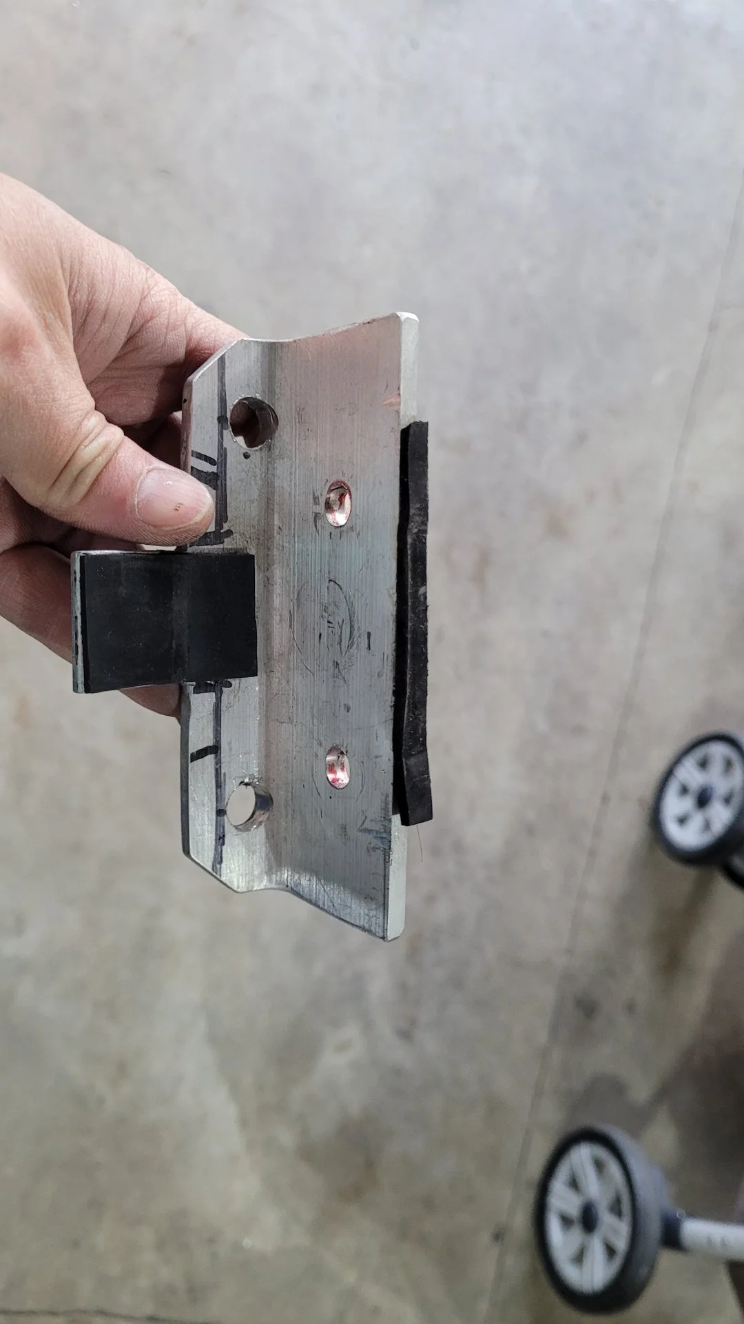

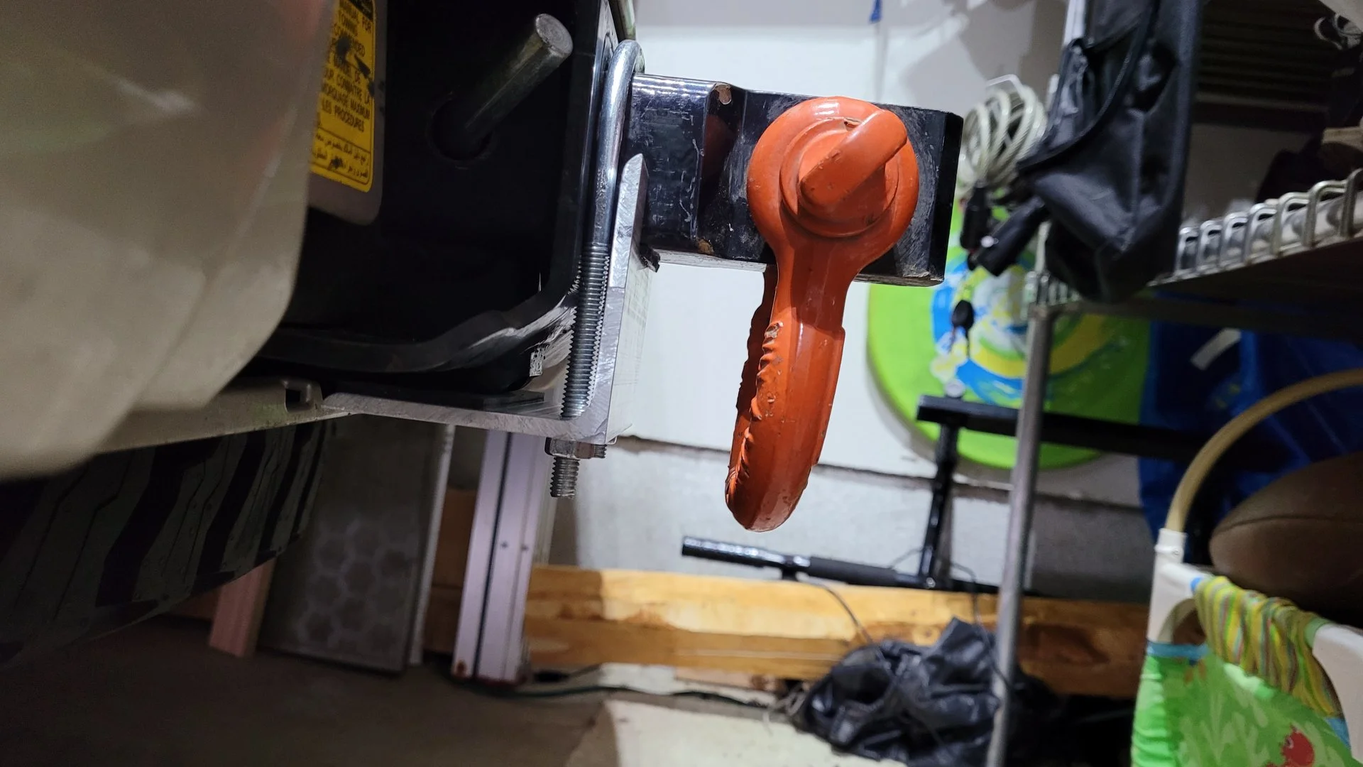

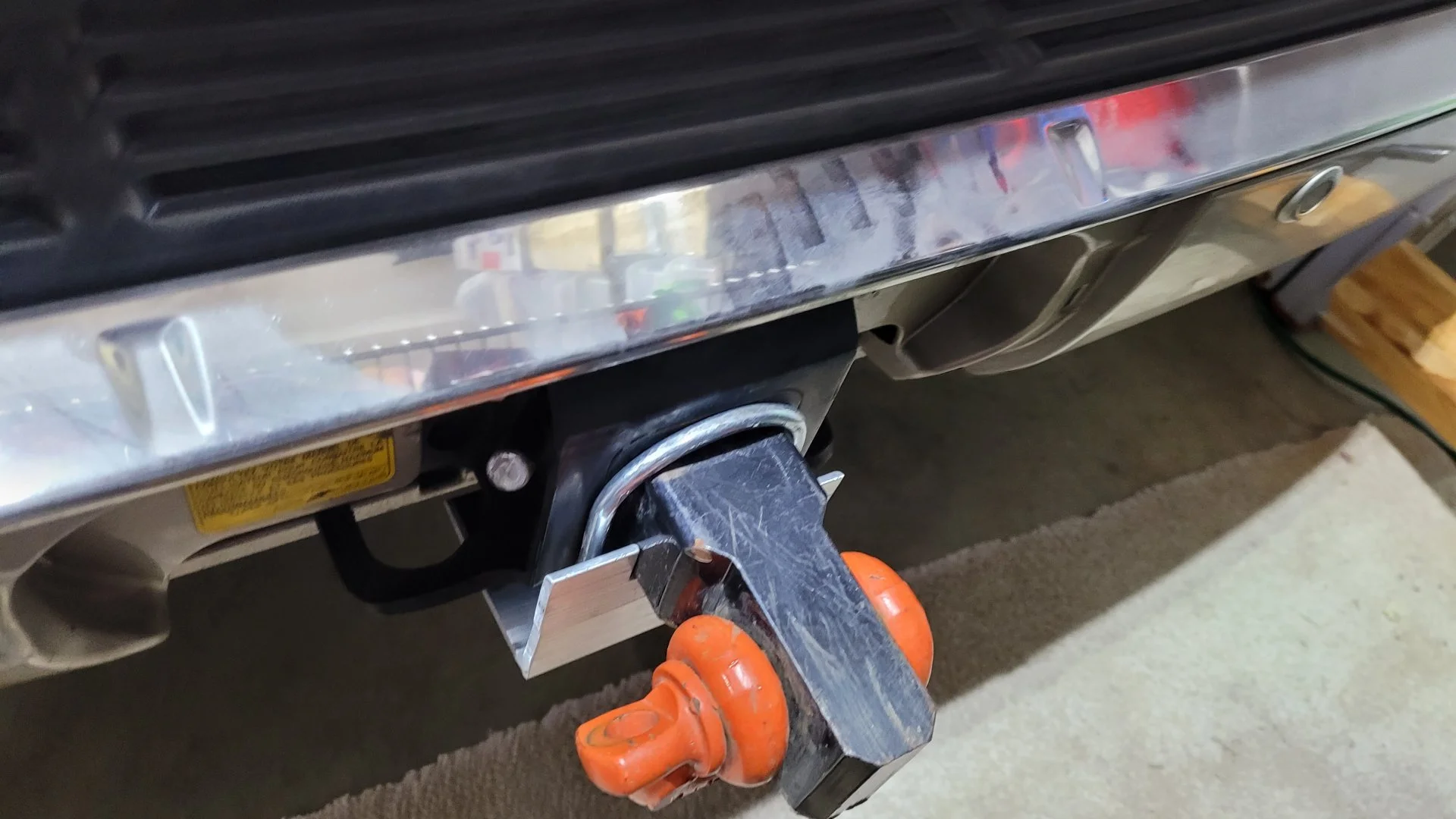

Got bored and tired of the hitch rattle so I made my own anti-rattle hitch device for the 200 series. The prototype (4th picture, smaller piece) was slightly short so it didn't stop the rattle completely. The 2nd one (bigger piece) I made stopped the rattle completely.

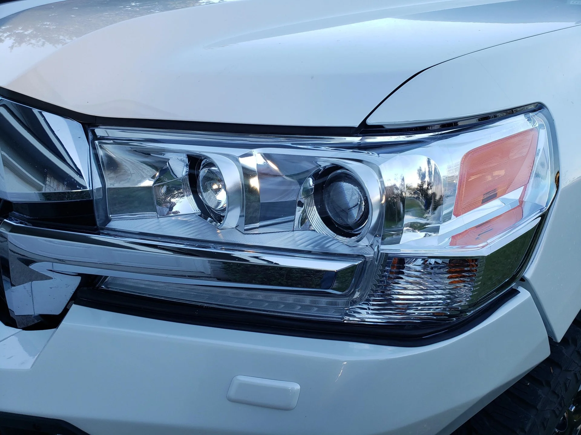

Xpel PPF on the headlights and fog lights to protect against rock chips / cracks / UV yellowing. They use a pre-cut kit, and to make the film fit around the unusual headlight contours, it means there are some minor gaps where the film does not cover (I've highlighted the coverage in red to make it more obvious).
They also cut a tiny piece to cover the front camera lens for free.

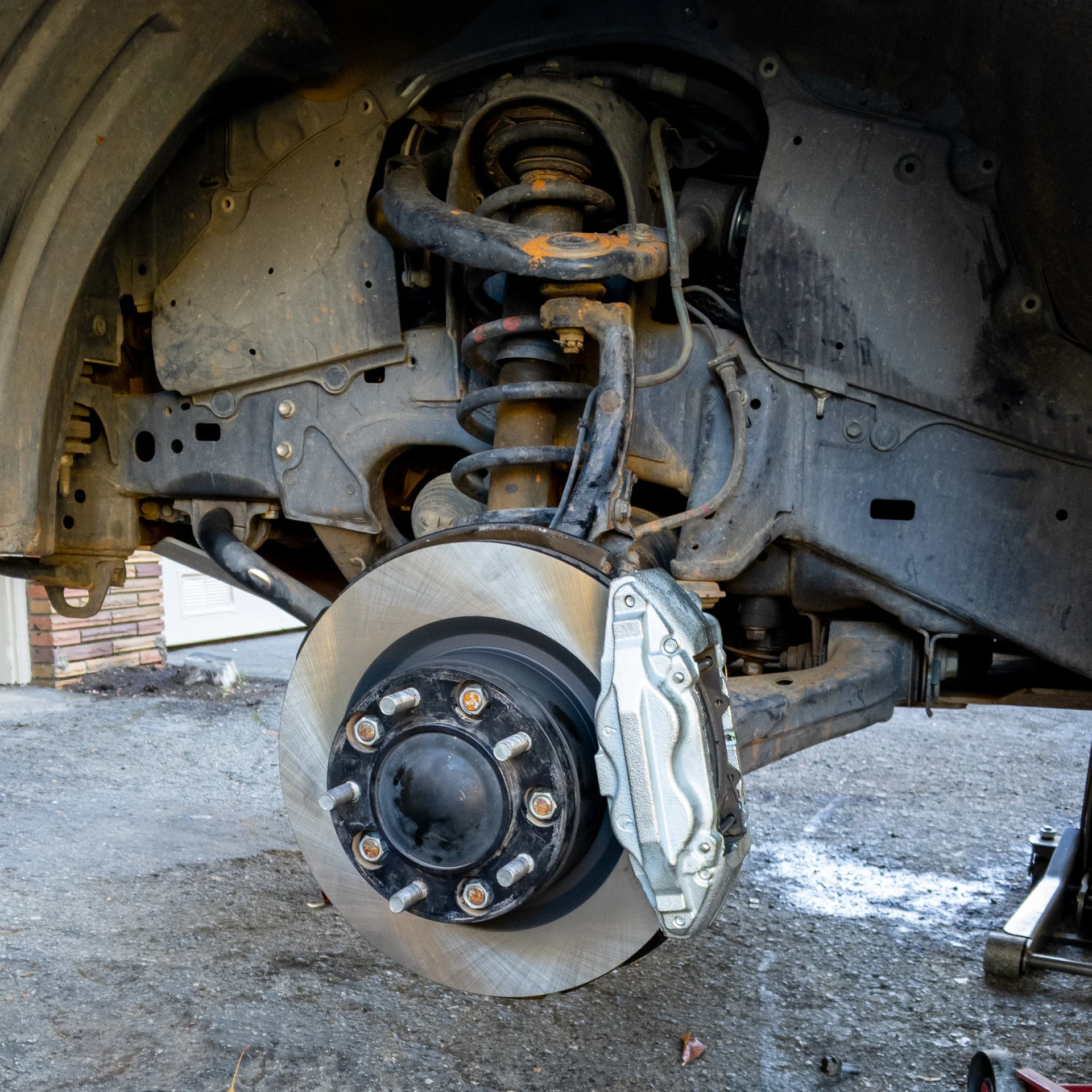

Did the '16+ big brake upgrade:
BTW that's not rust on the UCA. It's dried mud from Sedona, Arizona.

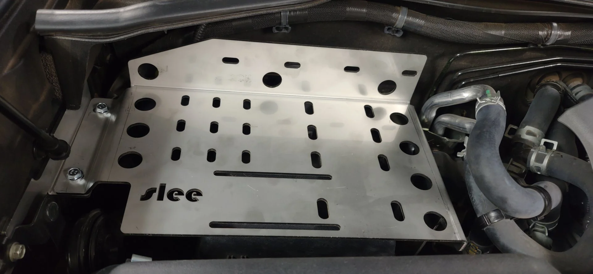

I had my ARB Duel compressor installed on the improved SLEE compressor mount yesterday. The new mount no longer interferes with the fuse box cover. I installed the SLEE accessory tray for future use .
I waited over three months for the compressor mount to be back in stock at SLEE. Don't wait to buy one even if you don't have plans to install immediately.

Do you have a picture of the compressor mount prior to installation? Im wondering what Slee changed. I purchased mine in March of this year.
No I don't have any photos of the mount before installing. They obviously moved the mounting holes toward the firewall so the compressor front filter caps wouldn't interfere with the fuse box hinges.

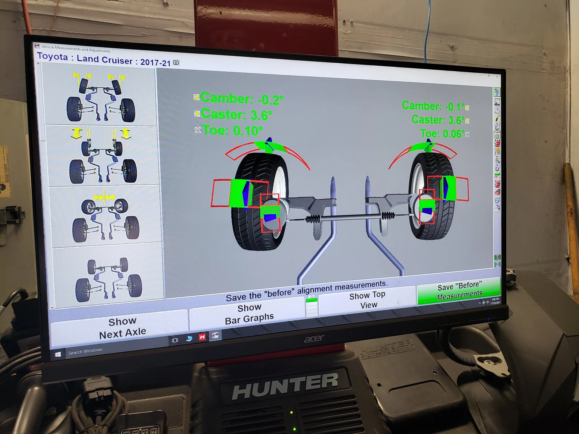

Alignment at Jerry's in Pflugerville TX. They took their time, did a good job, and listened to what I was asking for (increase caster to eliminate rubbing at back of wheel well).
Much better than NTB, who just try to get you in and out as quick as possible with as little work on their part as possible (and NTB even lied to me about what is possible to adjust).

The slee accessory mount works great with an onboard Noco charger!
