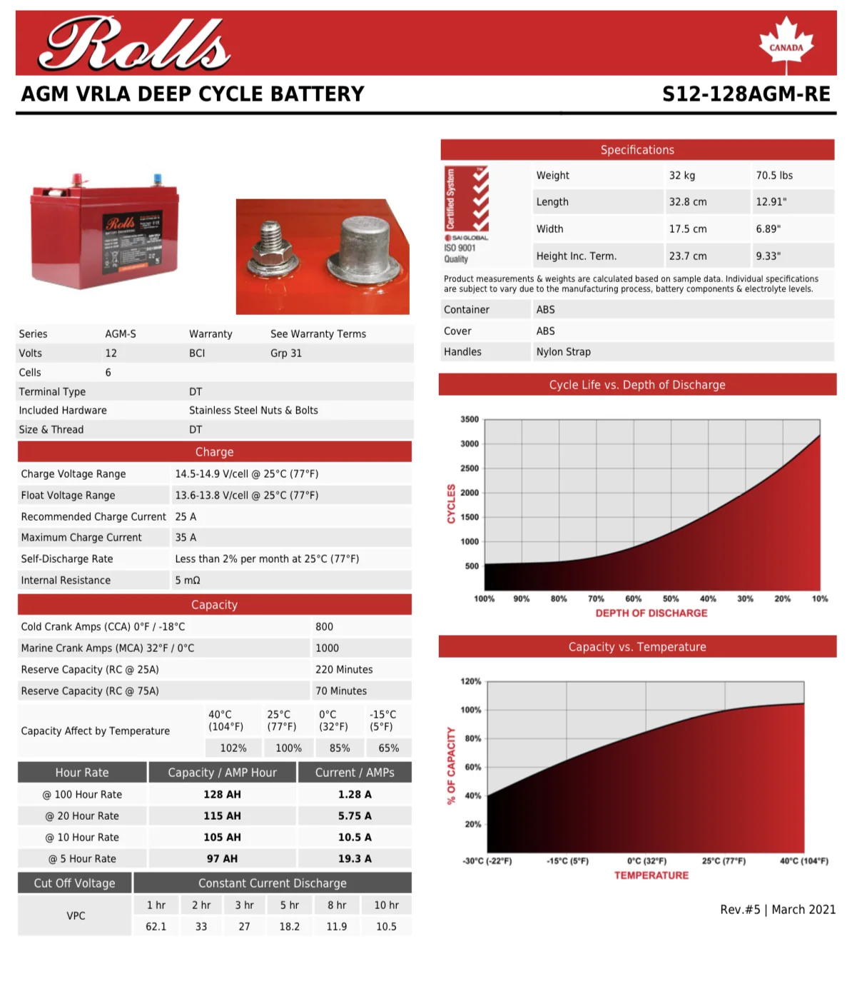

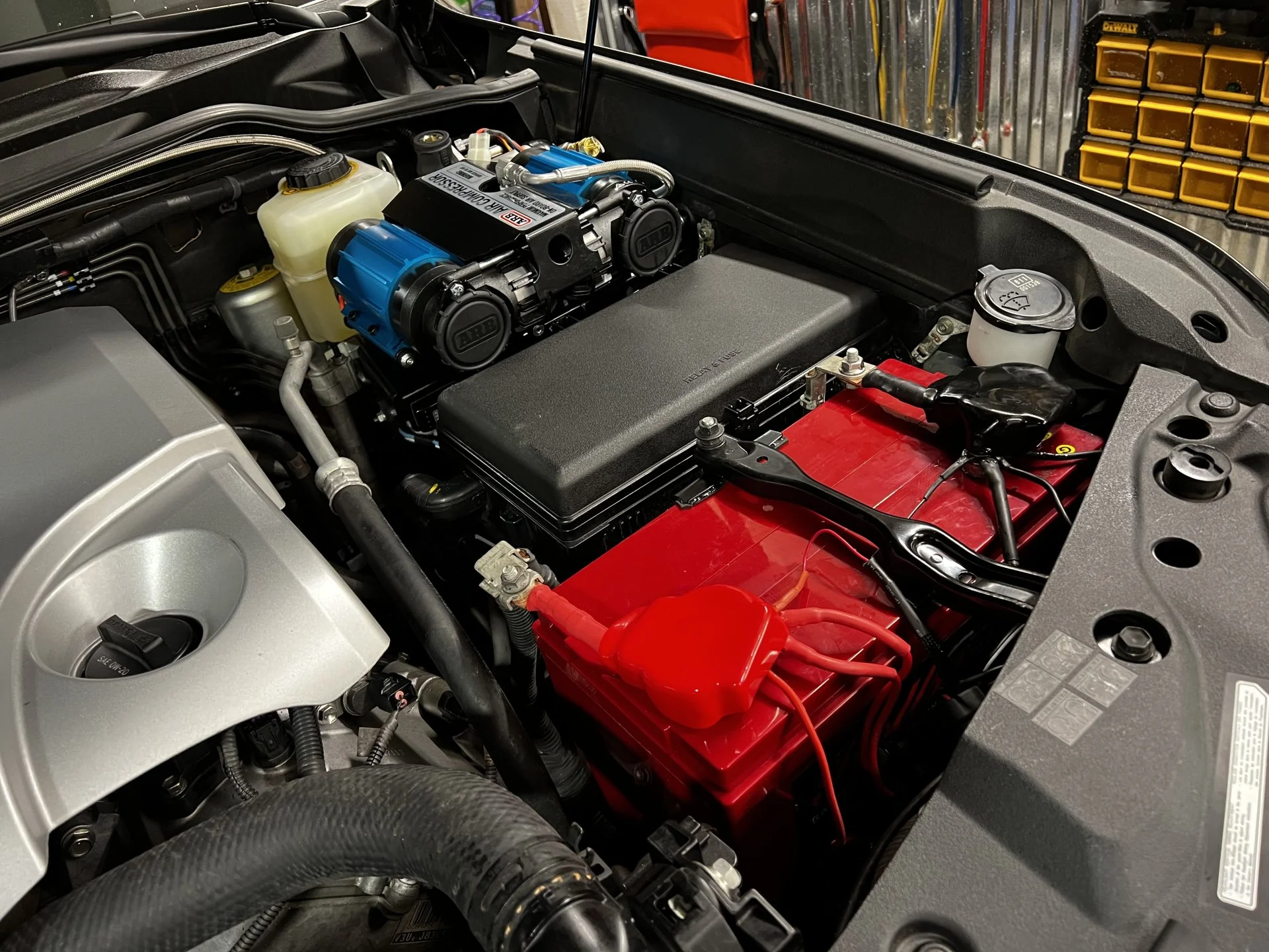

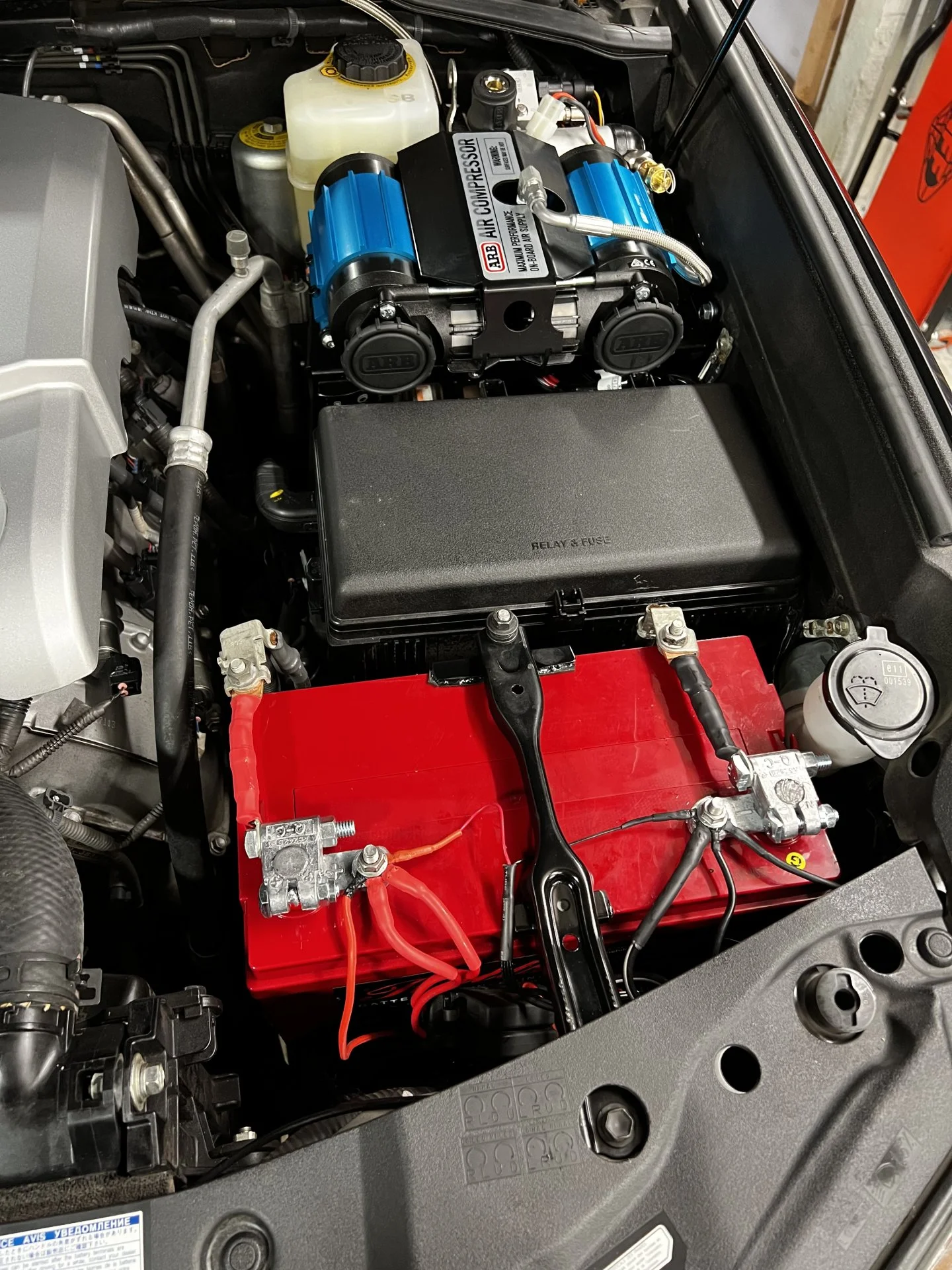

Thats the wrong battery. You needed a RH positive so you dont need the extensions to the terminals.
Very well aware. My factory Panasonic was failing fast and this was the best I could find locally. Honestly, I like the extra space it created by relocating my accessory leads forward and away from the fuse box (the inline fuses on that ARB Twin are bulky AF).
It’s really just a temporary solution before going hog wild on a dual AGM with a proper fuse box. So I count it as a win.
