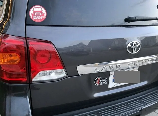

Hi - I ordered the GOBI ladder online for my 2013 LC from TrucksandSUVpartswarehouse.com. Delivered in 4 weeks.

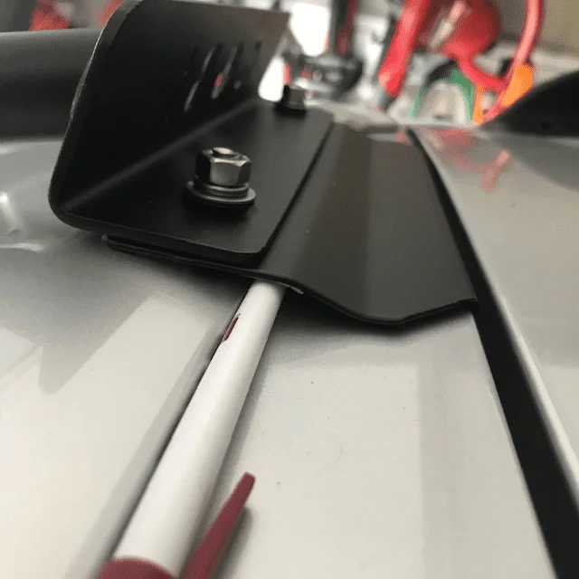

A GOBI rep reached out directly to confirm the order. There were some issues with the ladder hanger plate that I sent pictures to the representative to update engineering.
I also replaced their white adhesive tape on the LAND with black. Seems solid but as you can see from the pictures there’s a finger size gap from the adhesive to the body where one strip of adhesive doesn’t even touch...

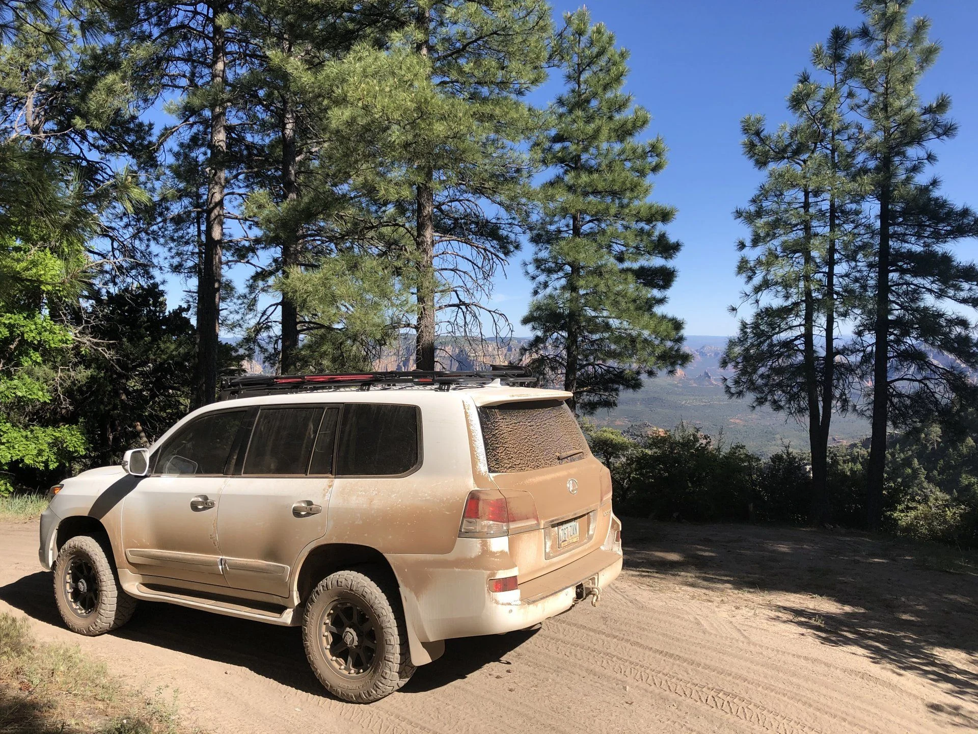

Buying a hullavator but I see you have a full roof rack with yours. I can’t find any info on roof rack compatibility, only the bars. How did you do yours? Yes
Frontrunner makes a set of brackets that bolt to the rack, and allows for the mounting of Thule crossbars. I used the Wingbar Evo 135. The Hullavator is then mounted to the Thule bars. Rack Adaptor Plates For Thule Slotted Load Bars - by Front Runner
This is a great cross-brand solution, and while it works, it’s too tall for the LC to fit in my garage. I will be switching to Yakima Skyline towers (which I already own) with Yakima Landing Pads and Yakima crossbars. This will sit higher when in use, but the Skyline towers are easily removed with the Hullavator still attached to the crossbar. Unfortunately, this requires a little on-site engineering.
For factory side rails, you can use Yakima Timberline towers (they strap to the side rails) and Yakima crossbars. Thule may also offer towers that attach to the factory side rails...I’m just not familiar with their options.

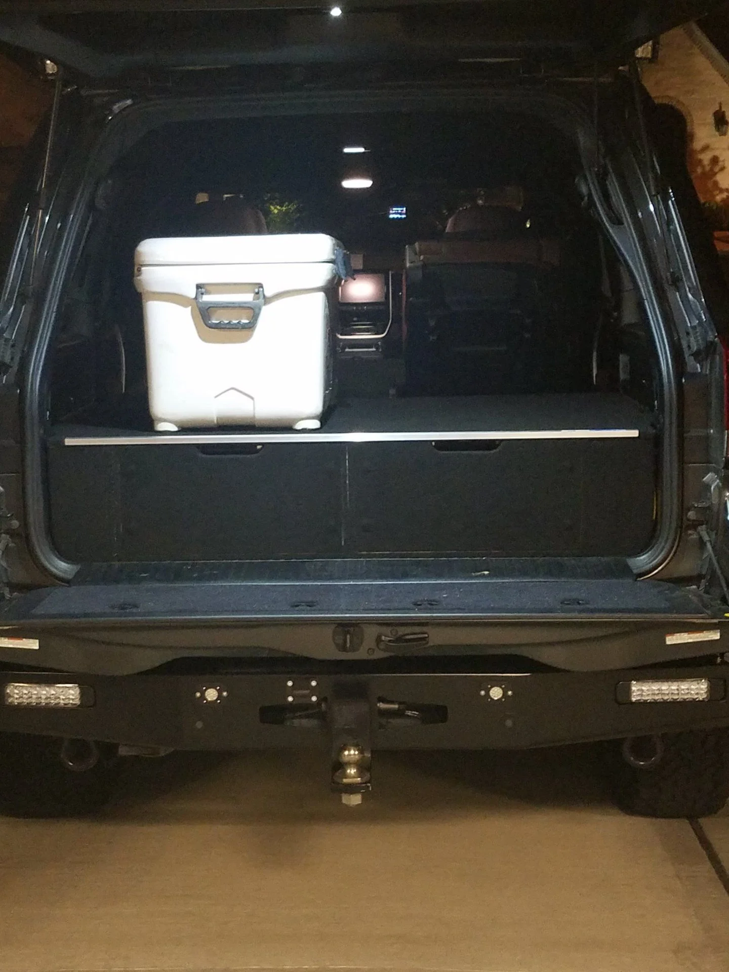

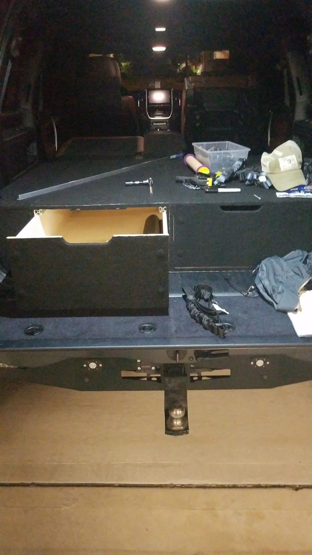

Installed 2nd drawer from Landshark Outfitters. Carpeted both on exterior and angled aluminum on leading edge. Next is to install rubberized non skid padding on inside of drawers.

Awesome! Would you be willing to share what material and dimensions you used for the angle material? Did you screw it on?
Sure...its the aluminum angled strip that can be found at Home Depot. They have a 48" strip. Its a little short but after you make the cut forthe wing it can moved down a hair. I'm fine leaving that little bit of carpet exposed on the end of the wing.
Drill holes through aluminum and attached with small screws. I drilled small holes in wood as well to avoid splitting it.

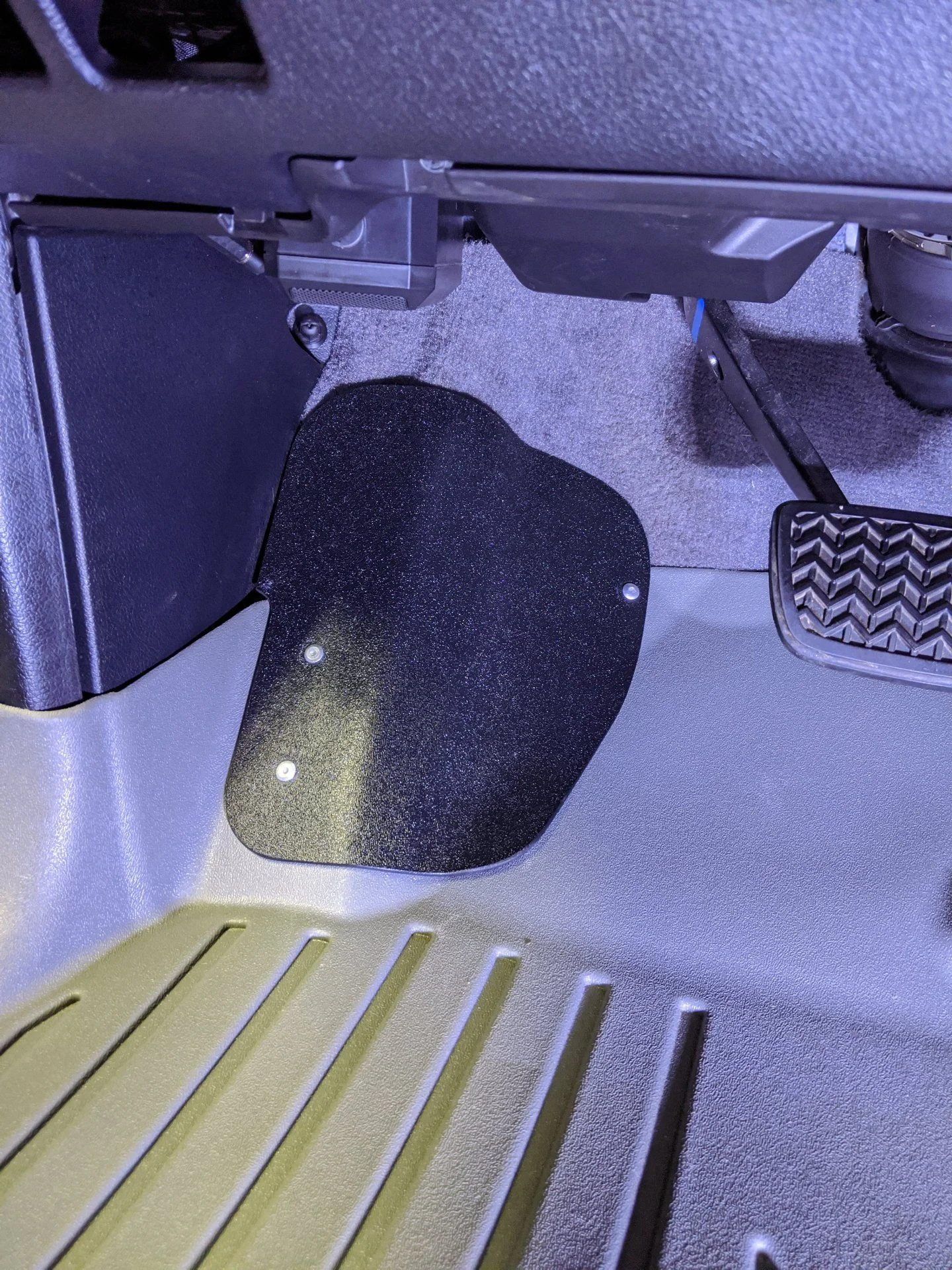

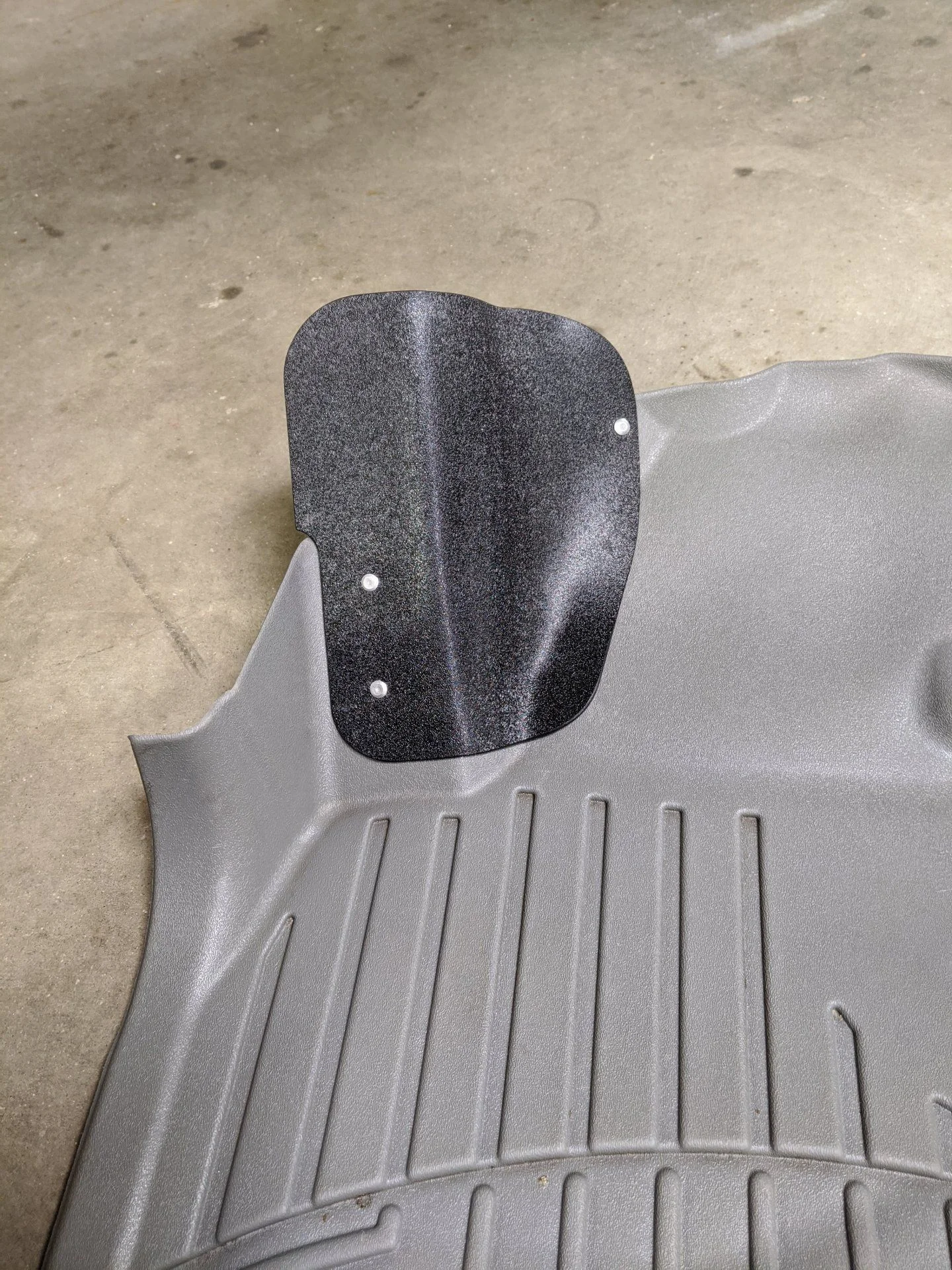

I know the Husky vs Weathertech floor liner debate rages on, I went with Weathertechs as I wanted gray (Husky doesn't sell this color). But, like others noted, I'm not happy that they don't cover as much as they probably should, especially up on the left foot dead pedal. So I fixed it. Found this chunk of ABS plastic on Amazon:
Amazon product ASIN B0007WTF02
Made a pattern out of a piece of scrap cardboard, cut the plastic to match with a bandsaw and finished up with the stationary belt sander. A few minutes with the heat gun, I was able to form it to match the floor in that area. Fastened to the Weathertech liner with a few pop rivets, backed up with fender washers on the other side.

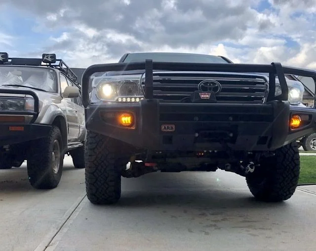

Fit amber LED fogs in the bumper

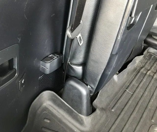

3rd row power, 2 12v outlets and 2 USBs. Currently wired straight to the battery with an in-line fuse. Will be adding a fuse block later to clean it up and make room for more dodads.

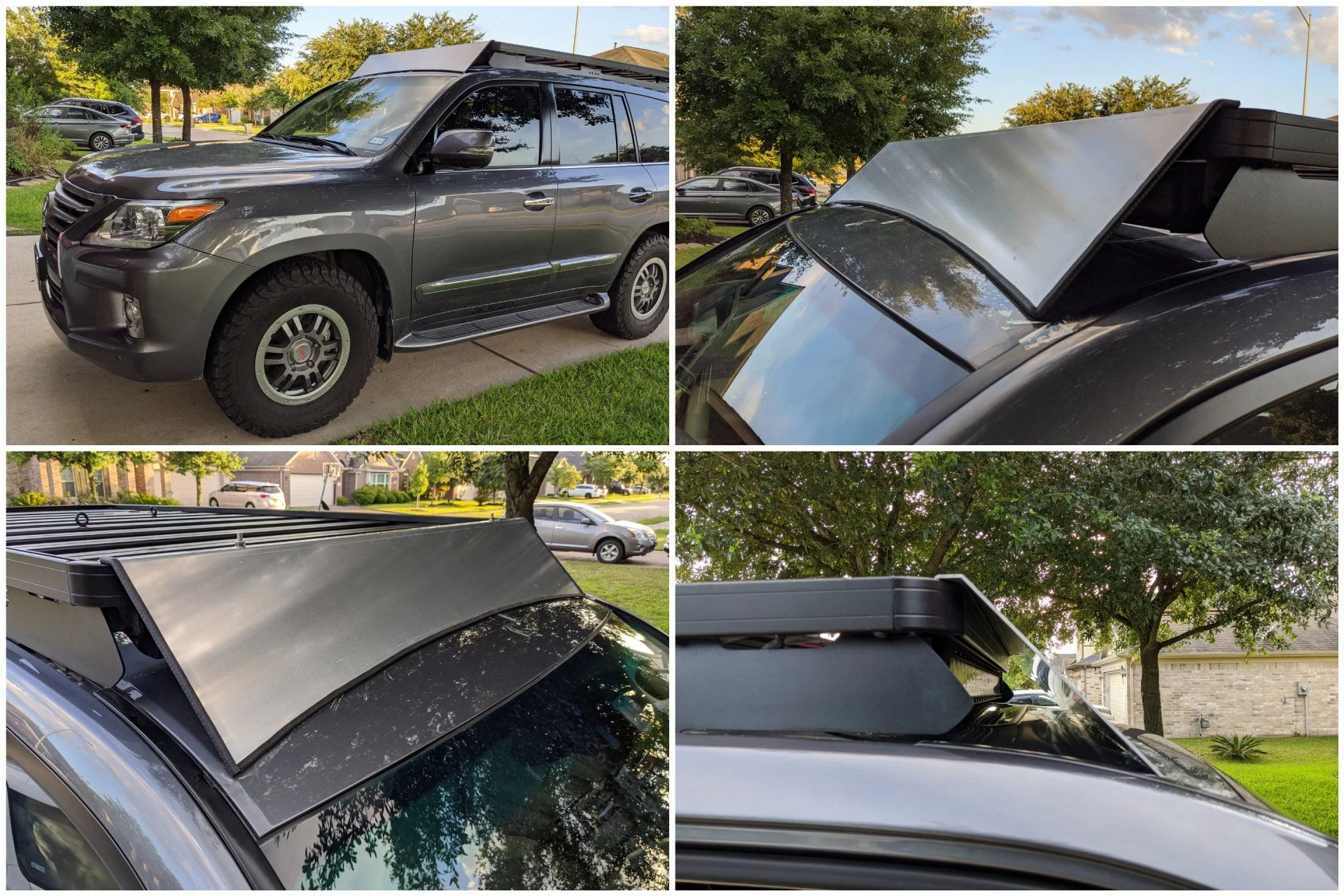

Just made a custom wind faring out of 1/8" aluminum. I decided to go this route to make sure theres no air gap between the roof and the faring to minimize wind noise. Now I'm debating if I should paint or wrap this black to match.
Just made a custom wind faring out of 1/8" aluminum. I decided to go this route to make sure theres no air gap between the car and the faring to minimize wind noise. Now I'm debating if I should paint or wrap this black to match.
Make sure if that is touching your roof you put a layer or 2 of paint protection film under the front edge or you will be missing paint fairly quickly.
NM, It looks like you already did.
My opinion is that you really don't want it to touch the roof at all. Off-road, with dust and grit, mixed with vibrations, will wear though any film in time. Leaving an ugly scar.
