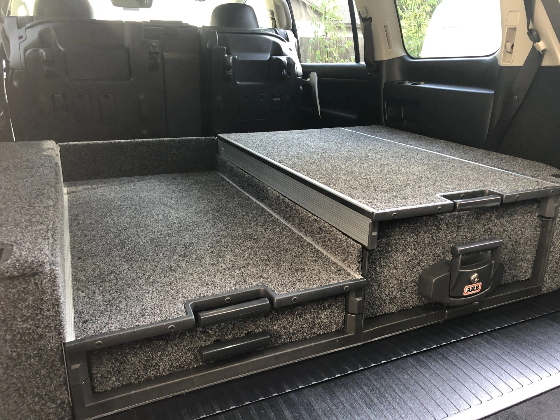

I installed the ARB Roller Floor side wing kit today. Yes you do need to remove the drawers from the Cruiser which was a pain.
Not quite finished - need to adjust drawers as they are too close to the RHS of Cruiser and wing kit does not quite fit plus I need to move my USB charge outlets.
Looks good. These kits are available here in the states...ordered mine (left side) on Thursday. Very disappointed with my dealer for not telling me about this option when I ordered my drawer and roller floor, but even ARB USA didn’t know about it.

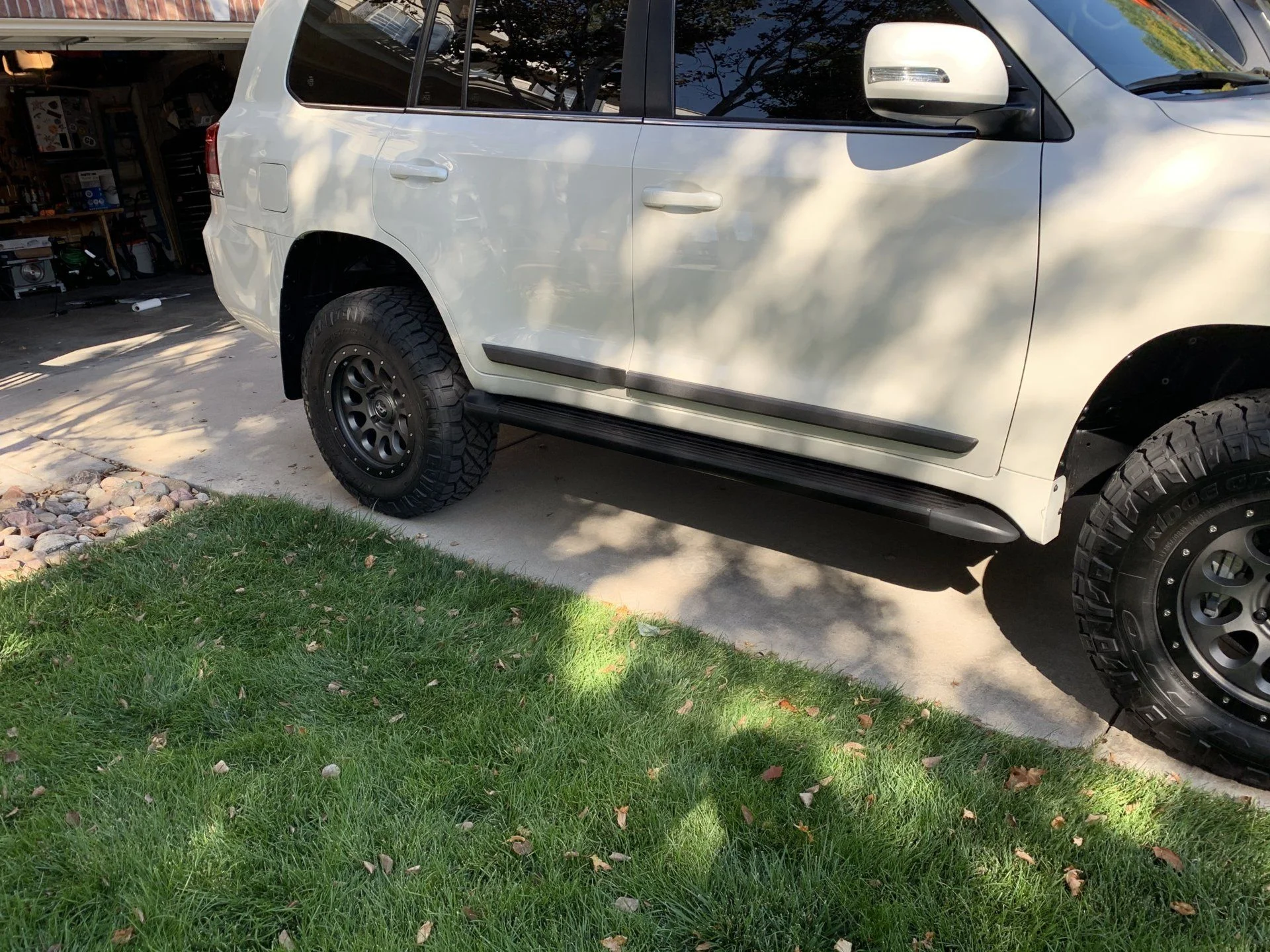

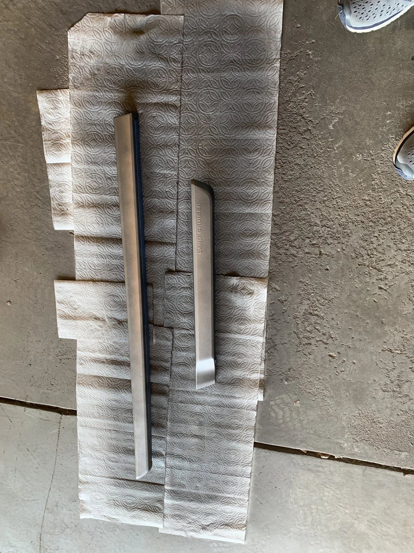

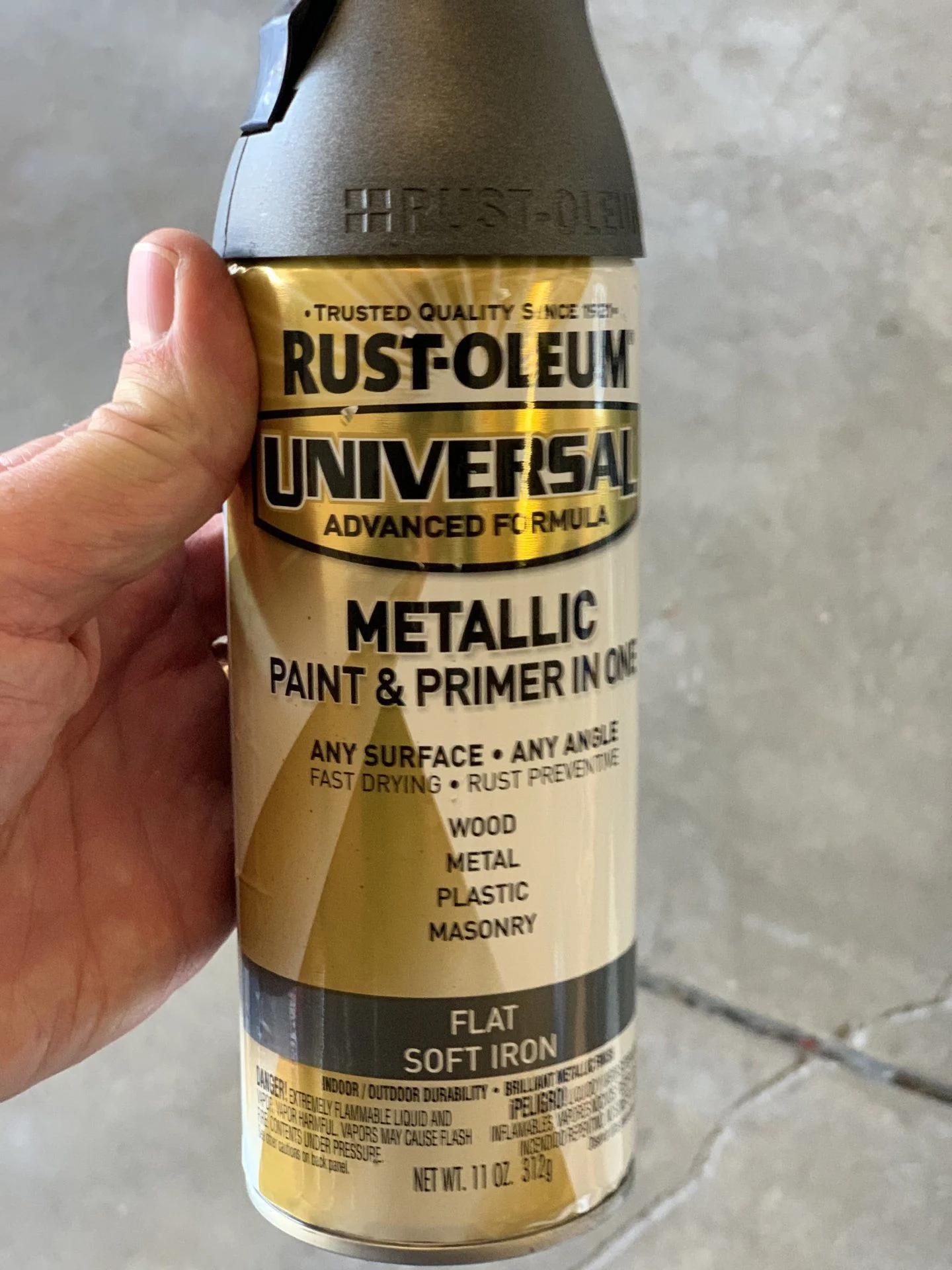

Start of the chrome delete phase of my build beginning with the side trim on the doors. So much easier than expected to pull off the trim to paint. Moving onto rear hatch chrome trim next

I just finished my installation. It was not smooth, as the RFFKADP was not properly fabricated to allow for the reinstallation of the Roller Floor. I contacted ARB and they were nice, but no help. I had to drill access holes to re-install the Roller Floor Stop on the left side. Here’s a pic of the left side...you can see there’s no way to re-install the stop on that side.
Here are a couple if shots of the finished product. I really like how clean it looks.

iI always wondered how they handled the side fit kits if it wasn’t a full-height drawer. I like it! Means you still get to use that covered space, and also get rid or the un-stackable wheel bump area.

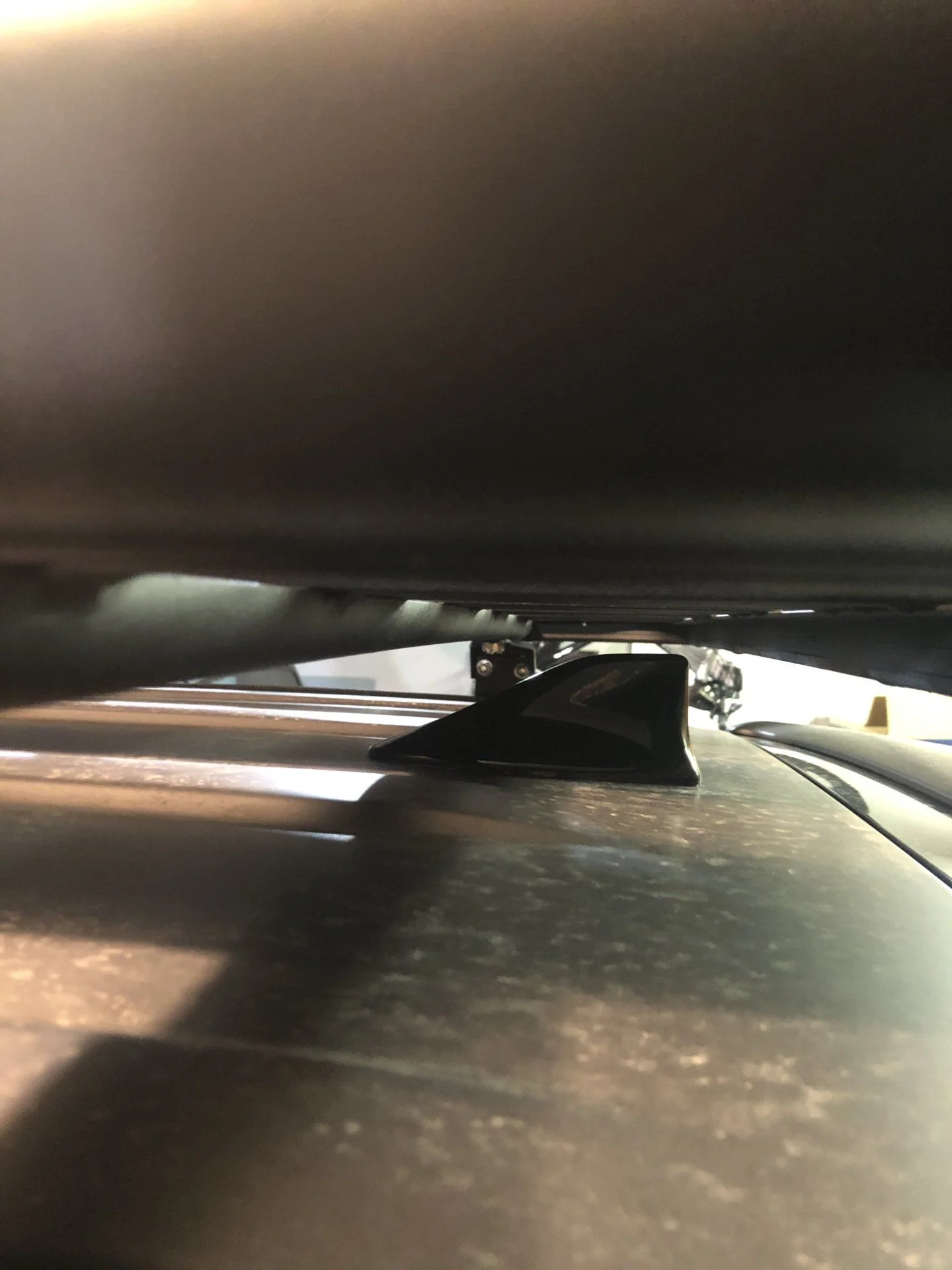

Had the recall serviced yesterday. Swapped my Eezi-Awn Load Bars for a 71”x1250mm platform on the 40mm feet. The middle two feet are bottomed out, and the front and rear feet are maxed out. There was absolutely no clearance issues with the sharkfin. I will say, if you use a platform any longer than 71”, you’ll have to mix and match components of the 40mm and 65mm feet to make it work.

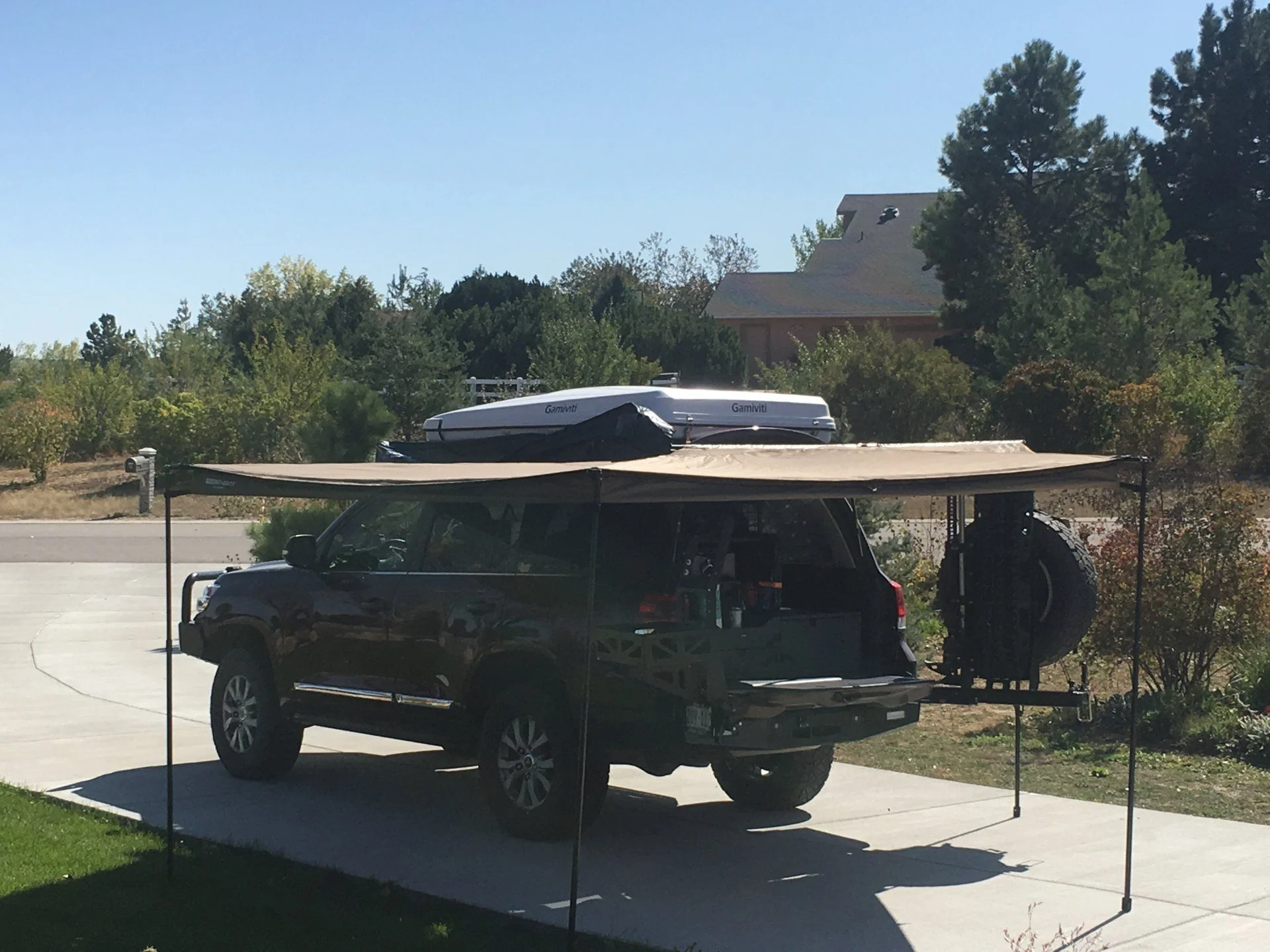

I took my 200 over Kingston Peak Pass (Colorado) today with a bunch of my friends on our annual Haloween themed "Spooky Night Run." We ended up helping some kids in Jeeps that were way out of their element and completely unprepared. Here's a picture of our cook out / potluck just before we headed to the pass.

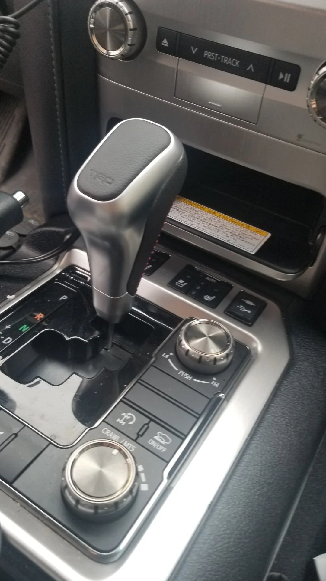

Jumped on the bandwagon, grabbed the TRD shifter. See how it feels once I drive around a bit. Looks neat.
EDIT: A fellow Mud member just bought the shift knob...so posting here in case others were interested. Came home to find multiple offers...! Didn’t expect that.
