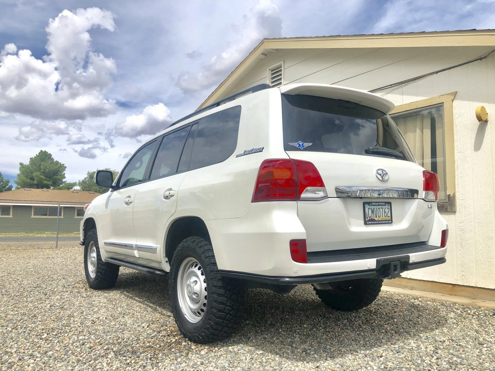

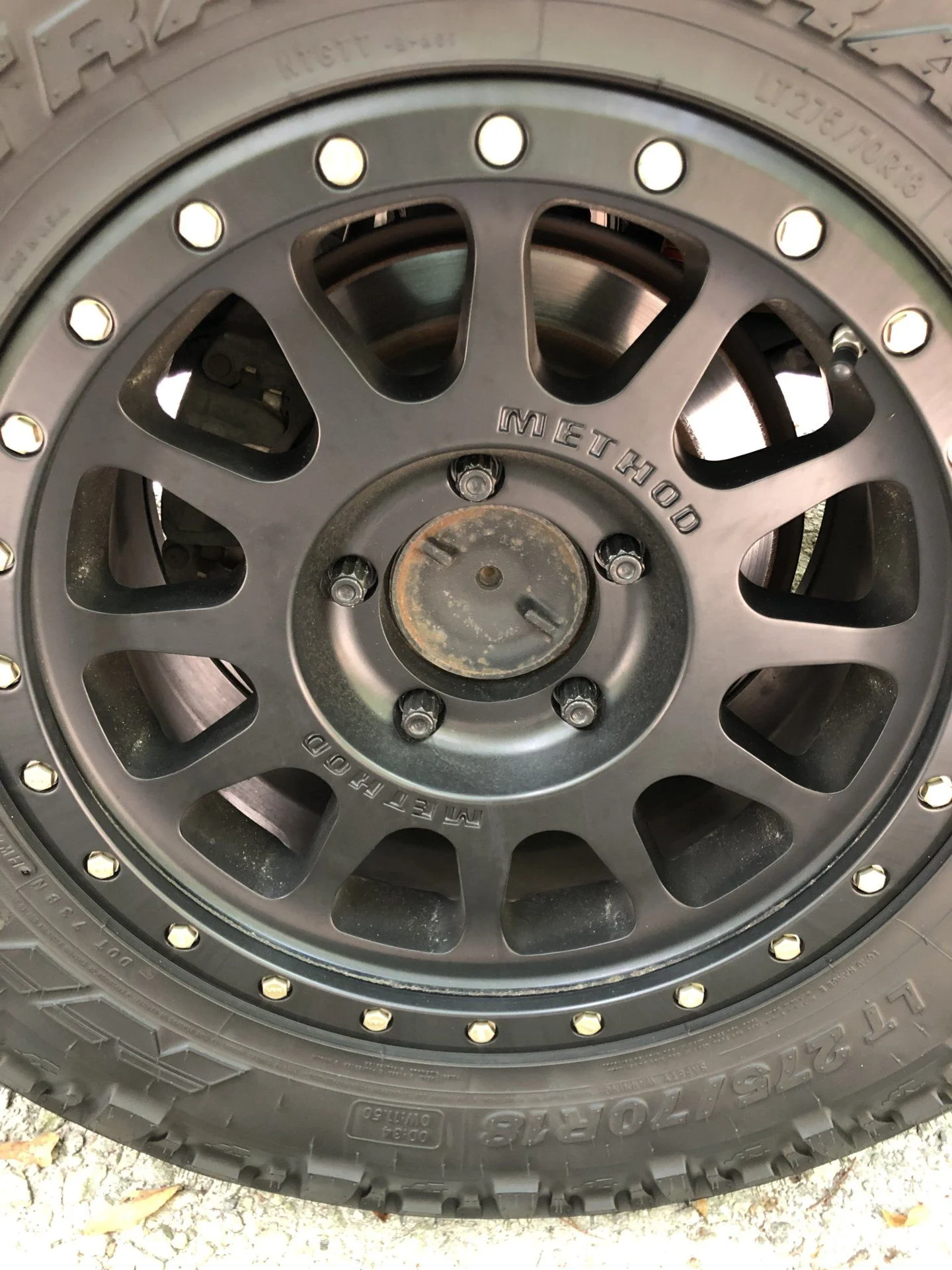

Swapped the stock 21's for 18" Tundra wheels and 275/70 Pirellis. I'm pretty happy with it.

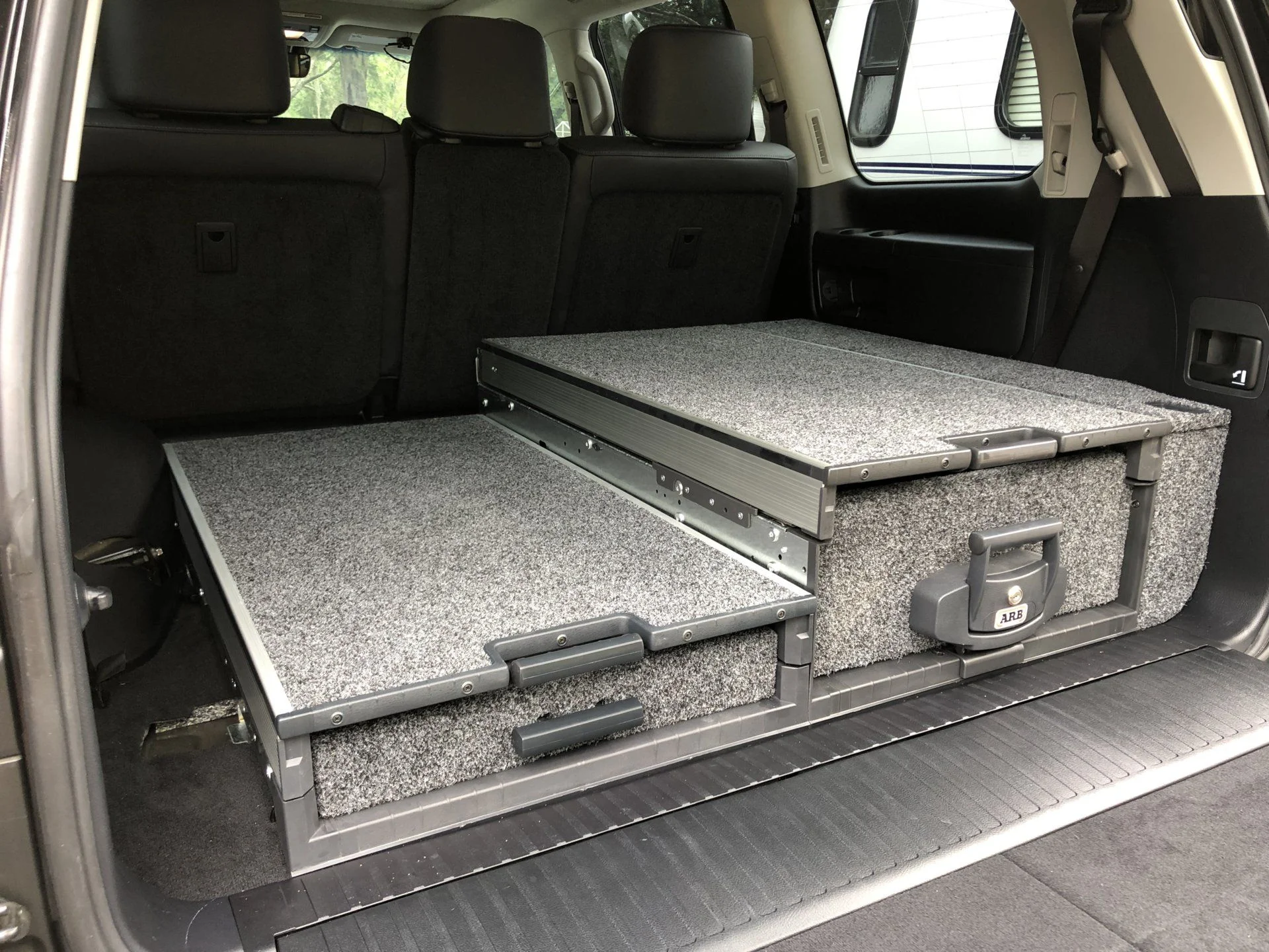

What part number is that 1/2 height drawer on the left?
I have been thinking of swapping out my full size for something like that. I thing it's a way better setup as if you are putting stuff in the back the tail gates holds in the groceries instead of the rear hatch window.
To fit the side kit likely you need just a plate of aluminum bolted to the side.
If I travel I will put it on a roof rack. Otherwise I don't want to carry the weight.
I can barely pick up a tire/wheel to stab it onto the lug studs when rotating, I can't imagine putting one up on the roof. Sounds like a good way to get hurt.
The left side is part number RF1045. ARB also makes a mid-height version that's about 2" taller and about 3" shorter than the full size unit. That part number is RFH1045. You can see a video of that unit with the side kit installed here: Outback Solutions Modular Roller Drawer Systems - ARB 4x4 Accessories

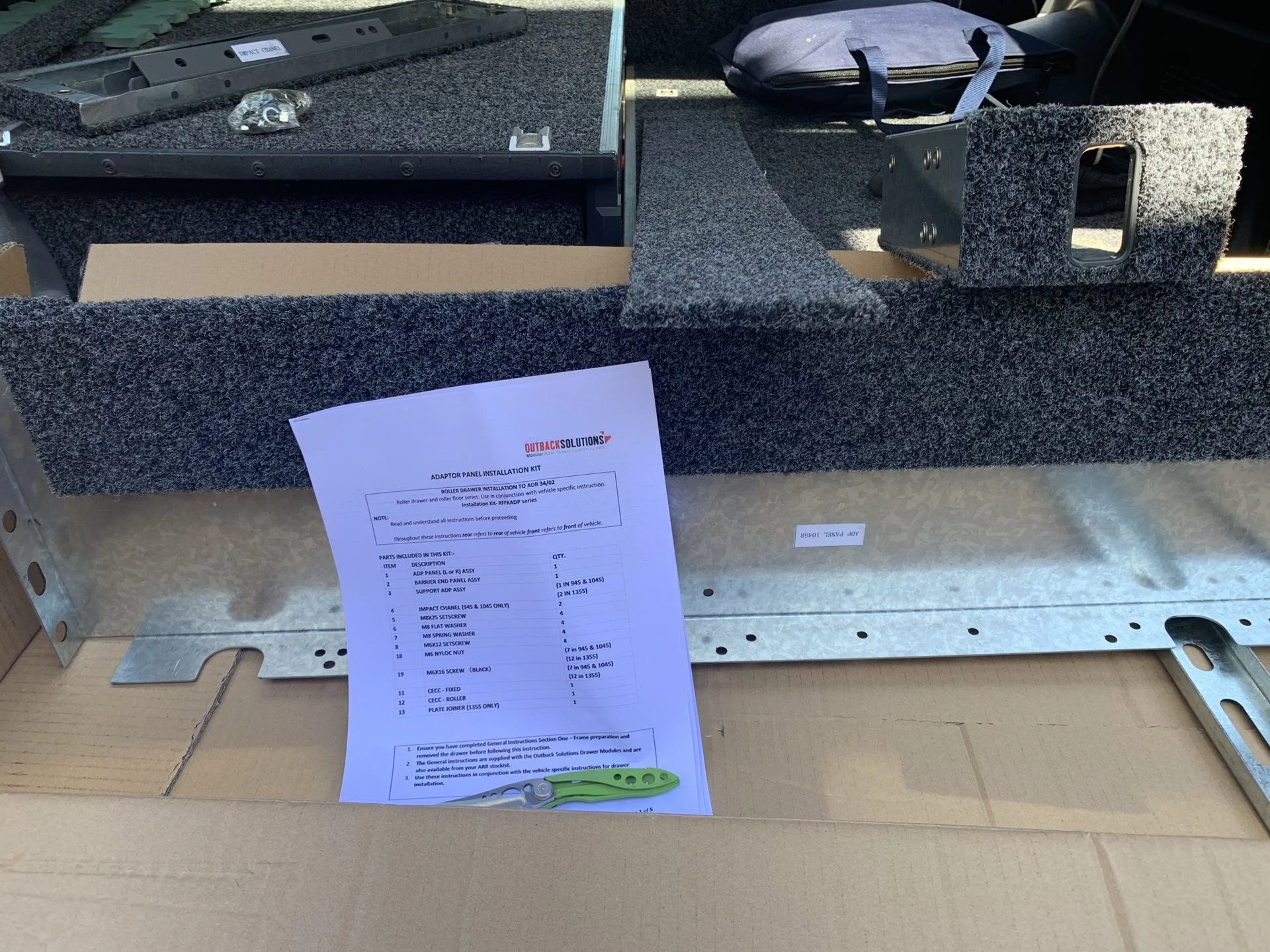

OK I have collected the roller floor adaptor panel kit from ARB.
If you want one the part number is RFFKADP1045 (R or L for right or left.
Once this is installed (and I have to remove the drawers completely apparently to fit the adaptor kit) then you can attach the side kit.
I don't have time to fit today but will do so this week and post images.

Thanks for sharing the part number and kit photos. I’ll check with ARB USA to see if this is available here in the states. Can’t wait to see the finished look. Will also be curious whether you have to remove everything from the vehicle, or if you just remove the roller floor and tray/drawer from the frame for installation.
Was that a kit you bought somewhere?
