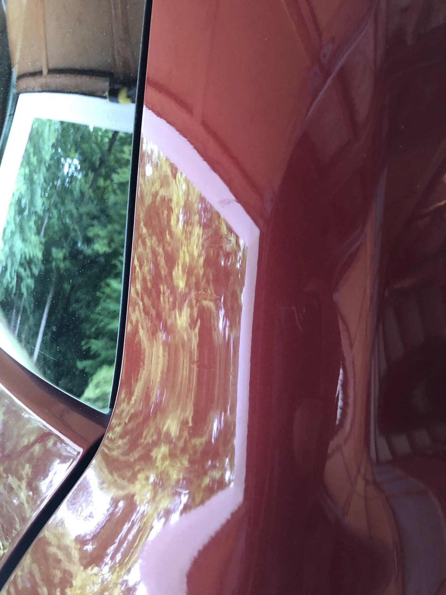

So a couple of weekends ago I took on finally giving my LC a good compounding, polish, and sealant to remove the annoying swirl marks. Well... I was switching between multiple buffers, with one being an older one that I had added Velcro to fasten pads. Problem was that the disk on the buffer was same diameter as the polishing pad, which means when I got in a hurry on the rear pillar curve, the metal plate hit the paint :bang:
So this past week I finally received the Langka touch-up kit and set about trying to repair best I could using the OEM touch up paint. These show the progression through the steps. Overall, I’m pretty pleased with how it came out, though it could be better. The nice thing with the Langka system is I can still work to get it more even, so it’s hard to really mess it up.
The last two are after using the kit, then wet sanding with 1000 & 3000, then compound, polish, and sealant.
