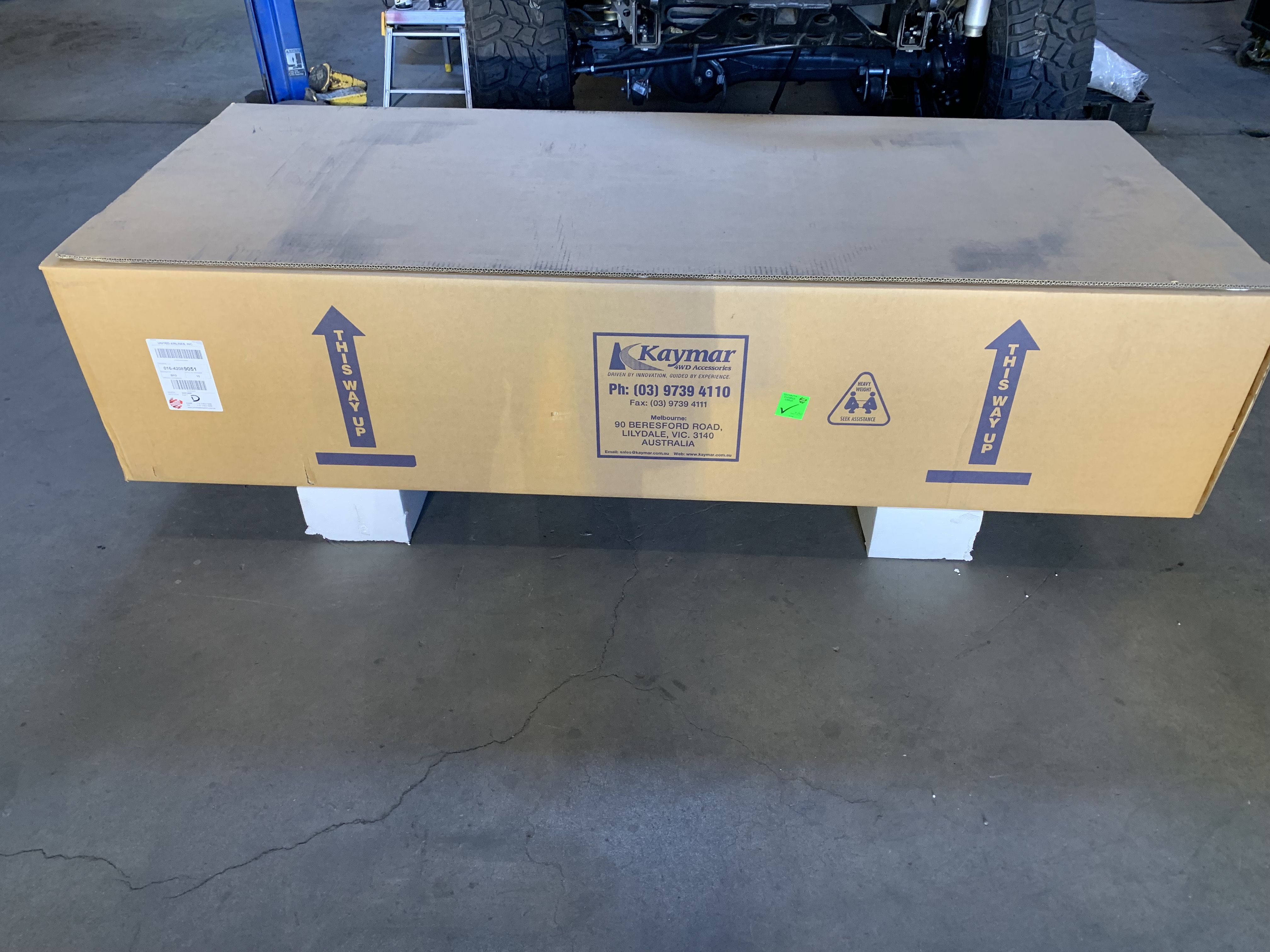

Getting my Kaymar rear bar and LRA auxiliary tank installed thanks to @orangefj45 and @wardharris . And I really appreciate Valley Hybrids getting the install done before Expo West . More pics to come.

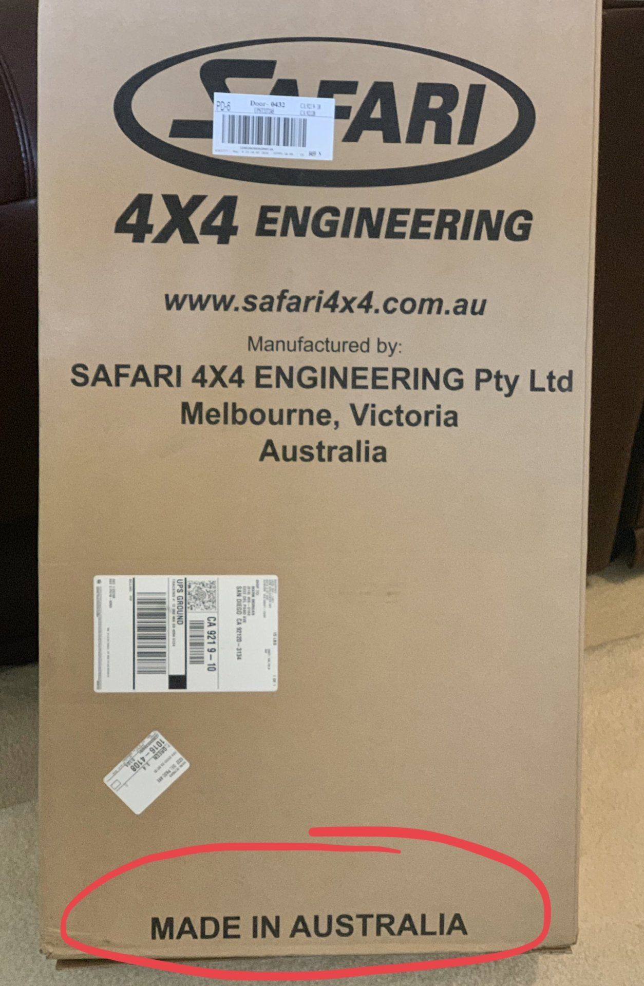

My @indycole special arrived a few minutes ago...
Noticed two things...
Made in Australia (not China)...

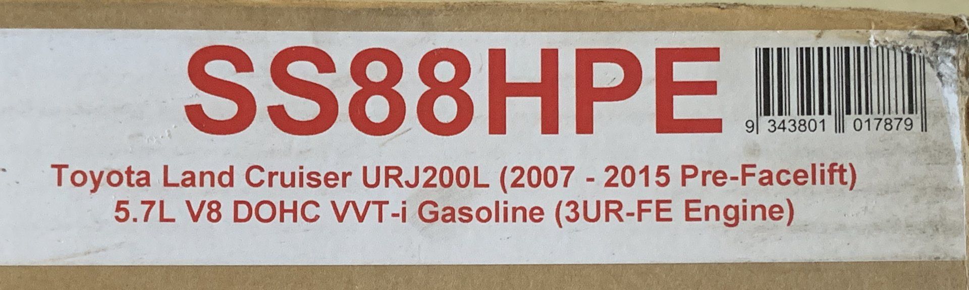

And also appreciated how clear and specific they got in specifying the model particulars like “pre-facelift..5.7...and more... Great move, ARB.
Would love for others (Toyota included) to add real world identifiers on their parts labels...

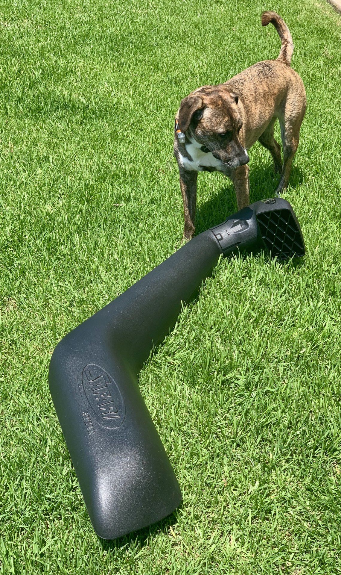

So now comes the scary part...cutting more big holes in my truck. :hillbilly:
If I can do it, anyone can do it! Just make sure you put down copious amounts of masking tape onto the fender before you put on your template, and make sure the template lines up to the body lines perfectly before you cut. A replacement fender is only ~$350 as a worst case scenario 🤣
Really?? That’s surprisingly cheap!
Bindi...wondering if she just got the world’s biggest chew toy...? :hillbilly:

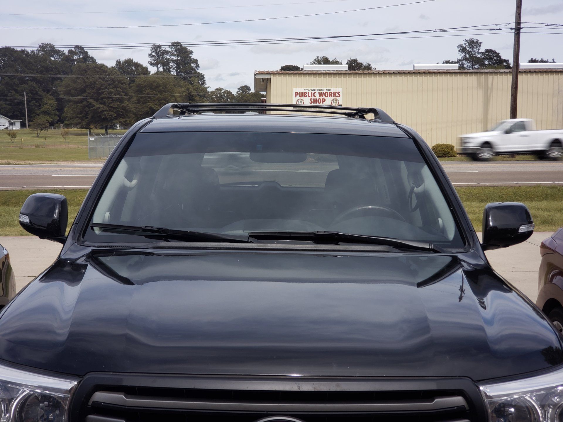

Long story short... Took truck in to get front windshield brow tint. Installer cracked windshield. Got brand new windshield and brow tint for free (awesome because I had a large existing crack in the windshield also)
And also ordered SPC UCAs and wheel spacers from Slee.
One of the first things I look for on used LC/LX is a stock one Toyota windshield. What kind of windshield is it?

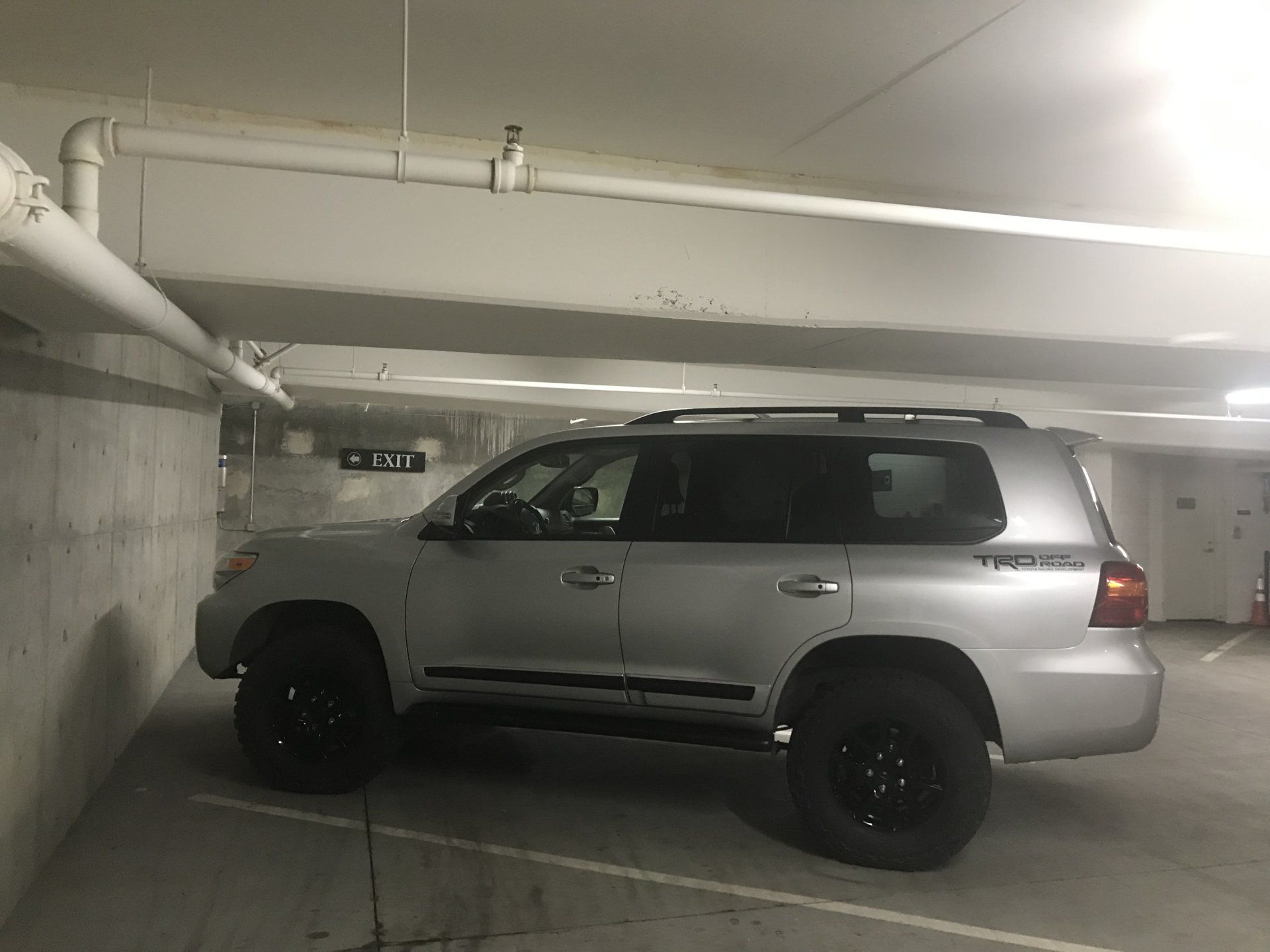

Finished the 35s install. Started with 4.88s last month.
Minimal trimming required. No body chop required.
275/80r18 measures 35 1/8 mounted. 35mm effective offset.
I was initially surprised that the 35's worked with minimal trimming etc. but great news. Maybe it is because yourn tires are narrower than the 'typical' 35? e.g., I had a lot of rubbing on KDSS and body (after trimming) with 34.4" KOs, but they were 315's. And IIRC, many LT35's are 35x12.5 (317mm) so they would intrude medially more than a narrower tire.
Were you able to test for rubbing at full compression or droop?

Awesome. Been intrigued by the Kaymar bars for a while. Was just watching some YouTube footage of them the other day and they look great on a 200-series. Nearly stock (or OEM option) appearance, especially if they are color matched. And nice that you can (easily?) remove the swing arms for more convenient daily-driver access to the rear. I expect lots of pictures on completion!

Yes. Choosing a tall narrow tire and a medium (35mm) offset was deliberately done to reduce rubbing and decrease other fitment issues. It would be slightly better for scrub and some minor clearances with 40mm offset, but I already had the 25mm spacers on hand.
No I haven’t been anywhere demanding yet. As I’ve taken up two inches of wheel well with the taller tire I will almost certainly need to sensor lift all four corners. At that point I’ll effectively be on a two inch lift (it’s an inch+ but ahc doesn’t compress with load like springs) and I should be okay for full flex.
I experience no issues currently with minor things like driving up on curbs and speed bumps, full lock turns etc
I anticipate no droop clearance issues.

Width is the killer. I was 35x12.5...and those 12.5” are gonna rub somewhere. Whack an inch off of that, and there’s a shot at clearing, though full stuff in rear in stock bumpstops can will likely still rugburn the coating on the rear wells.
