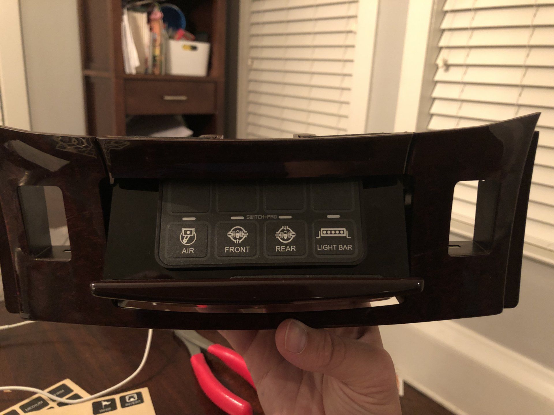

ordered the switch-pro from poly performance - wiring is super easy. hardest part of making everything fit was cutting the acrylic sheet to size and cutting away parts of the ashtray to make room. I can take some pictures of the setup if you want
Yeah, pic's would be awesome!
Yep pics would be great, also any specs or links on the acrylic sheet. Thanks.
